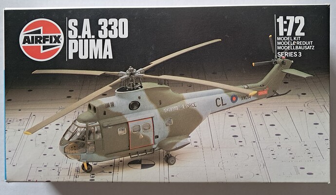

Hi Folks,
i picked up this old kit and it’s almost as old as i am!

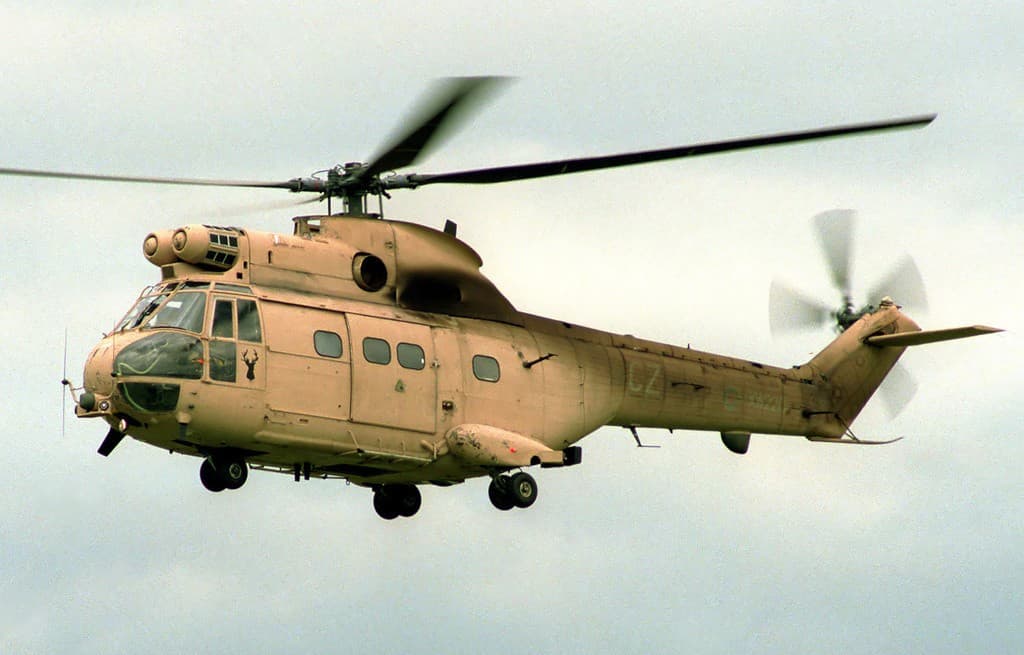

this airfix 1/72 RAF Puma and i was wondering if anyone knows what i would need to upgrade it to a Gulf War 1 version as seen below.

SA 330E is the Aérospatiale version UK used, HC is the Westland version. Like the Seaking probably a few small differences. Engine upgrades with filter are easily seen. The sponson size can be enlarged but harder to determine (at least to me).
Whirlybits has a number of sets, since the company is closed, might be hard to find but maybe easier in your area than mine.
Does this boxing have the sand filters? I’ve got one from the early 2000’s that has. Airfix have announced a reissue at some point this year, so if you not you might be able to get some spares.
Off the top of my head, it also needs countermeasures gear. ECM antenna and flares. I think the rear clear bubble was removed and covered over with a new panel. This is probably where the rear mounted flares were fitted. This seemed to remain a standard fit after. Would probably need a door mounted gpmg.
I’ll be interested to see what we can gather as I’d like to have a crack at this myself.
I have got a gut feeling that Airfix might surprise us with a new 1/72 Puma in the near future. They’ve done Seakings and a Wessex is due, so a Puma is logical.
Air Graphic do a set designed for the SAAF Puma, not sure if this is the same as the RAF version or not, I’m no Puma expert.

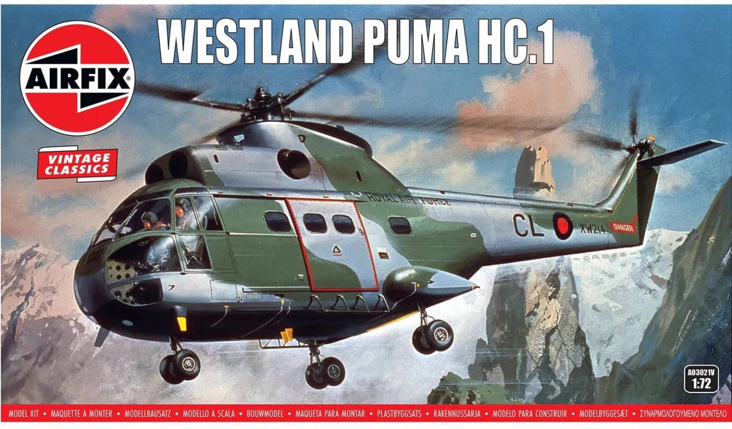

Airfix released the kit changing the designation to HC 1, but I think it is just the same kit:
Was just looking at these myself. I think they might be different. Doesn’t seem to have the intake ring around the front.
i can’t see any sand filters in the kit so I’m assuming that this is a pre-gulf war issue.
since you have mentioned that airfix doing a re-pop i might just build this one OOB and see where the fit issues are. my guess is the new version will be a re-pop with some added stuff to make it look more modern.
