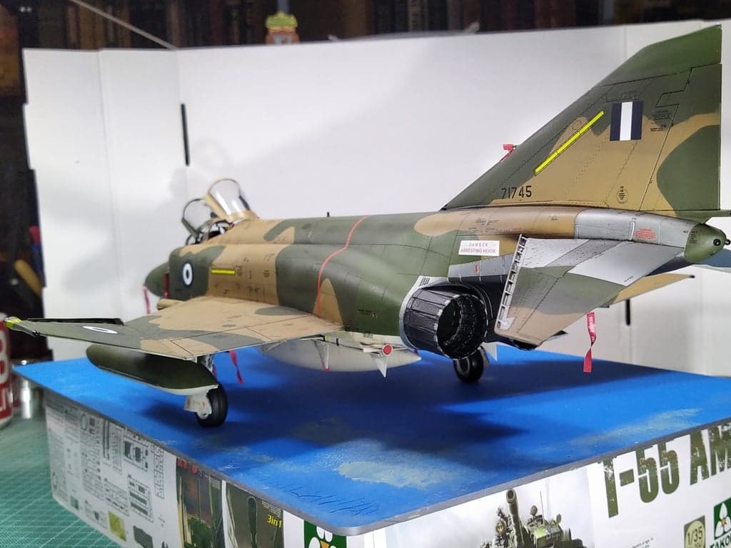

I have used them a couple of times.
Primed the model with Ultimate Primer then sprayed their own black gloss primer.
I used my 0.5 nozzle 15-20 psi pressure. Shake very well before using them, do not use any thinner, straight from the bottle.
Without any kind of varnish over them:
Black oil wash, very light
With matt varnish over the paint:
