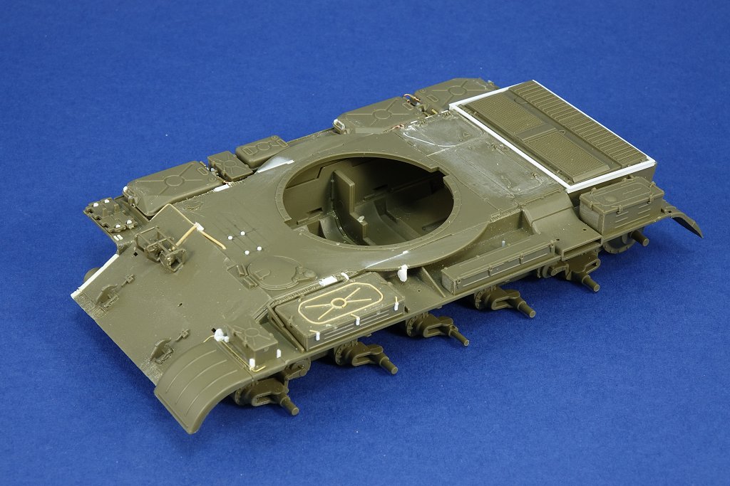

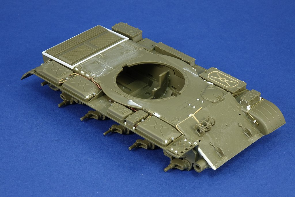

To backdate the 1/35 Tamiya kit, you’d need to do a lot of small, stuff that will take time.
You’d need to add the fixed machine gun beside the driver (just a hole in the glacis), fill in the glacis weld seams and re-score them (the T-55 has a straight/horizontal weld seam along the lower part of the glacis. The T-54 glacis interlocked with the underside plate, so the weld seam is more complex, as are those along the front of the hull roof has a more complex interlocking weld arrangement. The location of the diamond-shaped access cover on the roof beside the driver would also need to be relocated.
The large stowage bin on the fender next to the driver’s hatch also needs to have the lid changing to reflect the different embossing pattern present on T-54s and all(?) Chinese ‘Types’
The rear engine deck of the Tamiya kit is not suitable for a T-54 so you would need to change the hatch arrangements.

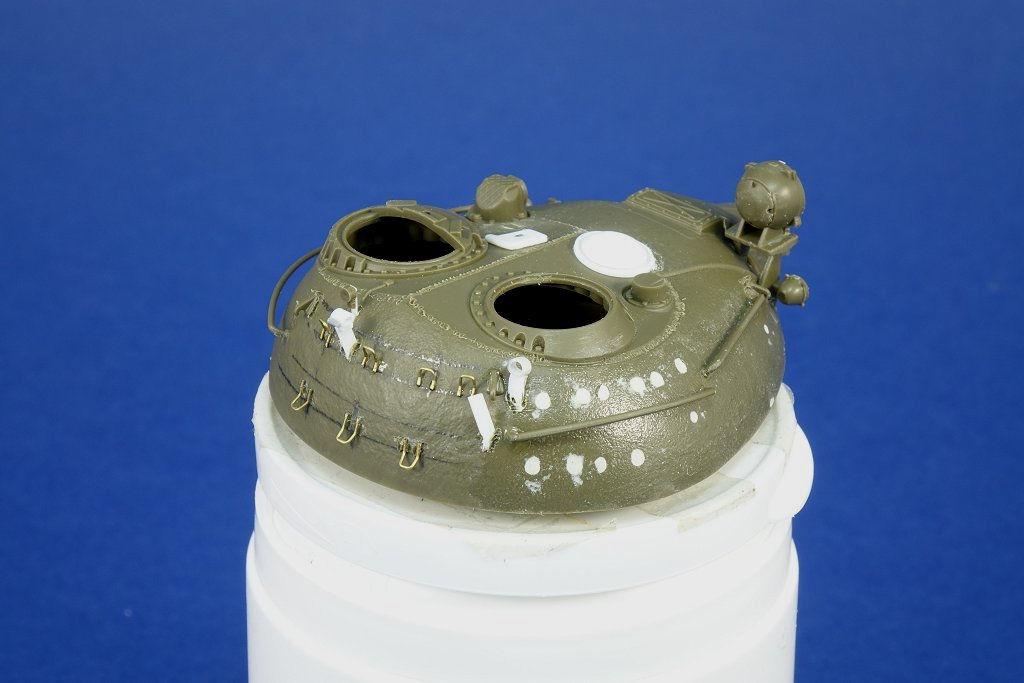

You commented on the turret ventilator but also consider that the T-54/Type 59 as-built, did not have the gunner’s sight housing on the other side of the turret roof and that in turn means that the small periscope adjacent to the main sight was in a different place on the roof.
The attached images show what I did to dackdate the Tamiya 1/48 scale T-55 to a T-54 (note this tank has the gunner’s sight fitted because most Soviet T-54s were regularly cycled throught depots and upgraded with newer parts). Also, for a Type 59 you won’t need the deep wading frame around the rear engine vents (but ultimately it didn’t matter for my project as most of the engine deck was submerged
