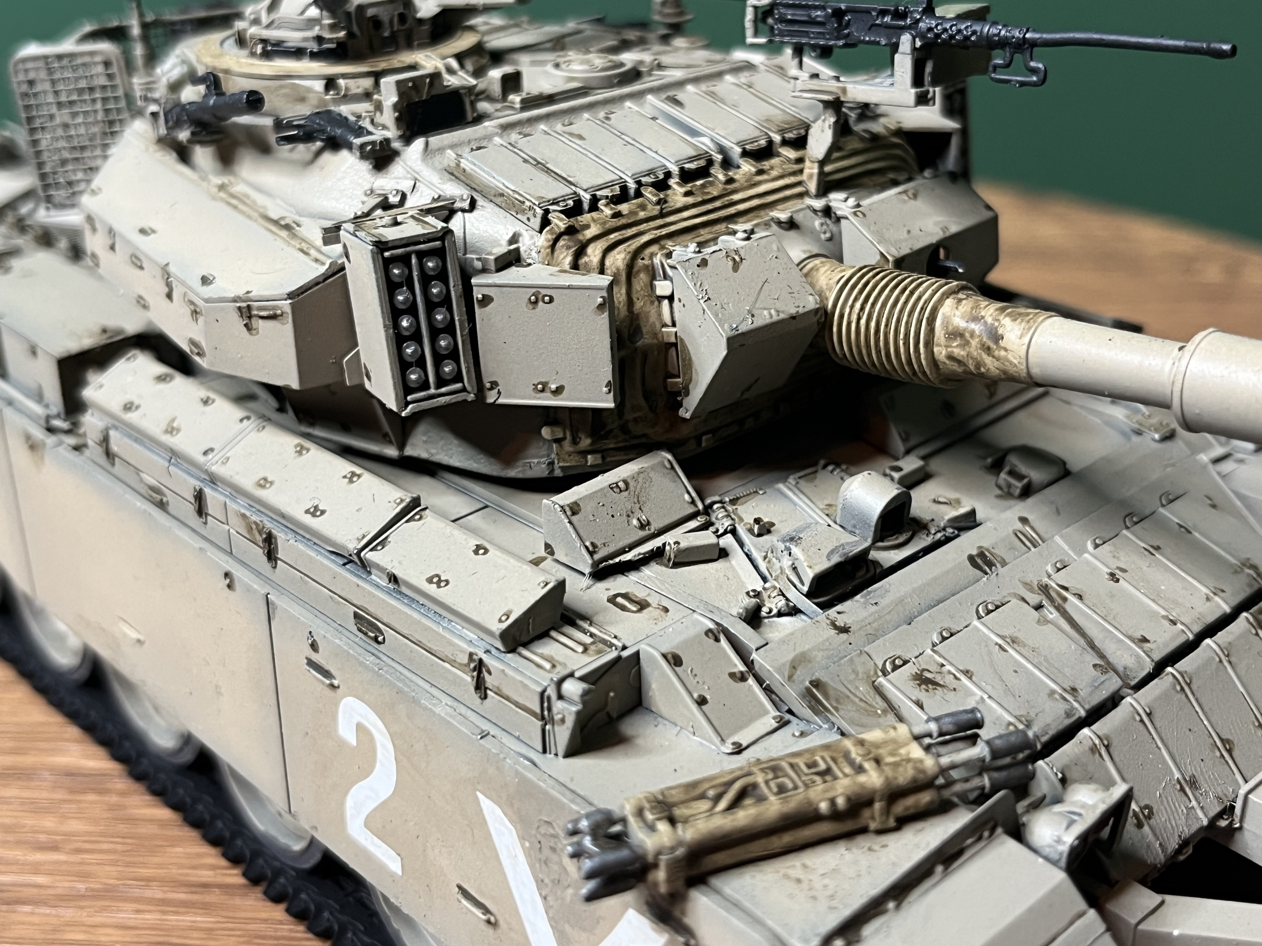

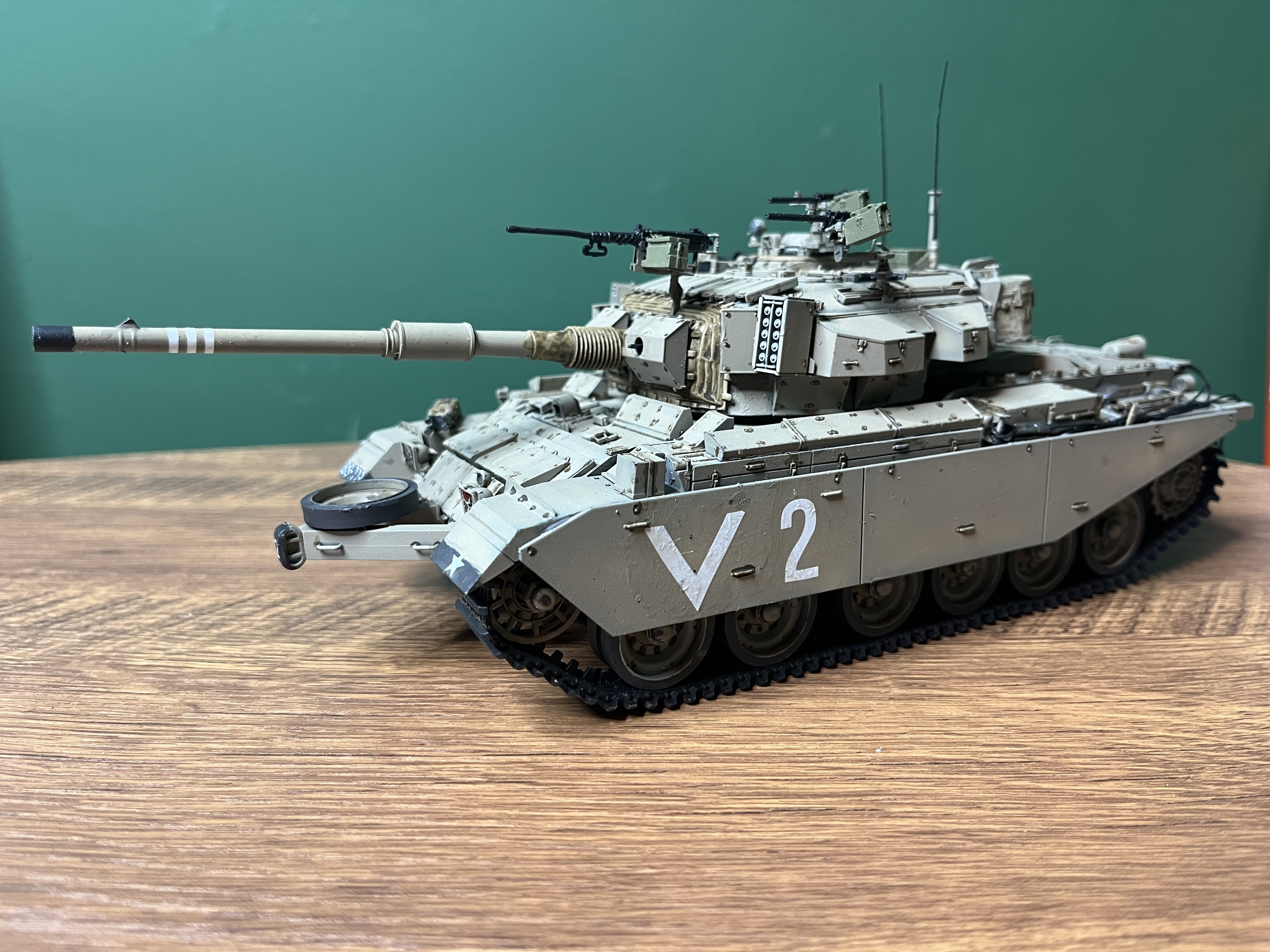

Hey guys! Decided to post my failed Alef that I converted to a Gimel!
Story after the pics!
So, the Sho’t Kal Alef is my favourite tank of all time. When I was just starting out, it was the third kit I built (After a Merkava Mark 4M and an IS-2)
But due to my inexperience and some other problems, the kit didn’t come out very good. I accidently cemented the sprockets, making them seize up and no longer be workable, I messed up the canvas cover I added, the sponsons where all the stowage boxes and tools are on were bent, I lost a few small parts that were never found..
Basically, messed it up. Not too bad, and probably not noticeable to the average person
But since the Sho’t Kal Alef is my absolute favourite of all time, I wanted it to be perfect.
So I decided to retry.
But what to do with tis botched one?
Well, the amusing hobby Alef kit actually comes with all the Gimel parts!
All I needed to do was get the instructions for the Gimel from Scalemates, and I got to work. I copped off what needed to be chopped off, added what needed to be added, replaced wat needed to be replaced, and boom, it’s a Gimel!
I was missing decals, so I scavenged some from other kits haha. They’re not accurate at all but they’re similar enough.
And well, even though it started off from a botched Alef, I think it still made a pretty handsome Gimel!
My dad actually served in a Gimel in the first Lebanon war, and I think he’d approve too!
Well, that’s about it, cheers!

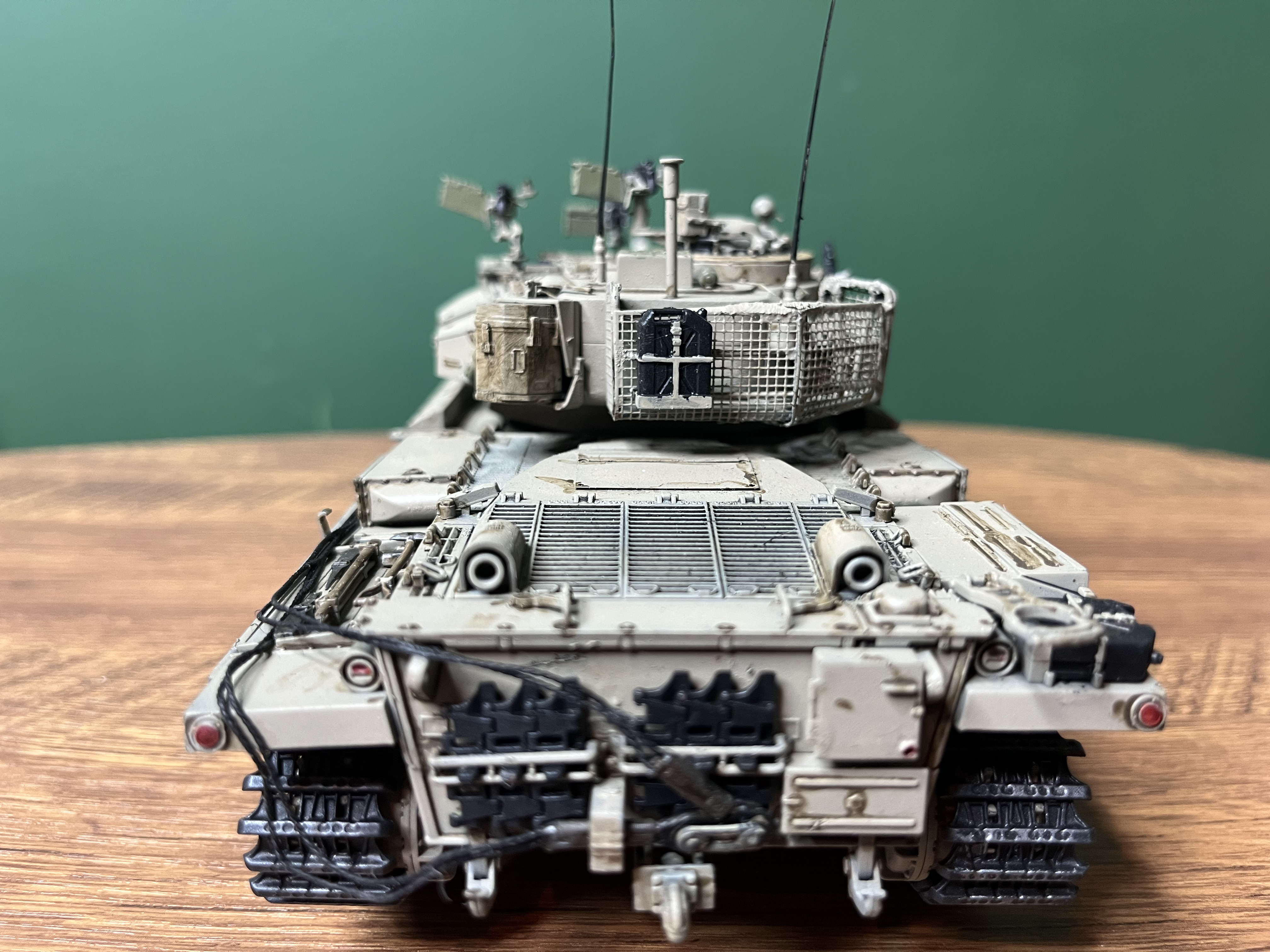

Very nice resurrection! I’d suggest you add some soot to the exhausts.

  • Better engine, and therefore two additional exhausts (seen in photos 4 and 5)

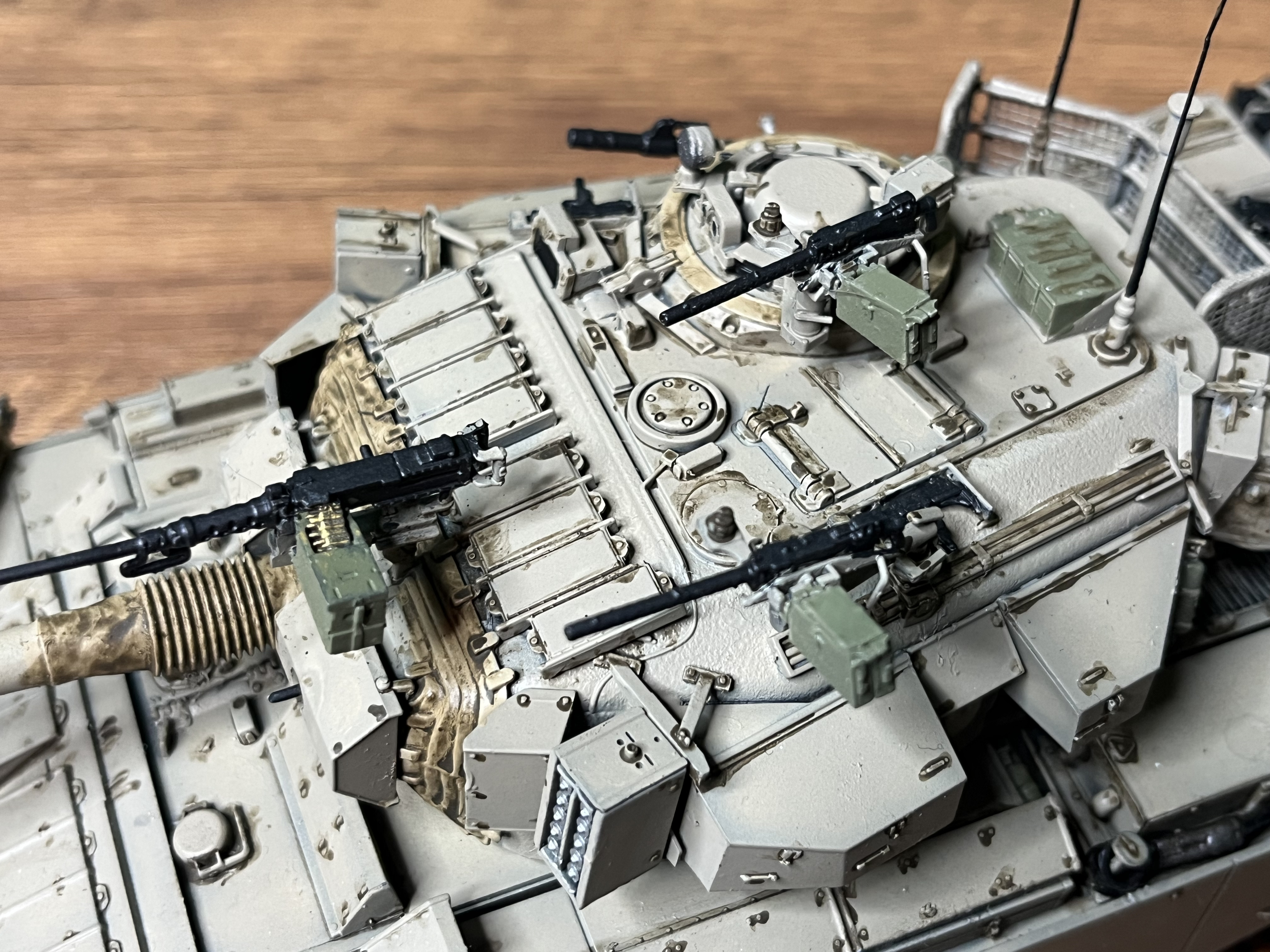

  • Added a co-axial 50. cal machine gun above the main gun, and also an additional MG for the loader

  • Added 60mm mortar

You mean the two new ones on the engine deck yeah?
Great suggestion, don’t know why I didn’t do that… Will do!

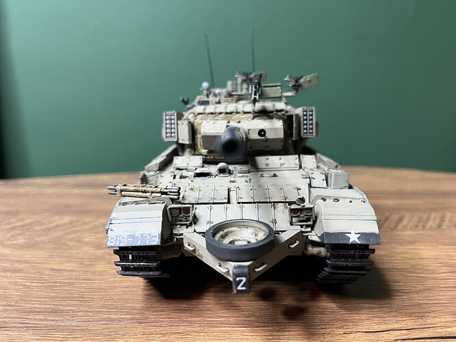

Hey lad! Great model! A few notes.
The tactical marking on the fender shouldn’t be filled in, it should be sort of a dotted outline of a pentagram, in the middle a number. I think you’ll find this video useful, I will not comment on it’s accuracy.
The two exhausts on the engine deck, aren’t just normal exhausts, they are called Karney Plita (קרני פליטה) and were added for the ESS.
On the rear of the turret is that meant to be a meteorological pole? If so it shouldn’t be there on a Gimel.
Thank you!
First from what I know, the video is quite accurate!
And yup I know haha, the 188th brigade’s symbol is a segmented star with the battalion number inside, but like I said, I did not have the right decals, I had to scavenge the smallest star I had from a scrapped M48 kit! The serial numbers on the other fender aren’t accurate at all either haha
And yup, correct, the exhausts were for ESS as well!

You have a choice, either rip it off or… Turn the model into a Dalet! Regarding serial number, listen, I am a huge IDF Serial number nerd, I have many memorized but Shots have so many different serial number series it is tough to tell, but is it a Magach serial number?
You trying to give my tank an even worse identity crisis?! :rofl:
And yup, precisely! It’s a leftover serial number from my Magach 6B (technically 6B Gal) I made a while ago, that’s why it’s so modern and pretty and stenciled
In reality from what I’ve seen on the Sho’t (at least until Dalet) it was just handbrushed on
But again, worked with what I had…
817773 IIRC was one of the Magach 6 Bet Gal Batash which began life as a Magach 6 Alef (M60A1) in 1973, it continued as Magach 6 Bet, Magach 6 Bet Digum Meshulav, Magach 6 Bet Gal and finally Magach 6 Bet Gal Batash.
