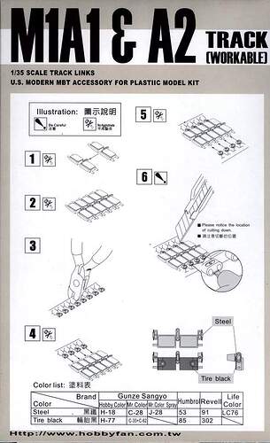

Dear all, putting this thread to life again. Inspired by @TankNut and Coldemonspl I´m building the Amusing Hobby’s Abrams X now as a “What If US Army Europe 2037” in an interpretation of the four tone TALON pattern in splinter version. Really enjoyed the build so far. However, I just can´t do the tracks with 243 pieces, and sometimes a little bit of a poor fit (from one of the sprues). Can anyone give me some advice on an aftermarket product or if I can use tracks from another vehicle such as the Leopard (Diehl) as @tanknick22 suggests? Thanks in advance! /Fred
Any set of Abrams T158 tracks will do. For an easier set of indi-links, I suggest the AFV Club ones. They are one-piece tracks with individual end connectors. They go together easy.

Thanks @HeavyArty , I will find that track kit. Just can’t do the 240ish pieces per track in the kit… ![]()
