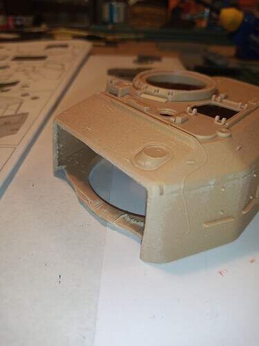

This is from where I cut the front of the turret off.
and the cut.
I did order the wrong mantlet so had to fix it with a simple filler fix and re-sculpted it a bit.

The cut is pretty simple, just mark with a sciber the lines and work with that. You cannot go wrong with that approach.

Its seriously a very nice kit. you should like it. The turret front sawing was fine, use the moulded on strips as a guide and it comes out as a nice neat cut and i needed minimal filling to join the DEF mantlet to the turret - I used Superglue gel as a filler on mine. no issues. Anything else, please feel free to ask, and like I said, Nikos and Israel are fonts of all IDF knowledge :+1:
