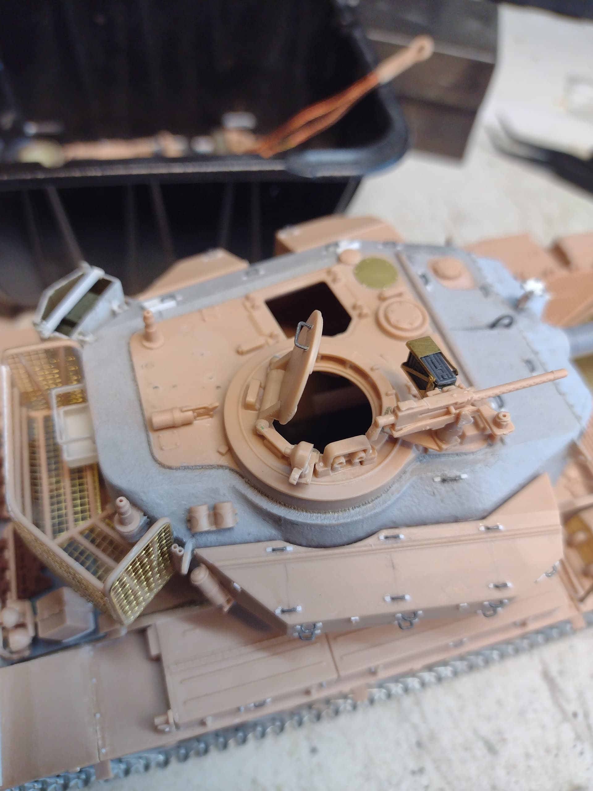

Ammo cans off, and I think I’m going to remove the TC’s Uzi mount because it’s an obvious factory type mount, but I can always hang one nearby later.
I guess I need to break the tracks down and clip the ends on every sixth link… oh joy.
Edit: the Uzi came off easy, only held on by a couple of tiny weld beads at the bracket.
