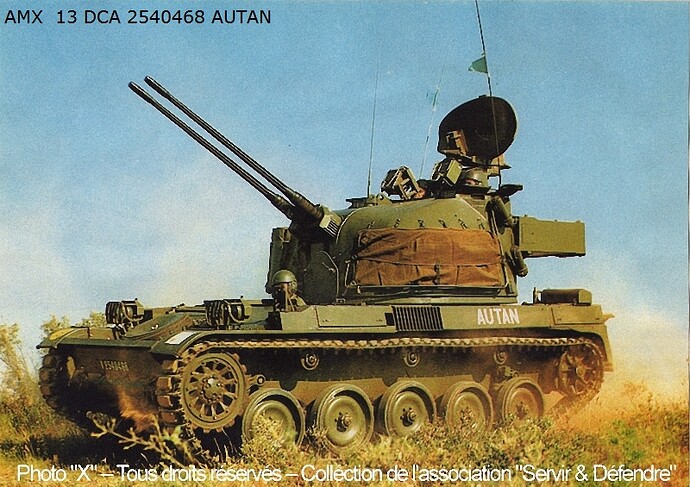

Robin, I may have confused the issue (or myself); the plan is to produce an AMX 13 variant - the AMX 13 DCA - taking the turret from the readily available AMX 30 DCA and transplanting the turret onto a Heller AMX 13, in order to end up with something like this:
and that will be difficult since the AMX-13 DCA hull is different from the
plain vanilla AMX-13 gun tank.
