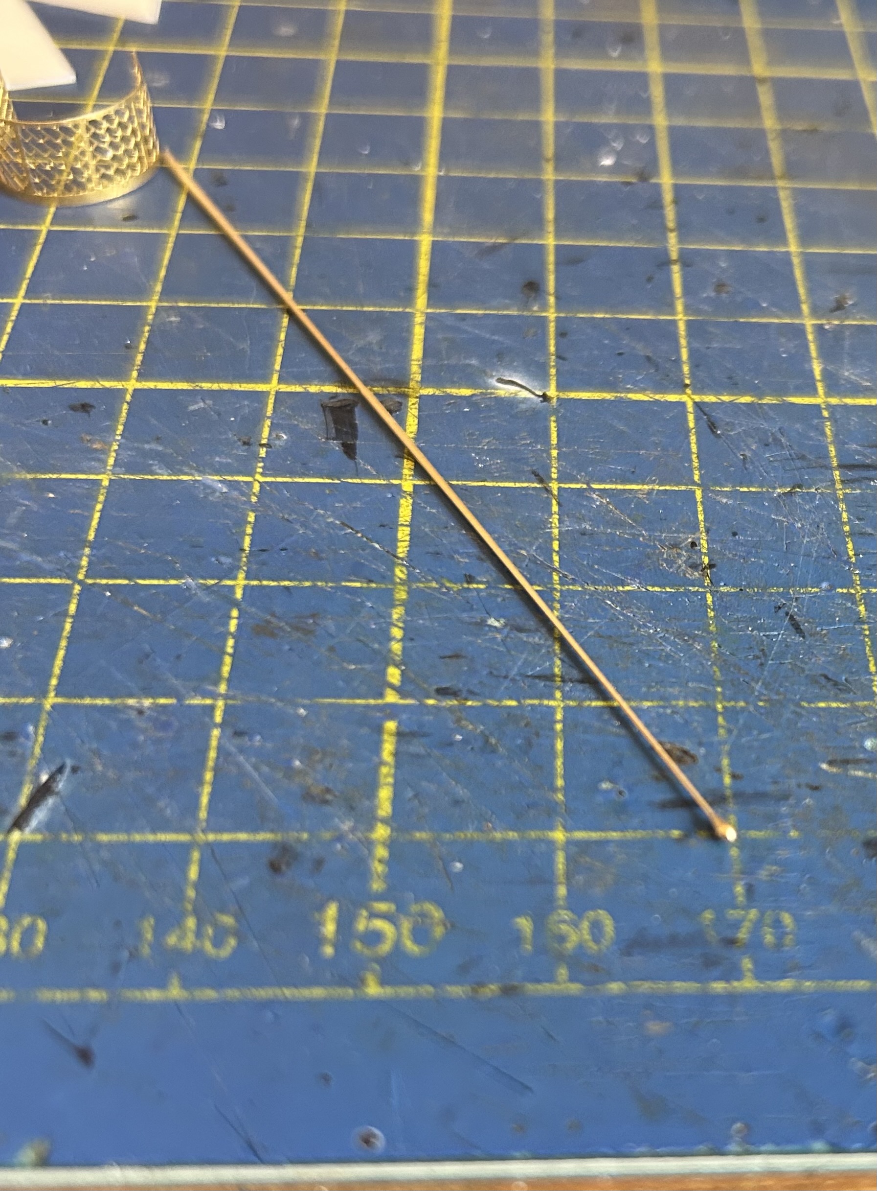

At some point, I purchased some beautiful, tapering, turned brass antennas and US antenna bases from somewhere. Packaging is long gone.

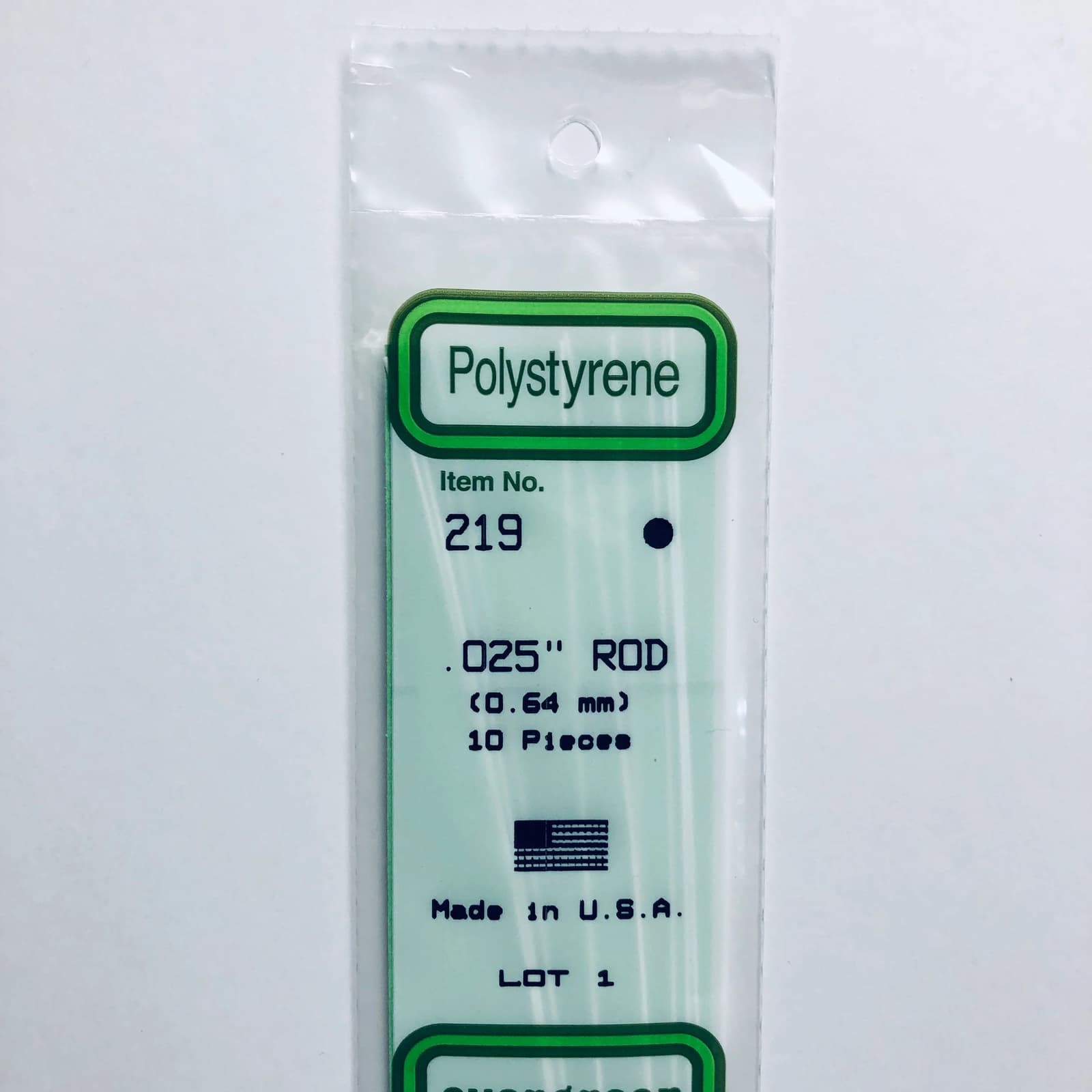

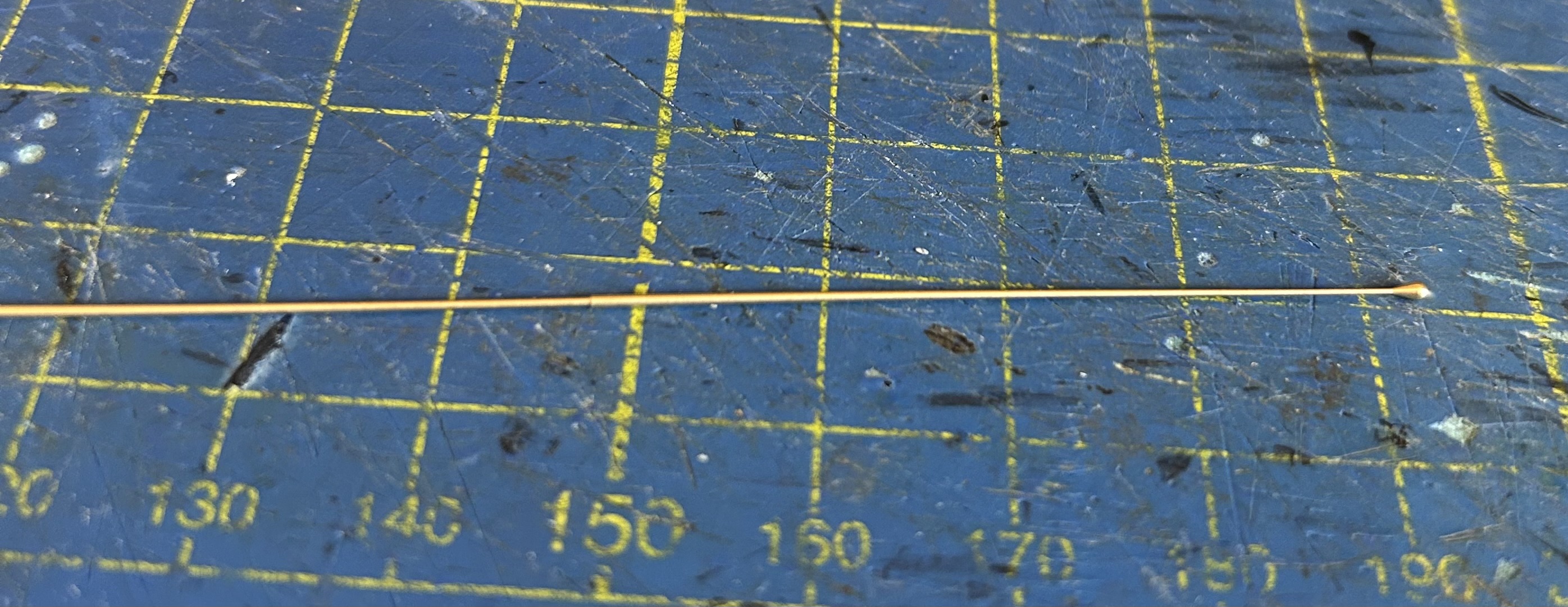

I use Evergreen 0.025 styrene rod. I cut them to length (2.75" for modern US antenna) and slightly mushroom the top end w/a flame to replicate the antenna ball. It is also easy to bend to make a tied-down antenna.

Sounds simple for new builds. My problem is that none of my fleet have them and I’d like to retrofit them all.
Adding them to Djiti’s resin antenna matching units and you will be set. You just have to scratch a base that attaches to your vehicle…
These are bases right? It’s the other end of the antenna Im trying to correct.

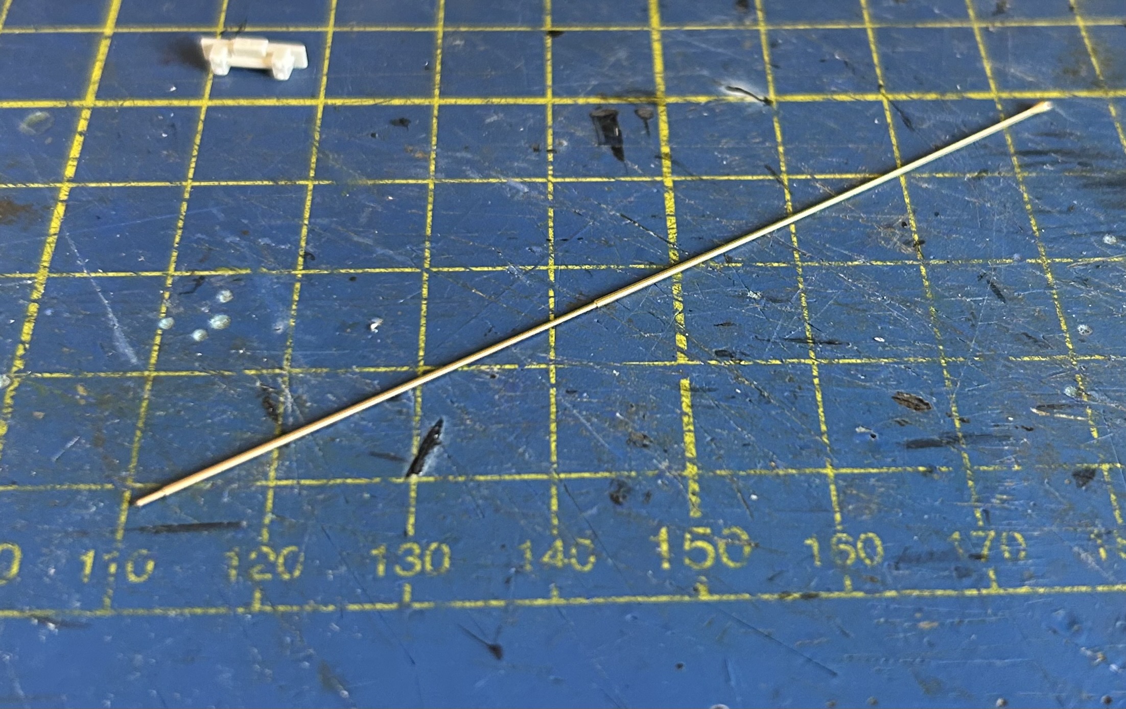

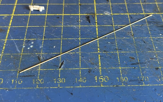

I have bases, some a/m brass antennas and have made a few antennas from sprue (minus the end cap you described)
It’s producing and retrofitting the end caps I’m struggling with.
