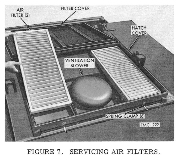

Looks pretty sharp. What’s with the box on the external side of the cargo hatch? Do the instructions show to mount such a thing there? On a real 113 that would prevent the hatch from locking in the open position and become a hazard when moving to anyone on the rear deck.
The Aussies mounted an exhaust fan and filters onto the top hatch. The latching mechanism was adjusted for this mod as well as the hatch supports.

Not armour, merely a filter pack for the forced air ventilation system. The lid is removable to permit cleaning if the filters.

@HeavyArty & @enfield38, ya learn something new every day. Thanks for the information. I realize that the 113 has served long & wide and has more modifications than are easily listed over that lifespan. But that air filter/blower box on the cargo hatch is a new one.

Australia trialed two petrol engined M113s against two early prototype British FV432s in the early 1960s to replace Saracen armoured cars in the APC role. The M113 was the eventual winner, with the (soon to be available) diesel powered family of vehicles being purchased. One outcome of the trials was the development and installation of the tropical ventilation system mentioned in this thread. That system was factory installed on all Australian M113A1, M125A1, M577A1, M579A1 and M806A1 vehicles. New Zealand also opted for the same kit.
enfield 38,good too know!,…never seen a ventilation system like that before!
