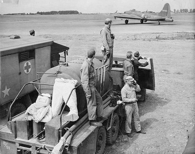

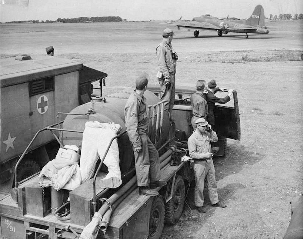

As far as I’m aware the USAAF were issued with Katys from soon after their flying units arrived in the UK (it was a package deal - an airfield with supporting infrastructure). The priority was to ship combat items from the USA initially, so the support and service elements were supplied by the UK until the American logistics train could get up to speed. I would suggest that the vast majority were of the ‘round vent’ flavour
There is also a suggestion that USAAF Katys remained in use late into the war on UK airfields because the Dodge ambulances were 4x4 and therefore better suited to front line ground units. That said, there are photos showing mixed line-ups of Dodge and Austin ambulances on UK airfields.

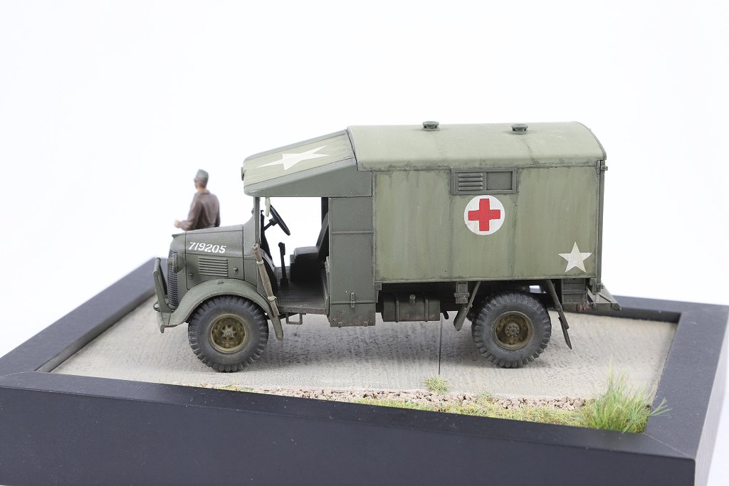

The one below was my take on a USAAF wagon (1/48 Tamiya kit).

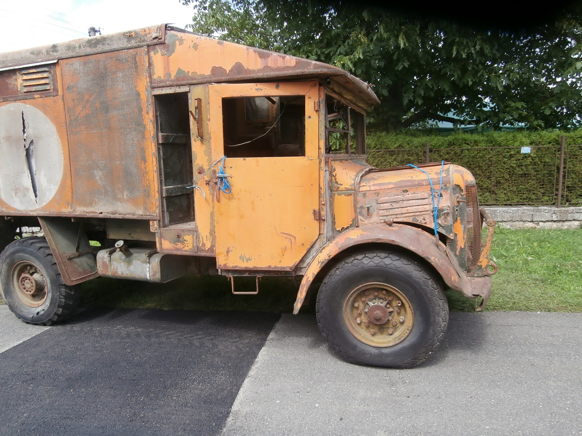

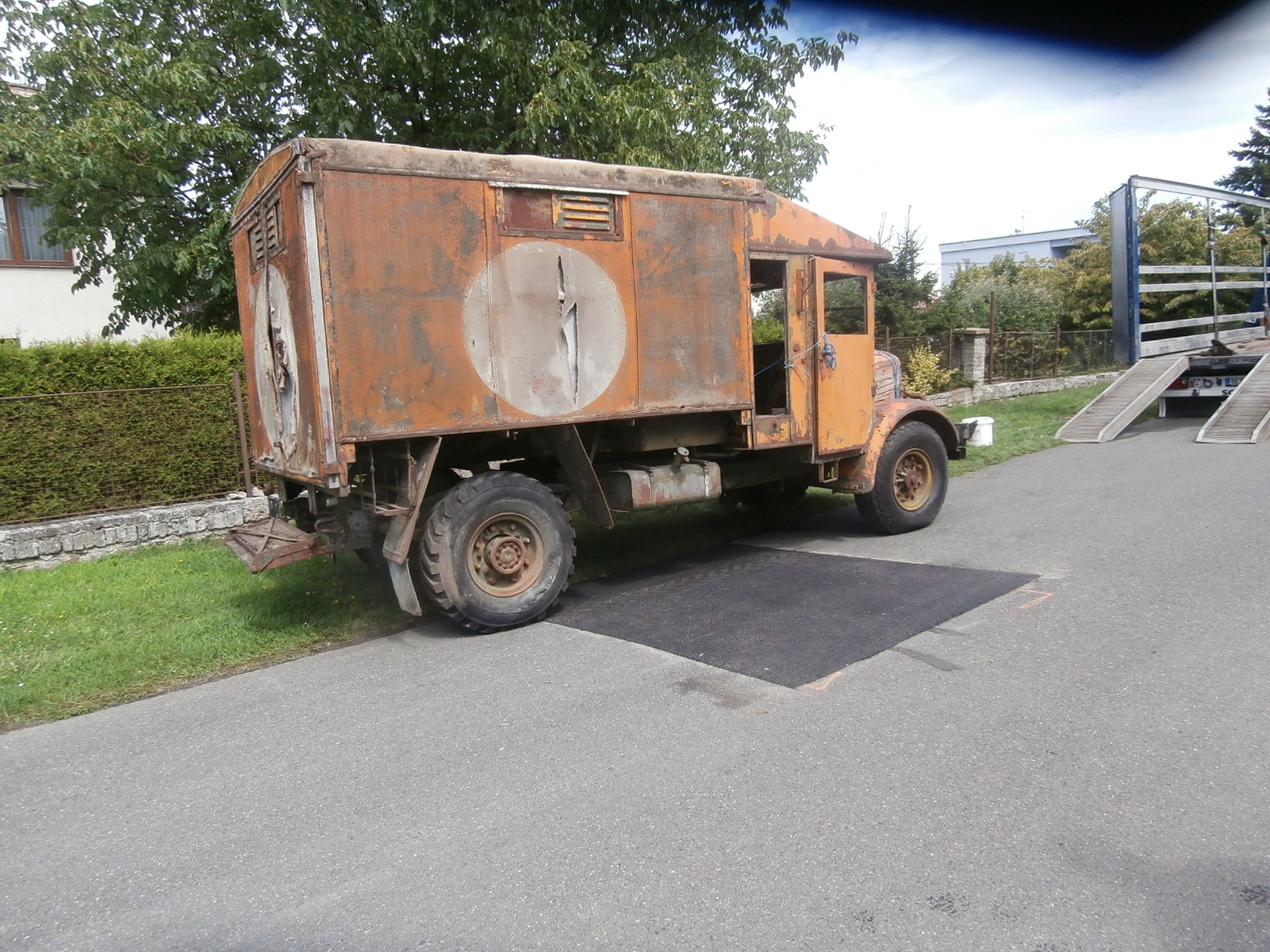

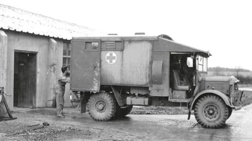

This is just for interest - ambulance bodies being painted, but the canvas hasn’t been stretched/doped yet. Note the sides and the panel on the cab roof.
Also note that the ‘bulge’ for the spare wheel is fitted inside out - seems to have been common when shipping new vehicles to units.

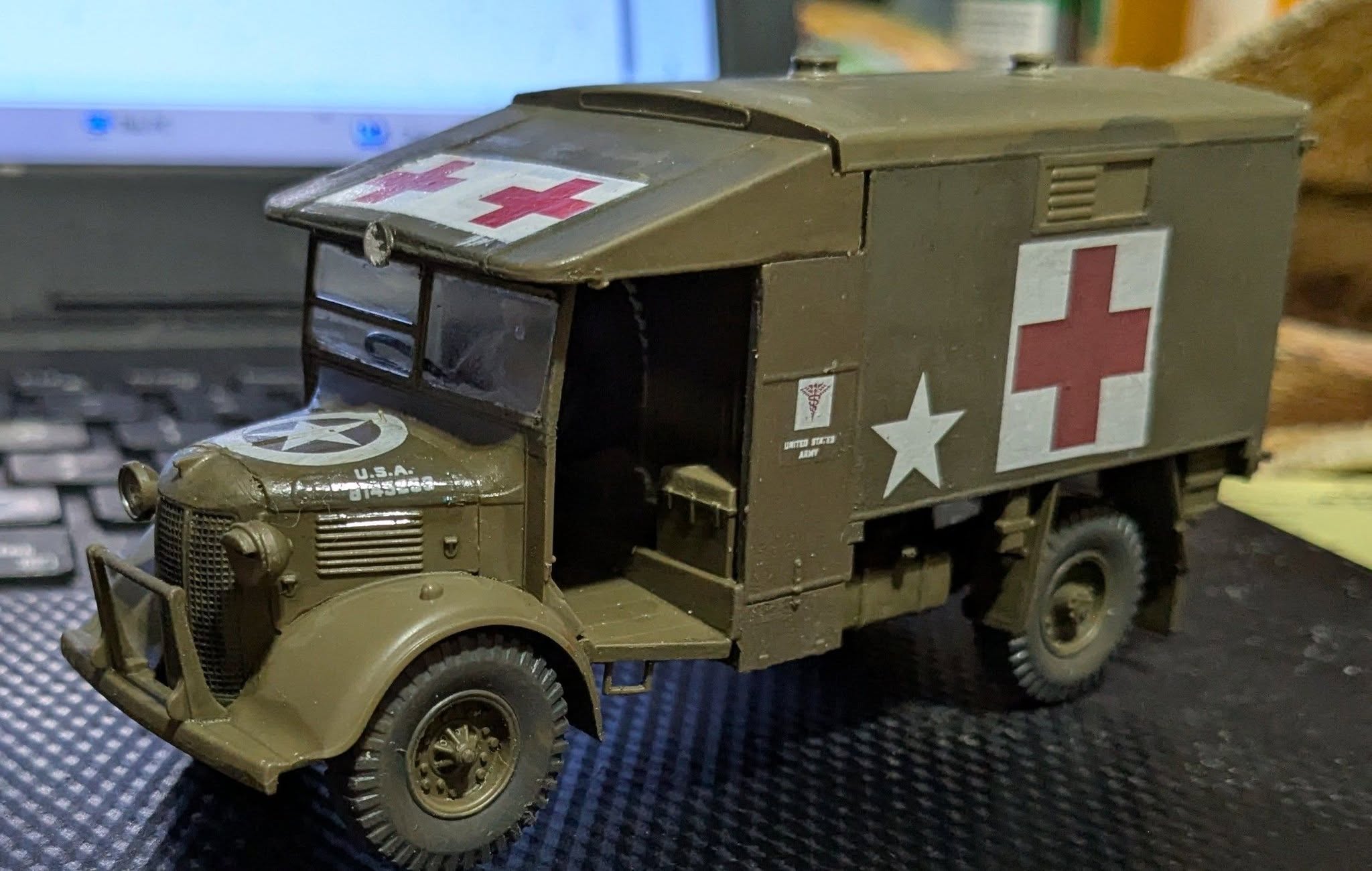

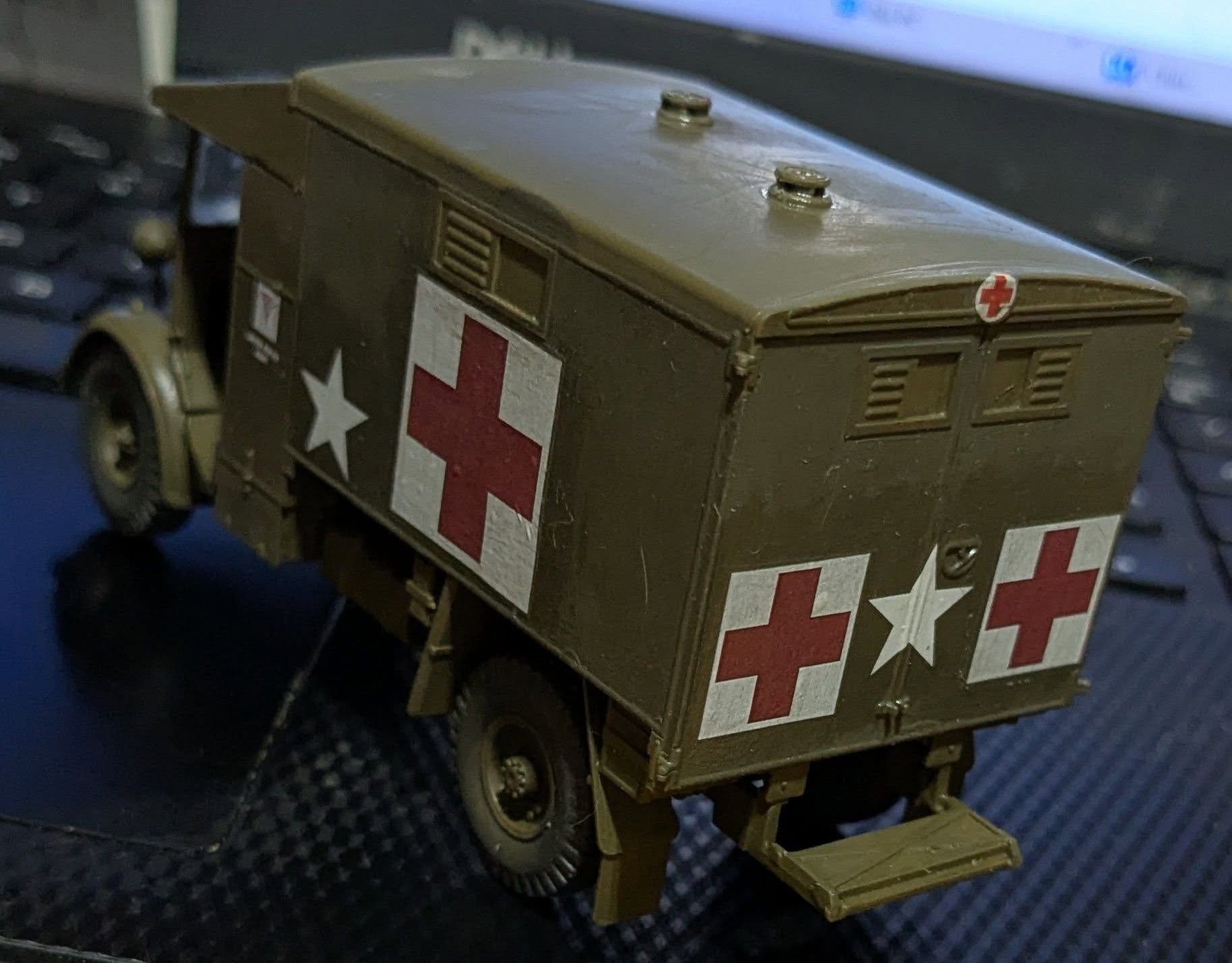

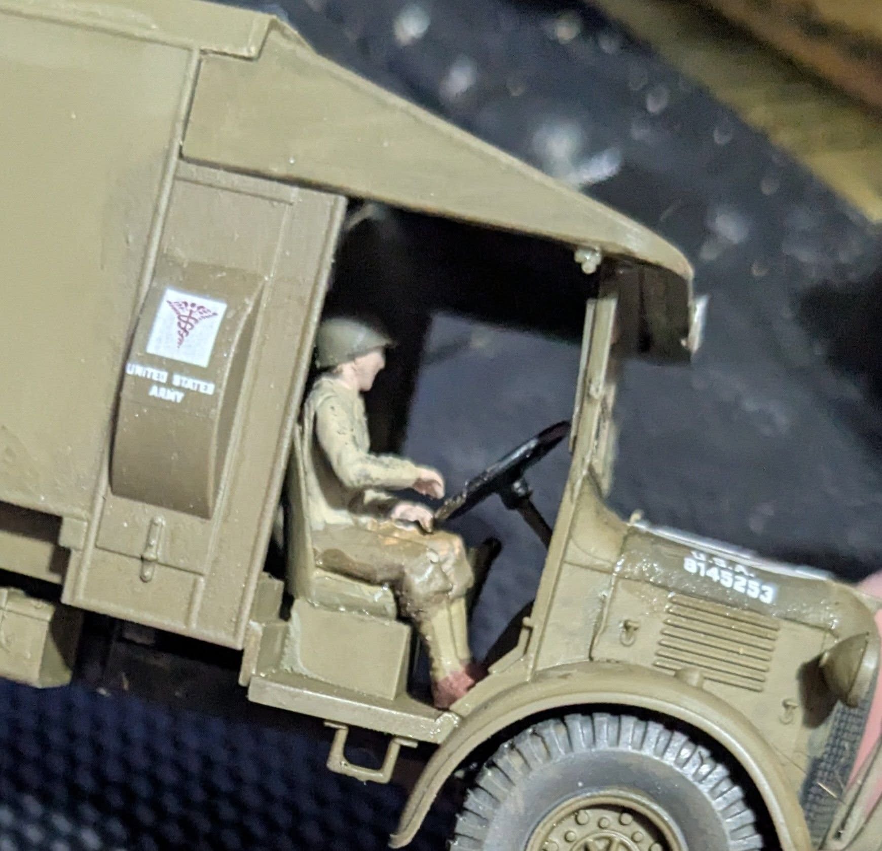

" Also note that the ‘bulge’ for the spare wheel is fitted inside out - seems to have been common when shipping new vehicles to units."… Logical. One of the mods for the Mk.II was smaller bulge. Guess the drivers had issues with hitting things with them. Shipping this way would keep them from being beat to hell on arrival. This edge looks metal. (orange ) Protect canvas where it goes around the edge? Opted for 41 Dark Olive Drab for the “repaint”. Little better contrast with the G-3. No.31/ ANA 319 was too dark. Couple of WIP shots for you. Still need to paint roof.Markings are based on a couple "styles in photos. Added the black out shield on the passenger side head light and US driver.. Somethings bollocksed up and photos wont post.:face_with_symbols_on_mouth:

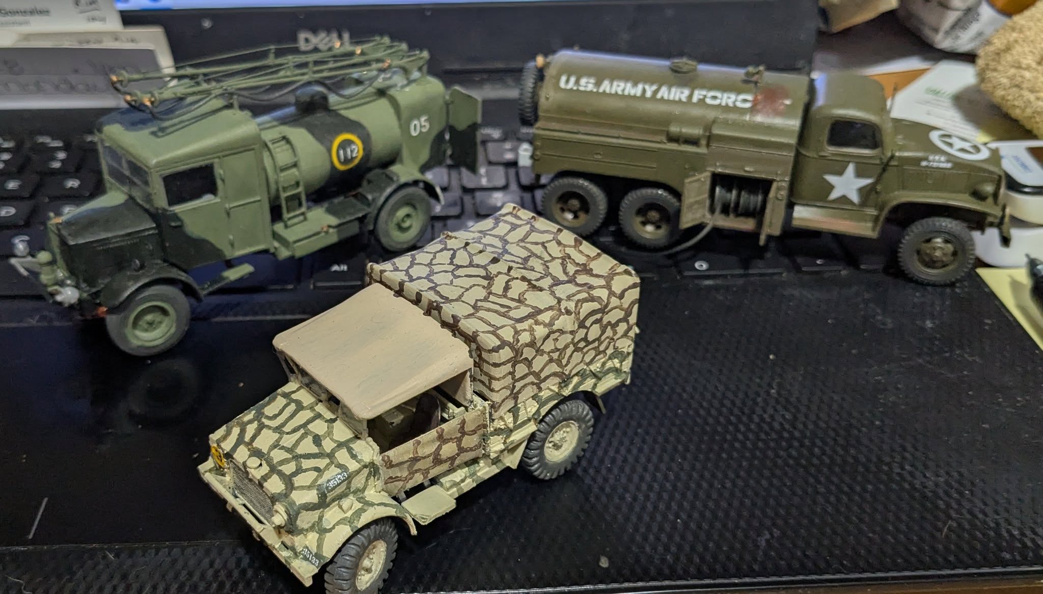

This is Tamiyas 1/48 K2y. Also have Airfix Bedford 15cwt, Albion fueler and Tamiya CCKW 353 tanker WIPs. Have the Tamiya CCKW 353 building as a bomber crew transport. Built Tamiya Kurogame, Hasegawa Isuzu TX-40 (IJA) nd Komatsu G-50 (IJN)

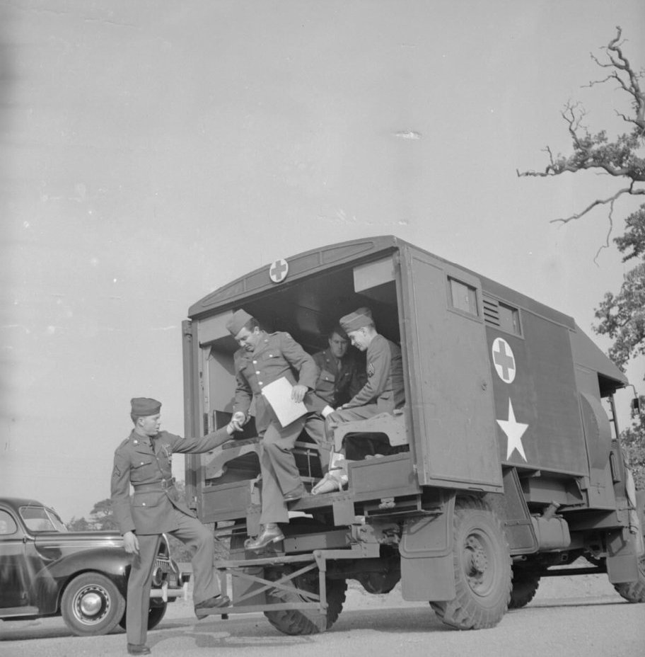

The roof is definitely canvas. There is metal edging along the sides and the end plates are metal.
Looks wierd with cab doors. Post war “upgrade”?
Yes - the doors are post-war.
These ambulances were used for many years post-war.
