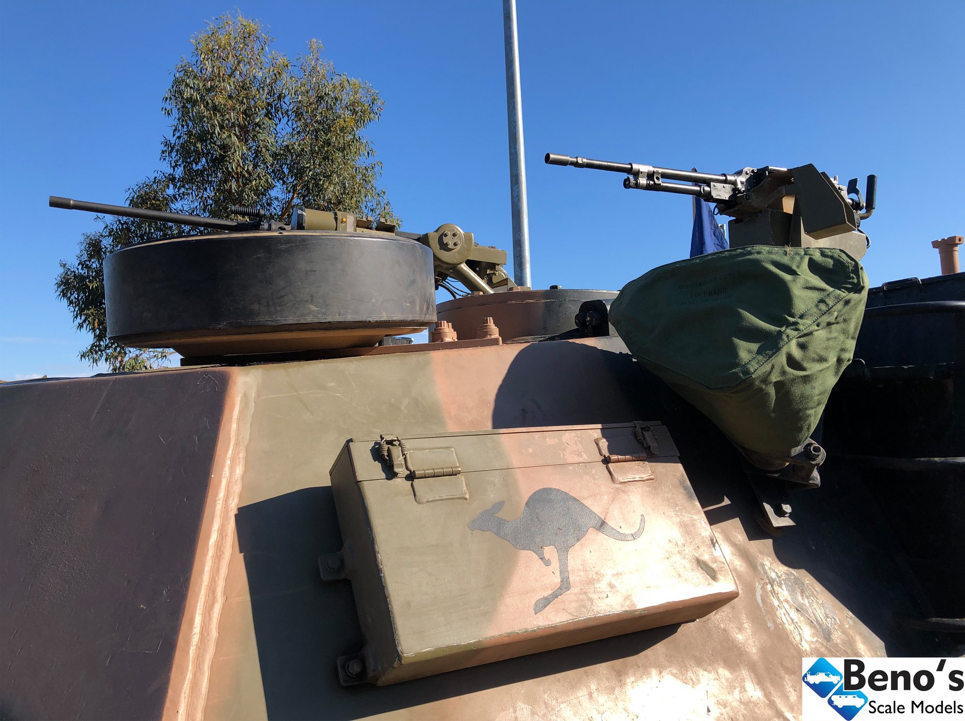

Like these?
Angles not quite right…

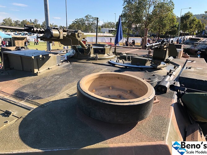

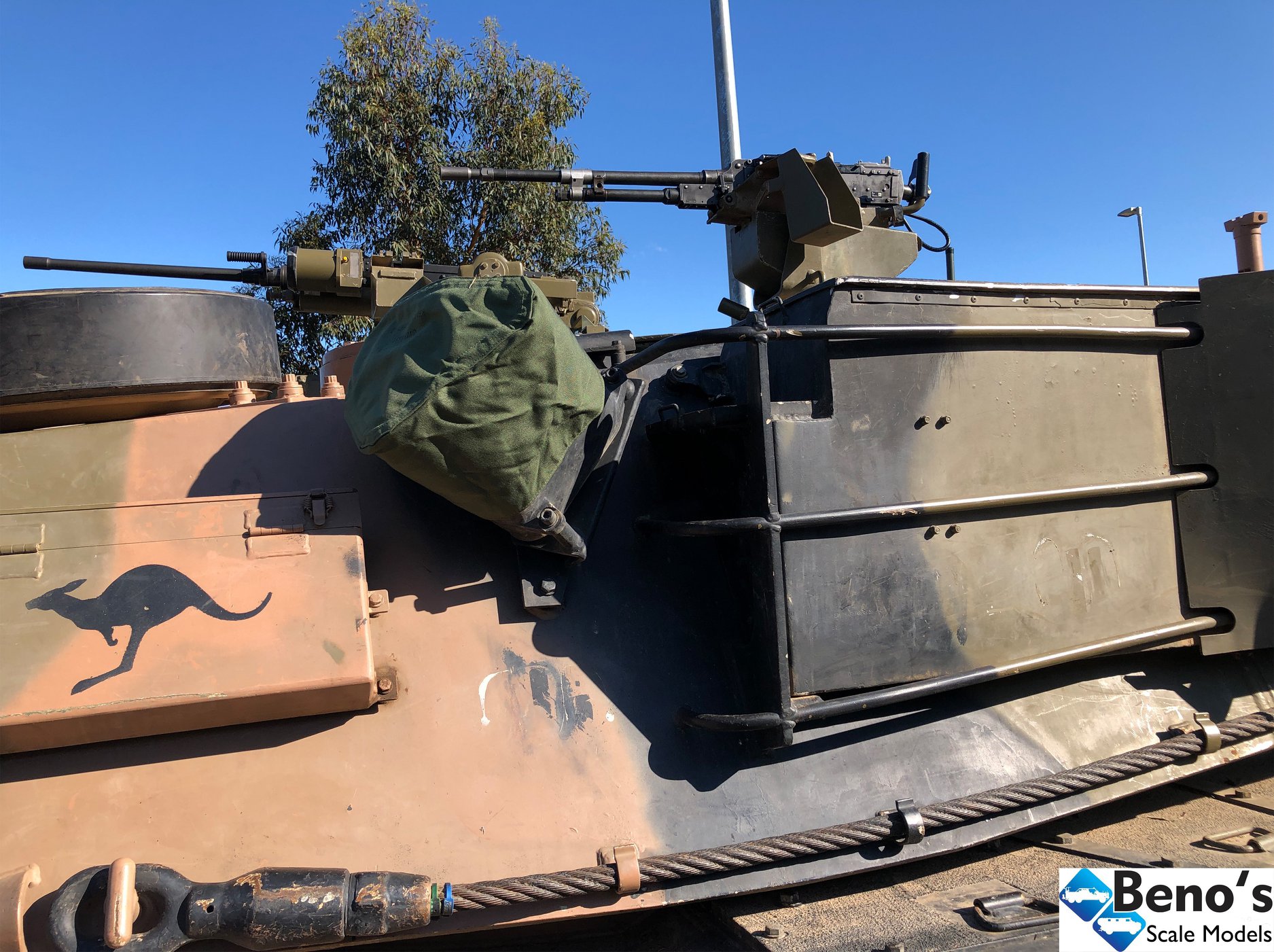

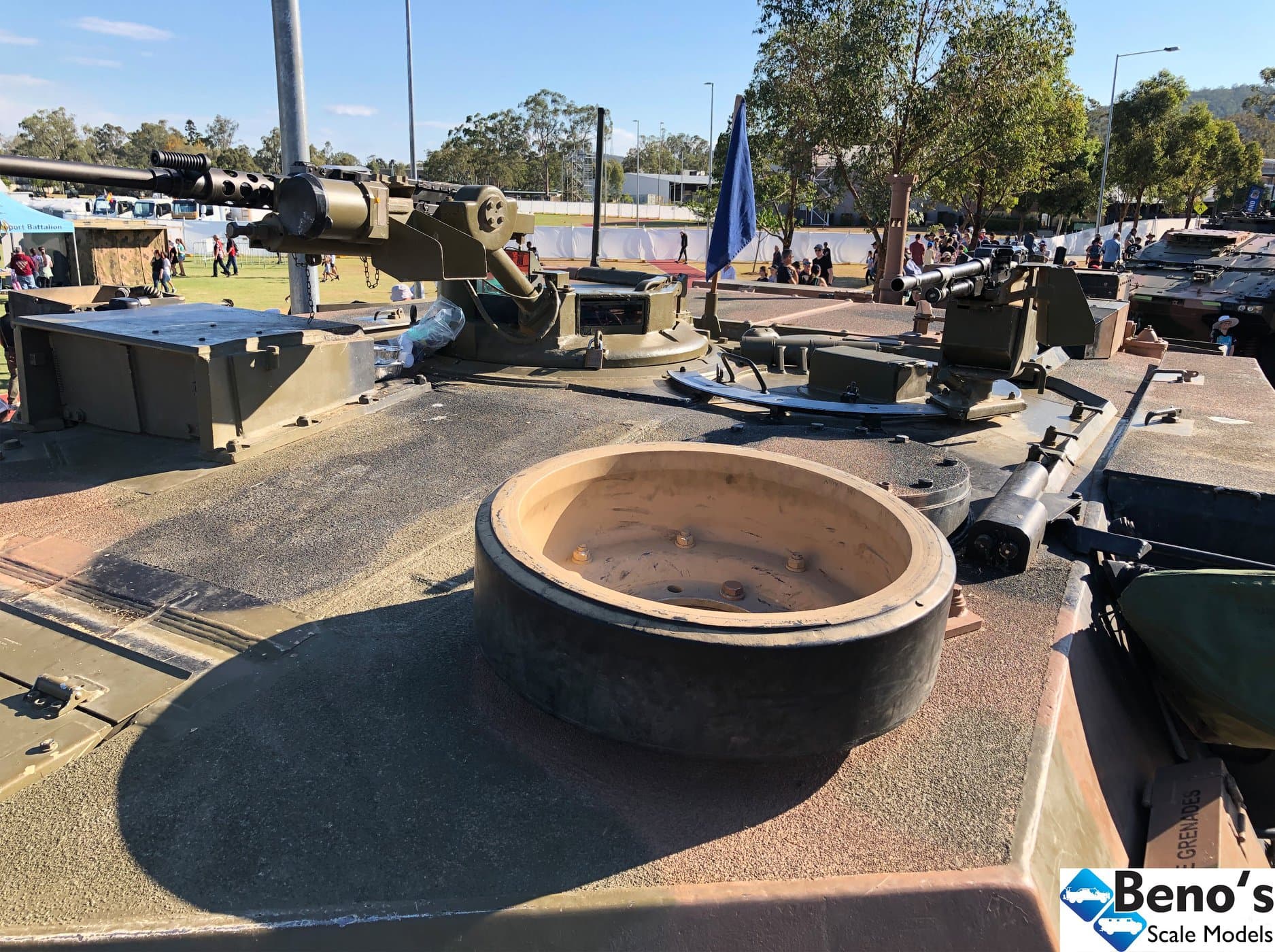

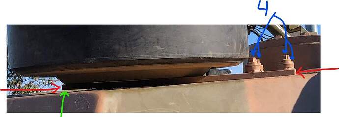

FWIW my spare wheel is just sitting there. Needs to be moved up a bit.

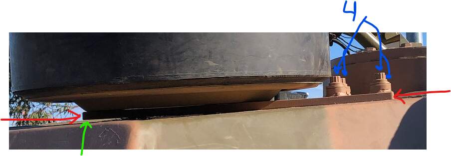

Blue: 4 bolts holding down
Red: frame or plate which
Green: isn’t laying flat against turret roof

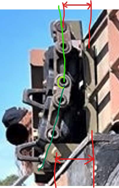

Greens: Angle between links
Red: Lower attachment is further out than the upper, to make room for the
angle between the links

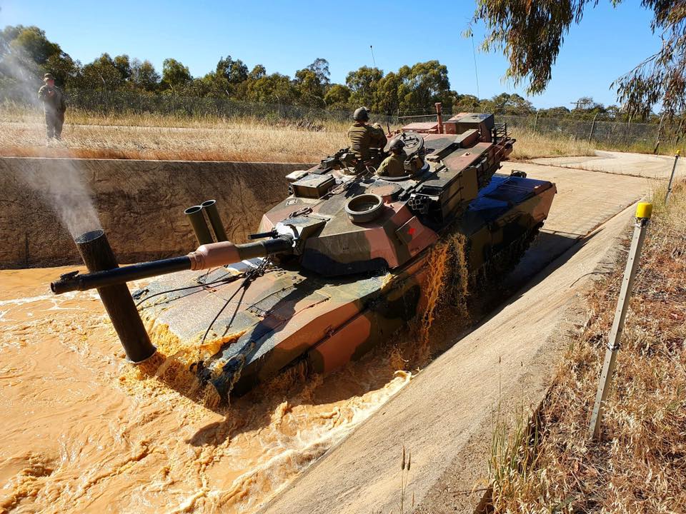

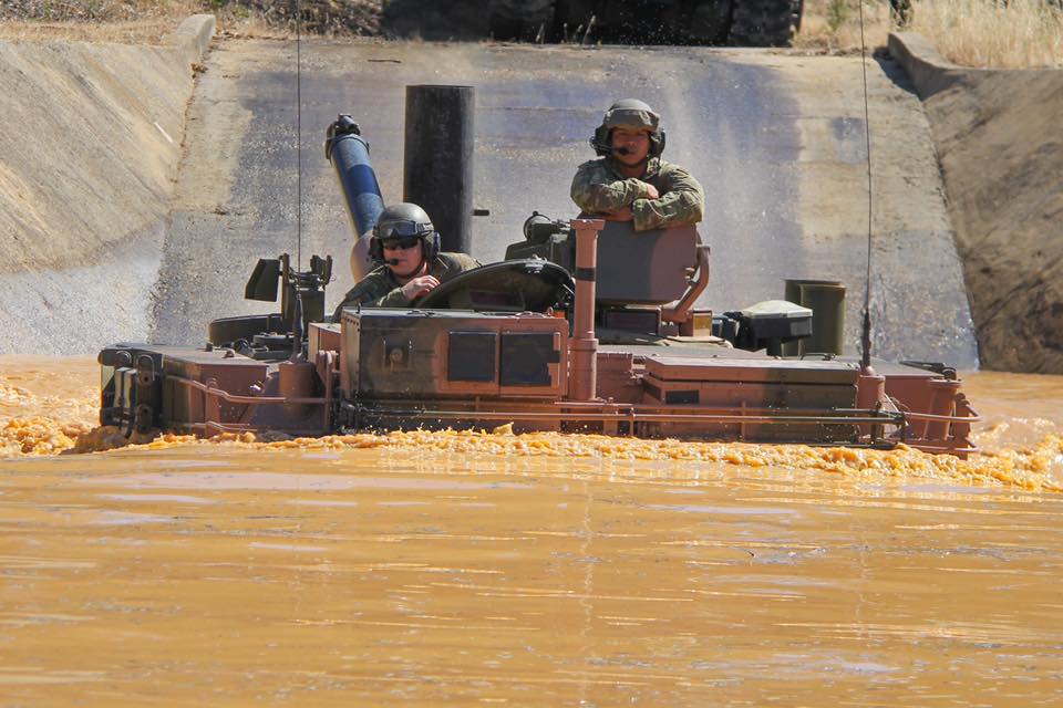

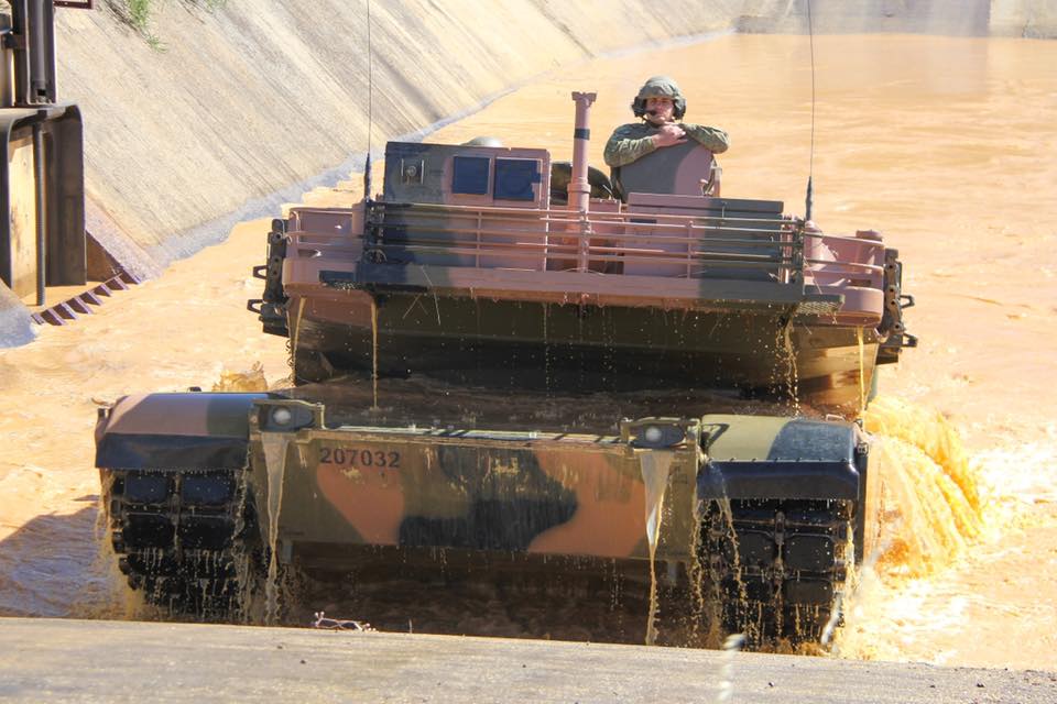

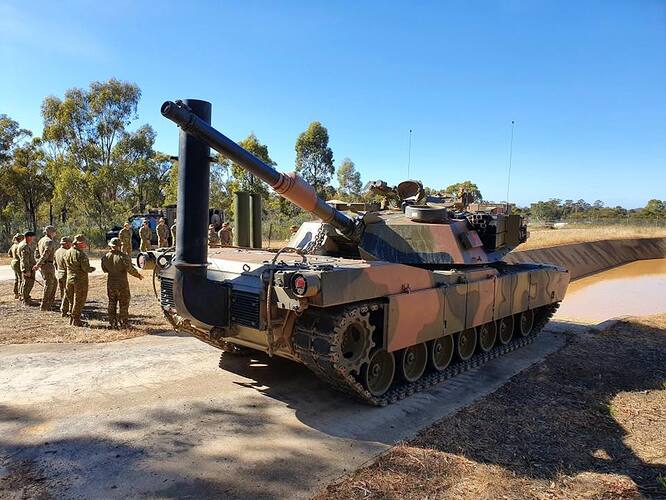

Poor driver. He is either going to get slightly wet to real wet and that inside will never be truly clean until it goes back to Ohio for a rebuild.
That driver is probably praying for tight seals
Even without technical tight seals, you can pressurize the interior but that help is probably lost with bubba hanging out the top.
Not really, the overpressure system is under water, and hopefully was sealed up before hand; so it is not usable.

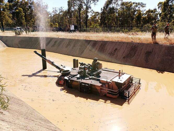

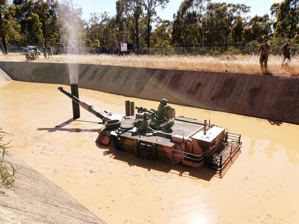

The other photo’s from that sequence
Mal
And the before’s
Mal
They’re aren’t so much worried about keeping the water out but more the crocodiles up north!

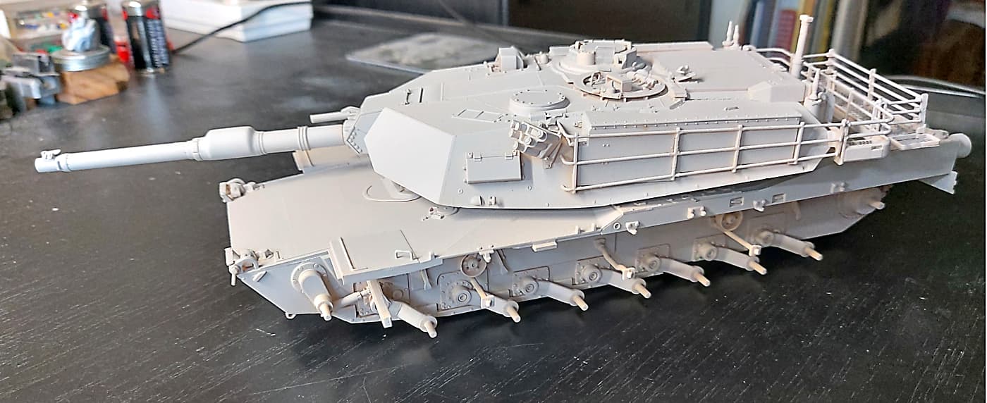

Update.
OK almost done priming. First time I’ve used AK primer. (3rd generation). First impressions of AK primer are very positive. None of the fighting with the air gun like I had with Mig Ammo primers. Yes the AK is thin and takes a LOT of coats to cover. Seems to self level very well. A few places seemed dry and some places I got it too wet. But five minutes later i couldn’t tell which was which. Even then I still have transparent bits and pieces. I’m debating going back over with a few more coats or ignoring them and hitting them with the first colour. Around the suspension I missed but a top coat and dirt may get me out of trouble. Then again I hate a job not done well. No tip drying with the AK primer. Yippee. Clean up was way easier.
Looks good but where is the track guards?
