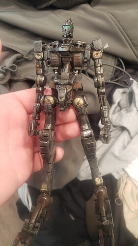

This is the frame of the kit. Base coat of Tamiya gunmetal followed by a sloppy drybrush of chrome silver and gold details. Then added an AK dark brown wash. Tomorrow I will knock of some of the wash and start some home made oil washes.
I made some mods to the armor, but deleted the pics off my phone. I’ll reassemble everything when the frame is done.
Oils on. I only used black and burnt umber. Randomly apllied over a few days.

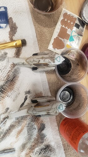

Turquoise from a mig ammo russian cockpit kit. It’s almost perfect.
Also been adding washes and filters trying to get the white to tone down a bit. I tried an orchard yellow filter, but it didn’t work well. So I just drybrushed all the armor with black oil paint and removed/worked it in. Sucks not having a basecoat on. Still can’t airbrush right now.

Remembered to actually buy some clear green today. So chrome silver and clear green on his one eye. Then brown on the pipelines throughout, black oil wash over brown.
