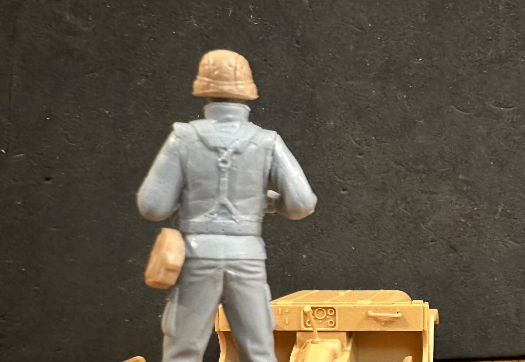

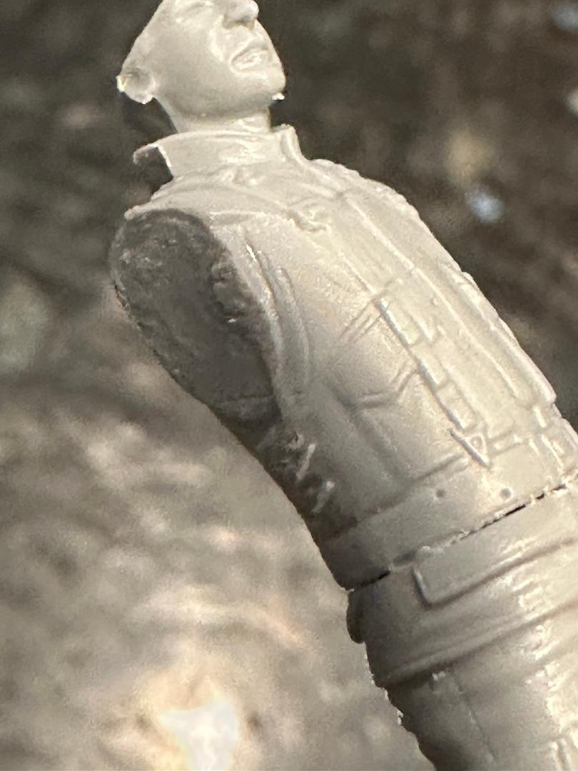

I started adding laces to the flak vests. I’m not sure the juice is worth the squeeze. The arms may cover most of it. Either way it’ll take some dry brushing to even make them noticeable.
I may use sprue to fill the gaps in the torso - I’ll have to see how much gets hidden by kit first.
I eliminated that weird hump underneath his pistol belt. As I suspected, all the work on the flak vest laces is unseen. But overall all I’m digging the direction this one is taking:
The lighting shows where I can do a little more work on the vest.

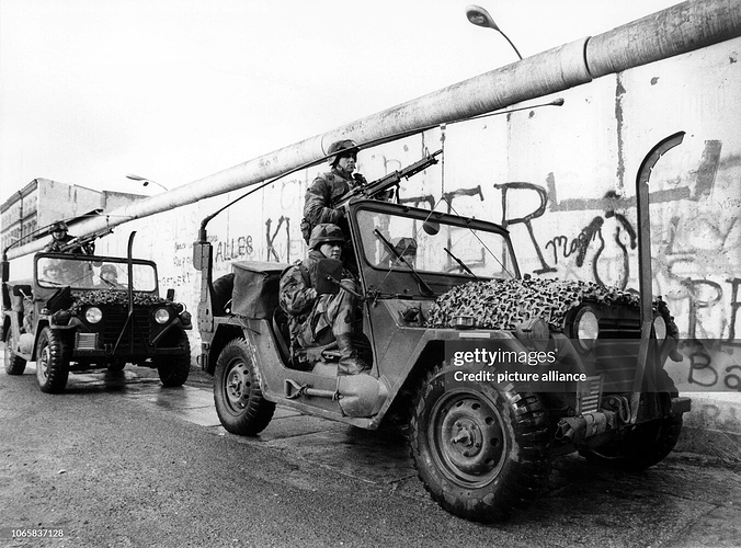

Time to move on to the gun trucks. The best review I’ve seen is that from Vodnik, written back in 2004. That guy is sorely missed in this site. But as good as his review was, he missed some things - one of which is the horrible way the seats are mounted. I’ll tackle those later. I’ve corrected them in the past but you know how it is - skills diminish over time. Another is the pedestal mount for the gun. While in the article he goes about making it better, he neglects to model the two-piece riser that was fairly standard for the pedestals. Anything is better than what you get in the kits, however. But today I’ll start but attempting to show a detail I’ve only seen in his build - and he neglects to tell us in his article it’s actually part of a Verlinden upgrade, which I had never seen until tonight. And that would be the reinforcing ribs seen on the wheel wells in my photo:
You can actually see the back side of these ribs behind the wheels, which you can replicate with half round. But for the inside they’re much harder to reproduce. Verlinden did it with PE plates with the grooves - not a bad solution.

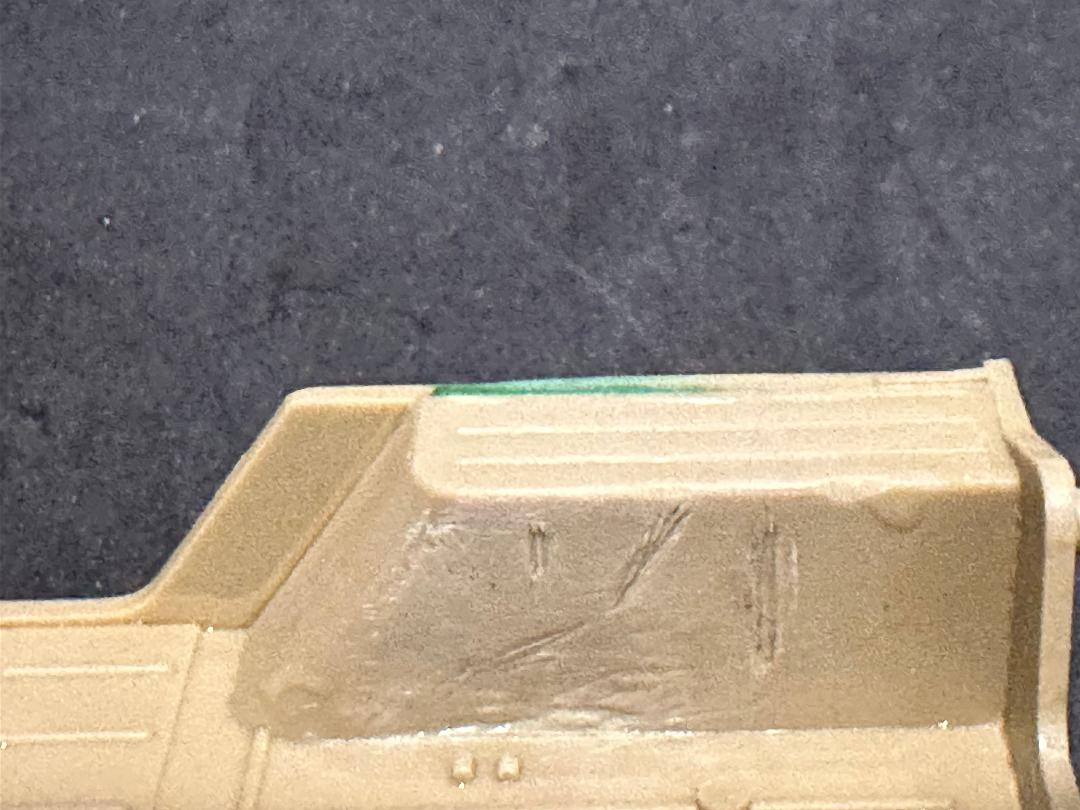

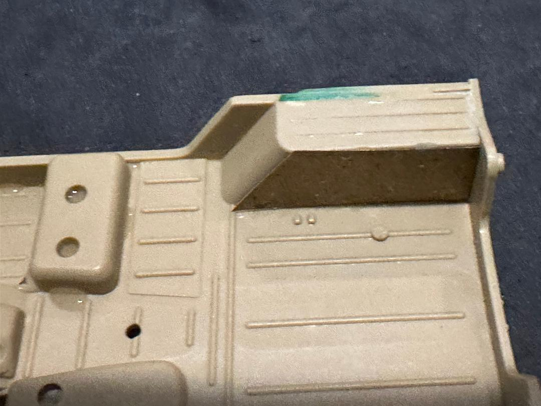

I tried first just seeing how fine I could scoop them out. Not very. You can also see from this photo there’s also a dished out portion in each wheel well toward the front. No kit replicates this. (yet) The dished out portion looks horrible right now, but will smooth out with some creative sanding - I’ve done it before. But I was not happy with the results of the ribs, so it looks like I’ll have to resort to using brass. I can cover up my mistakes with it as well, so I wasn’t too worried.

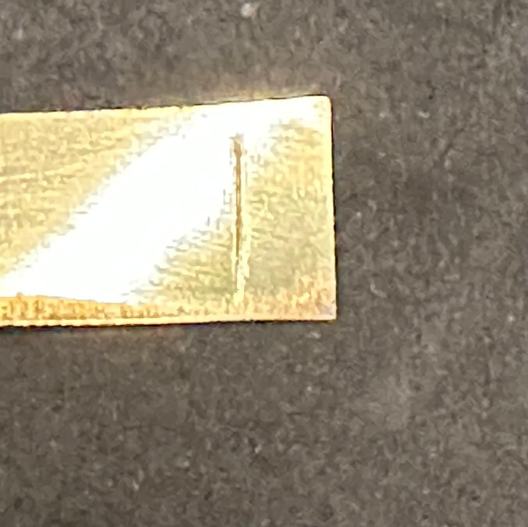

First thing is a paper model template, which I’ve suggested in a few posts over the years. Then you only have to cut the brass once to get the correct size and shape.
The second order of business was making sure I could cut the shallow grooves in the brass. It’s not much, but it’ll show up - I hope.

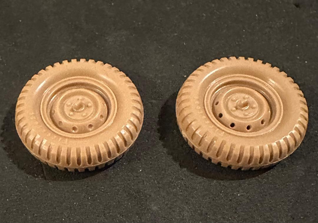

So - all of my M151 builds have featured drill out wheels. The results speak for themselves:

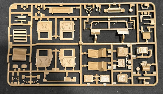

One of the things none of the kits by Academy of Tamiya give you is these larger rectangular mirrors. They were often used on A1s and A2s.
Fortunately the faceted version (as shown) is easy to find - I’ve got at least ten Tamiya HMMWVs languishing on the shelf with the correct mirrors.
