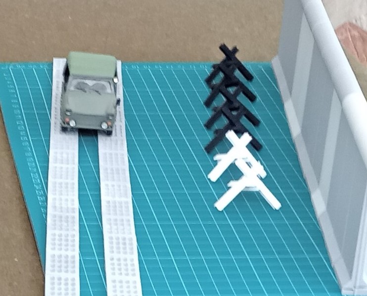

Great minds think alike; I’ve had to compress the distances on my (planned set-up, but based on this pic:
which would also indicate that a wall could be made from readily available stuff, and not have one rely on the AFV Club product, though that is the stock I have.
I originally was going to use Tamiya or others tank obstacles, but a closer look showed that the GDR version was actually quite simple, so I just made my own.

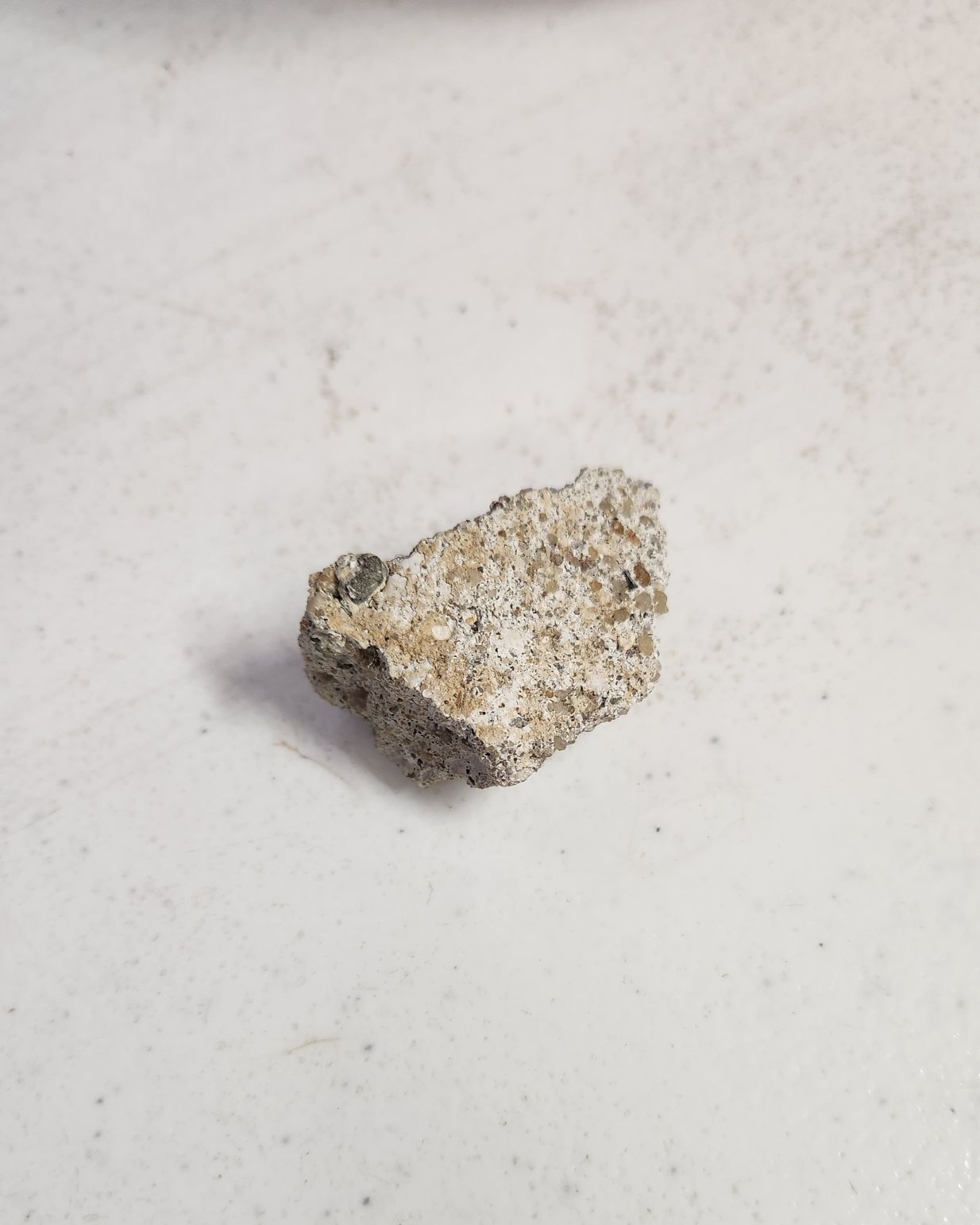

I have a section, but it is probably too small for your purposes.

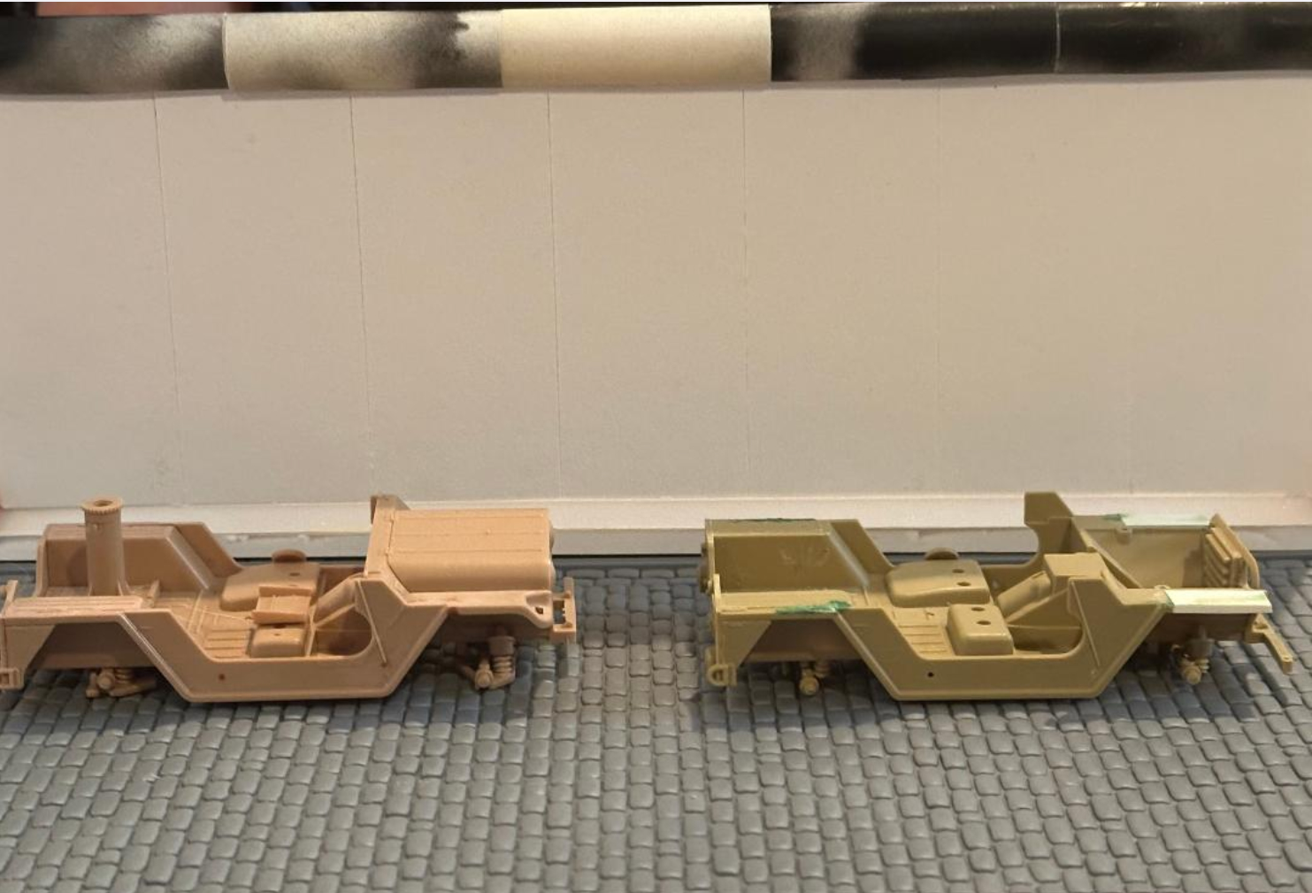

Between chipping two inches of ice of my walkway, doing my reading, and entertaining a Chihuahua, I was actually able to make a little progress today. Eventually I want diorama of M151A1s as well as M151A2s.
I’ll probably make the pipe sections longer.

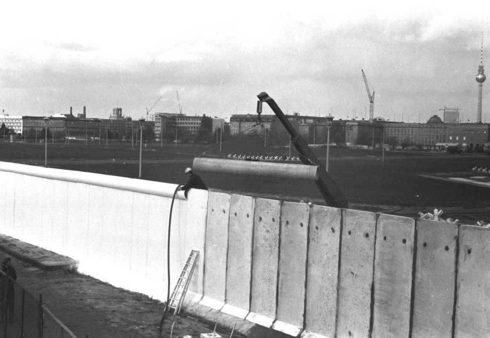

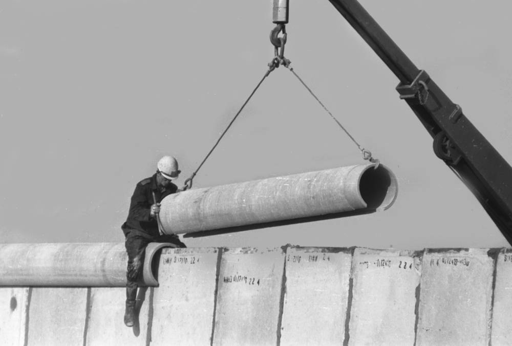

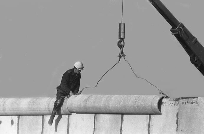

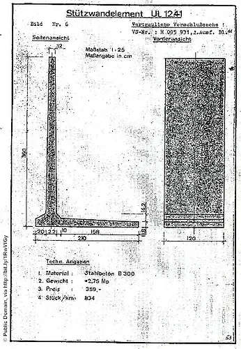

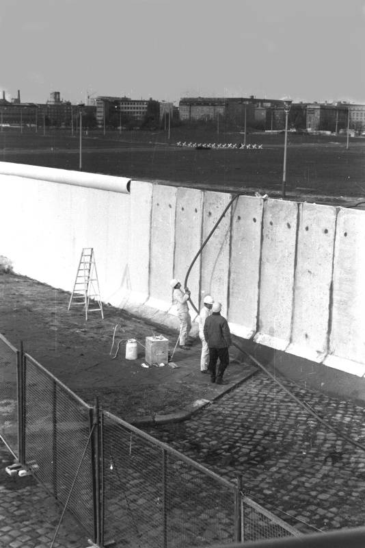

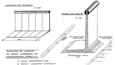

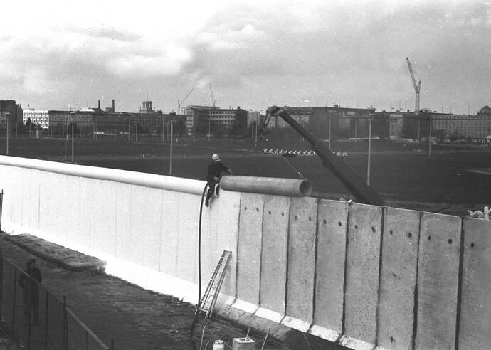

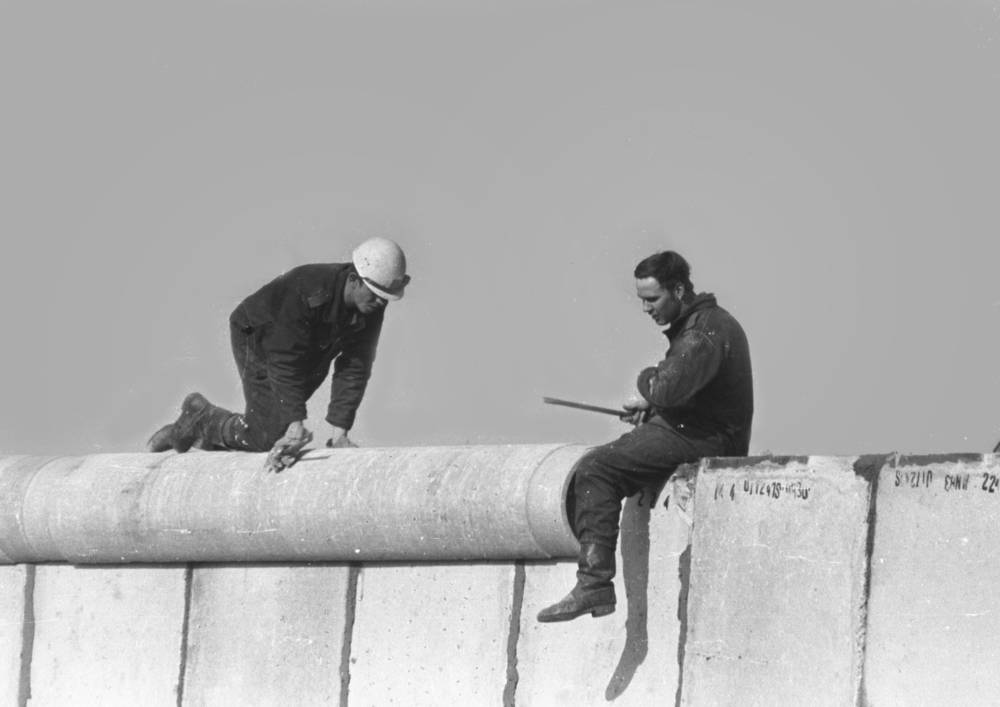

Some Grenzmauer 75 details.
40 cm Rohr?

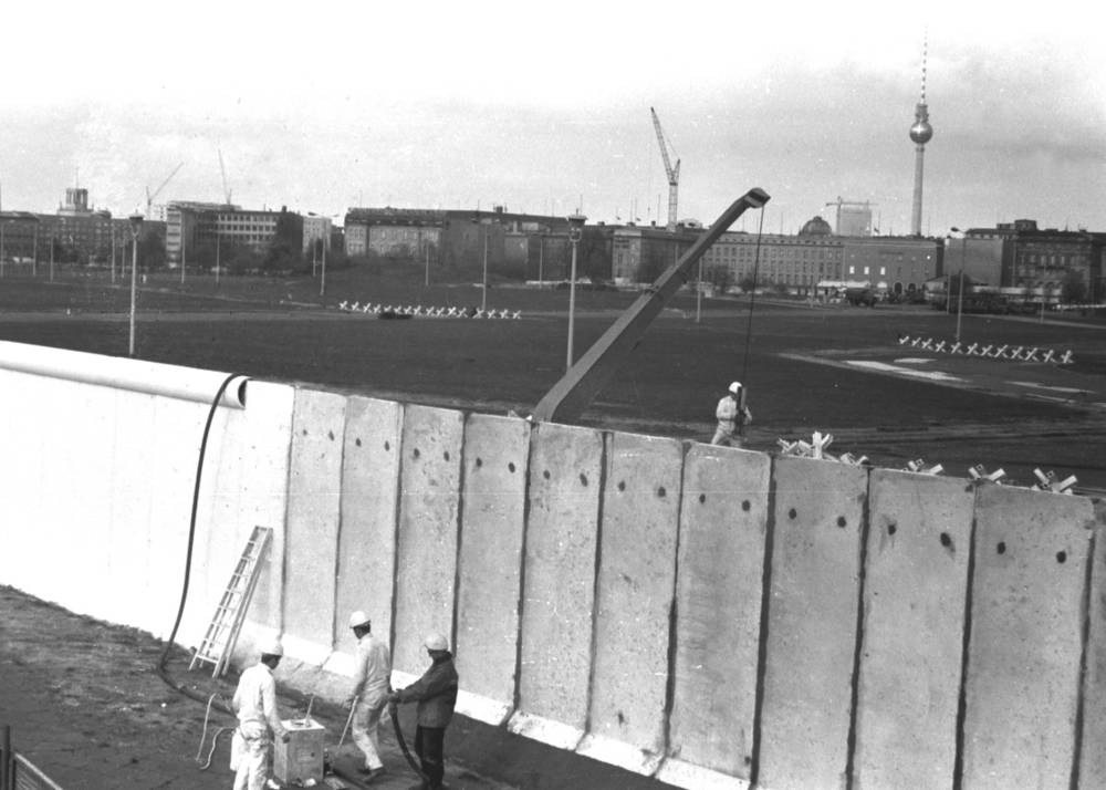

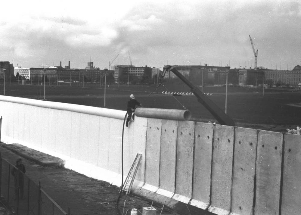

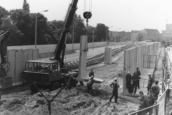

“Die Mauer” im Bau,
Great pics. Although online sources say otherwise, they illustrate the fact that if a Wessie was next to the wall, he was technically in the Eastern zone.
That’s 299,406 Marks per km of wall. Not counting concrete for the foundation and filling in the holes and gaps, or the top pipe. Labor - pretty much free if you wanted to eat…

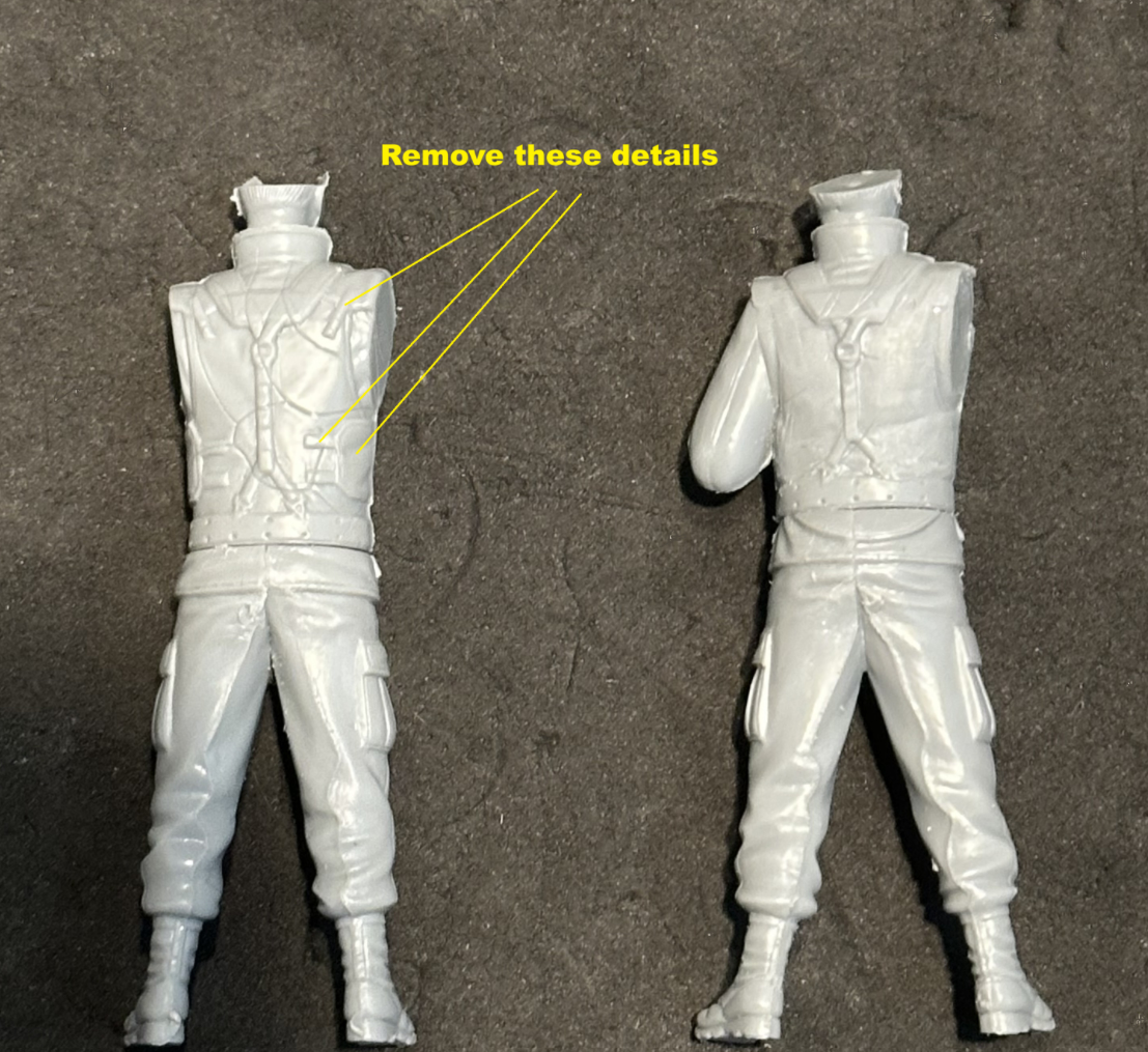

Every Wall Patrol was six pax in two gun trucks. We wore flak vests and a basic combat load. Gunners wore a .45 as well.
I have to make figures with flak vests. Just take a bit of time. I’ll leave the wrinkles in the vest as they really had them. As for the weird cracks you see in the left hand figure, they had to be removed as well.
