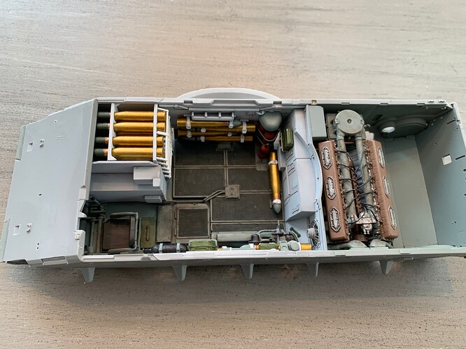

I build a lot of artillery and therefore a lot of ammo. AK Extreme metals has the best brass that you can airbrush. It is an enamel and goes on very nice. They have two shades of brass. I use both for my ammo. For brush painting of brass handwheels and fittings I use Vallego brass and then highlight it with AK True Metals brass wax applied with a cotton swab. That combo works really well for the small bits.
If all I have is either resin or plastic casings, I first paint them with a good acrylic matte black (I prefer Citadel because it leaves a smooth finish), then dip them in Alclad brass and let them drip off excess - don’t brush! Shake the Alclad well first. Repeat to taste!
