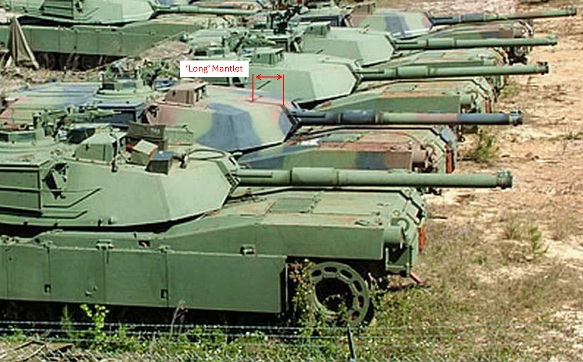

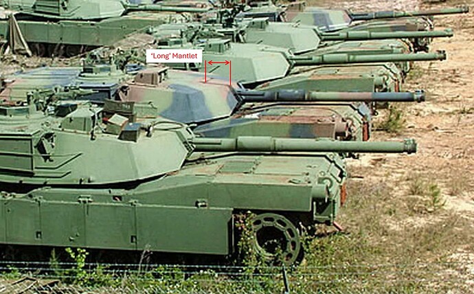

The Panda M1IP has the correct ‘long’ M1A1-style turret but the ‘short’ M1-style mantlet. I would categorize that as a major accuracy error. One reason it gets overlooked is that many M1 drawings - including those in the Hunnicutt book - have the exact same error.
AFAIK every Abrams from the M1IP onwards had the ‘long’ mantlet, making many older M1 kits incorrect.

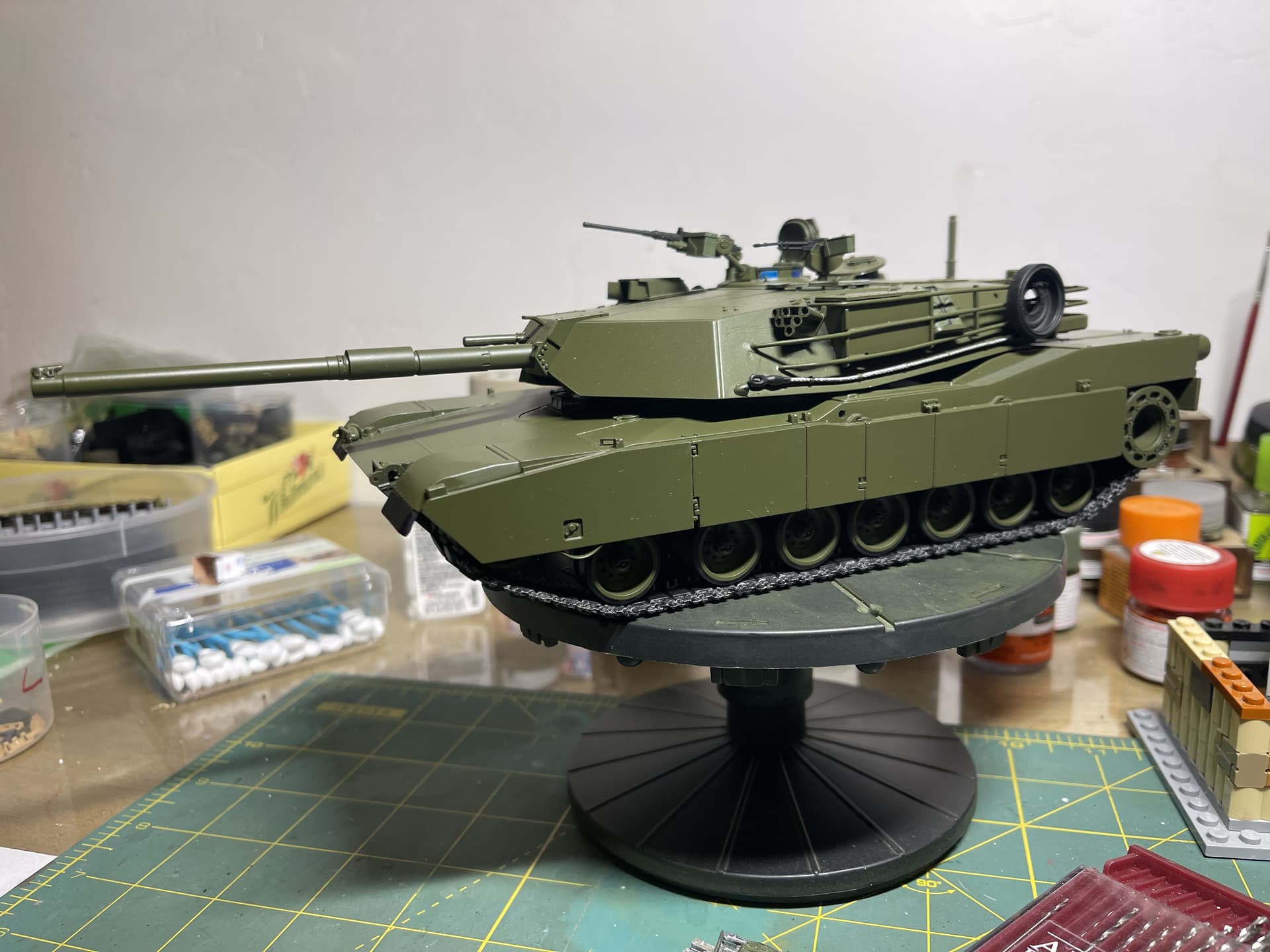

What I personally did was use an M1A1 “long” turret, modified the top blast panels, removed the ring where the CITV was eventually added on the A2, and used the older M1 crosswind sensor.

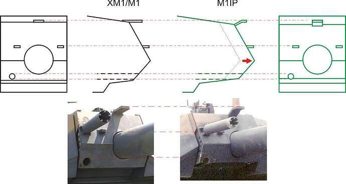

This image , created by Pawel “Vodnik” Krupowicz I believe, illustrates it perfectly . The mantlet is a wedge so extending its length results in a shorter front face and reveals the need for the “goose neck” on the top “tab” to retain the same relative position as well as the opening for the GAS now breaking through the bottom edge.
