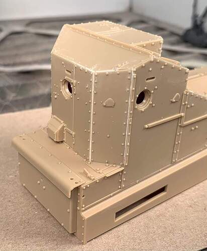

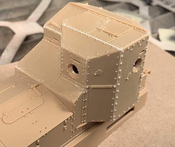

It first start with how large the seam is. This is where sanding and test fitting can fix many of the larger issues. Plastic shims can also help. I would tap off areas close by that you don’t putty to fill. On my Meng Whippet I used Vallejo plastic putty to fill the seams with a moist q-tip to wipe away the excess. It’s not a heavy duty putty so apply last before painting.
