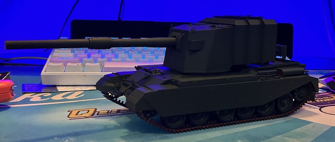

Building complete, tracks on.
Now to do some light weathering.

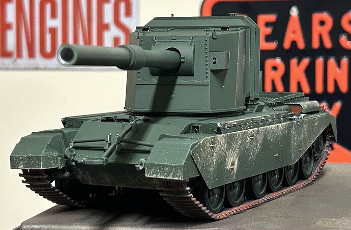

Better pictures and it’s gloss coated
Can’t beat a good Deep Bronze Green - in my opinion(!) 'Looking very smart indeed.

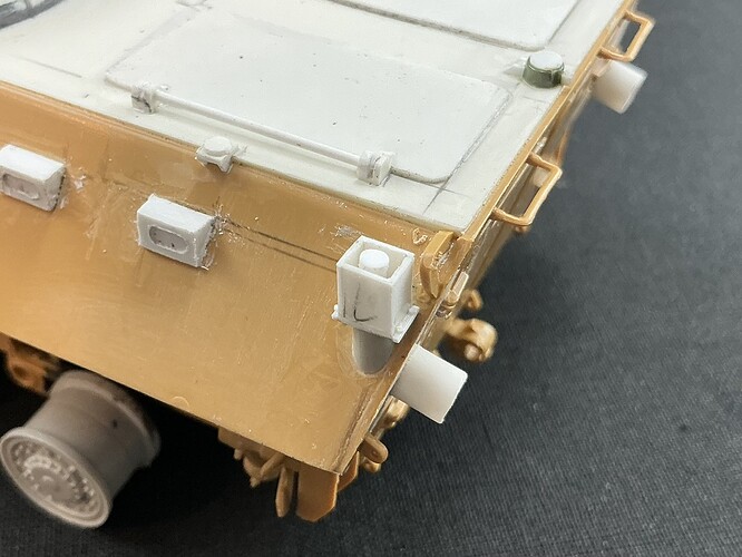

I’ve been using my new tool:
6 mm discs of 0.25 mm plate for the covers over the firing ports, with a much smaller disc on it (made with my RP Tools set) for the hinge — on both sides and the rear. On the sides, their tops are about level with the bottoms of the vision blocks, and all are about 2 mm to the left of the blocks (when viewed). At the back, they are about 6 mm below the tops of the doors and 3 mm from its left edge. On real Piranhas, the hinges can be either at the bottom or at the right, and as you can see, I chose to put them at the bottom because that seems to be the older style.
The ventilator on the roof, between the hatches, was also made with my new tool: first a 4 mm disc of 0.75 mm card as a spacer, with a 6 mm disc of 1.5 mm card on top of that, of which I filed the edges at an angle to make a truncated cone. That I had to do that anyway was a stroke of luck, because I found that the 1.5 mm plate is too thick to punch well with this set — it’s fine if you want a hole in a plate, but not if you want the disc, because its edges will be ragged. That is to say: the two sides were nicely 6 mm and round, but the thickness of the plate between them was ragged and smaller in diameter than the rest of the disc. Anyway, after filing and glueing it in place, I added four bits of 0.88 mm rod around it, because something like that is visible in Trumpeter’s instructions, too.

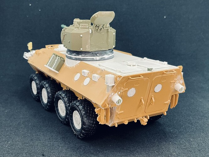

The Piranha’s smoke grenade launchers ended up with a mainly horizontal brushguard with a smaller vertical part :slight_smile:
The mirrors are from the Mowag Piranha 4×4 by Verlinden (that includes four, I think, because I had two of them left) on supports from brass wire and plastic — the trickiest job in all of this model, and now my biggest hope is that they’ll stay on :slight_smile:
After also building a rack on the side for two jerrycans from AFV Club’s YPR kit, I’m done building this thing:
A few things I didn’t mention yet are the tubes for convoy flags on the front corners of the hull (brass tube glued into holes I drilled) and the tail lights (leftover parts from an Airfix 1:76 Churchill and thin plastic rod). I could add a great deal of detail that Italeri left out, but I would need better references than the Tankograd book about the Piranha (tip: leave that in the shop, it’s basically a glorified Mowag advertisement) and, more importantly, much more motivation to actually add all of them :slight_smile:

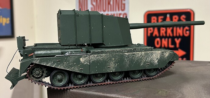

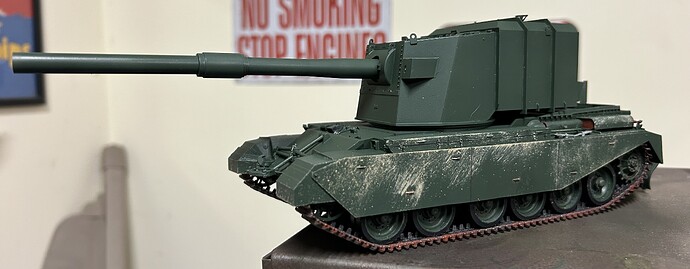

I’m calling this one done.
Pictures of the original test vehicle show no markings on it at all.
I would have added the tow cables but the pictures of the prototype don’t have them.
That looks good - only a little Bovington chalk on the hull.
