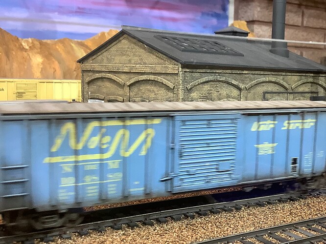

Dave, how did you simulate the mortar between the bricks? Great looking grimy factory. Looks like it has absorbed a lot of soot over the years.
That BN freight looks like it has somewhere to be in a hurry!
Hi Fred,
Thanks, the mortar is the Tamiya Rubber Black undercoat…
I was looking for NATO Black or Flat Black…but 1st jar outta the open paint box was Rubber Black…
I don’t think it would make a difference at any rate…
3 different craft paint colours were used to cover the bricks…brushed on with a worn pig bristle flat brush…then some dirty enamel thinner and a bit of Tamiya panel liner
Running trains at slow speed is relaxing…
The BN is a capture screen from video…like these below
