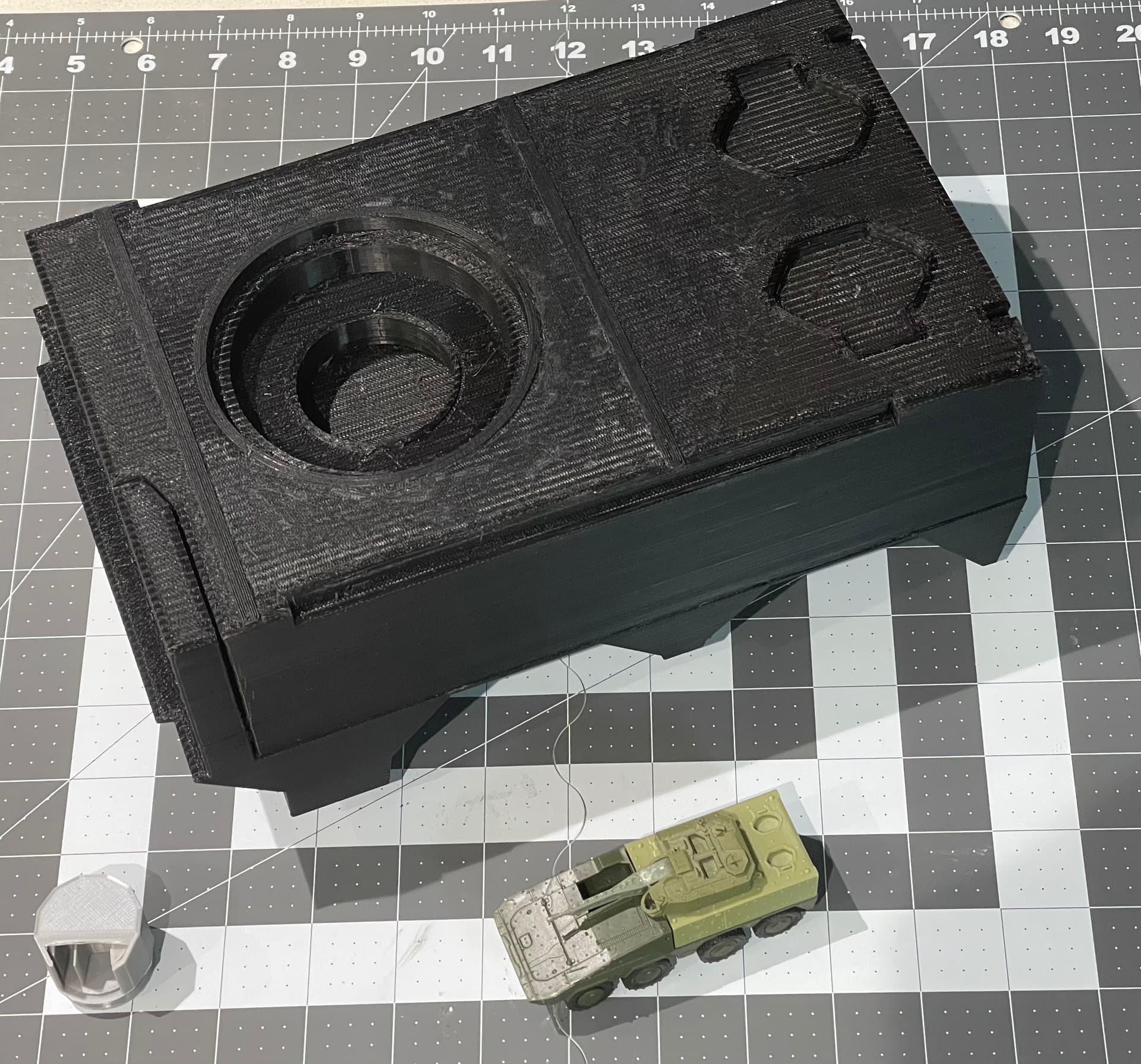

The back end of the Boxer took 340 odd hours. Here it is with minimal cleanup & in company with a 1:87 example.
All of that will be covered by appliqué, so aside from fitting, the quality of the finish isn’t a big deal.

340 hrs = 14 days odd, that’s some serious time. Are outages a big problem if they happen during the print?
Mal
Yeah, it does add up. That’s why I chuckle when people hit me up “can you print one out for me?” They have no idea, I hope, what it is they’re asking.
Here’s the notes from the Bushmaster prints in terms of hours. I stopped recording, but it’s be well over 1,000 hours.
This machine is okay with running out of filament, just reload it, and power outages. Had to deal with both for the first print.
I was familiar with prints taking a couple of days, but 14 surpasses that considerably.
Re the outages, I wondered if that induced a reset, so start again, which would be annoying.
