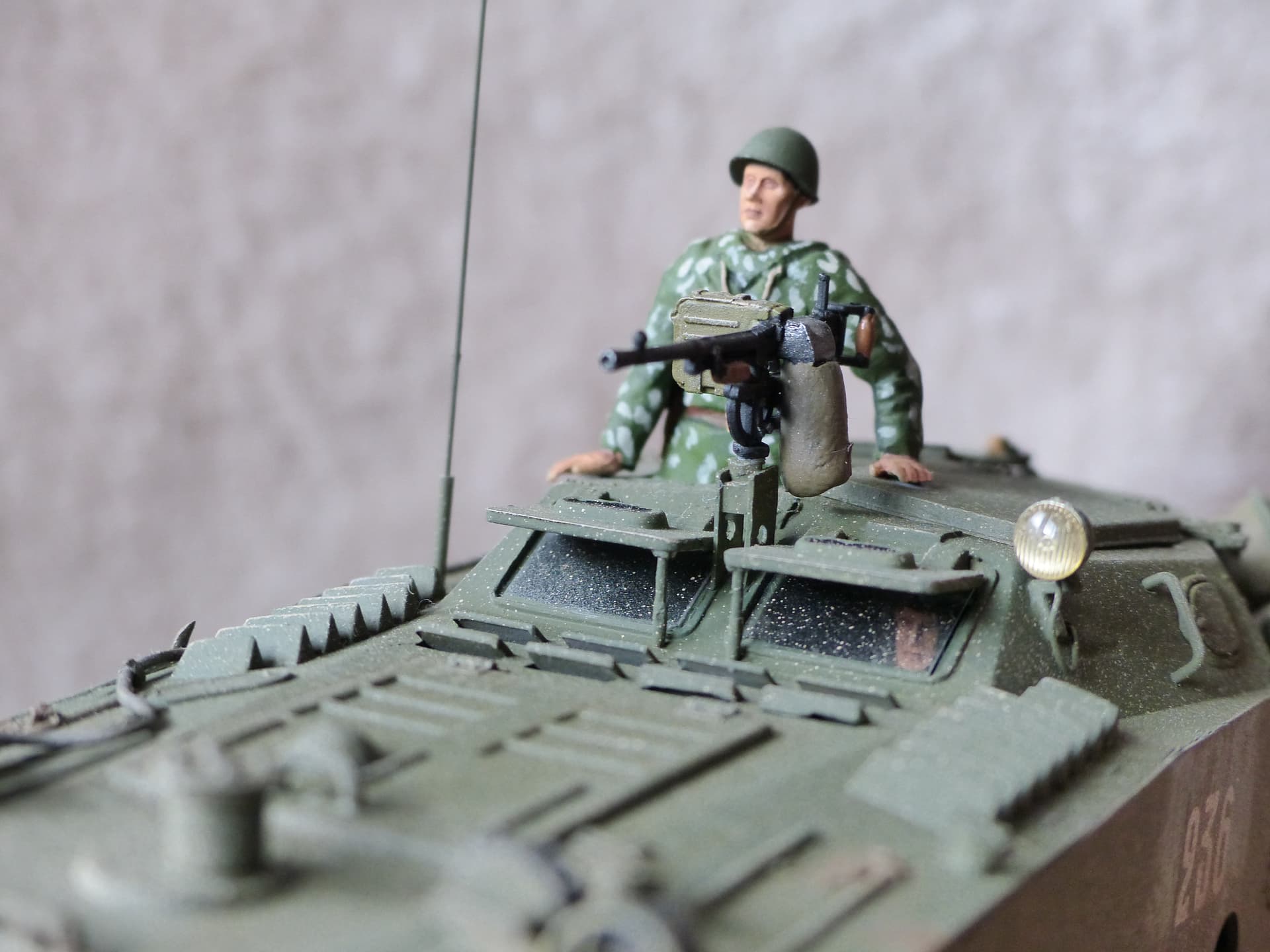

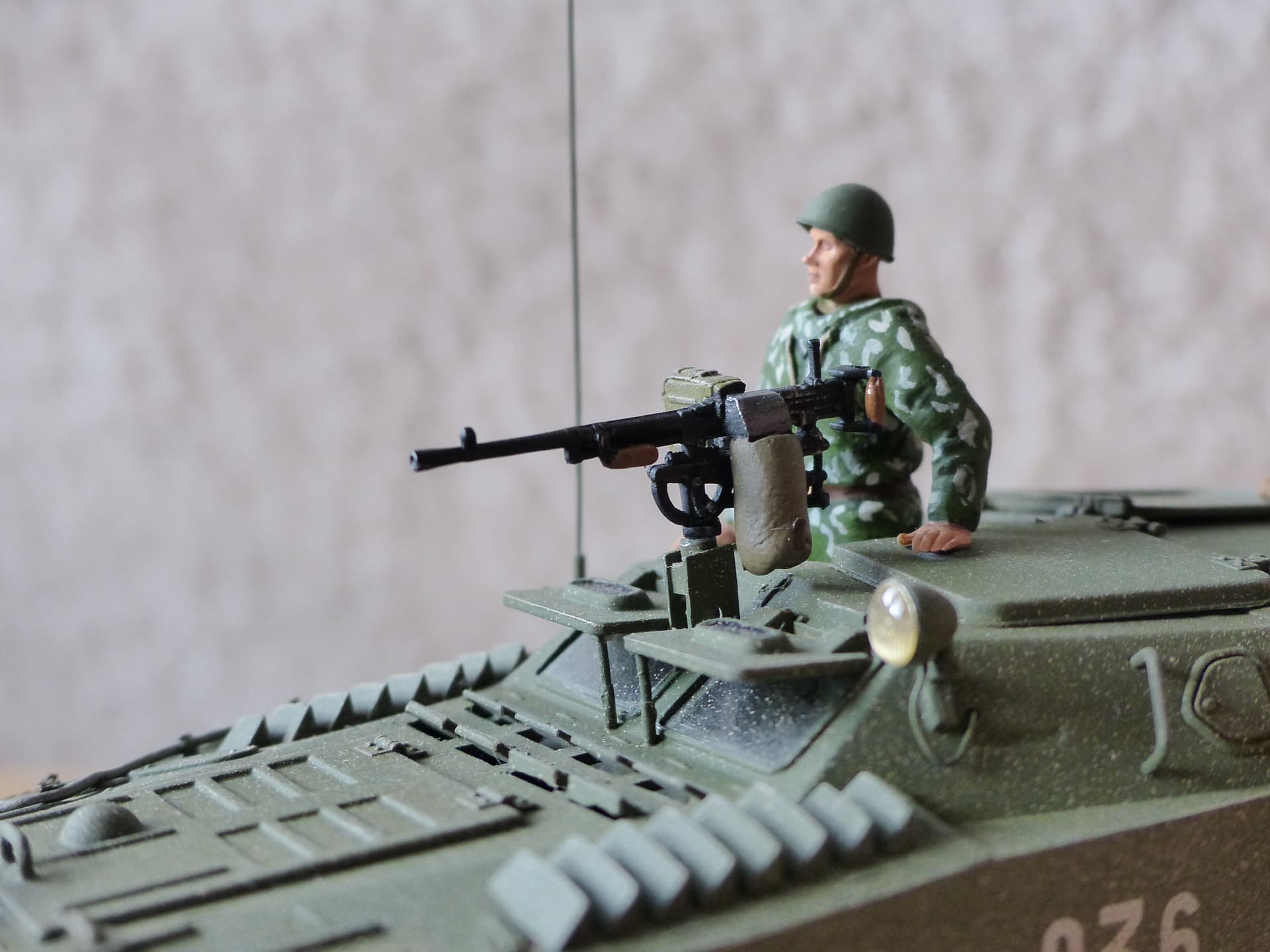

What I did for my model – the same as yours – albeit some time ago, was to fit an SGMB. For that I utilized the MG from this set:
Whilst technically it is an SG-43 – everything you need is there. The set I purchased was quite cheap, and whilst I doubt I will ever use the figures, I felt it was money well spent.
I added a spent-cases bag from Milliput, and the mount from plastic card. I omitted the shoulder stock as my research indicated that they were not always fitted. (I didn’t get the mount quite right but it was some time ago). Anyway, I ended up with an MG-equipped BRDM-1:
'Hope this helps.
