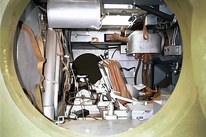

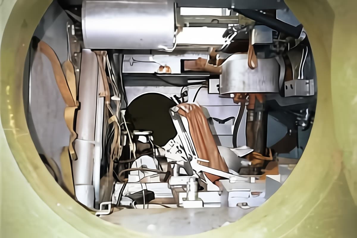

One of the pics mentions silver was the standard color of all British interiors
They were painted silver.
Took me long enough.
unrestored Churchill interior - confirming that they were painted silver on the inside.
I did a lot of research for a Churchill build with a scratch interior. Everything I came across points to aluminum/silver interior
