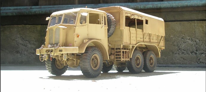

The cardo truck is about done, here are some outdoor pictures ( direct sunlight is the harshest judge of a scale model ) ~
Very nice ! Looks real .
