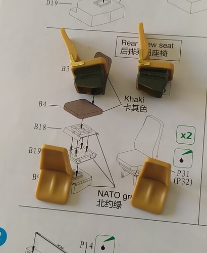

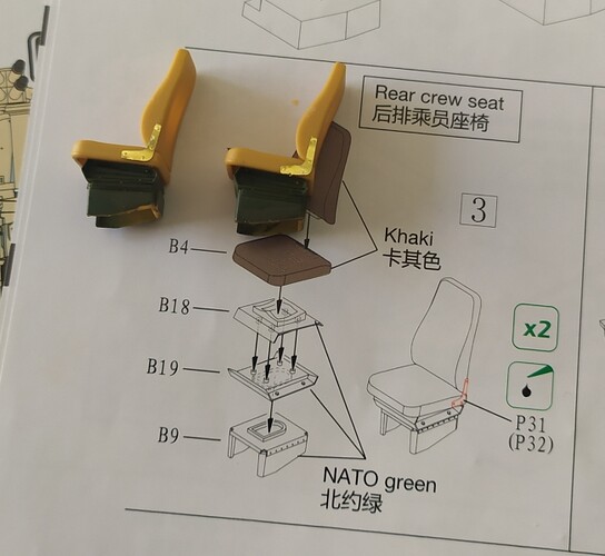

Been working on it for a few months now, Today I worked on the seats.
5871
5874
5873

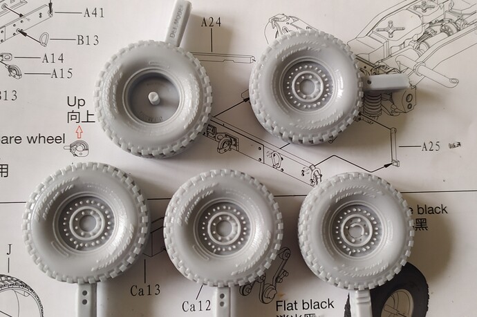

These are the sets I’ve used so far :
IMG_20230803_190625-engine
IMG_20230803_190658-wheels
The engine is quite nice, so are the wheels, but to be honest the kit’s wheels are perfect
the resin ones look good but there isn’t such a huge improvement .

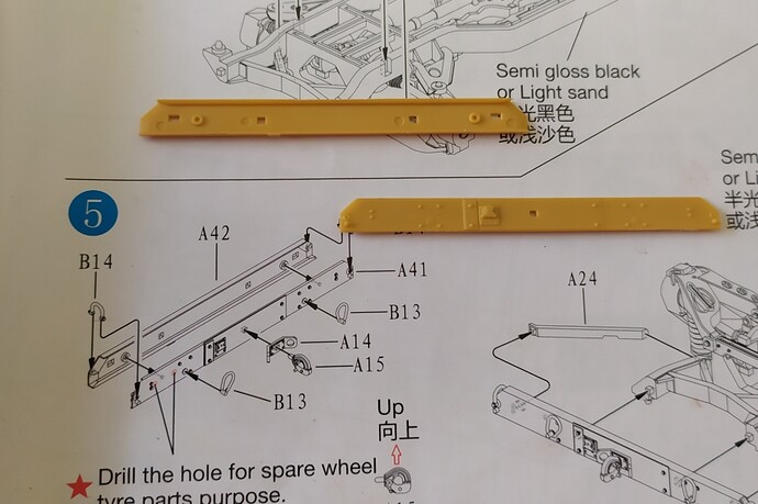

The deflectors under the seats should be black. the correct suspension looks like this. If you want to make corrections in line with the original, I’m here to help.
You’re off to a good start.The resin wheels also have a different bolt pattern than the kit wheels.

Yup; the M1114 Uparmored Humvees had the 12-bolt pattern wheels, while the newer ECV Humvees have the 24-bolt pattern rims. The older M998s had 8-bolt pattern wheels for further annoyance. Doesn’t matter much, since both rims fit all the vsariants of the Humvee.
Cool subject matter and choice of model. I have couple off these in my collection waiting to build. I think the resin wheels give that bulge look which fully loaded hmmwv needs but I have seen OOTB builds that look pretty awesome. Too bad, there isn’t a 1/16 kit of this of this. Perhaps, things might change in future since we are starting to see all new 1/16 kits.

The seats of the kit have a bit strange shape. Why 2 recessed areas with a peak in the middle ?
They should be flat.
Meat-eaters won’t fit anyway. Just remove the cushions and scratch build the frames:
