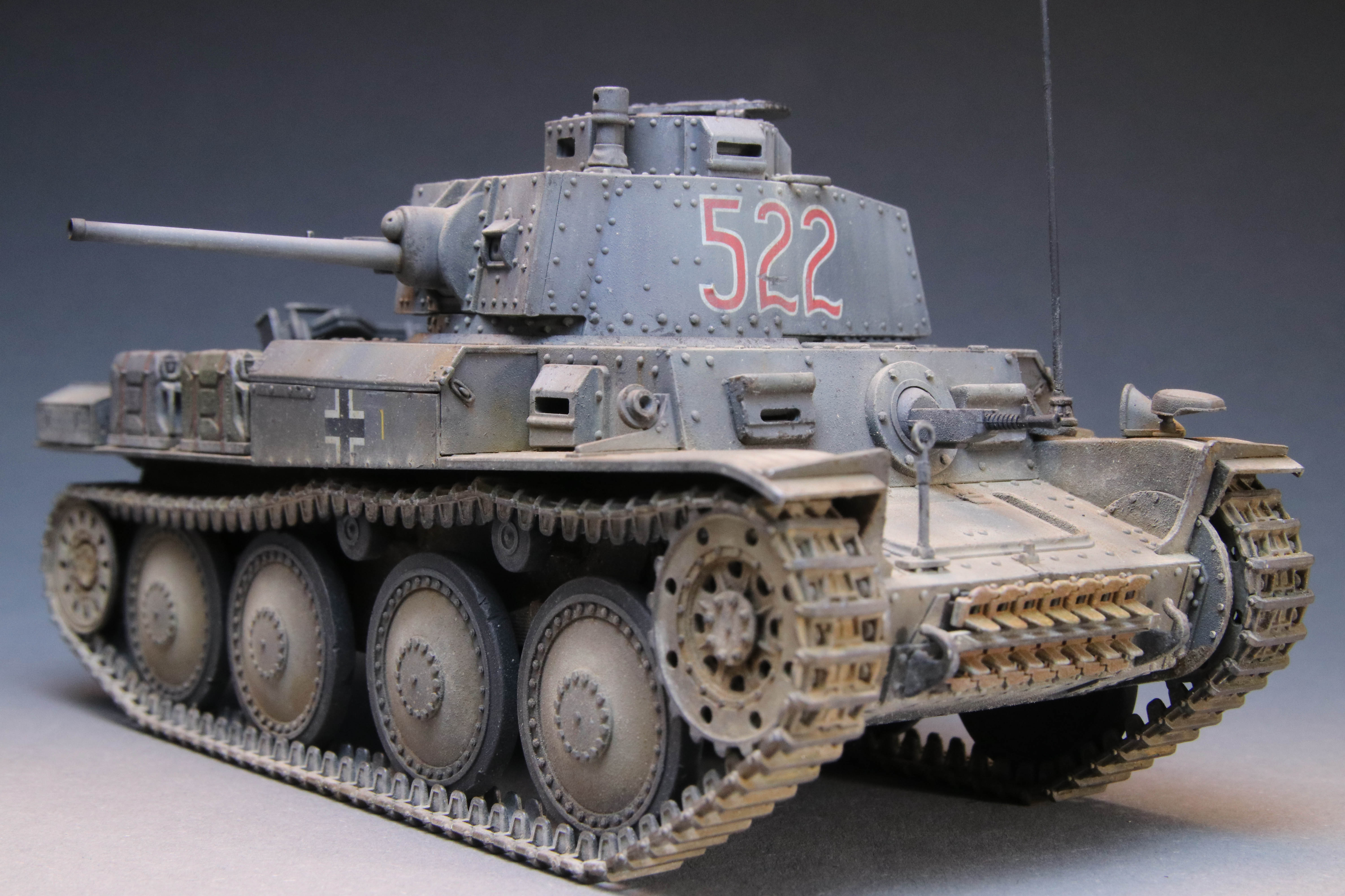

Hey Ken, I was wondering if you can post on what you used for the muffler finish.
Sure Petro, I have a rather unique way of finishing my mufflers. I first apply the Tamiya putty and extra thin cement mixture and stipple it on to give the exhaust some texture. This is followed by a light coat of brown spray paint from a rattle can, any brown paint is fine. I then stipple on various rust colored powders dry followed by a spritz (what’s a spritz? Lol! not a full coat but like a mist coat) of Testors DullCote. Here’s where the magic happens…Lol…Right after the spritz of DullCoat, and before it dries, I dip it into Isopropyl alcohol and let it air dry. The alcohol reacts with the DullCote and a nice white residue is created. If you don’t get the look you want just do it again with powders, DullCote and alcohol dip. The white residue simulates the look of metal that gets really hot like exhaust systems.
Thanks Sir. Too late to try on my PZ IIIa, at least the dip part.
Nice mixture. I have tried blue wash for german grey but Your colour looks better
Very nice!..I haven’t tried a blue filter on german grey but your work here looks great.
Right Petro, hard to dip with the exhausts attached to the vehicle! lol.
For the dullcote, i am assuming a laquer finish, not acrylic?
i ask because Testors Dullcote is what i think of with that term. I have both laquer and acrylic types i can use to try it out.
Right, the combination of the lacquer and the alcohol is what reacts to create the white residue.
