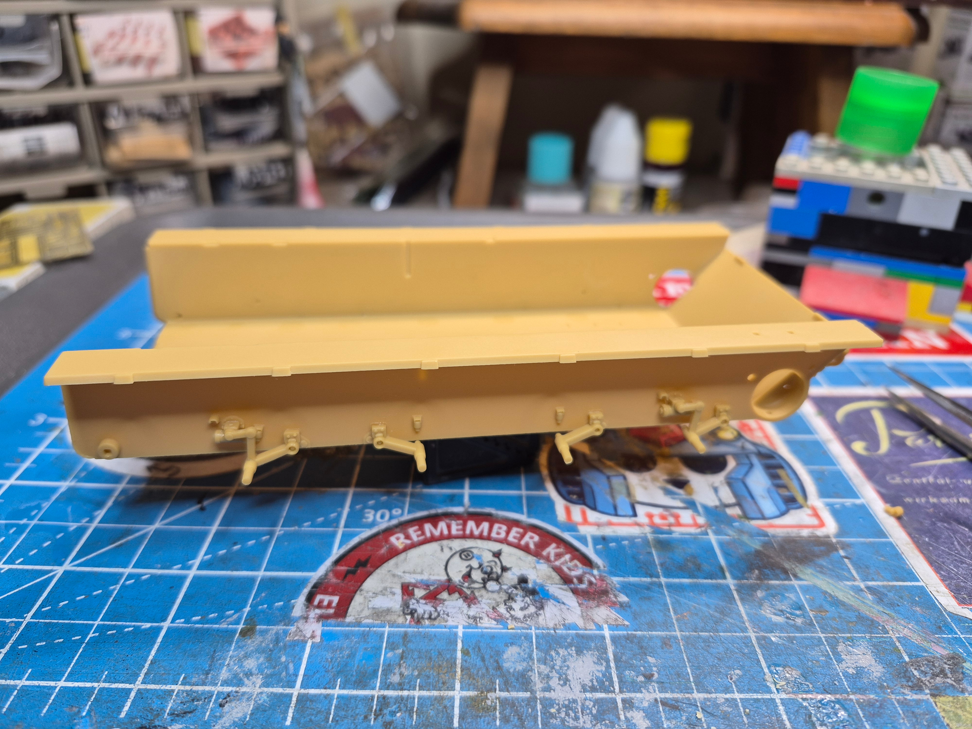

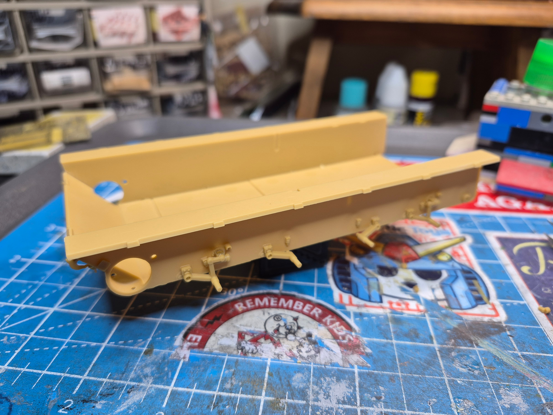

A kit that’s been sitting in the stash for quite some time.
First step. Shockingly good fit so far. The suspension seems quite thin for its size.
