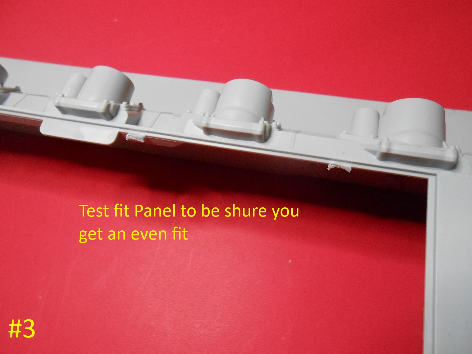

Well I am going to try something a little different this time.

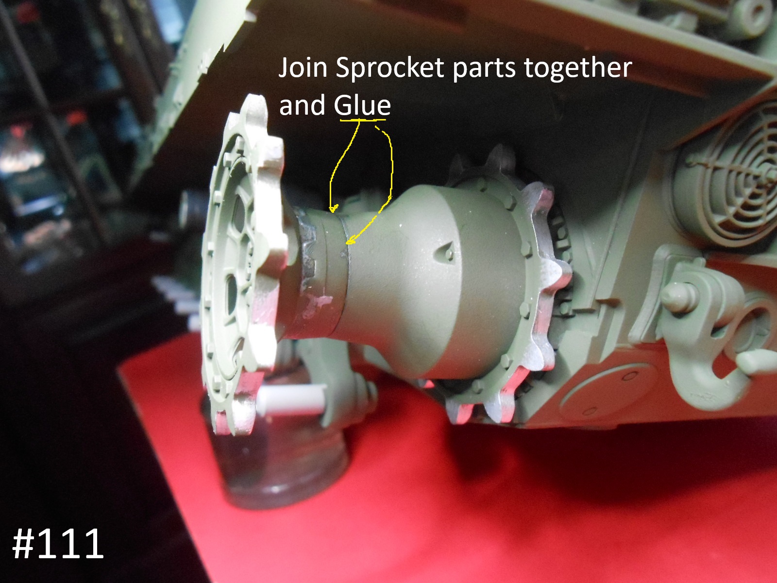

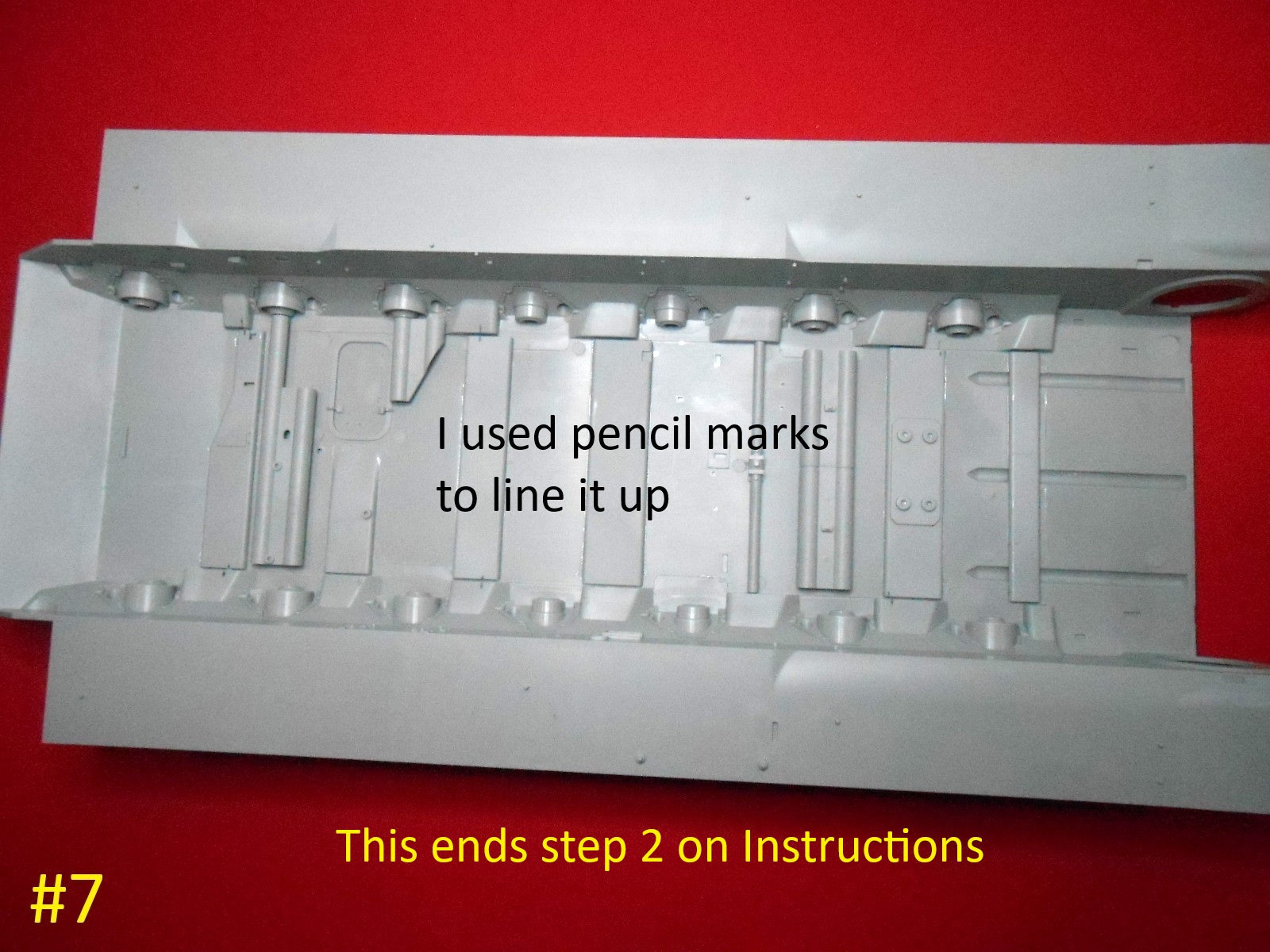

I will be doing a build on Trumpeters 1/16th Leopard 2A6 while comparing it to the Das Werk Leopard 2A7V2 Kit. The Picture Numbering on the Trumpeter kit will be Yellow while the other will be the usual Black or White numbers.

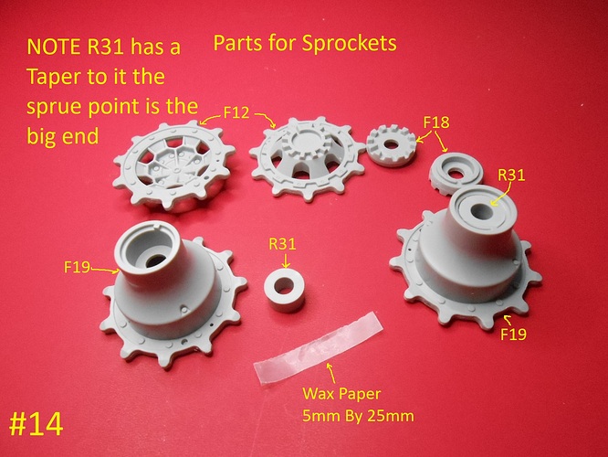

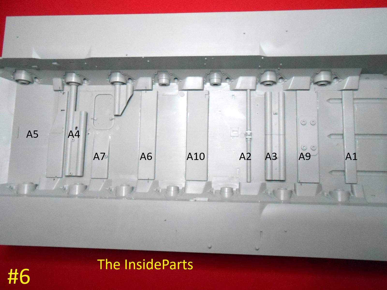

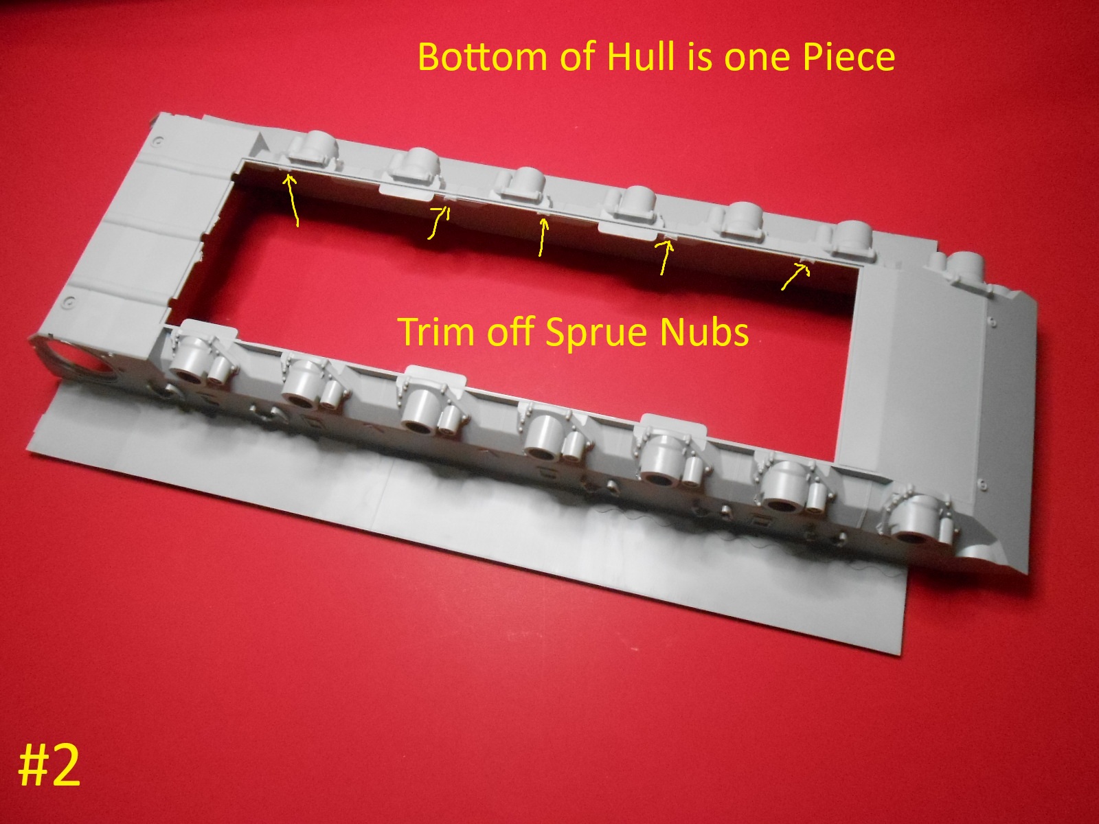

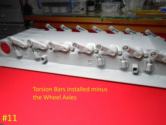

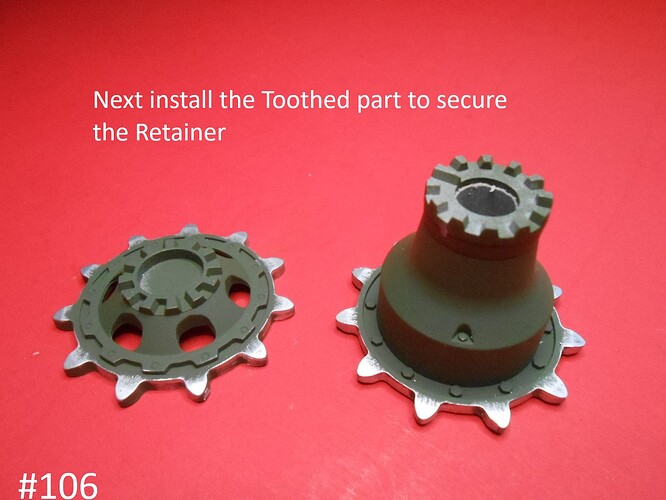

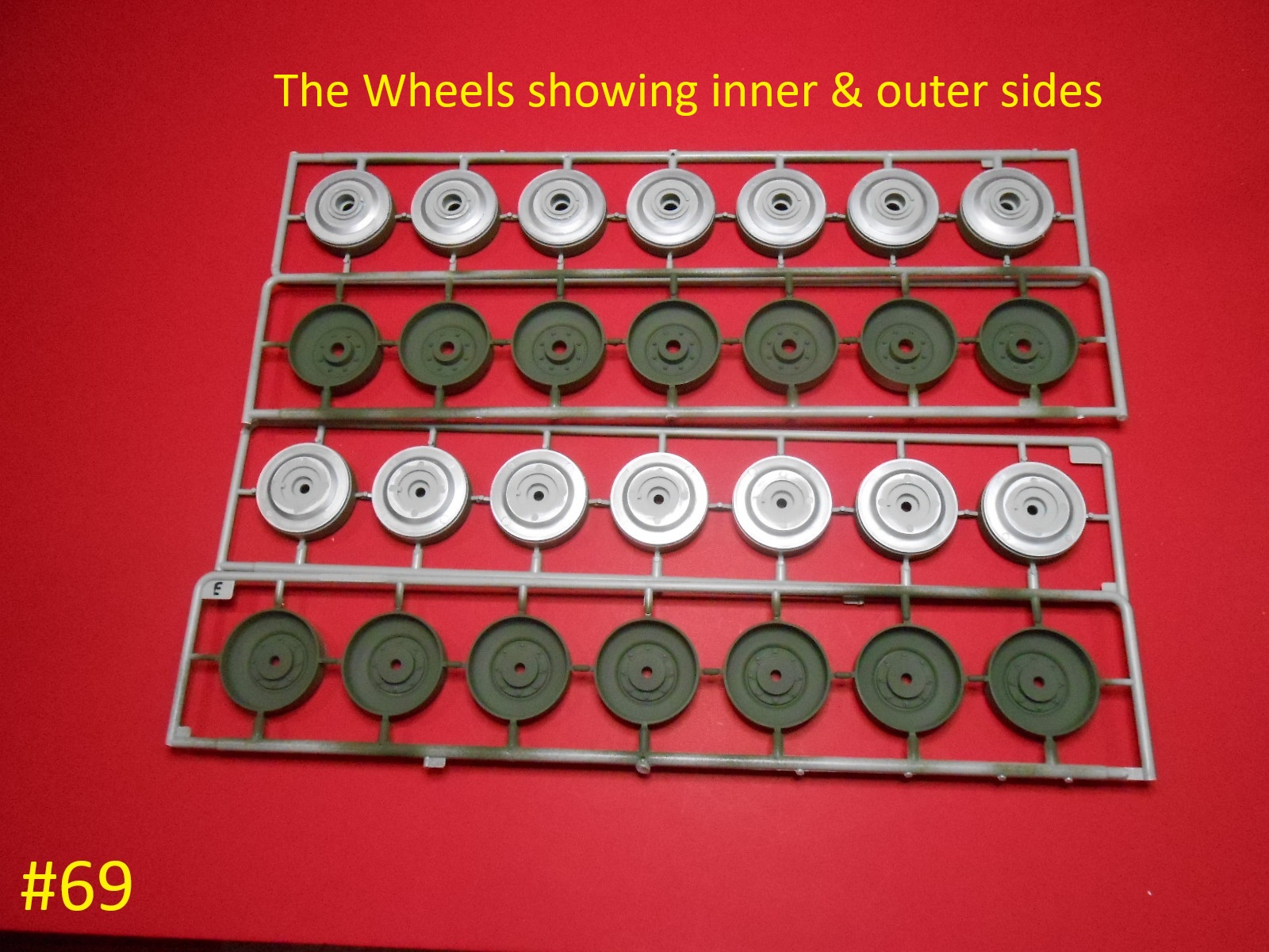

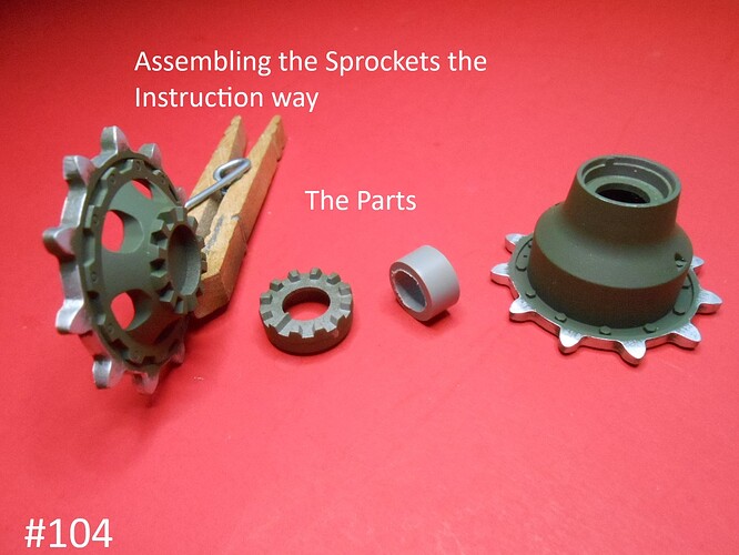

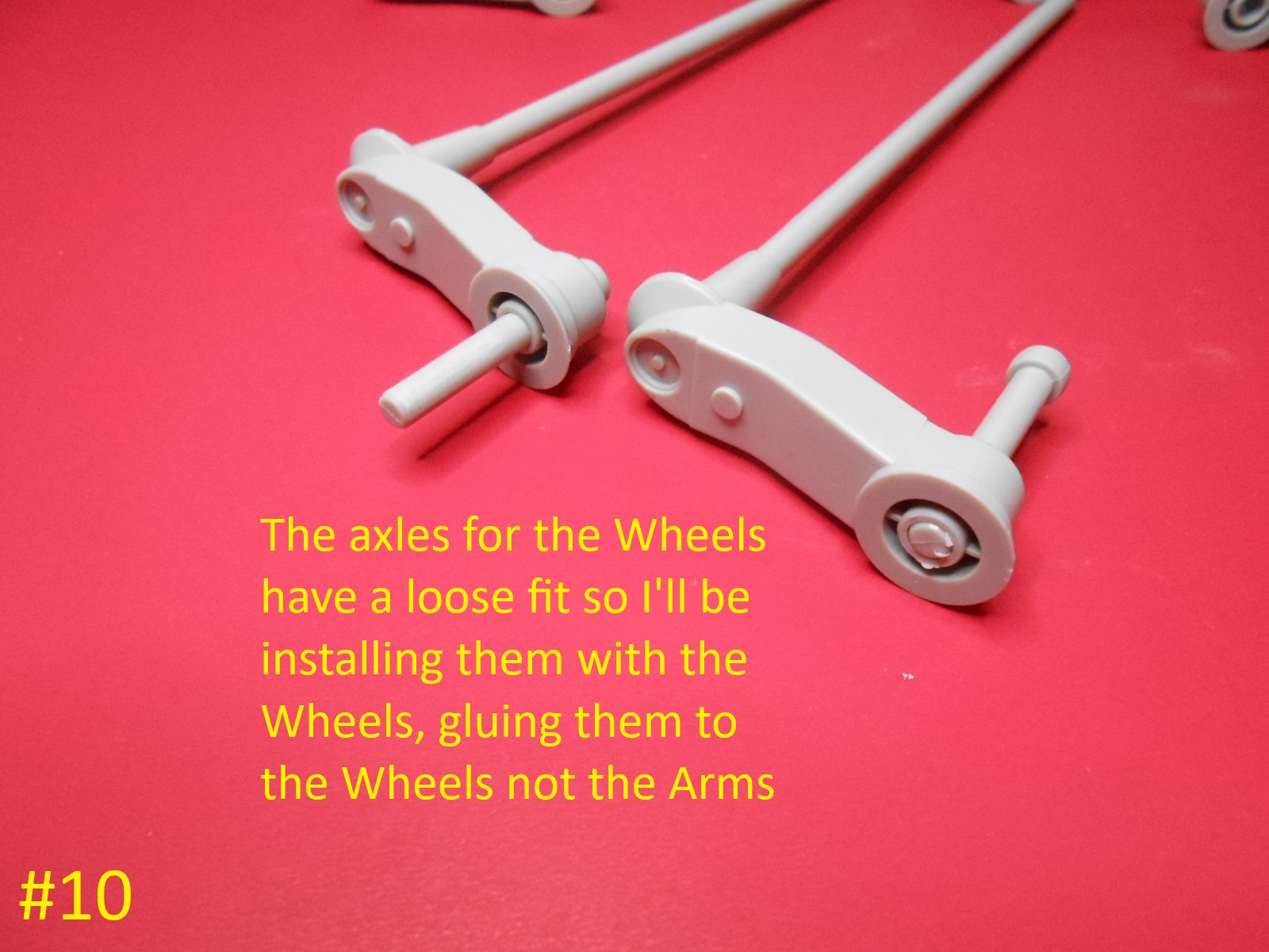

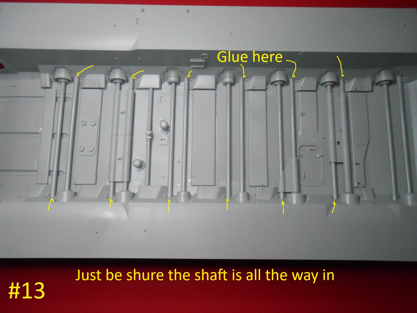

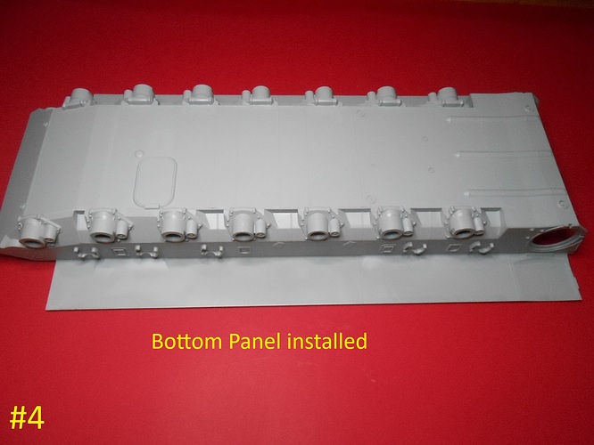

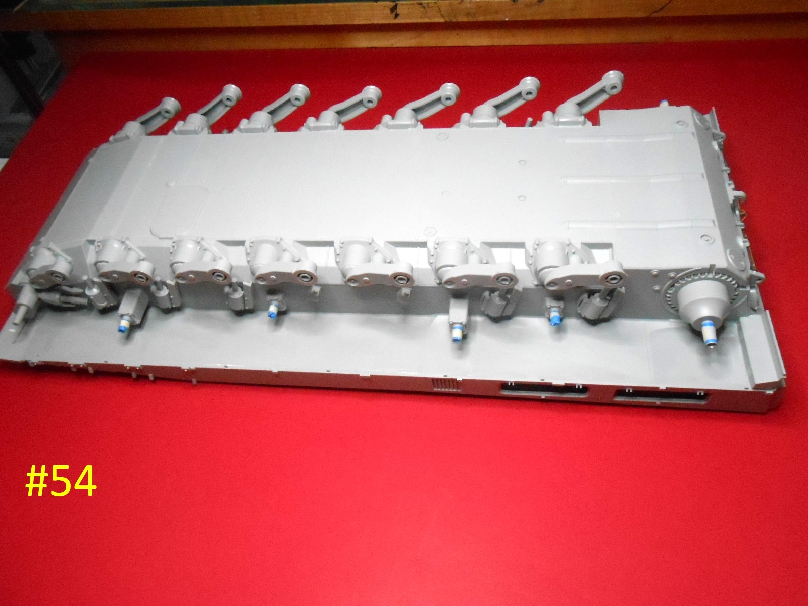

Continuing on, Now it is the Torsion Bars, I think that Trumpeters are more detailed and have a loose Wheel axle so it can be installed with the wheels. The Das Werks have backs on them while Trumpeters don’t. I don’t know which is correct.
First the Trumpeter parts.
I haven’t posted all the Pics. on the Das Werk build, that would be too complicated. Cceck the build posted here if you want more detail.

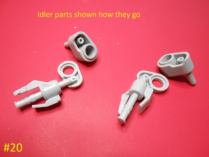

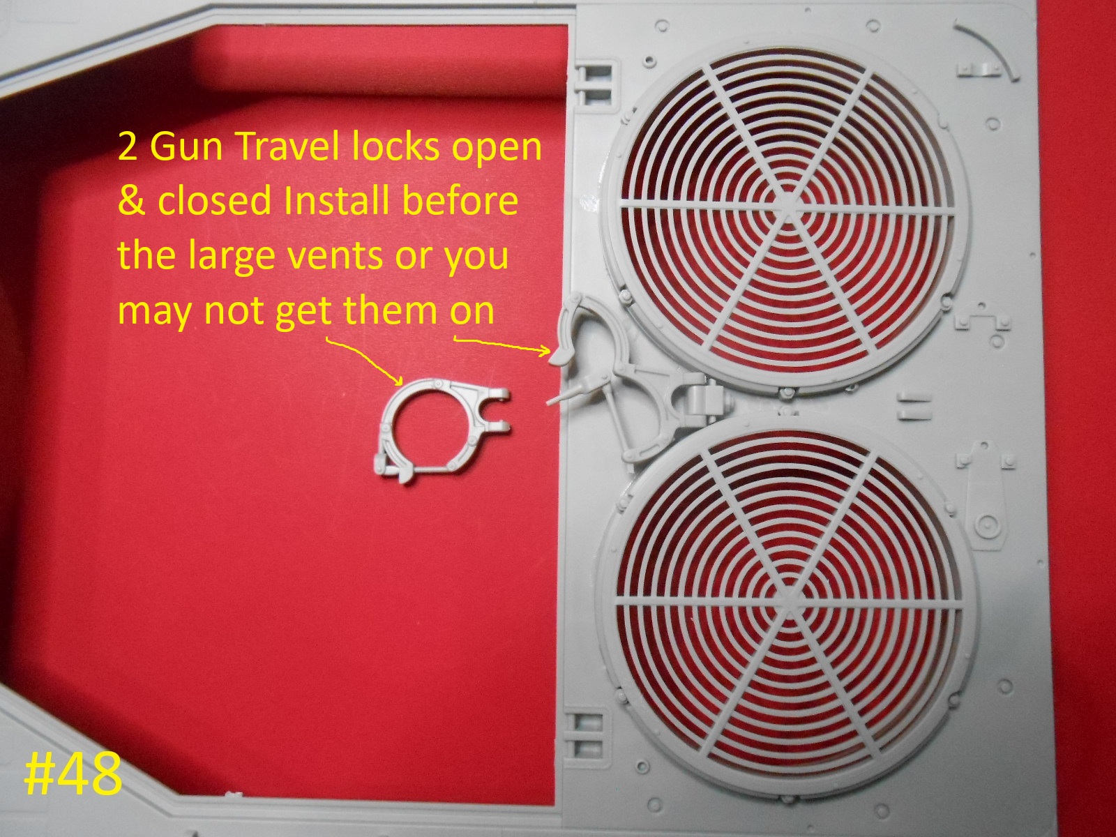

Bolt heads on the DW and the grilles look better defined it looks like DW has a higher part count to allow things like hinges to be better defined. Trumpeter has the upper hand on ease of assembly?
Honestly at this scale all track idlers should have adjustment in my opinion.

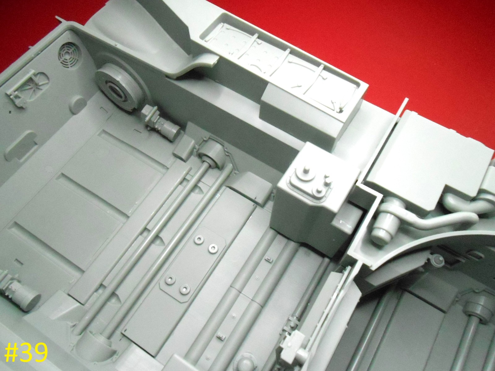

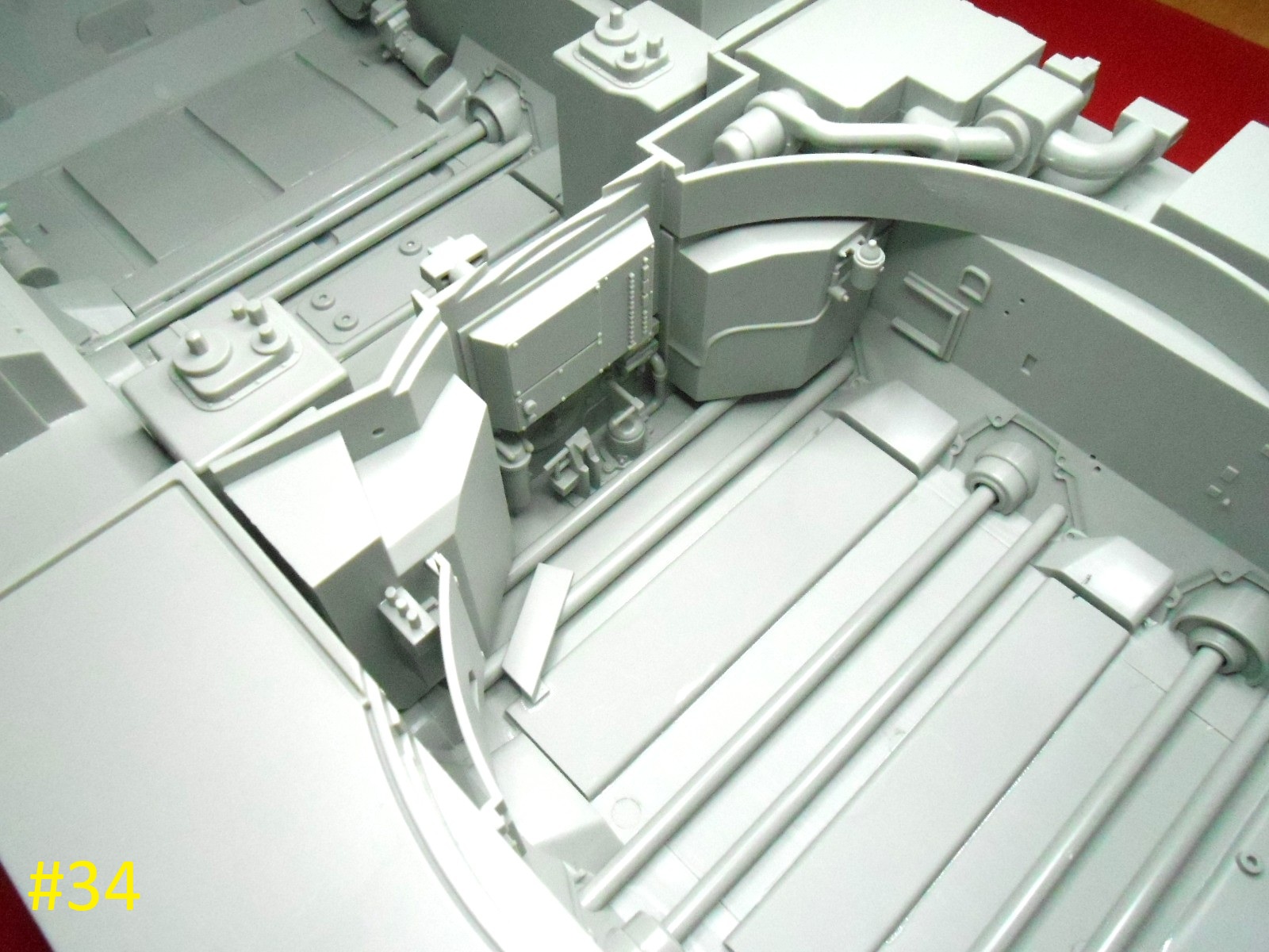

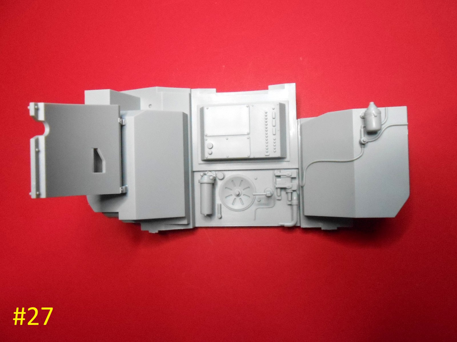

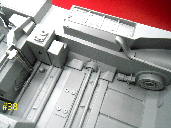

This finishes what there is of the interior, The Das Werk Kit has no interior at all. It looks like eventually Trumpeter will release another kit with an engine and the rest of the interior.

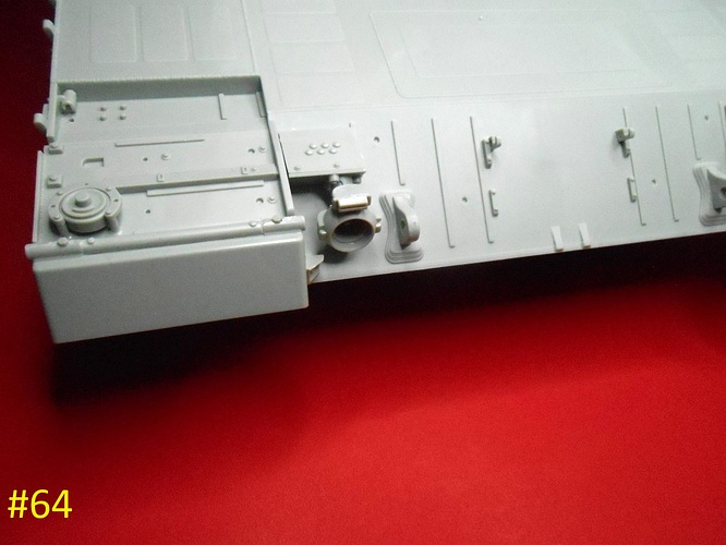

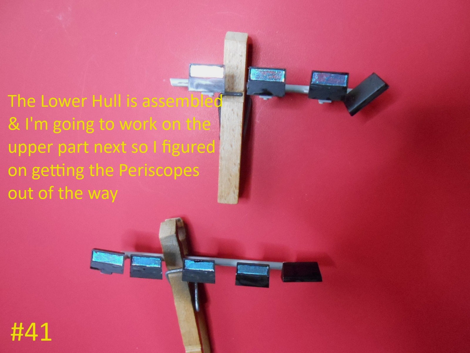

I’ll be working on the upper part of the hull next.
Regards
Donald

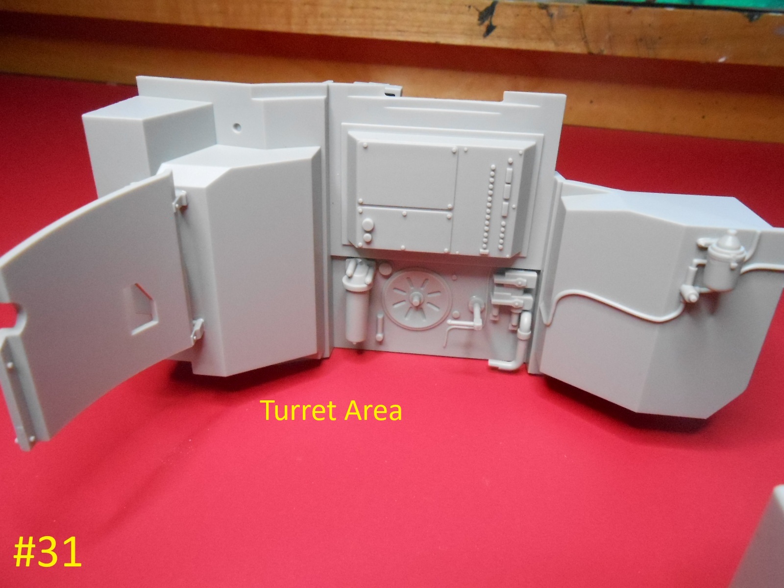

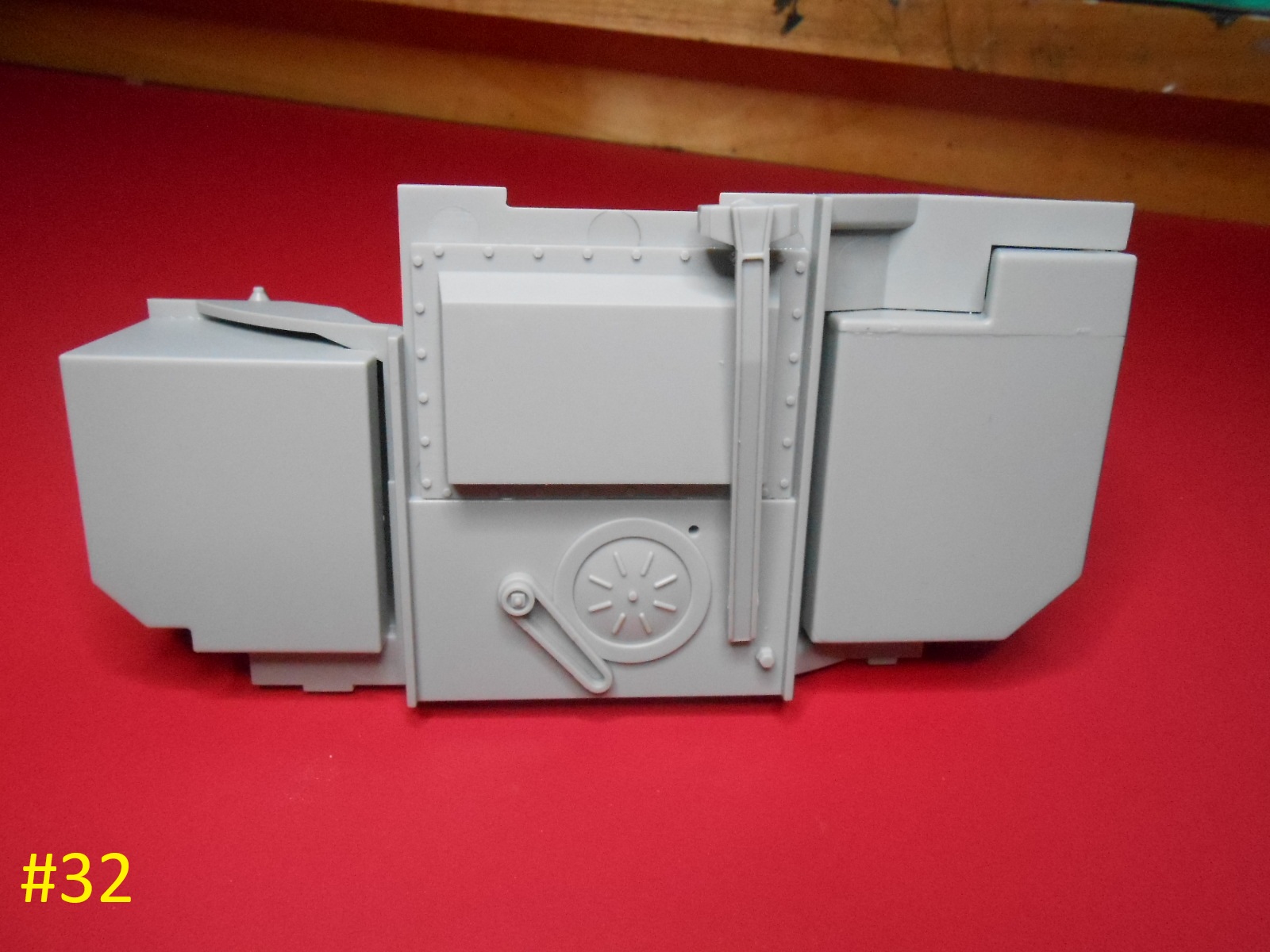

It’s hard comparing these two kits as I am doing it slightly different this time.
For a complete look at the Das Werk build, go to forums and do a search on the 1/16th. builds.
Regards
Donald

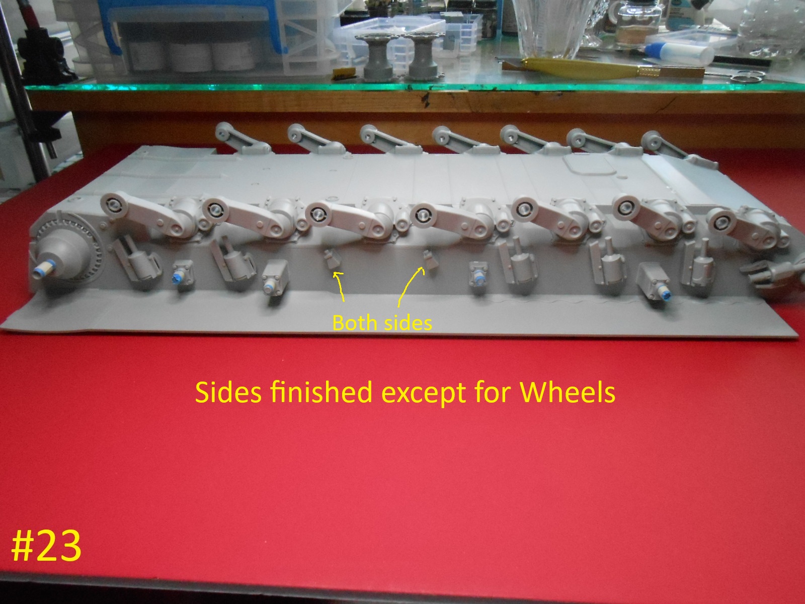

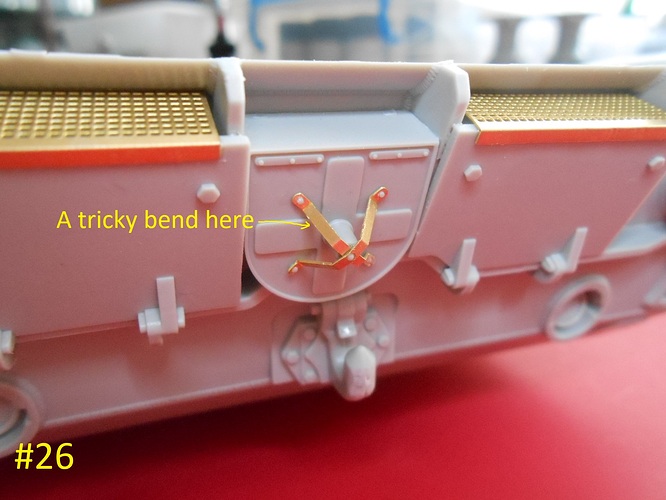

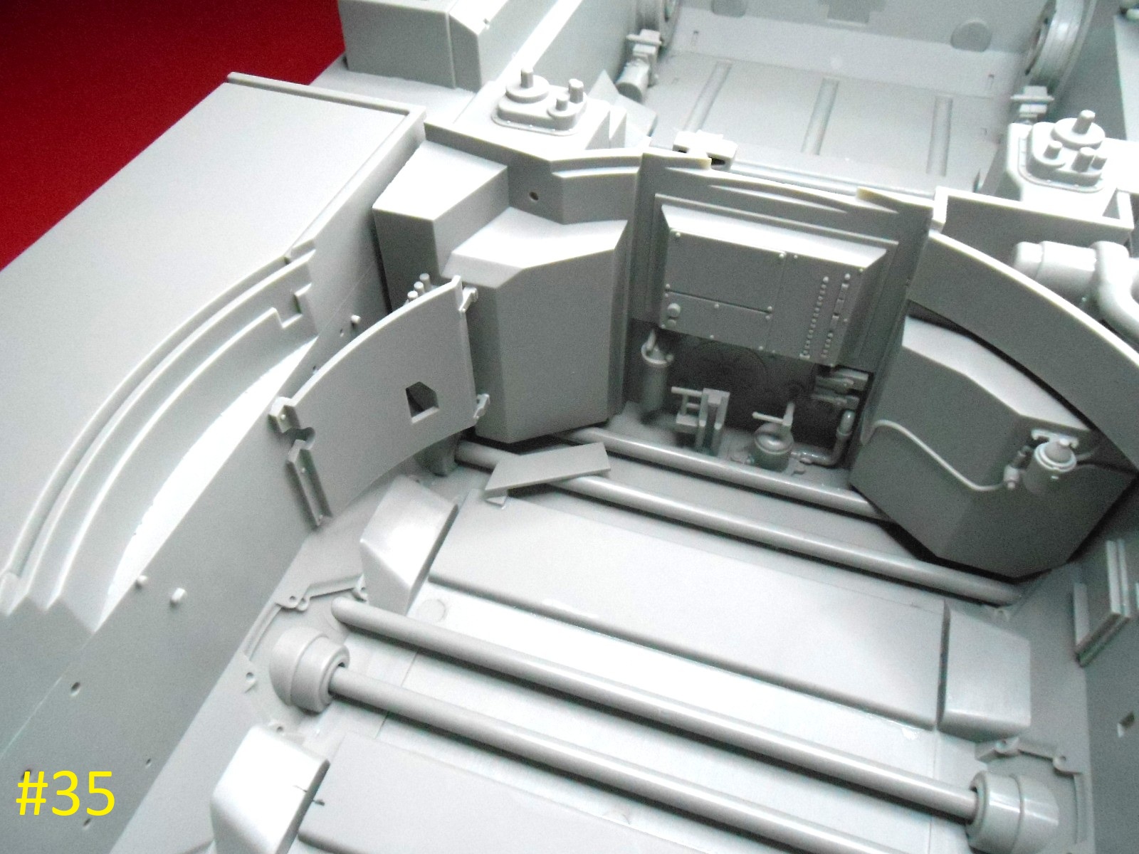

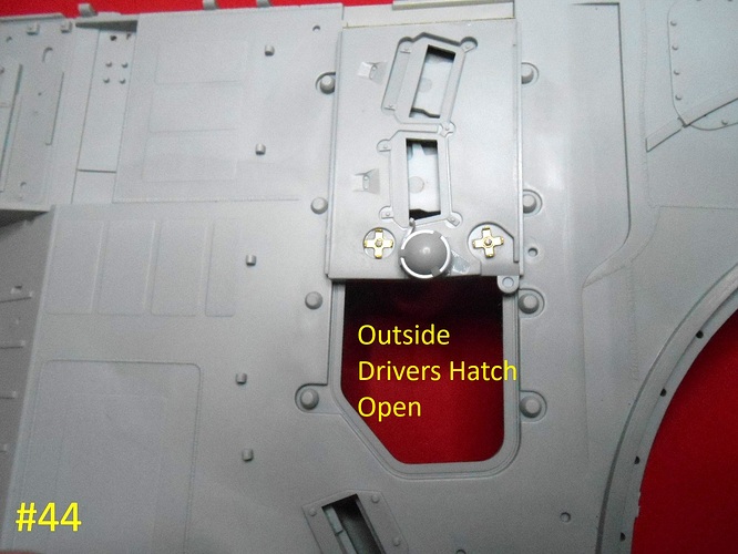

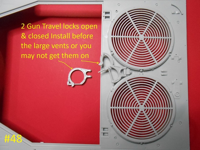

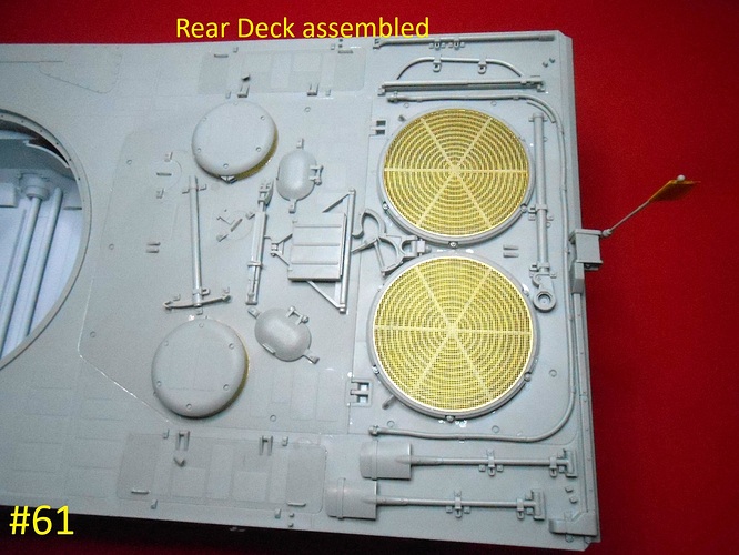

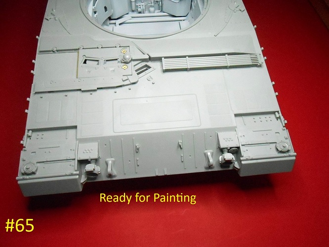

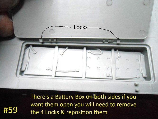

Just a little more done.

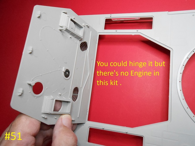

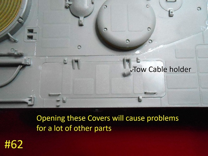

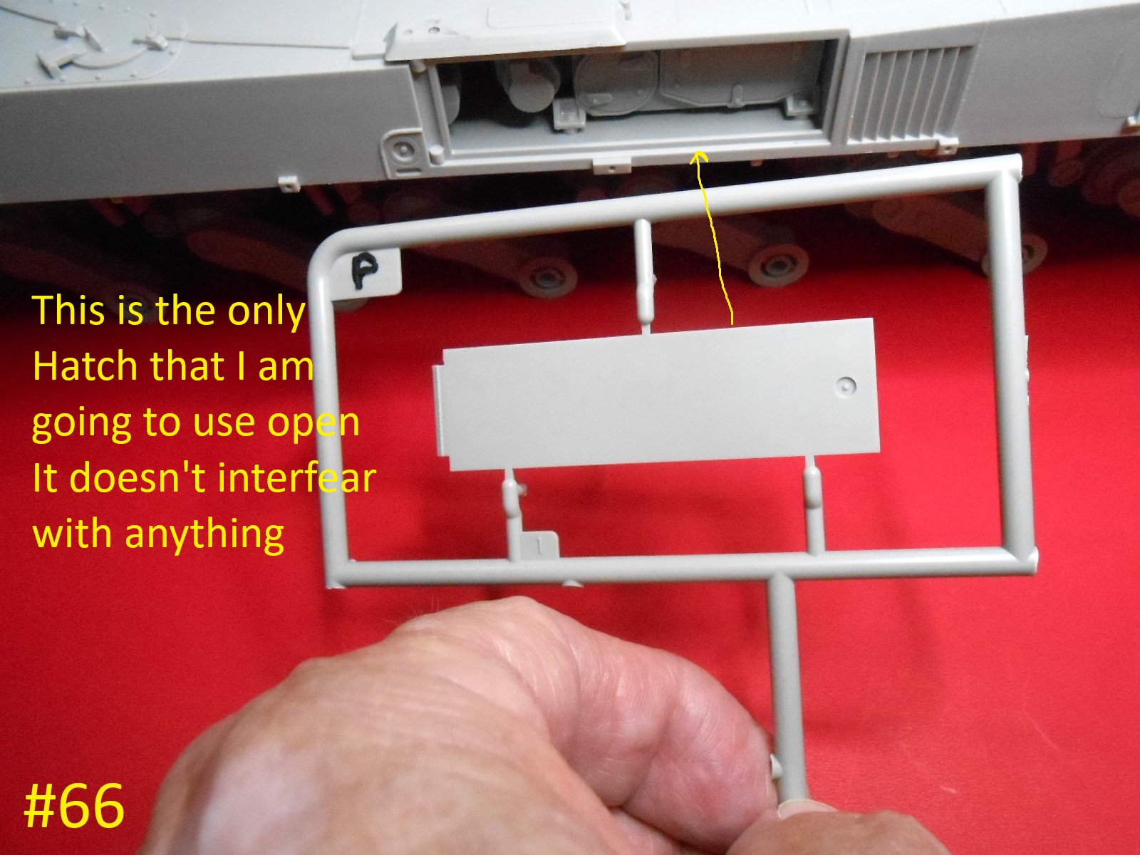

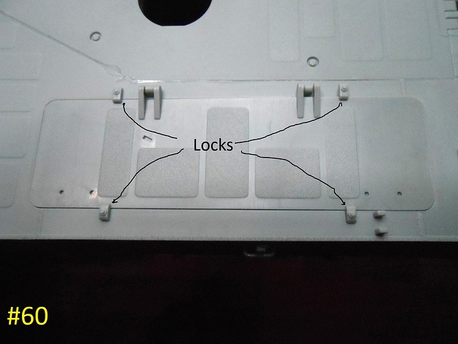

There are a lot of openable spots on this kit, Unfortunately if you want to use them you need to do a lot of scratch building. Removing hold downs and re positing them. Then in the open position they interfere with other parts .I’m not going there.
