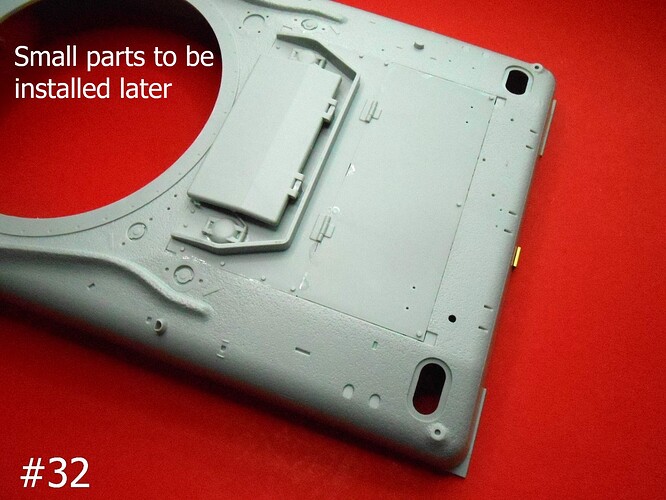

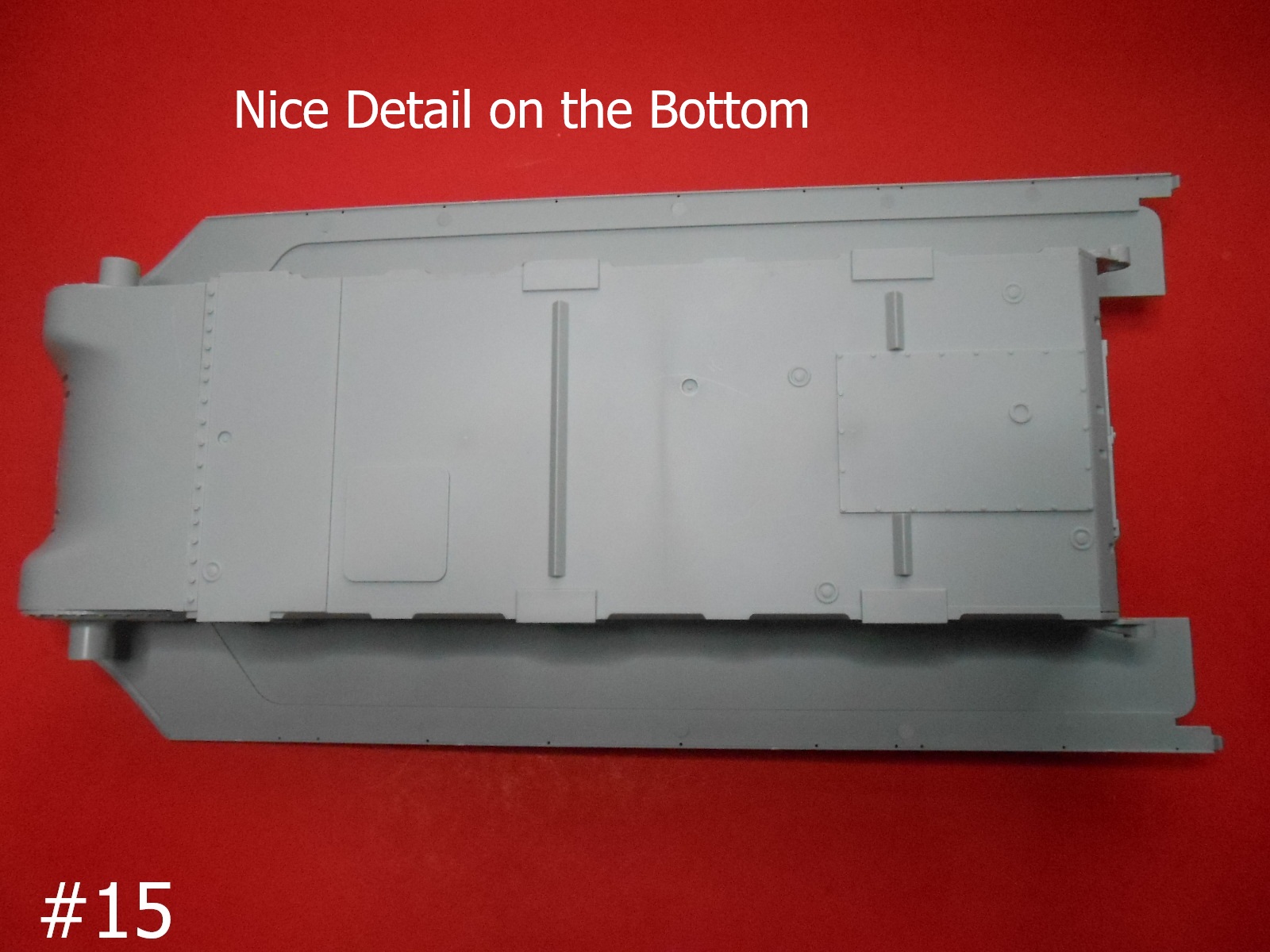

Continuing on.
Finished for Today.
Donald

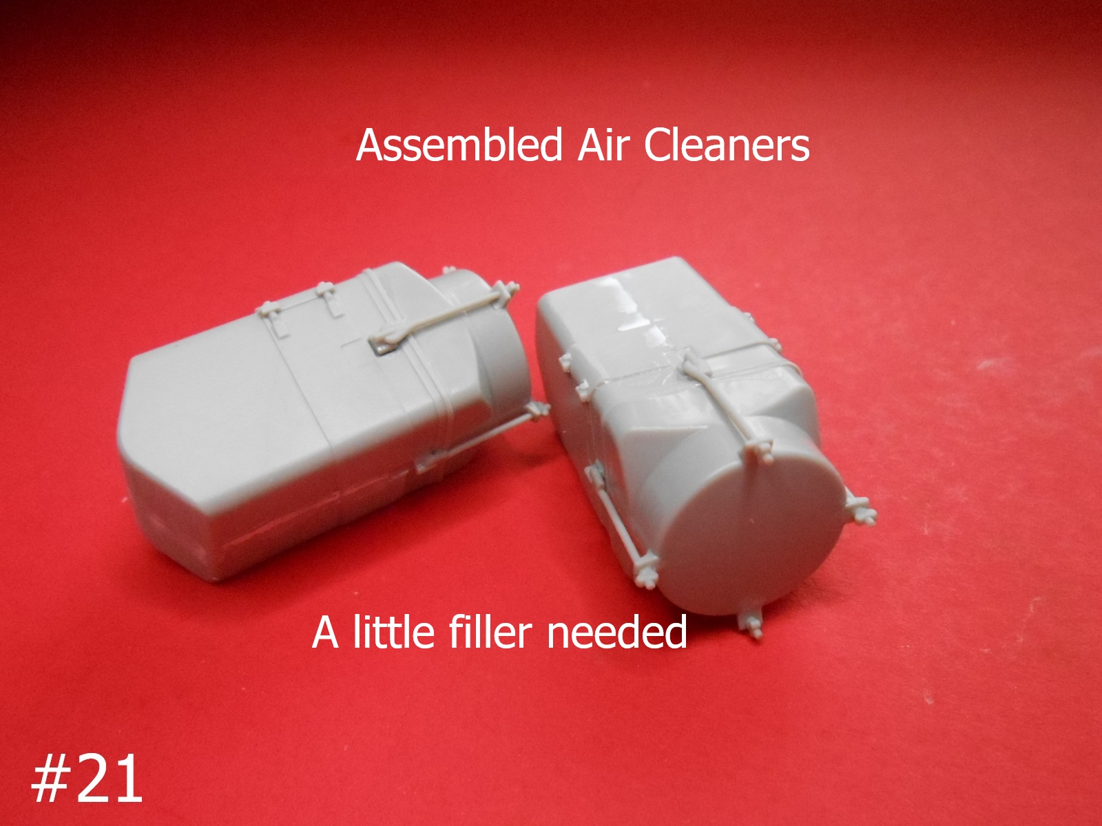

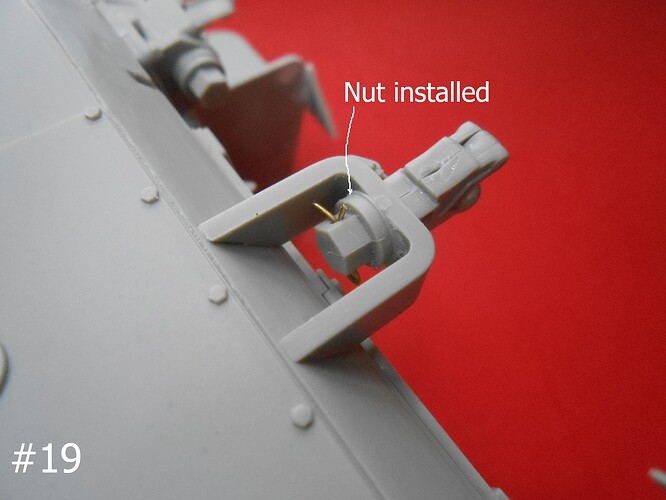

So i continue on, all by myself.
Finished for today
Donald

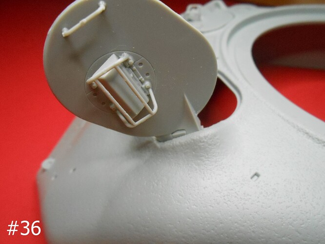

Looking good. That casting texture is excellent.

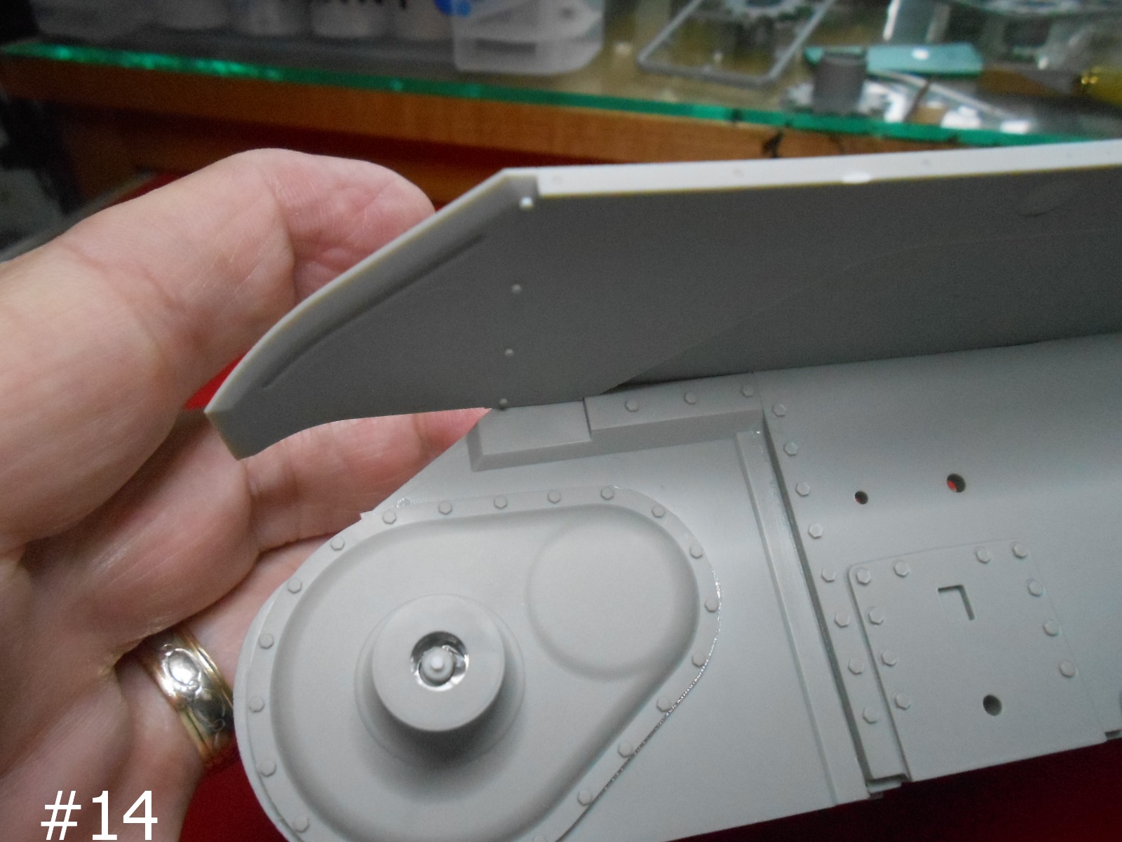

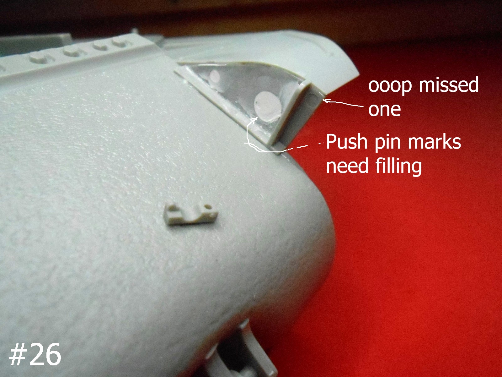

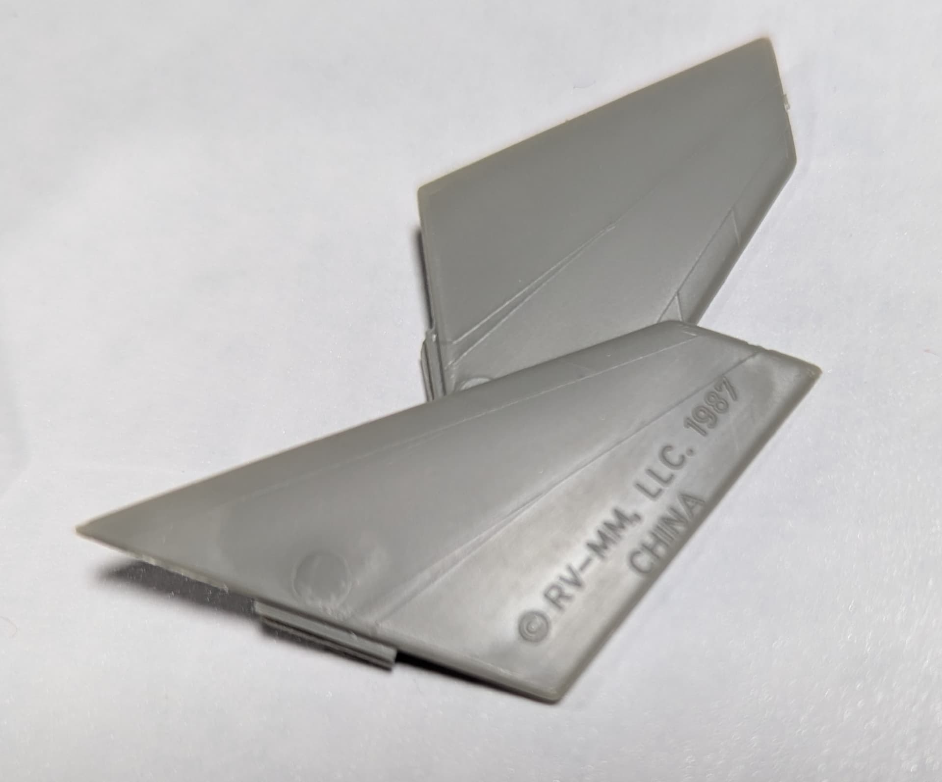

Are you gonna sand down that copyright?
I have no idea what you are talking about.
Donald
That is a good start.
That’s a factory casting number, not the kit maker’s copyright.
You can see it just barely on this example:
Imgur
Actually those are Foundry casting marks used to tell where the part was made, and by what company.
They didn’t CopyRite Sherman tank parts.
Regards
Donald
Note the Turret side.
This looks like the same type tat I’m building.
Donald
It struck me as odd, but I’ve been building 70s and 80s kits lately, and most of them have external copyright marks like that.
I never knew the real thing had that. One of my favorite things about this hobby is how much I learn. You guys are WAY better than the History Channel :slight_smile:

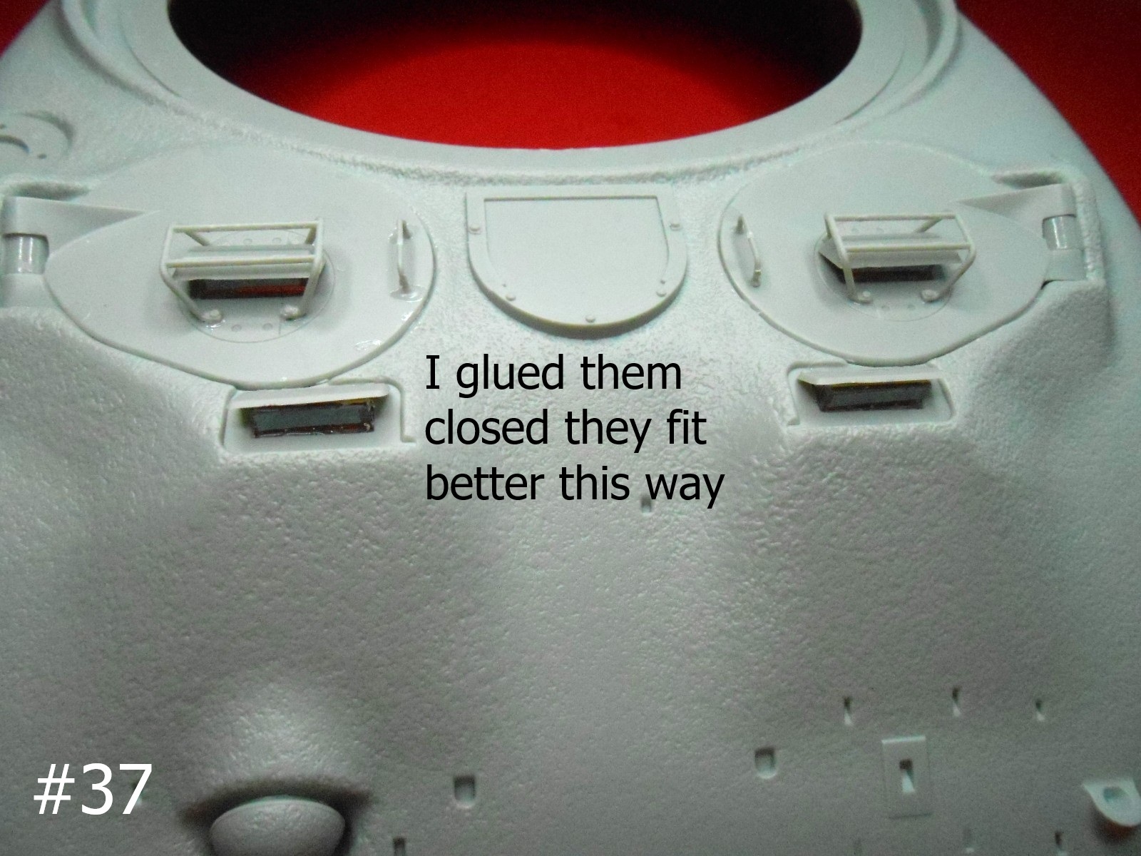

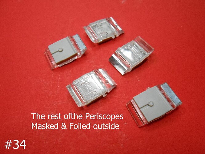

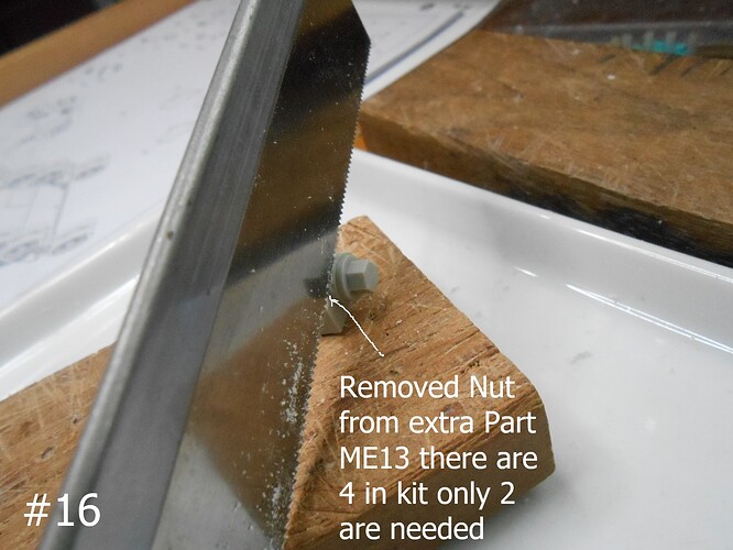

Continuing on, I Masked and Foiled the Periscopes, only 2 are needed for the Hull hatches the other 3 will go in the Turret when I get there.

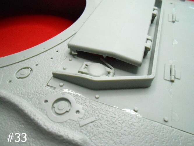

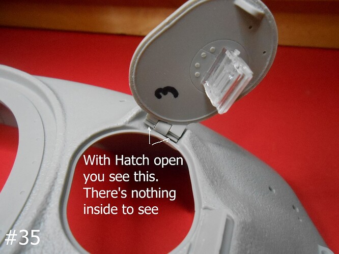

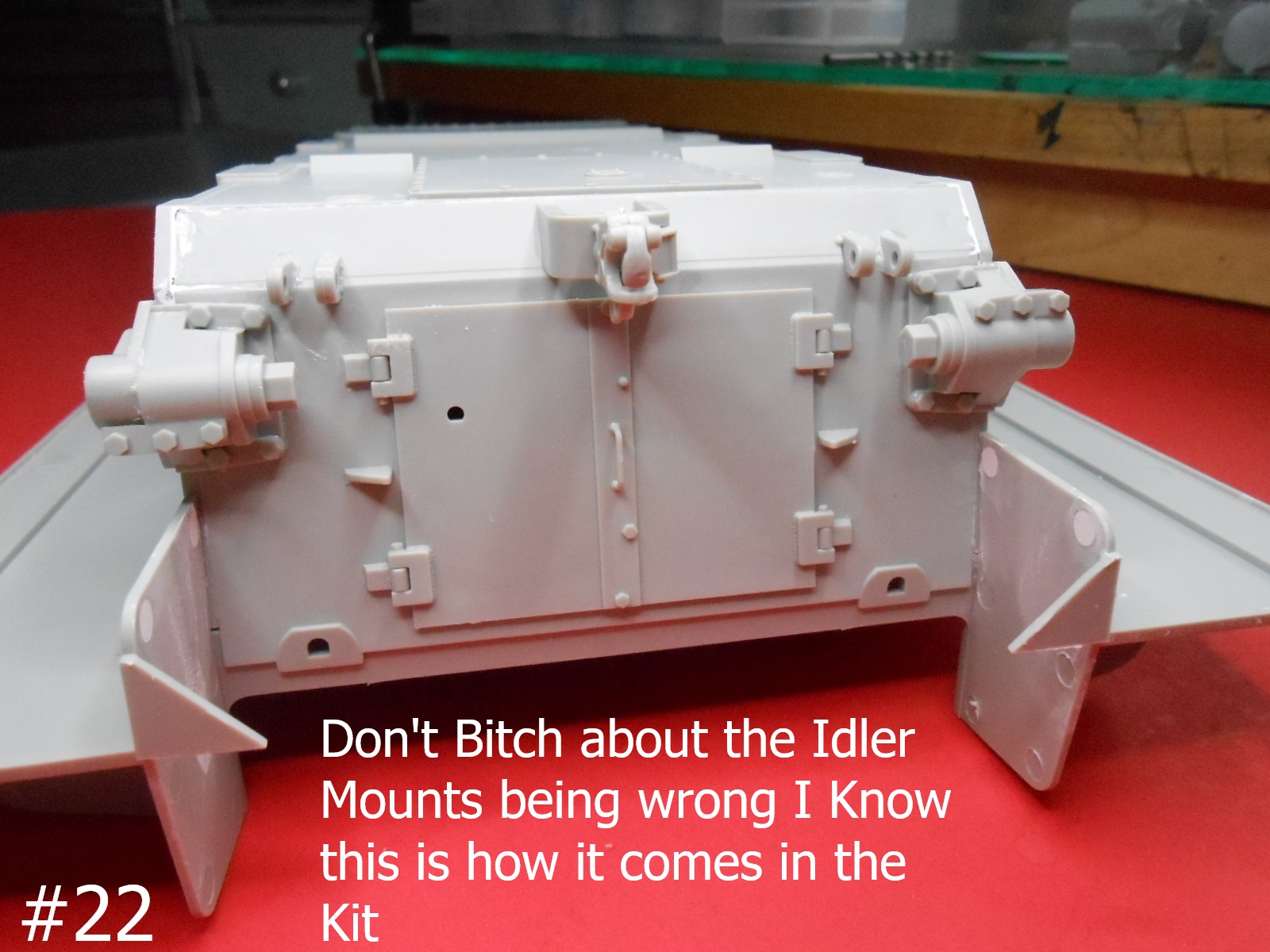

The Hatches didn’t have a really good fit, so i glued them closed. There’s nothing to see inside the Hull anyway.

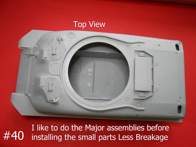

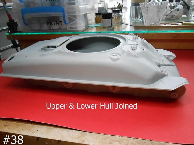

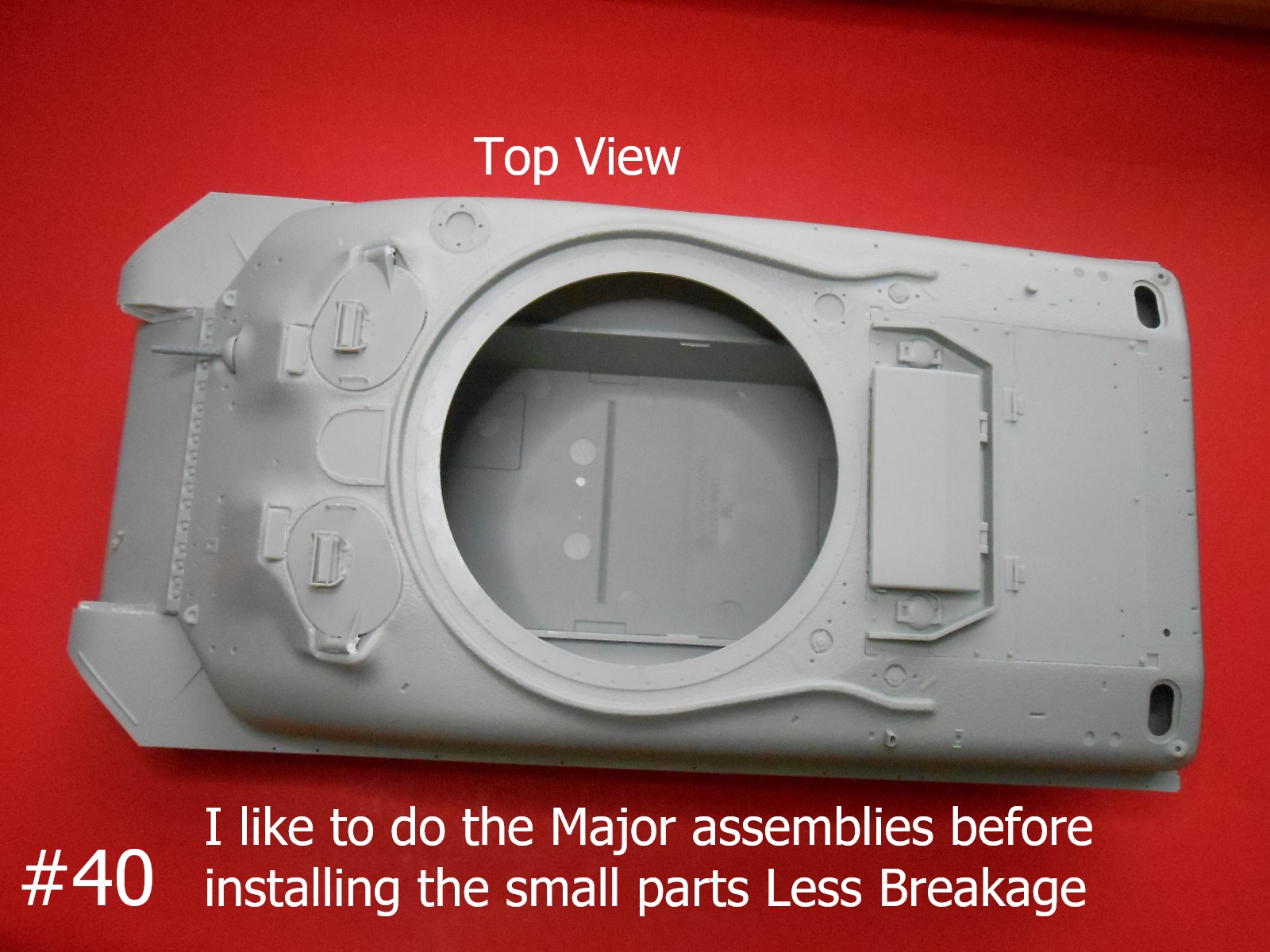

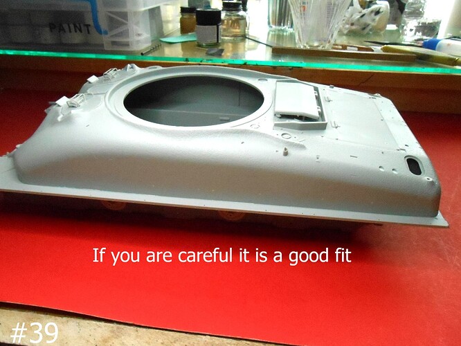

The Upper and Lower Hull parts are joined, If you are careful you can get a really good fit.
There that finishes the Major Hull assemblies, I think that I will do the Trucks assembly next.

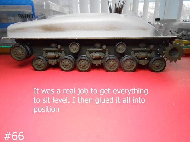

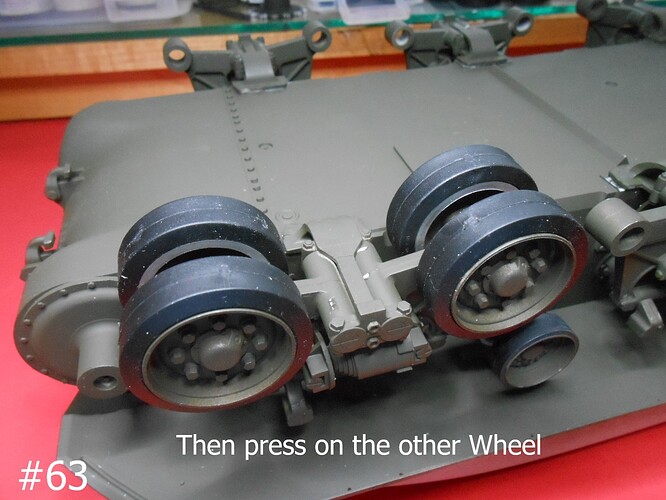

I have the Trucks assembled and painted.
Next some detail painting and the wheels.
Regards
Donald

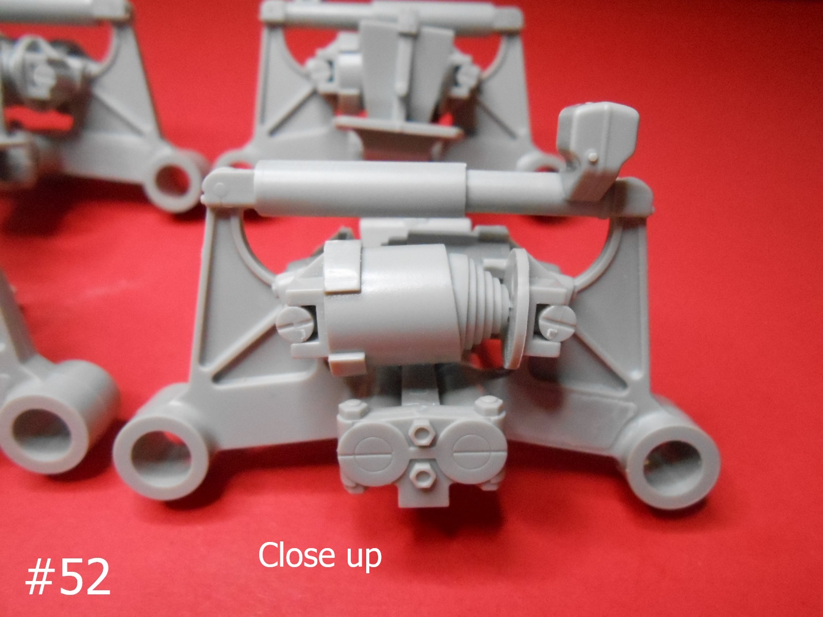

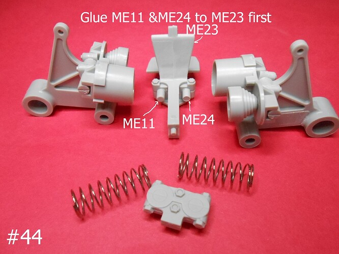

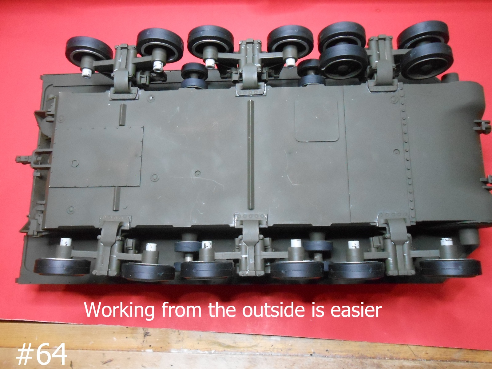

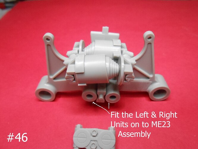

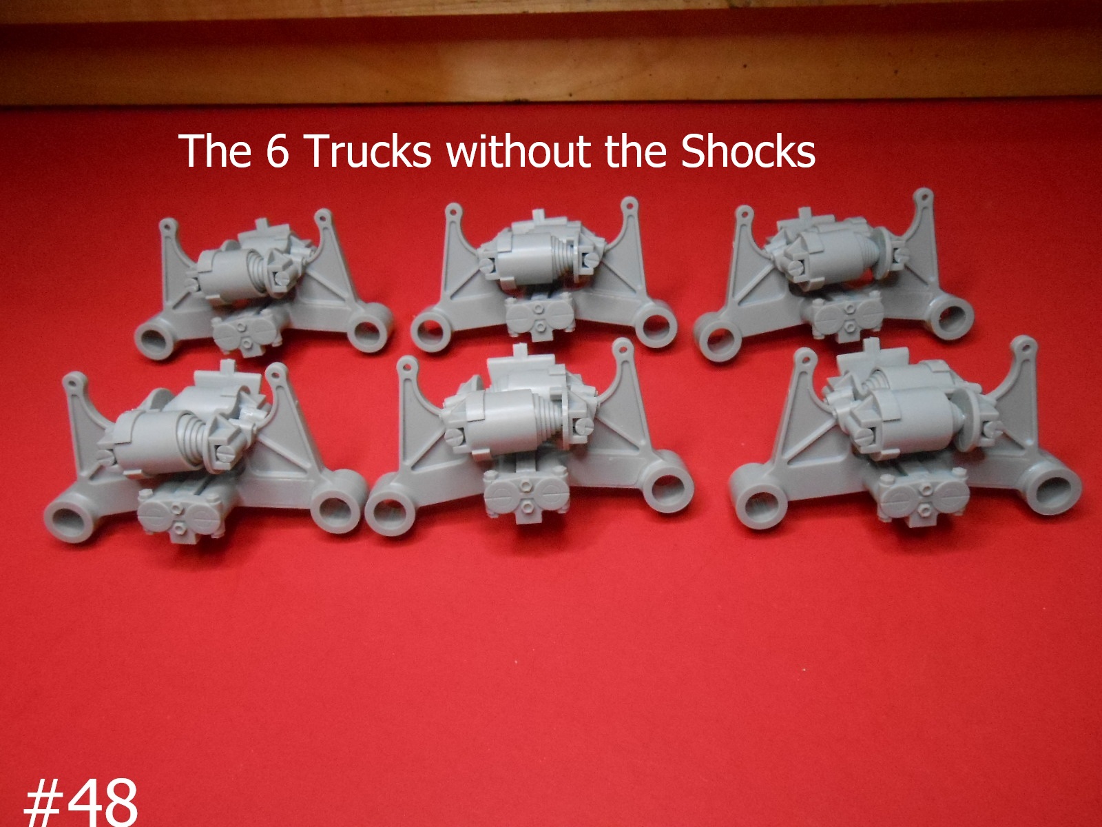

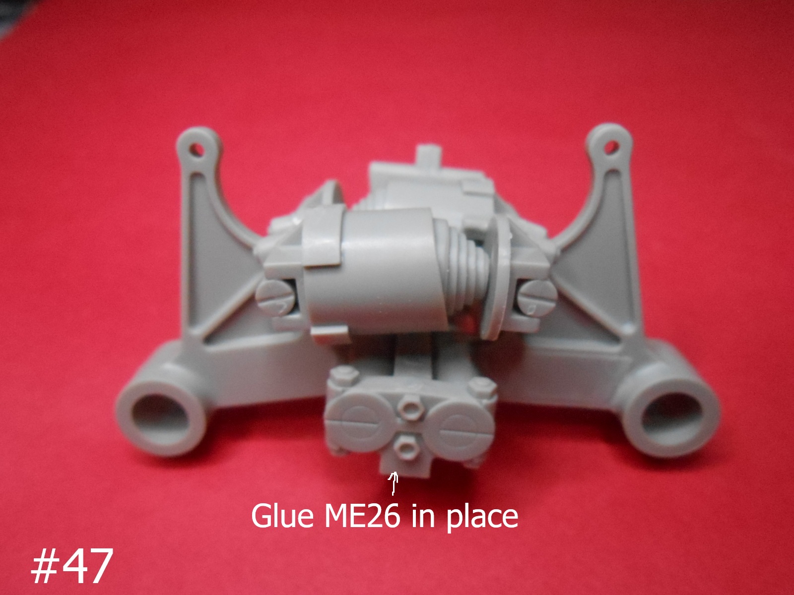

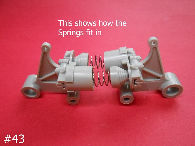

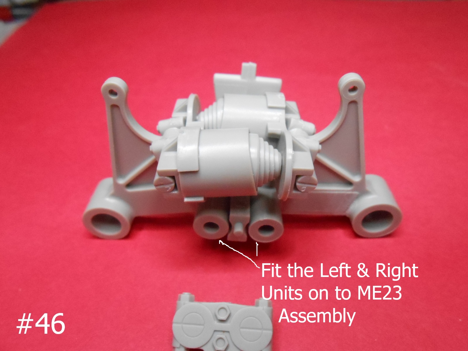

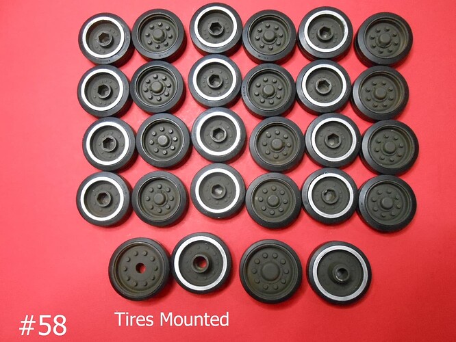

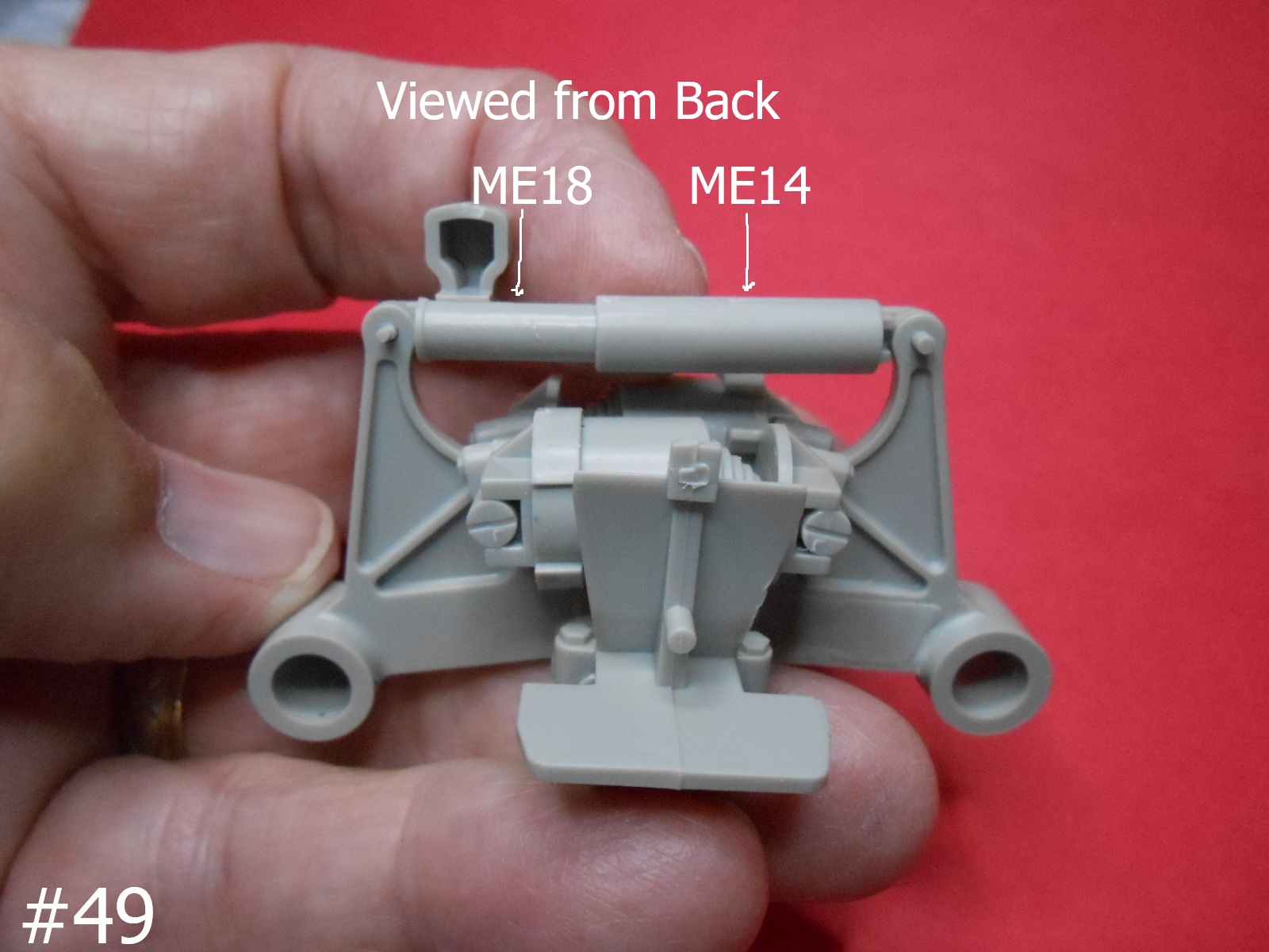

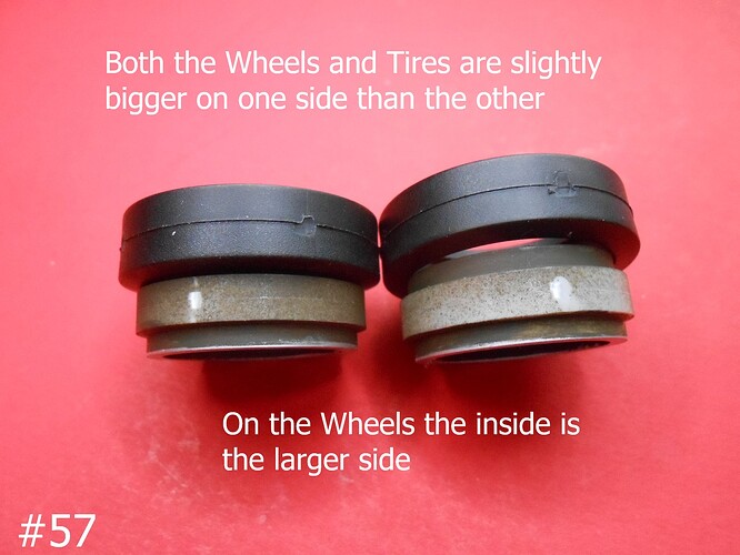

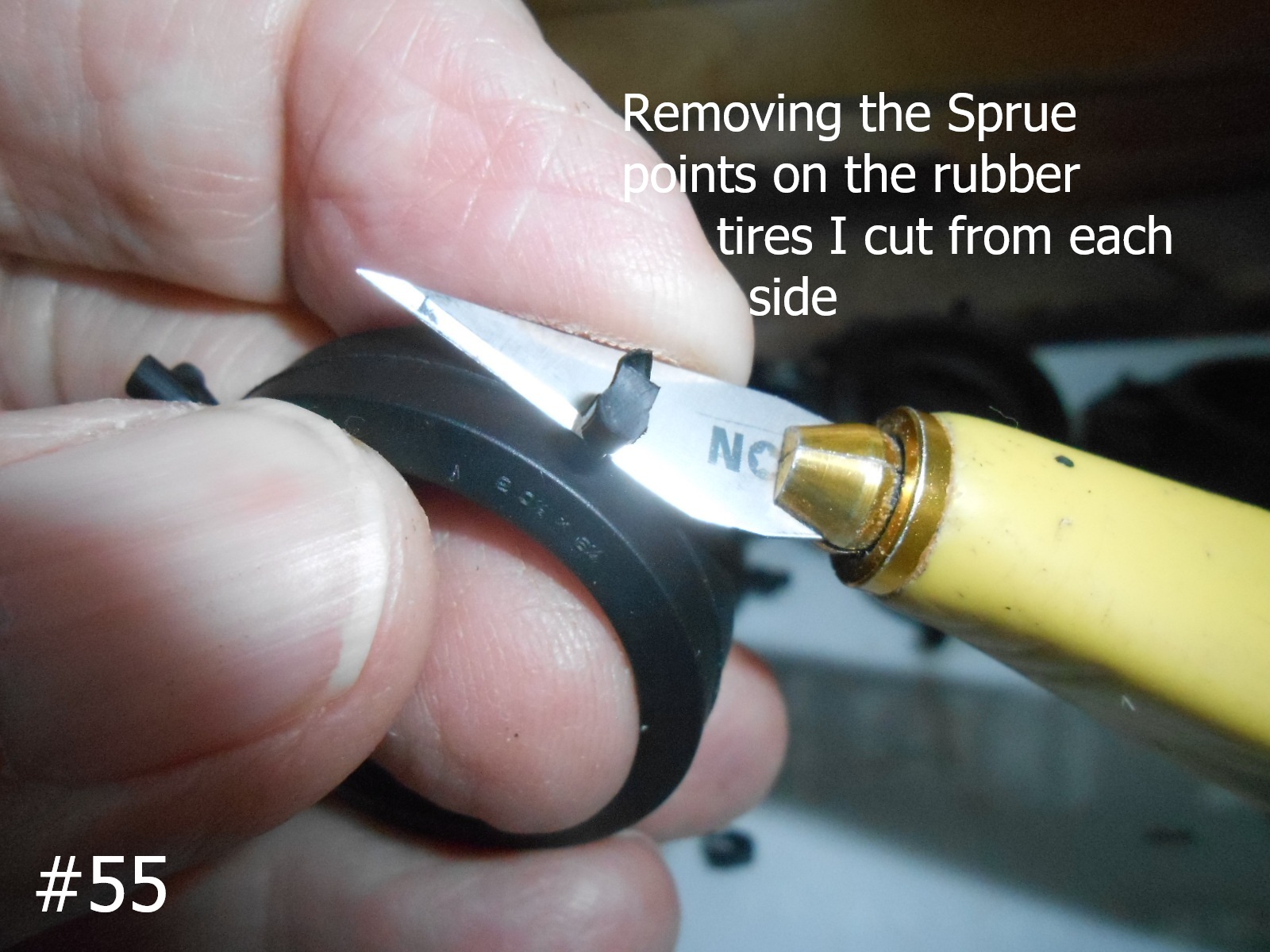

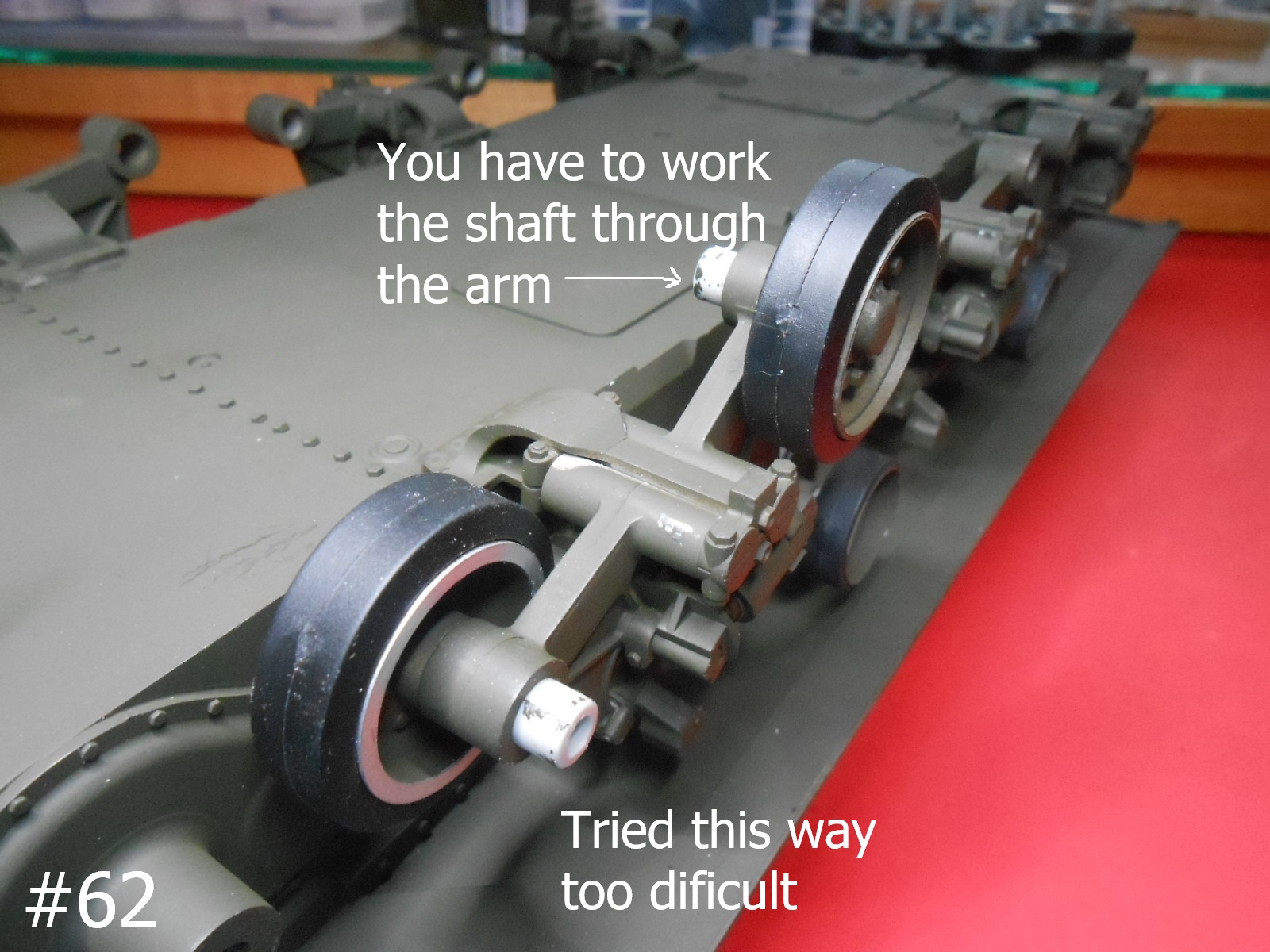

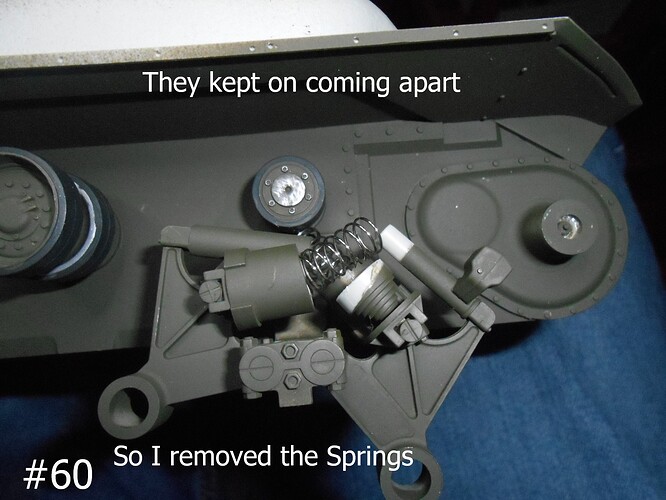

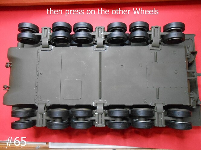

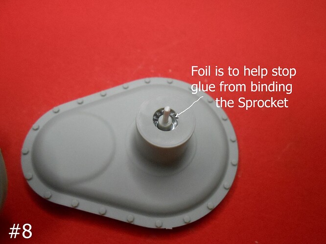

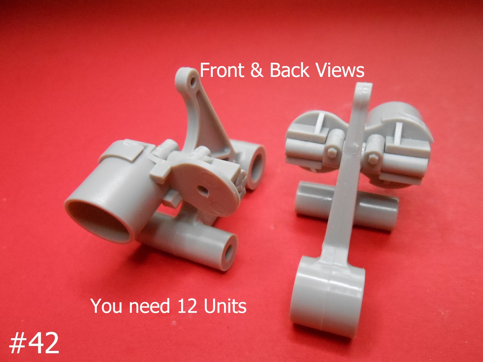

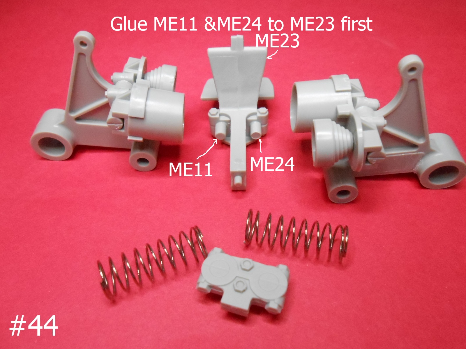

Here is how I did the Trucks, All the Info is on the Pics.
The Trucks on Andys Sherman E8 Kit are a lot easier, having the Springs in there was just a pain and it complicated things.
I found it easier to remove them and just glue everything in place.
I don’t play with them once they are finished.
I’ll be starting the Track next, and that looks really complicated.
Regards
Donald
For picture #60, could you use some foam, like those ear-plugs that you squish? Would provide some cushion but not as aggressive as those springs. There doesn’t seem to be a change of geometry from removing them, and then I read that you glued it all so might not matter.
EDIT: Here’s a quick snap of a kit on my bench to show what I was talking about earlier with copyrights. I’m not crazy about the old kit itself, but the subject matter (X-15) limits my options, and I cannot do scratch, so one must take what one may get.
I have been thinking, and Maby I could have done it differently.
Maby if I just glued the Horizontal shock absorber in a fixed position, that is the left and right end together and freed up the joints Maby it could work like the ones in Andys Sherman kits.
