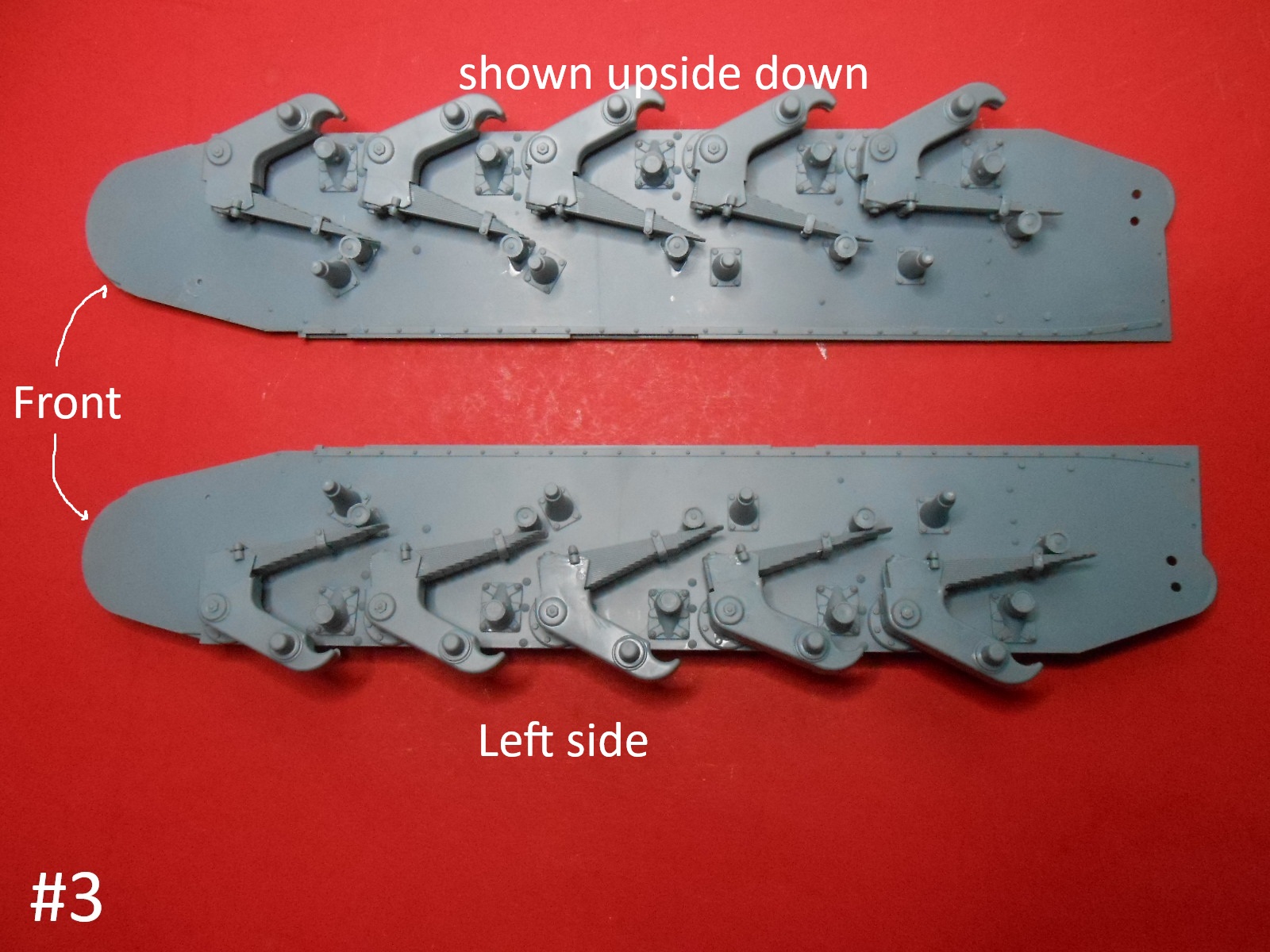

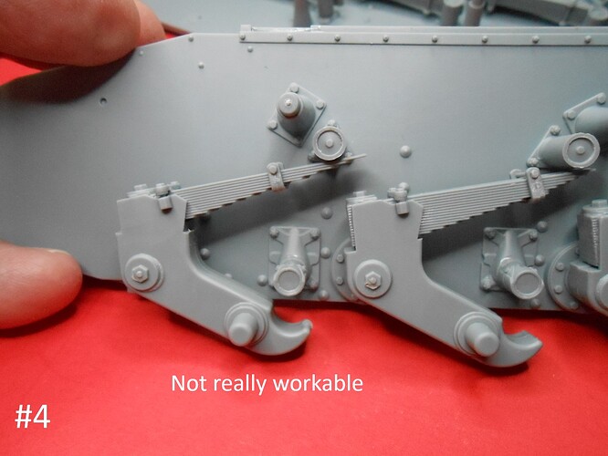

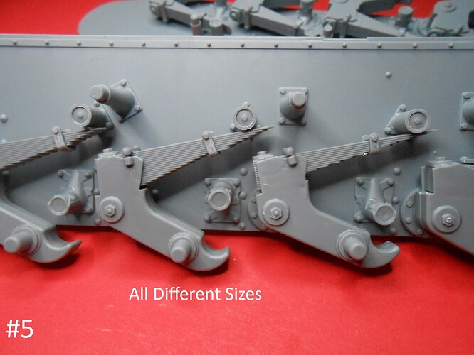

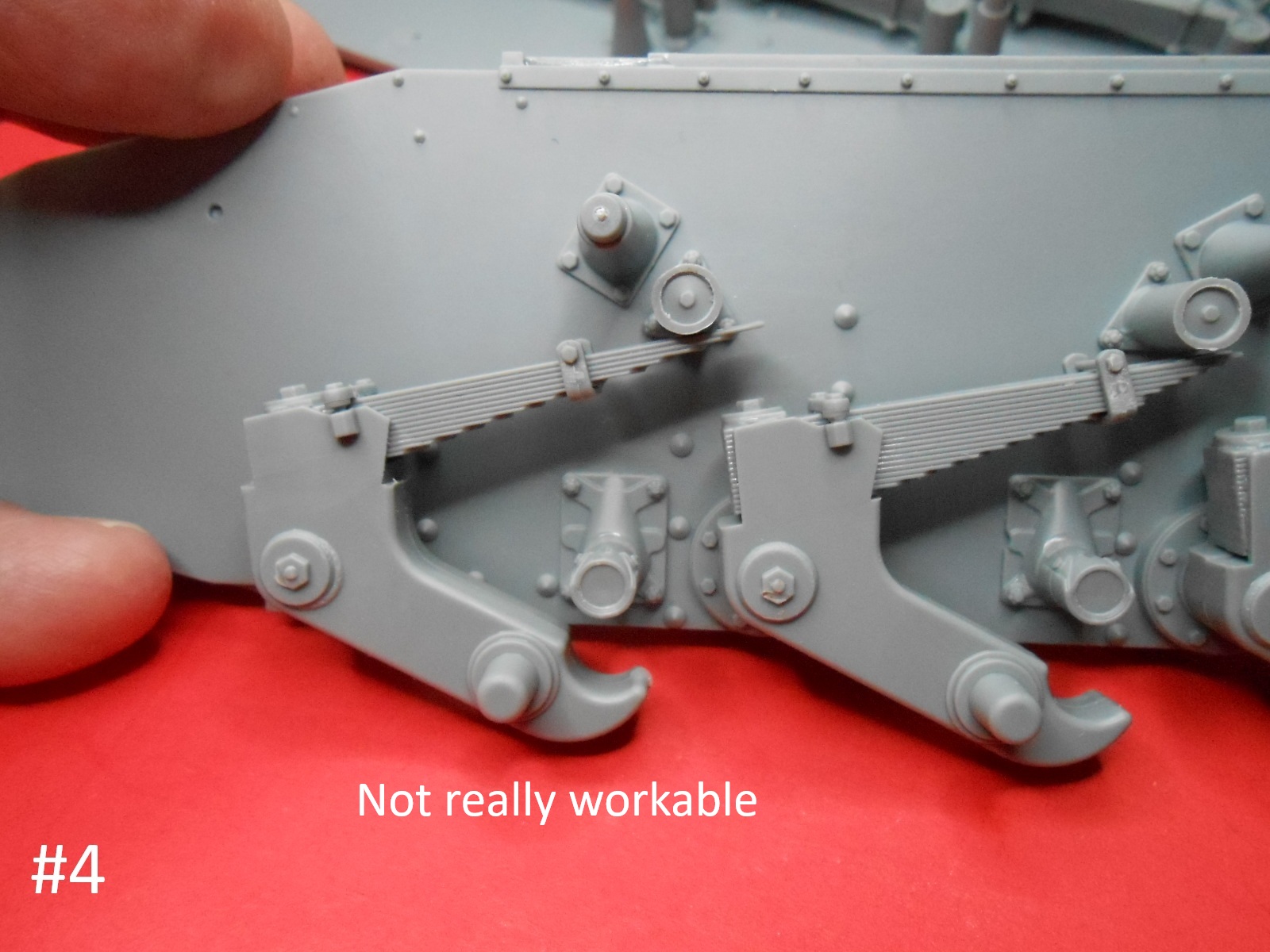

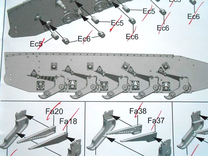

“All different sizes”
What? Are you sure you’re putting the right ones in the right places? Have they different part numbers? That doesn’t sound logical. It’s more likely that the ones at each end of the row would be special.
David
well this order is where the instructions say they go, and the only way they will fit to keep all the roadwheels level. Weird but it works/
Regards
Donald

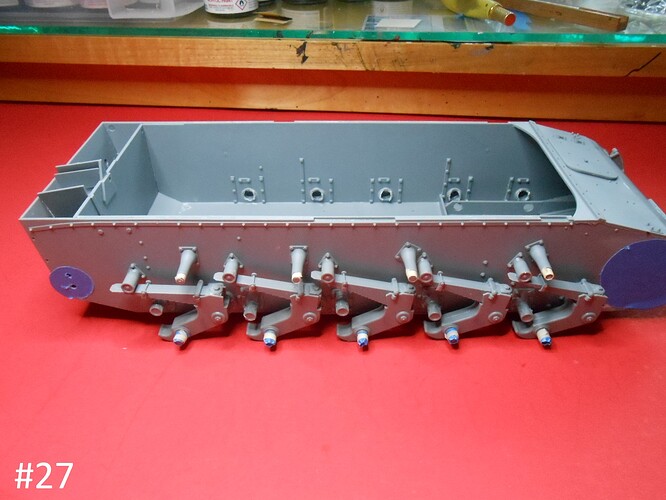

Here is a Pic. of the instructions showing where they go.
The actual suspension arms look to be the same size; it’s the spring blades that seem to differ in their number. I imagine that is perhaps because the load varied at those points.
Actually the tops of the arms where the springs mount are all different heights.
Note the tops of the arms pictured above.
Donald

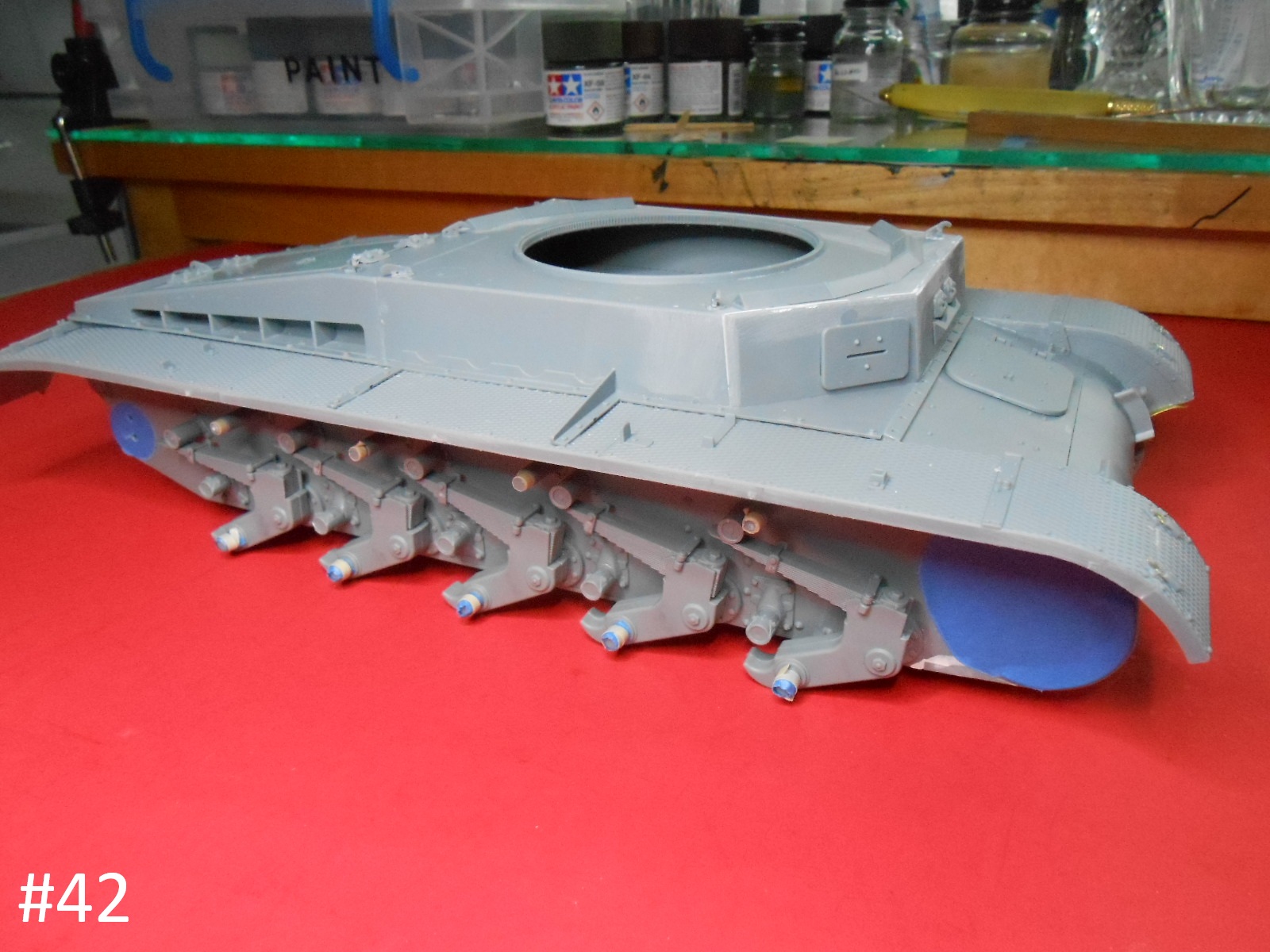

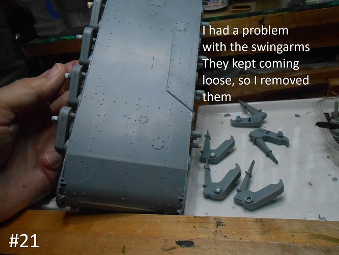

some more done.

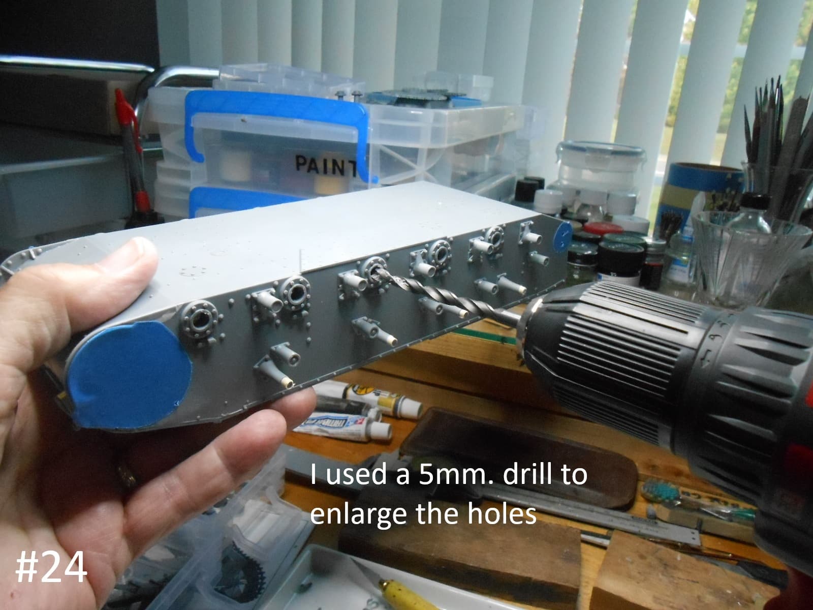

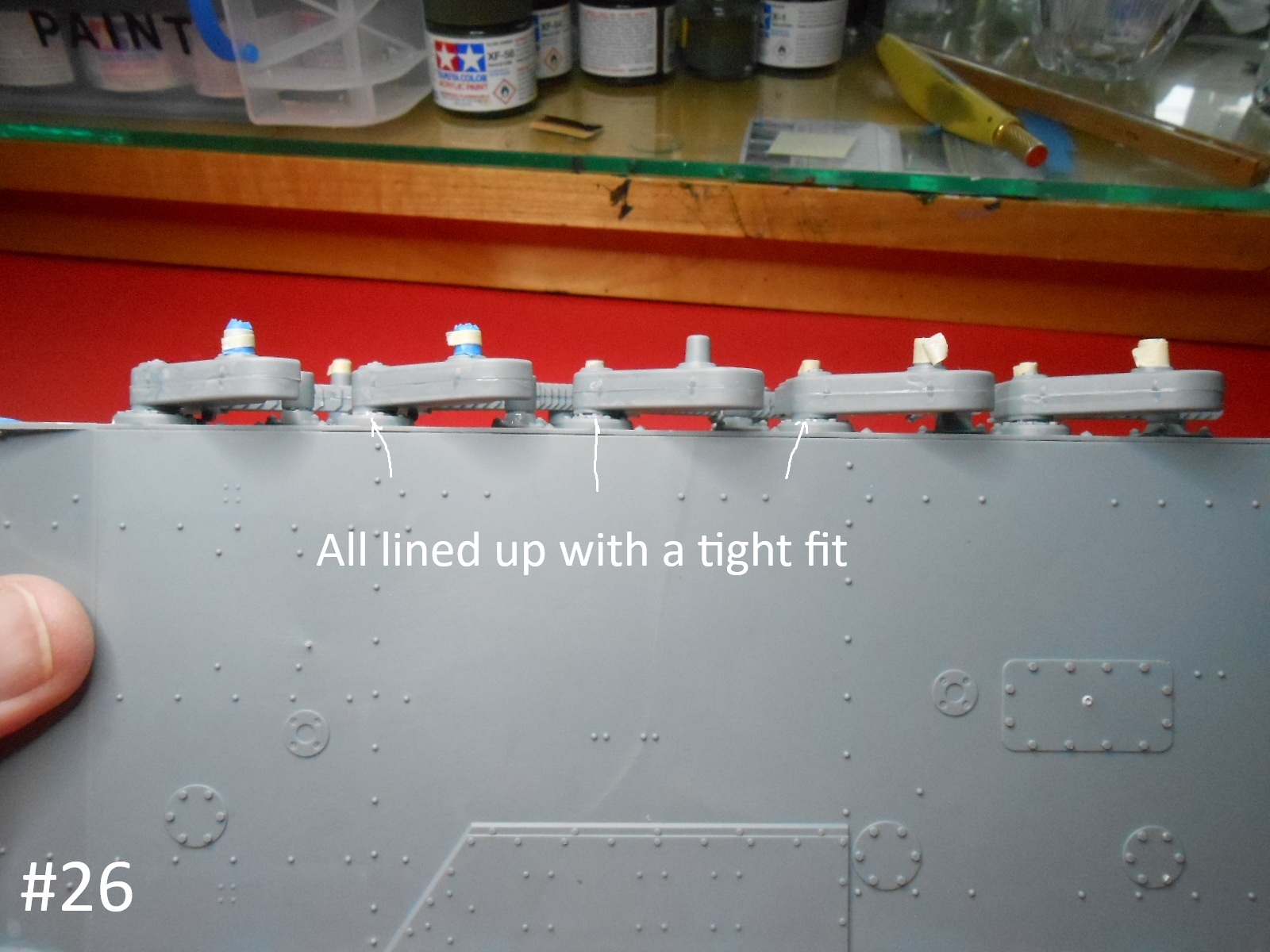

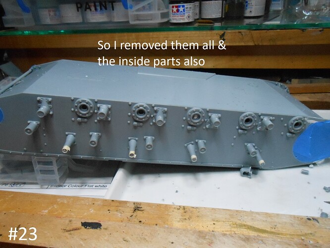

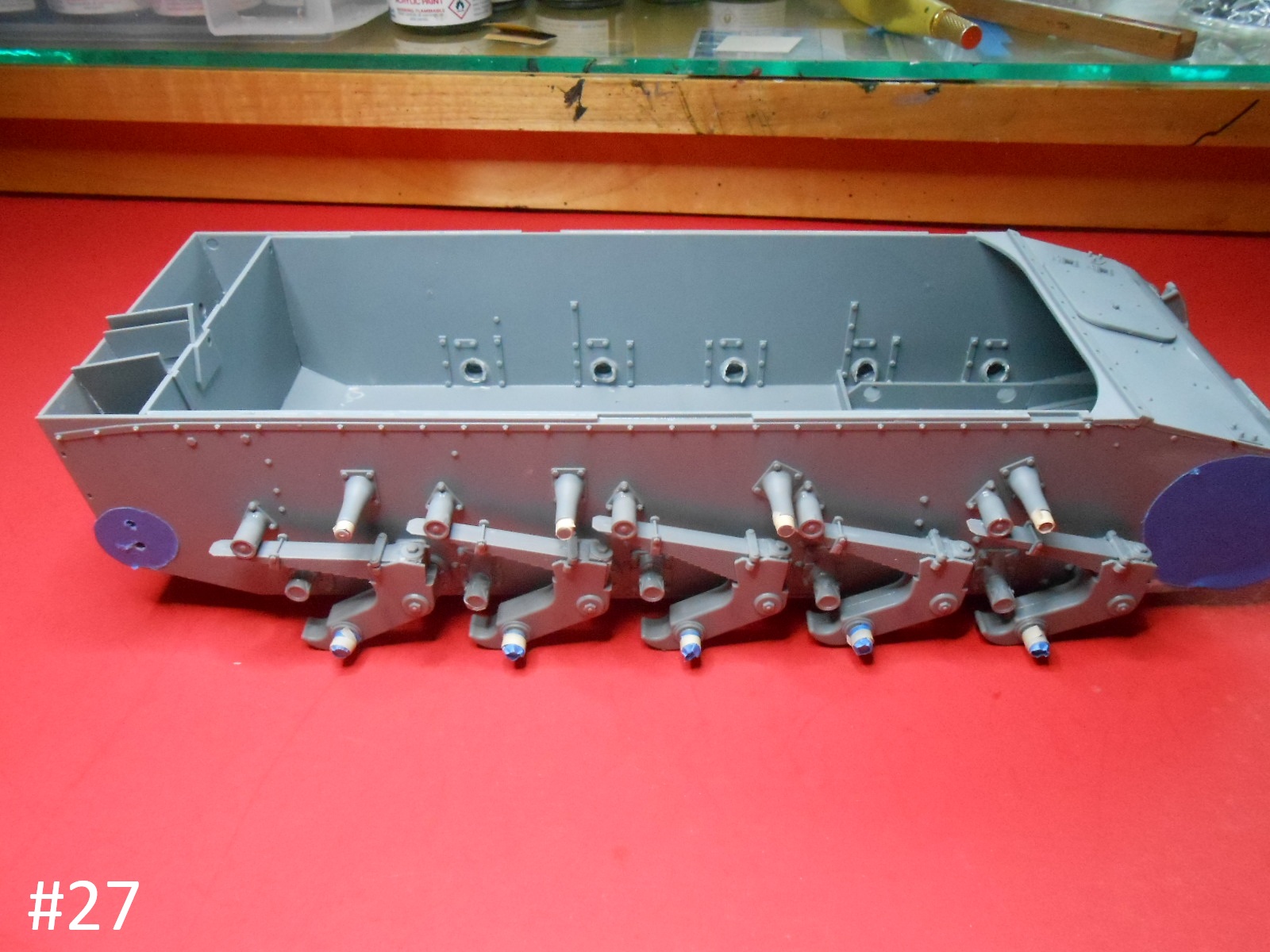

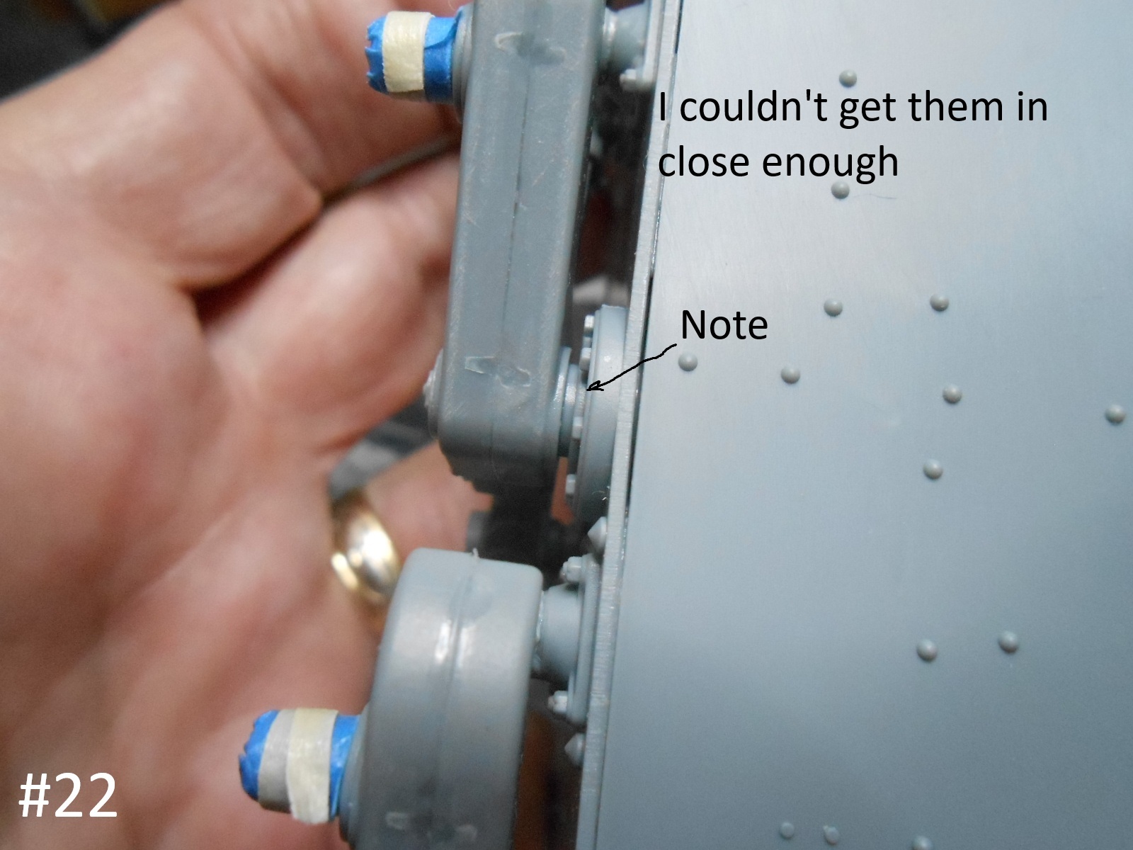

I had a bit of a problem, the Swing Arms kept on coming off.
I Couldn’t get them to mount properly.
it turns out , that while I thought I had it correct, the mounting holes were too small and I couldn’t get a good bond there

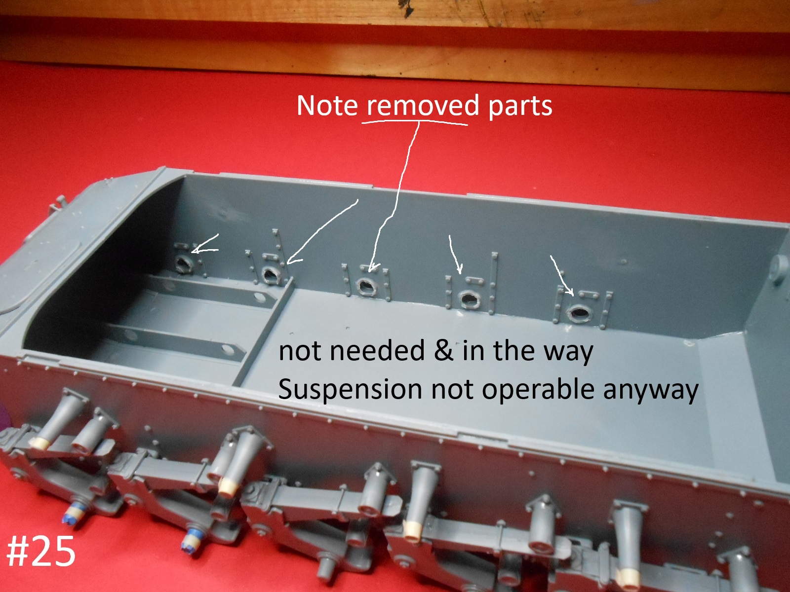

I removed all the arms keeping them numbered so I could get them back on in the correct order.
Now continuing on.

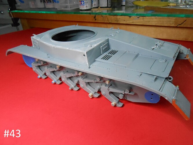

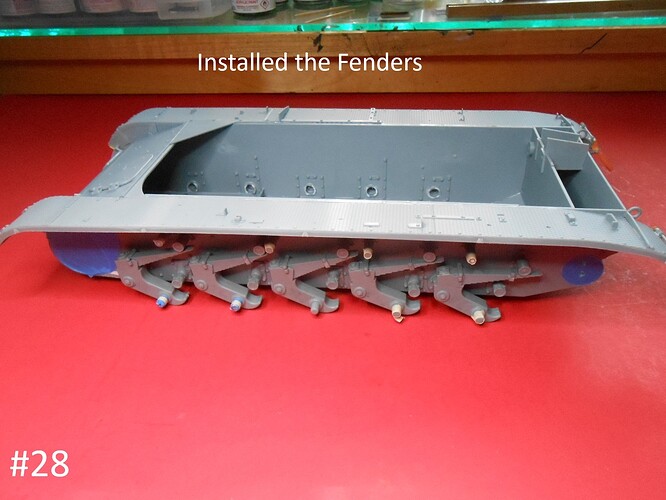

the fenders went on easily
