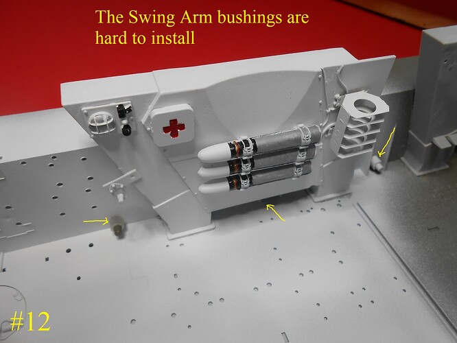

A little more finished , The Bushings that hold the Swing Arms on are very hard to install.

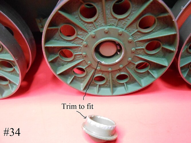

I have the wheels assembled , painted and installed.
Here’s how I did it.

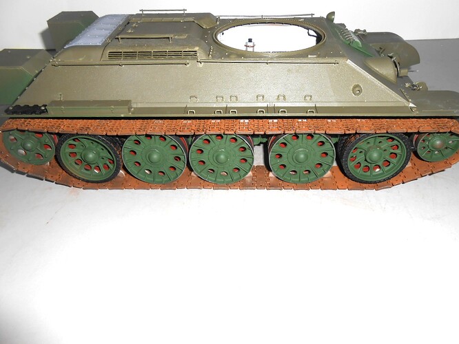

I have the track assembled , painted , weathered , and installed.
The instructions call for 36 of each Horned and flat Track .
Doing this is too sloppy You actually need 35 each.
Here’s the Pics.
I painted the Track with VALLEJO airbrush metal colors Gunmetal Grey.
I wasn’t really happy with them . The Track came out way too shiny .
A little silver Rub and Buff highlited the high spots and the Rust pigments rusted them to what you see.
There will be more dirt and weathering to come.

Nice work Donald. But U wave breaker on the front-hull did not appear until late 44 (or maybe 45) so I would be ahistorical for a 76 with the boxy fuel containers. If you care for such things you should remove them, Also the interior of the wheels should probably green too.
Gabriel
