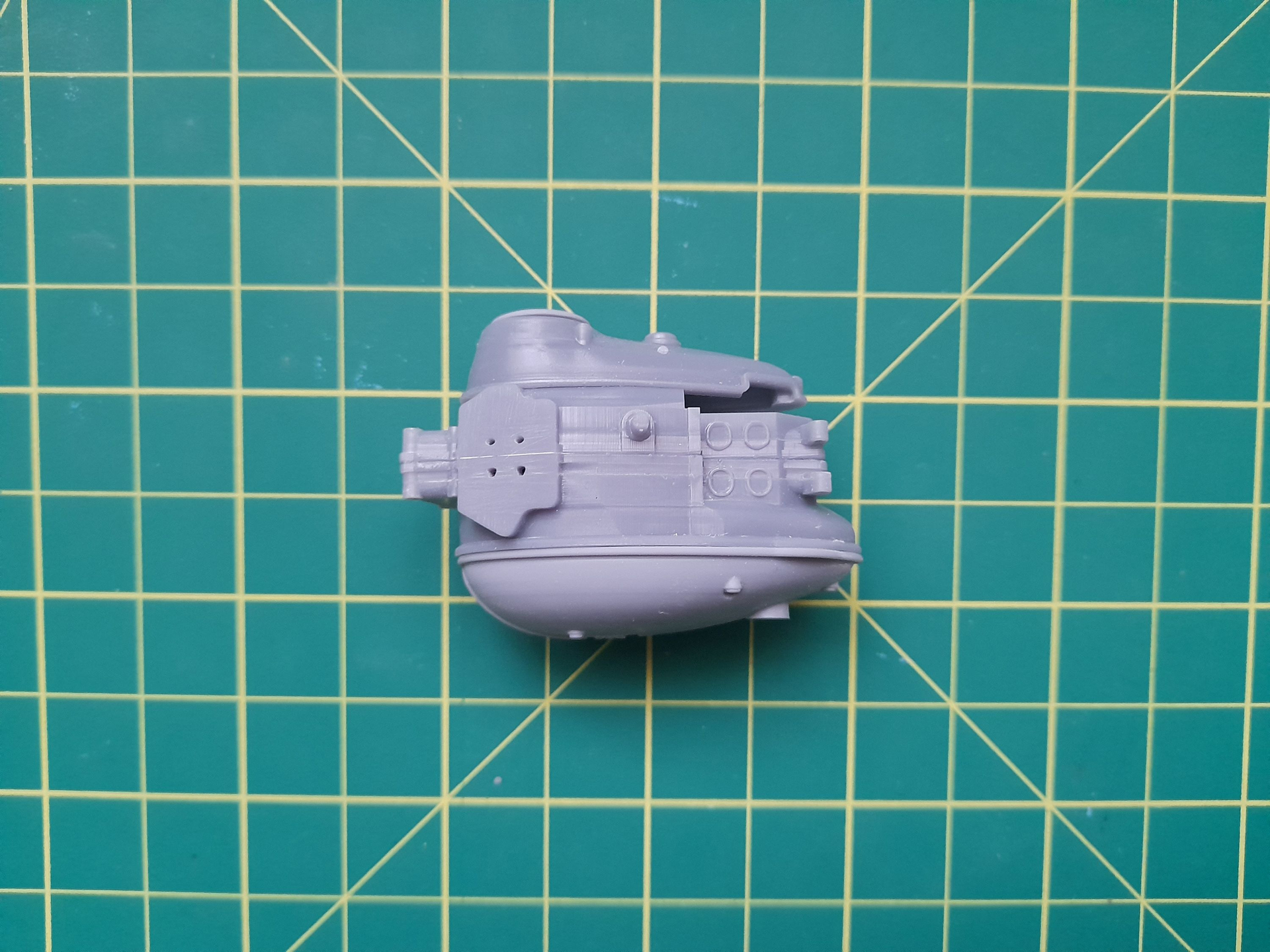

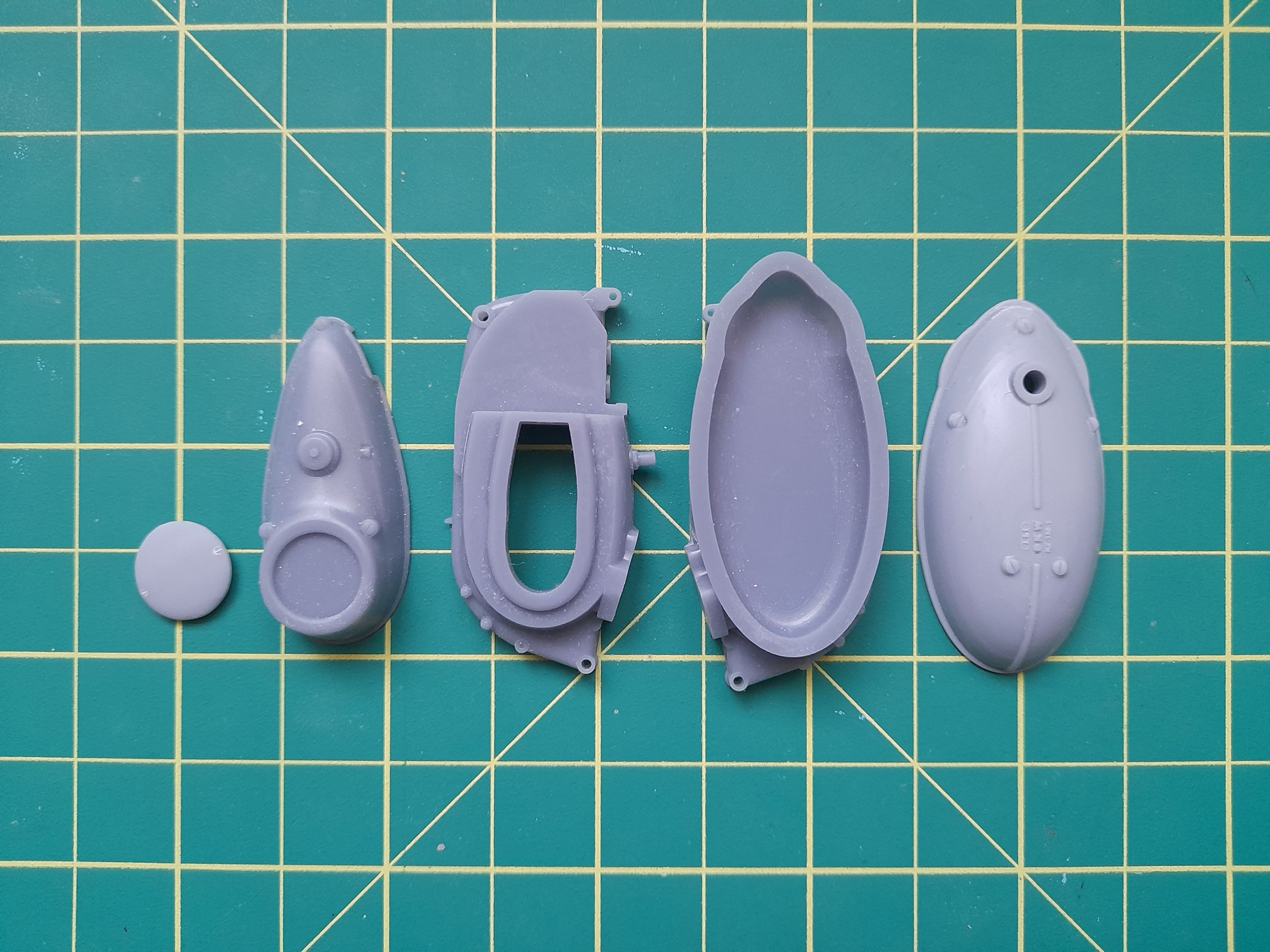

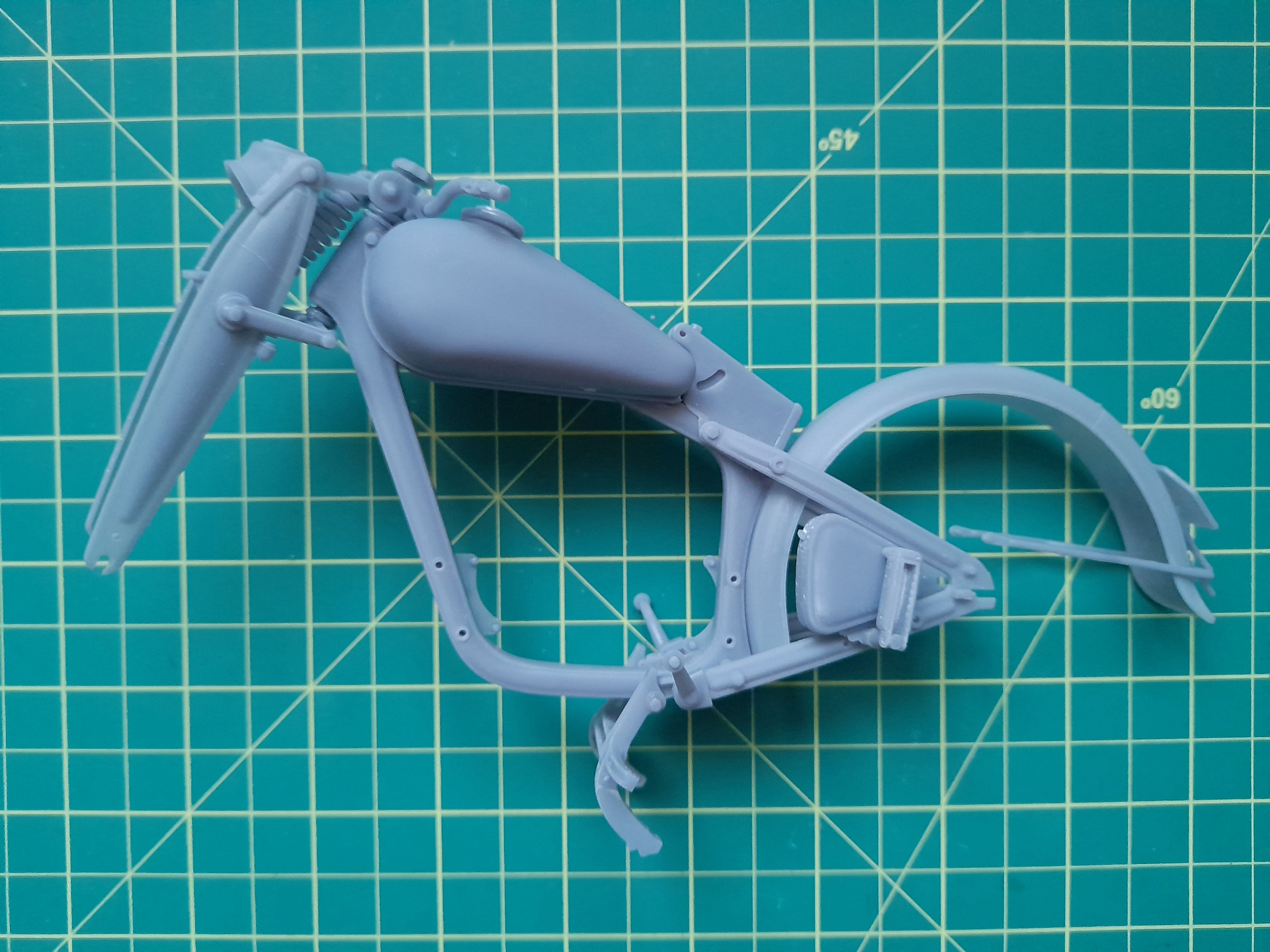

In this episode I managed to assemble the fuel tank. Unfortunately, it wasn’t without its challenges. Firstly, you can’t install the fuel tank with the front suspension already installed. I skipped that step in the instructions because I couldn’t wait to see the complete frame. Now I had to disassemble the front suspension to glue the tank in. It wasn’t easy, because the whole thing is glued with CA, but I managed to cleanly separate the glued parts and then glue them back together.
I don’t know if I glued something wrong, but to get the fuel tank onto the frame, I had to sand it a bit on the top with a nail file.

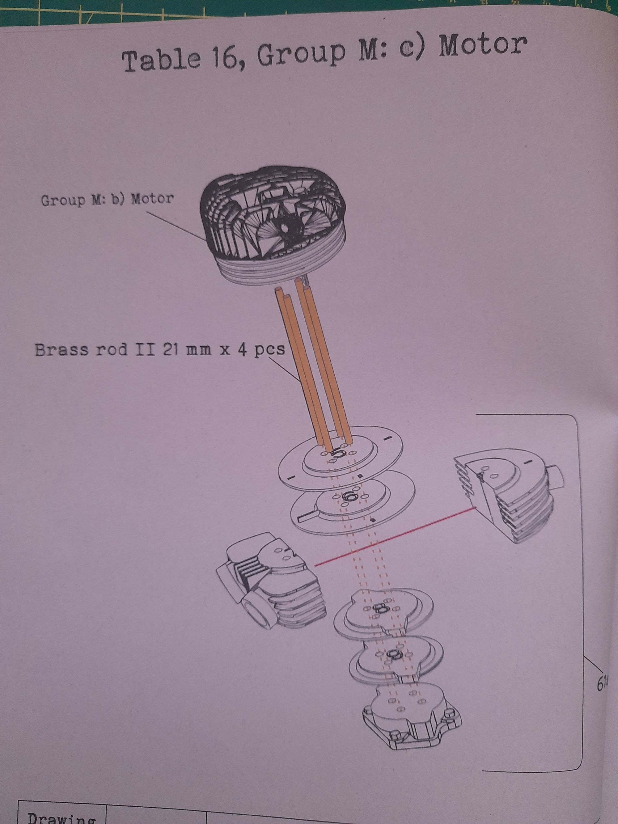

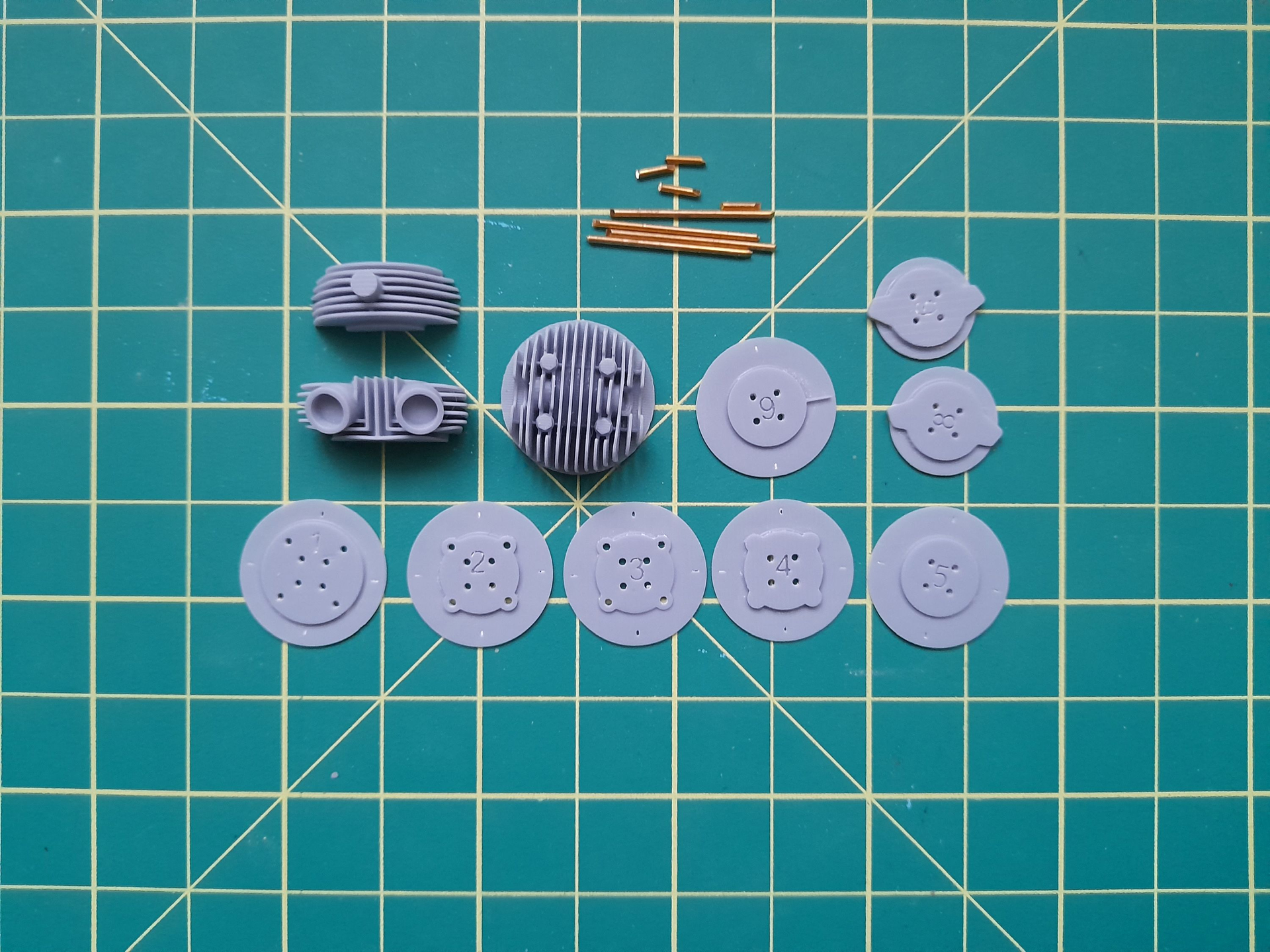

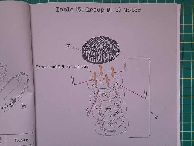

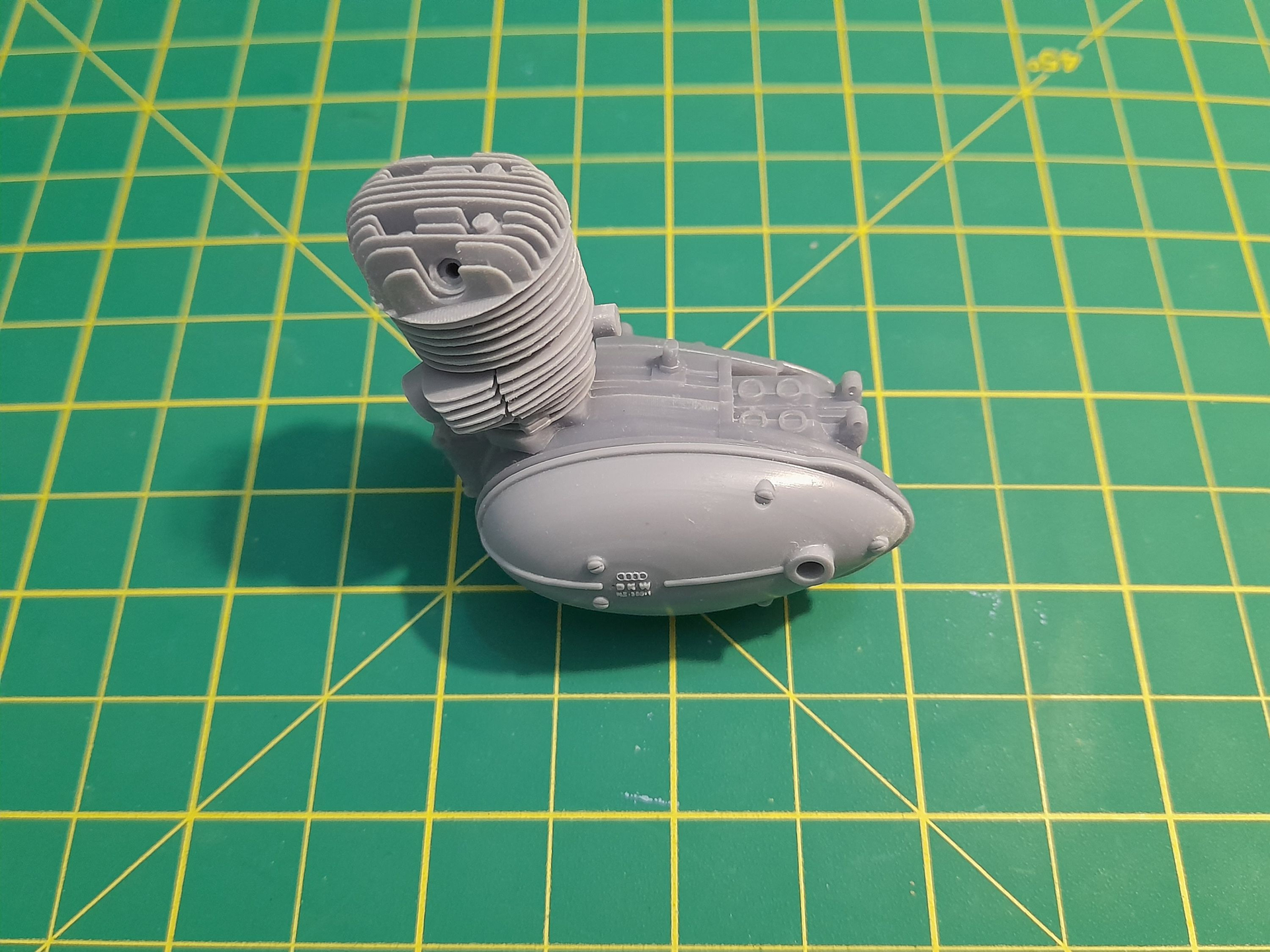

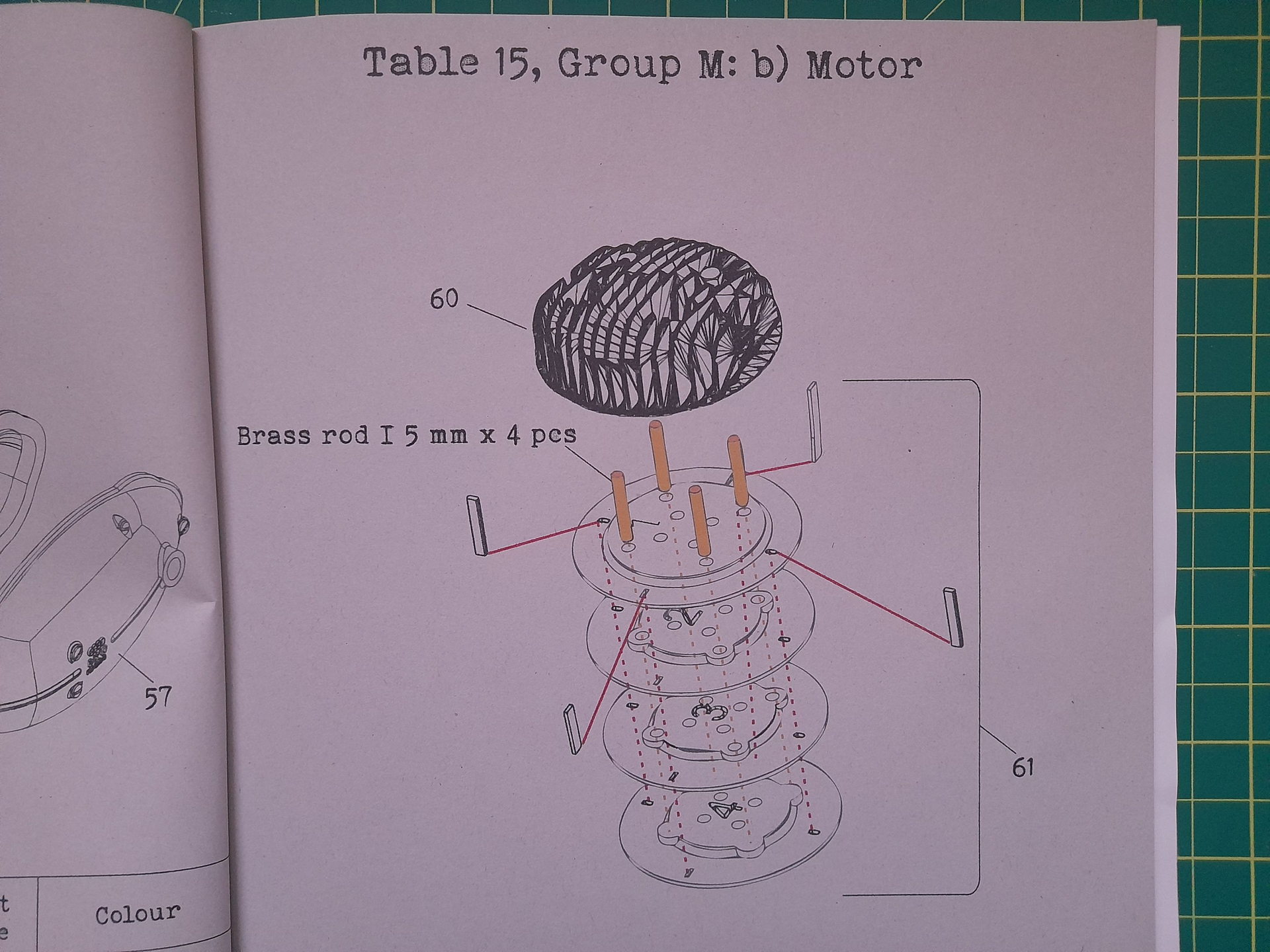

I’d like to show you how the engine was assembled. The instructions detail all the steps for assembling the cylinder, which is cut into slices and connected by brass wires that are included in the kit.
The only thing I changed were the vertical flat bars that fit into the top of the cylinder – I didn’t use printed parts, but cut a narrow strip of aluminum sheet and threaded four of them through the holes in the plates.

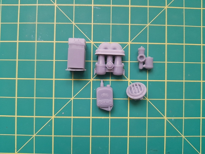

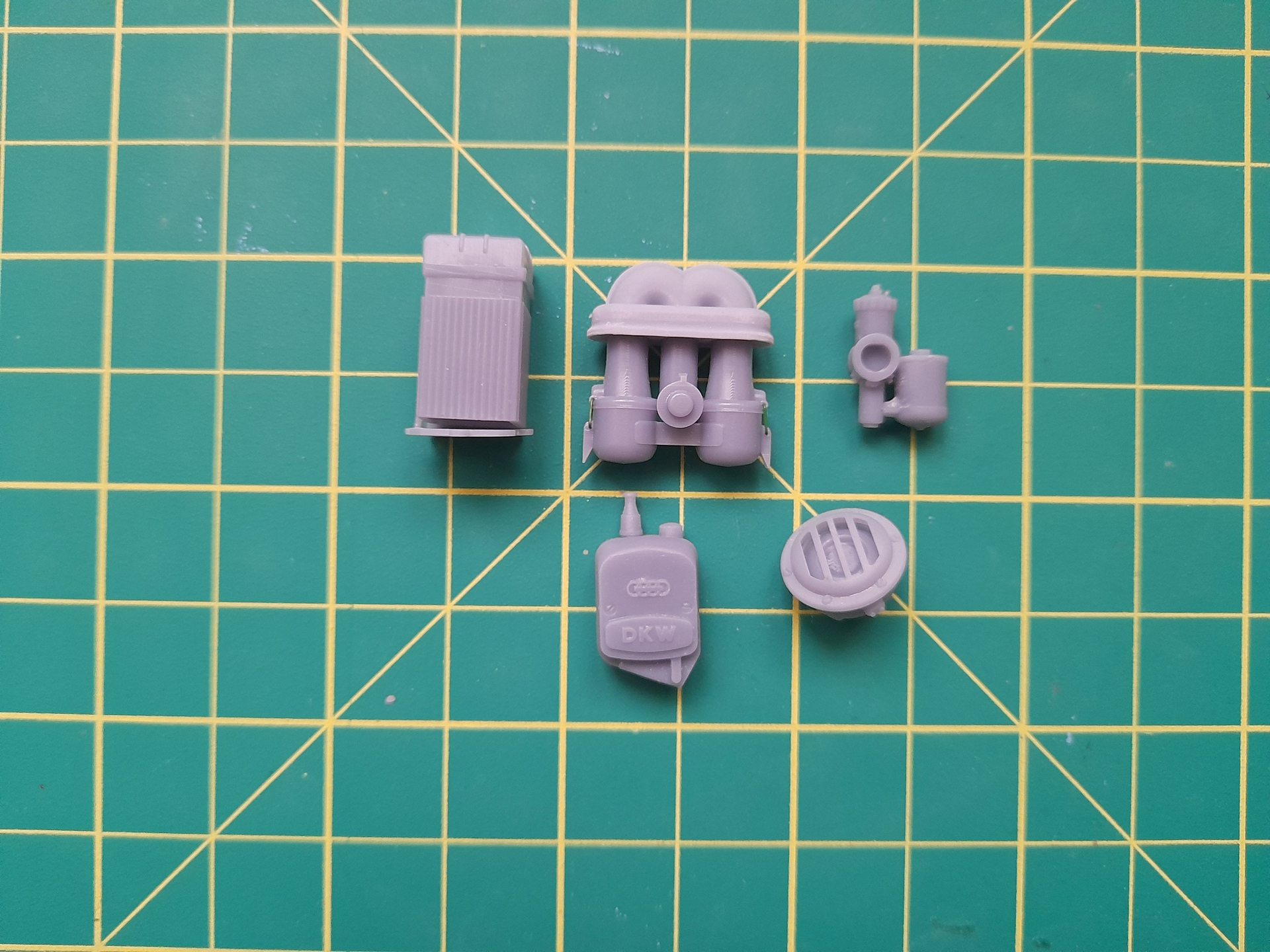

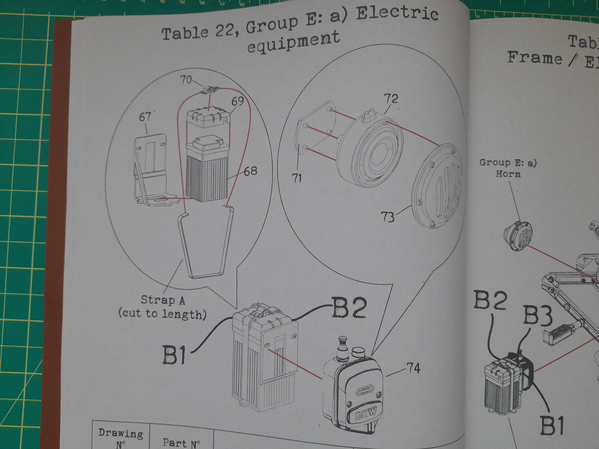

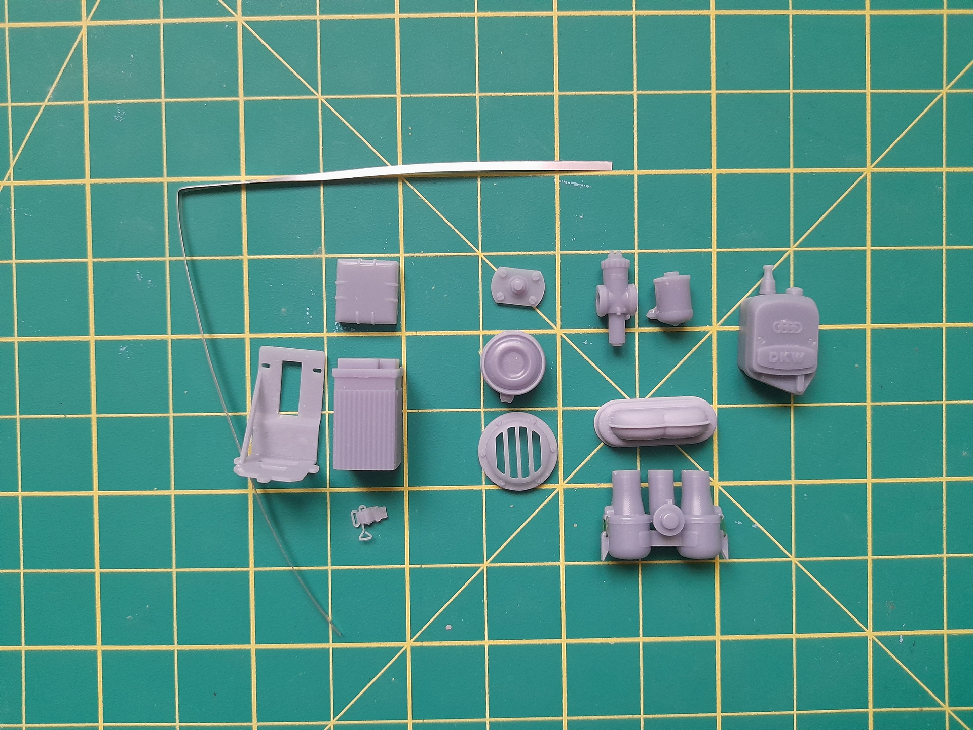

This episode will feature a lot of detail: the carburetor, air filter, battery, horn, and electrical box. The battery comes with a strip of aluminum tape to which you’ll need to attach the latch, which is beautifully printed in one piece. I had to think for a while about the correct order to cut the supports so as not to damage the delicate parts of the latch and key.
The air filter clip parts need to be made from the included 0.3 mm wire, using the template included in the ziplock bag with wires.

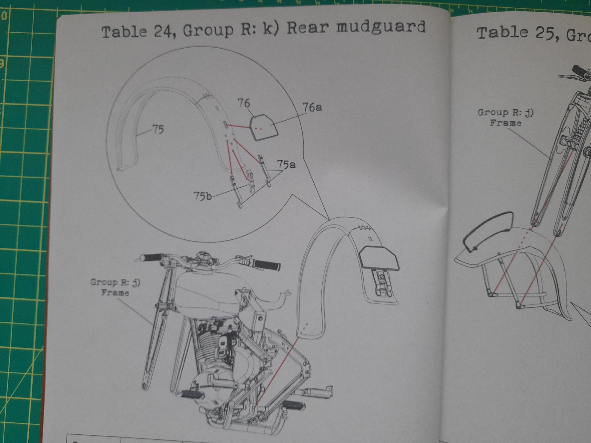

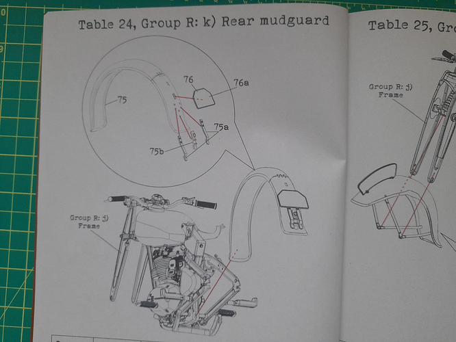

I also managed to assemble the rear fender. The fender mounts and rear license plate are dry-fitted for now.

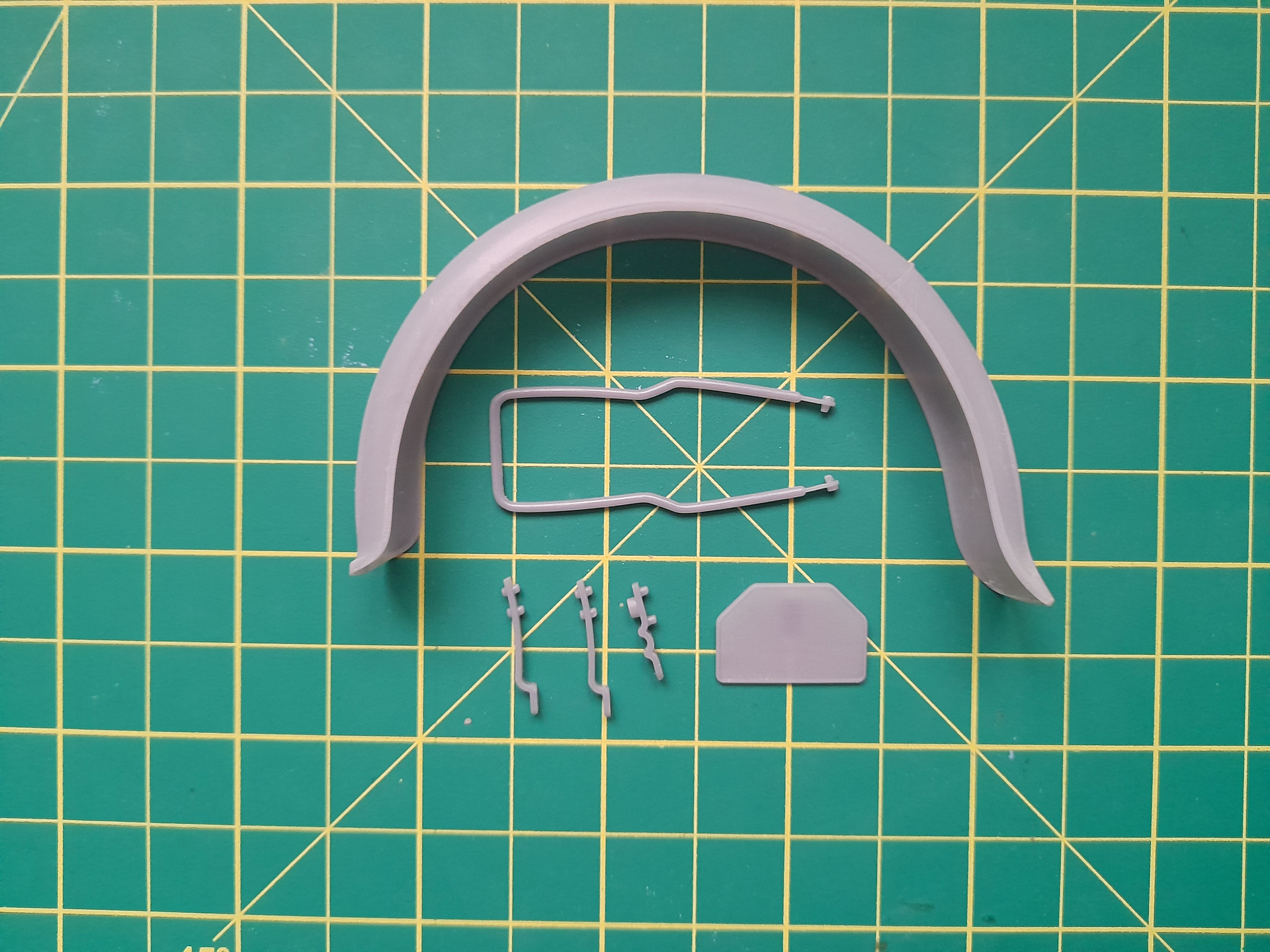

Maybe not much, but I’ve managed to assemble the front fender. Again, the fit is perfect. I just had to sand down some visible layer steps. I can imagine that for this kind of part there is no perfect positioning, and the layers will show whatever you do. Fortunately it is easy to solve as there are no tiny pieces printed together with the fender but smooth surface easy to run along with a sanding sponge.
