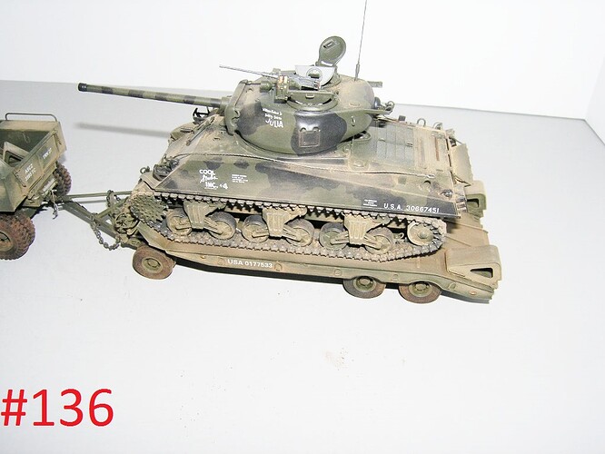

A bit fiddly but there are some nice details showing. Thanks for posting! Are you adding a load too?
Just a Sherman
Regards
Donald

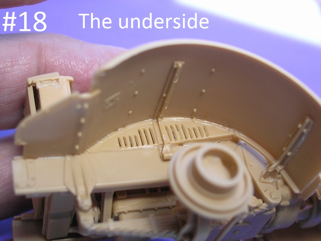

I think you either swapped the rear axles or at least the gearbox on the center-most rear axle. If the gearbox was the other way, the driveline would be in a straight line.
This is actually not that uncommon in truck layouts. The Diamond T 980 had angled shafts:
I don’t know how this pic came about (drawing or retouched photo - a common thing back then) but I find the inward angled rear wheel sets interesting…

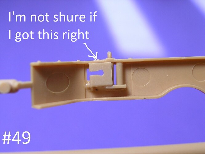

Pic #92. That wheel is the parking brake. When turned clockwise it locks the rear wheels.
I think #93 is where they intend the light relay switch to be located. It is different in the Technical Manual though:
It is not uncommon for different manufacturers to take some liberties like this. It may even be that they researched a surviving trailer which had been modified.
As you can see in the pic, there is another brake actuator wheel on the front of the dolly for the brakes on that. Note also the angle of the blocks. Don’t sweat that, I do not think they had any mounting points. This pic shows them to one side

Here are the final 20 Pics.
This finishes this build
Regards
Donald
