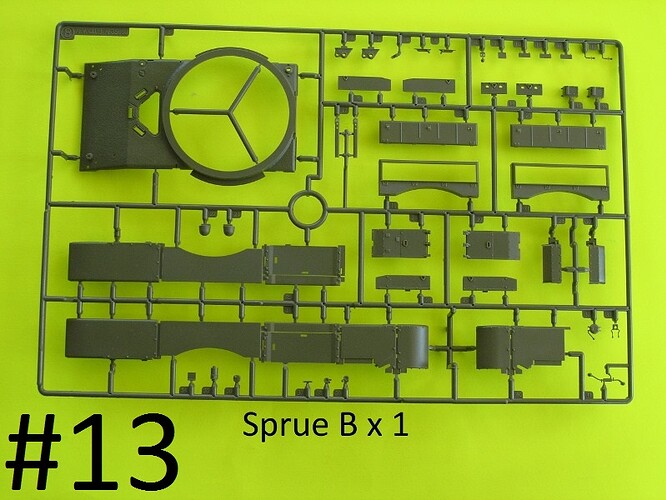

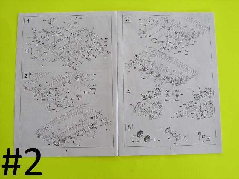

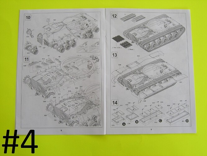

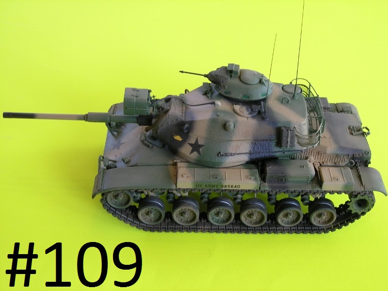

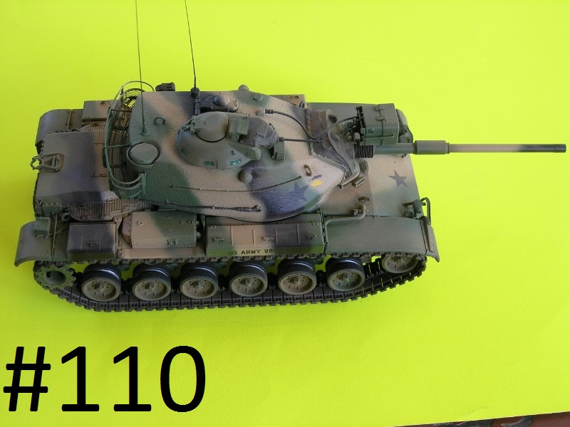

Here’s one of my builds from about 7 Years ago .

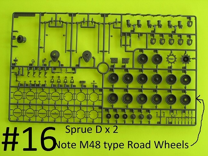

Well these are the parts , Tomorrow the build starts.

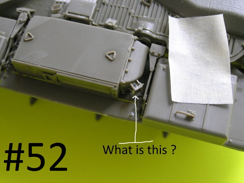

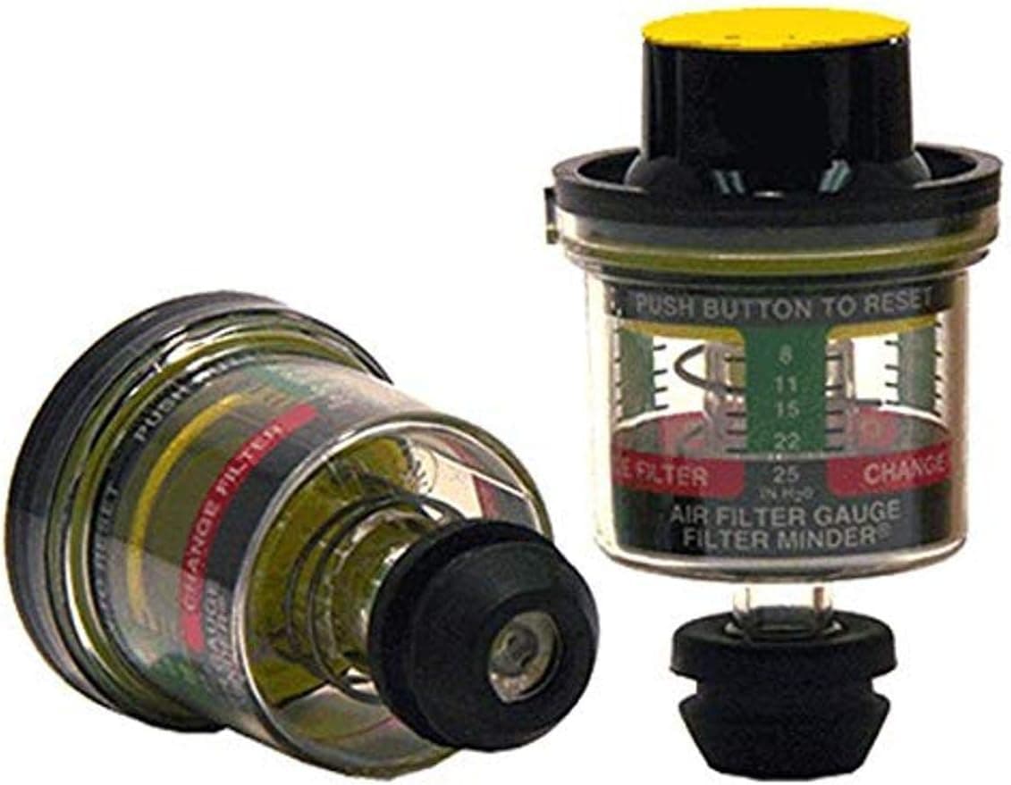

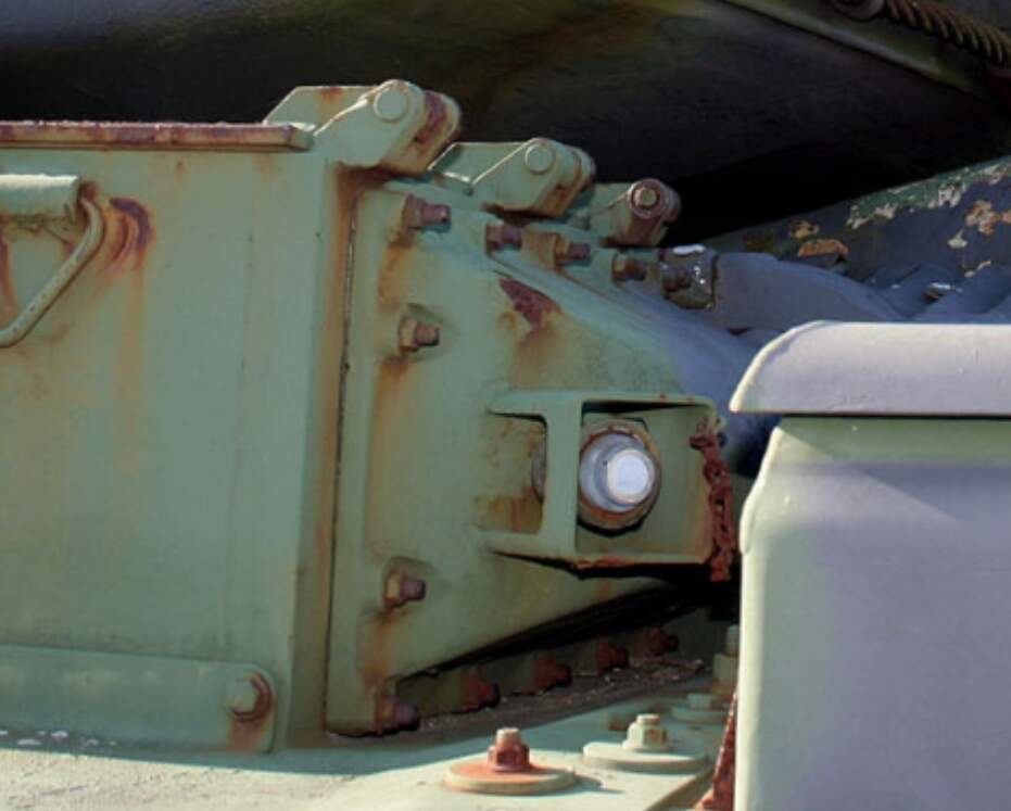

Ditto on what Gino says. The square box is to
Protect the gage from damage, since it’s made of plastic.

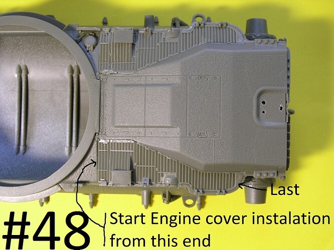

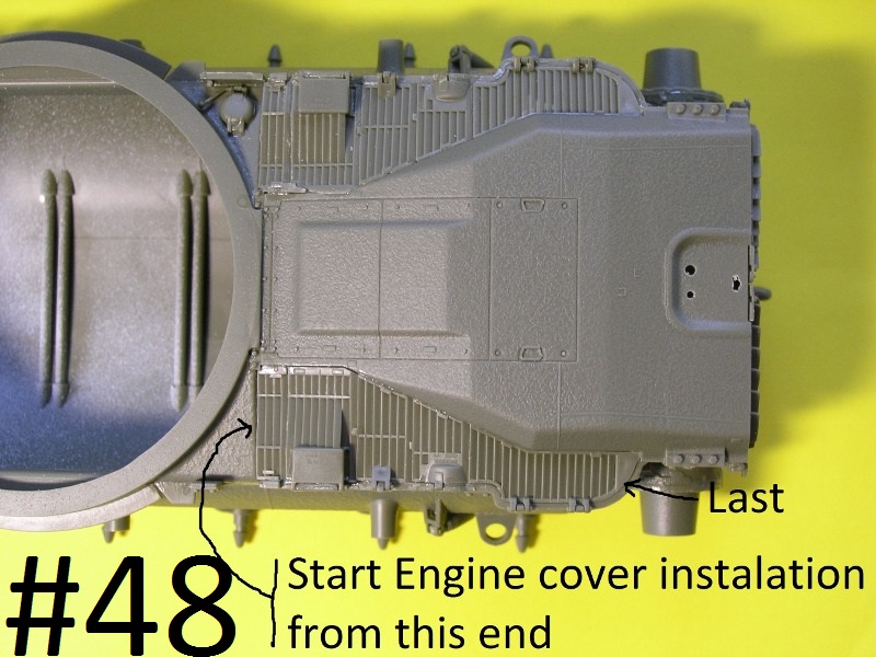

#48. Yes, the real ones are also installed/closed that way, front to back.

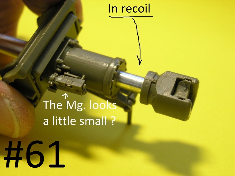

#61. The Mg. is small. It is the M219, a cut down version of the old M1919 in 7.62mm NATO. It was a piece of junk and got replaced by the M240.

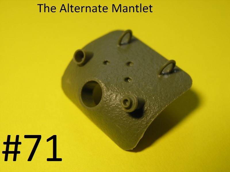

#71. The alternate mantlet is just the regular mantlet without the cover installed. If you look at the old Tamiya kit, that is how they modeled it.
Wow, that was a nice, quick build. I have the USMC version with the ERA and the dozer blade; might tackle that one soon.
Not quite that quick , i wish.
note the title this was from 2015 about 8 years ago.
I’m not trying to fool anyone , that is why I put the date of the build in the Title.

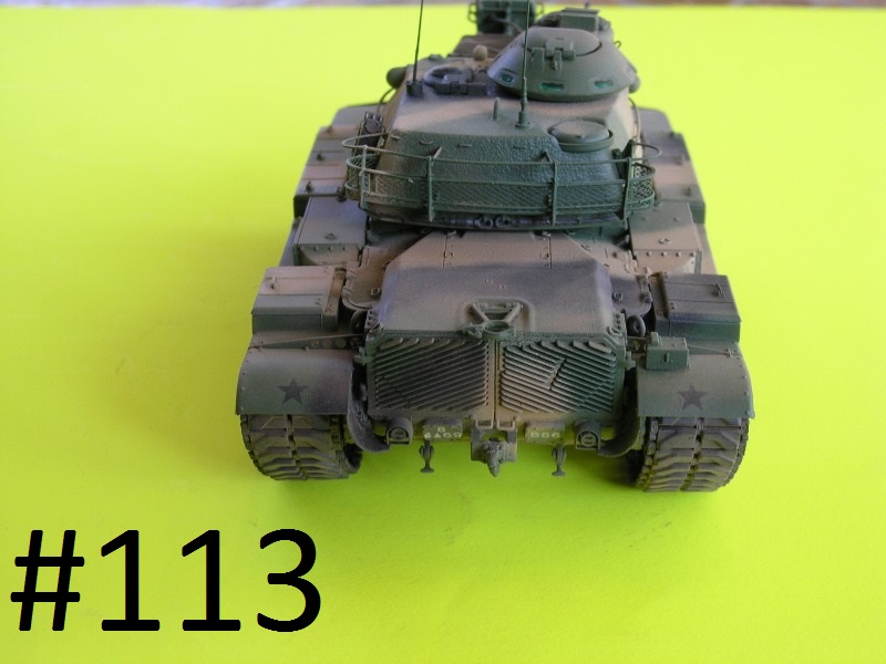

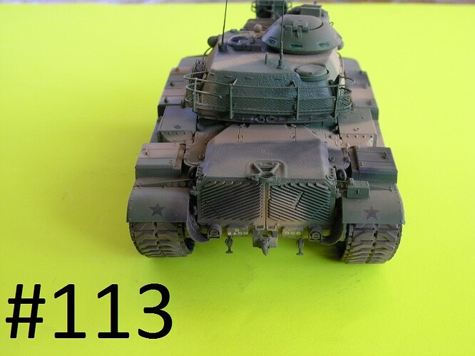

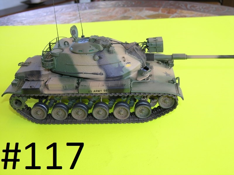

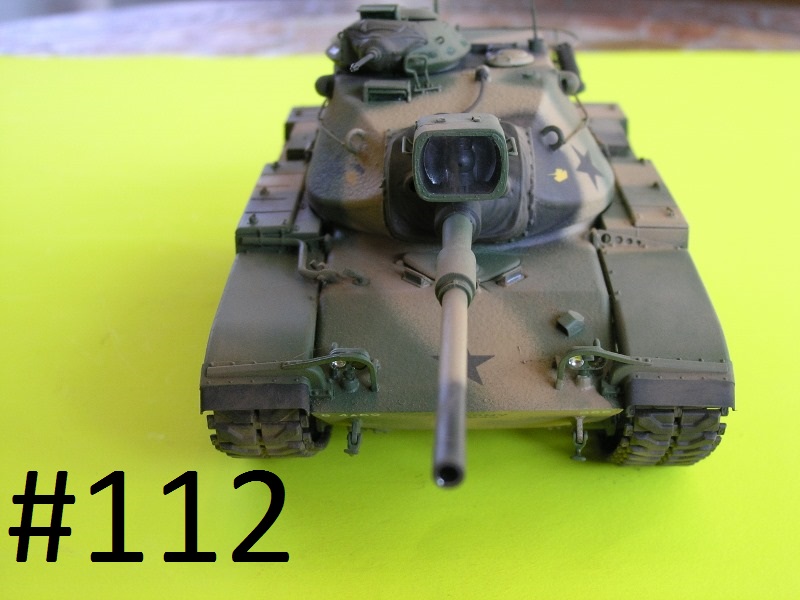

Still; a very nice build. I’ll be honest; the M60 Series of MBTs is one of my favorites from the Cold War era.
Nice build.

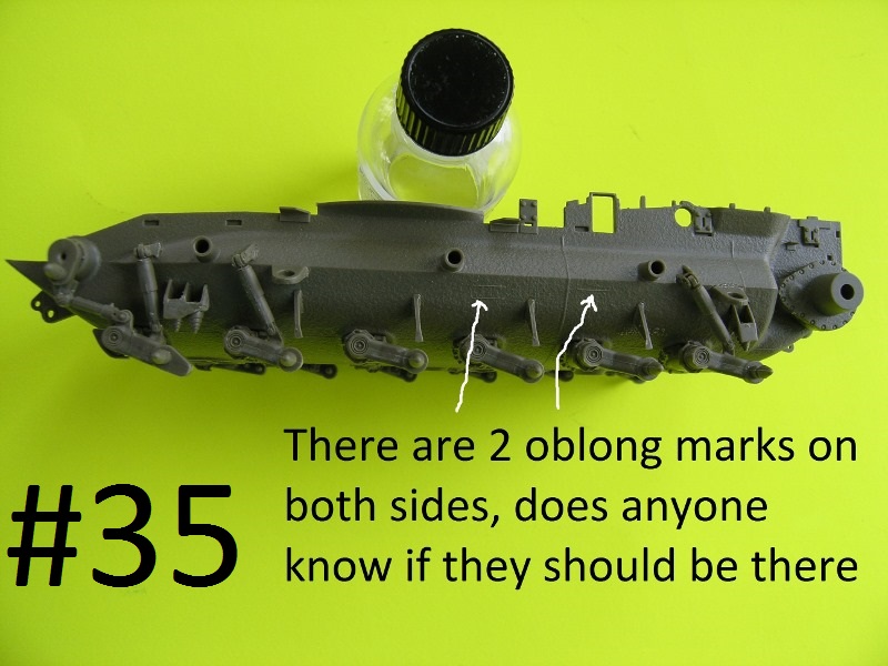

#35 2 oblong marks: these are for additional lifting eyes on some M60A2
