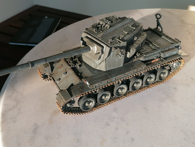

I’m inspired again - not the same but I should finish this one someday soon:

I have build the one (FV4004)
So what could be improved?

Thank you, Ossie. I will.
