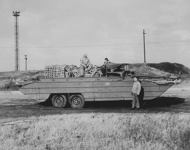

One thing is confusing to me in the engine exhaust and where it is located. You modified the intakes.
Hi Ryan, that is a good question. Where is the exhaust on the DUKW? Maybe it´s located in a similar place?
I founds this video, but it gives no explanation…
https://www.youtube.com/watch?v=BzLTJfivKs4
My book says that is was based on Zil-151 components.
Unfortunately I cannot find my copy of Doyle’s Dukw book. I did find this where it appears to come out a pipe on the starboard side intake.
The video was interesting, I think the automatic tire inflation was a BTR-152 item.
Here are two pics from the Doyle book that show the position of the exhaust; the extension in the 2nd one seems to have been a one-off version, as it doesn’t appear in any of the other photos in the book. Happy modeling!
Peter
DUKWs had it as well. You can recognise it on some by the air lines on the outside of the wheels:
Thanks Paul. Jakko’s photo shows probably another limited mod exhaust to keep it away from general public’s face.
