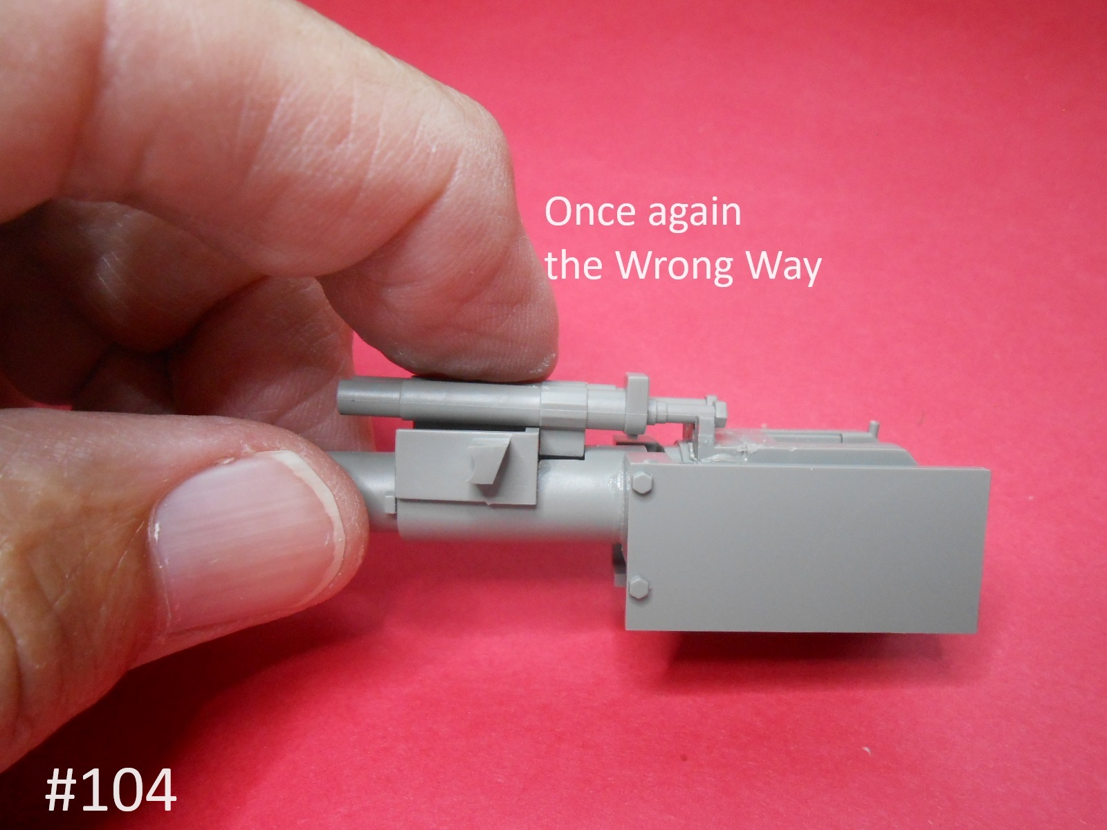

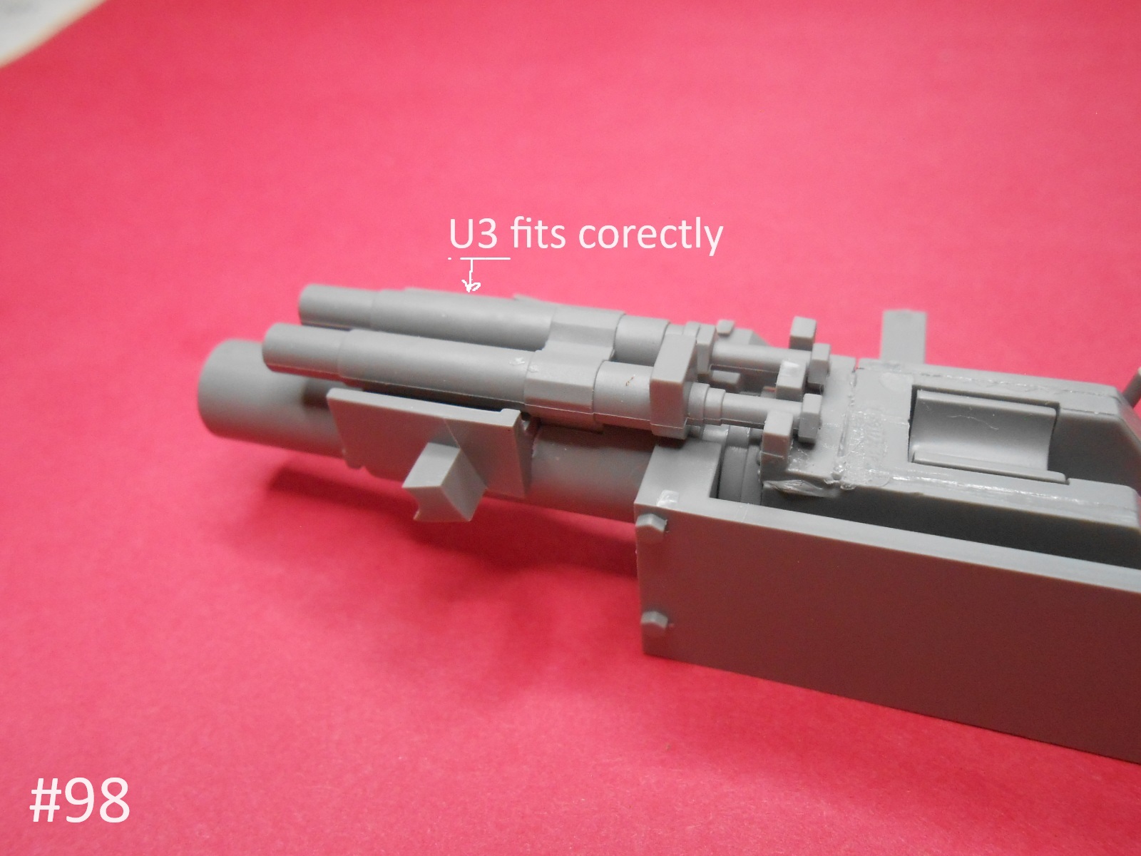

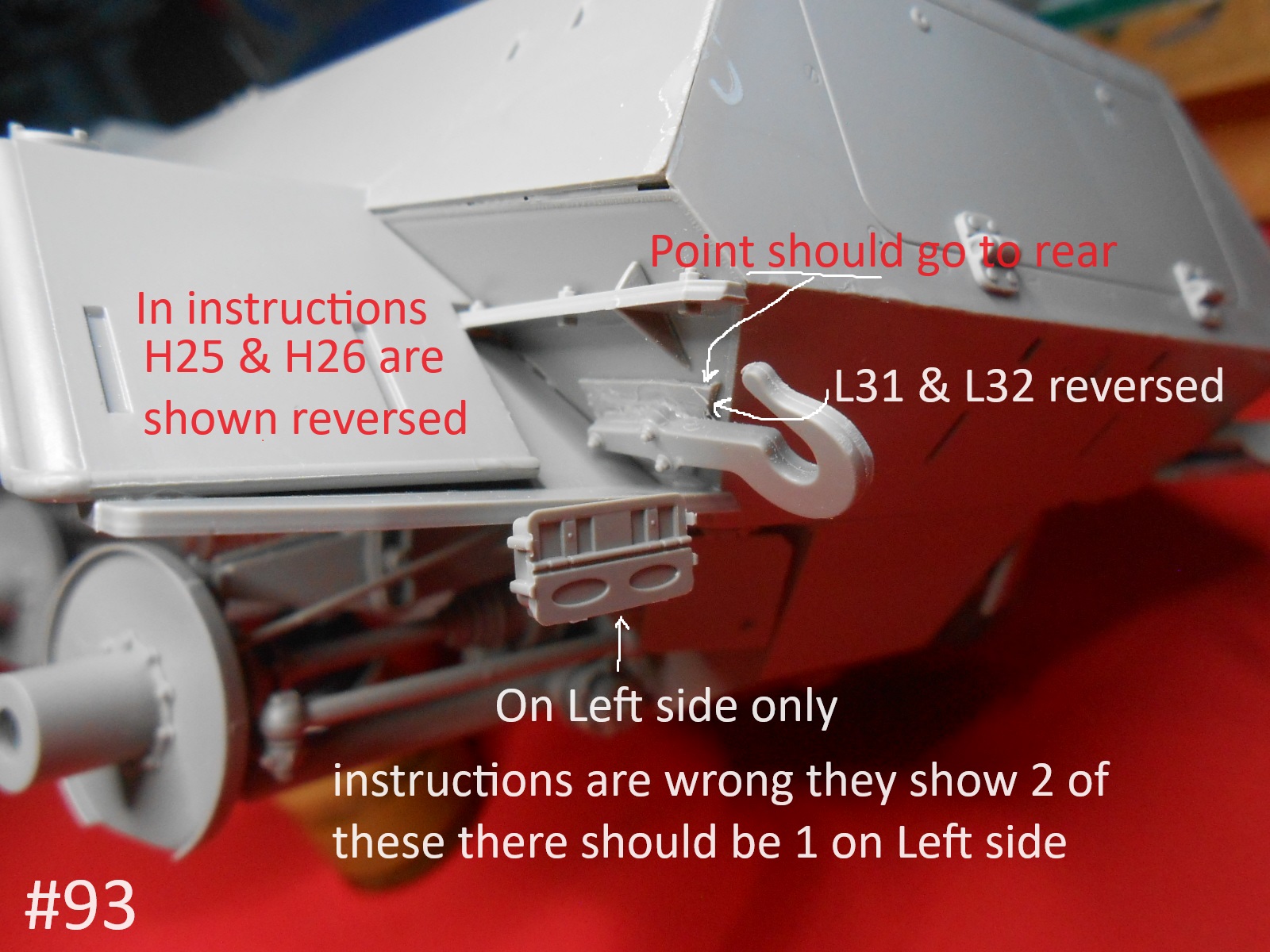

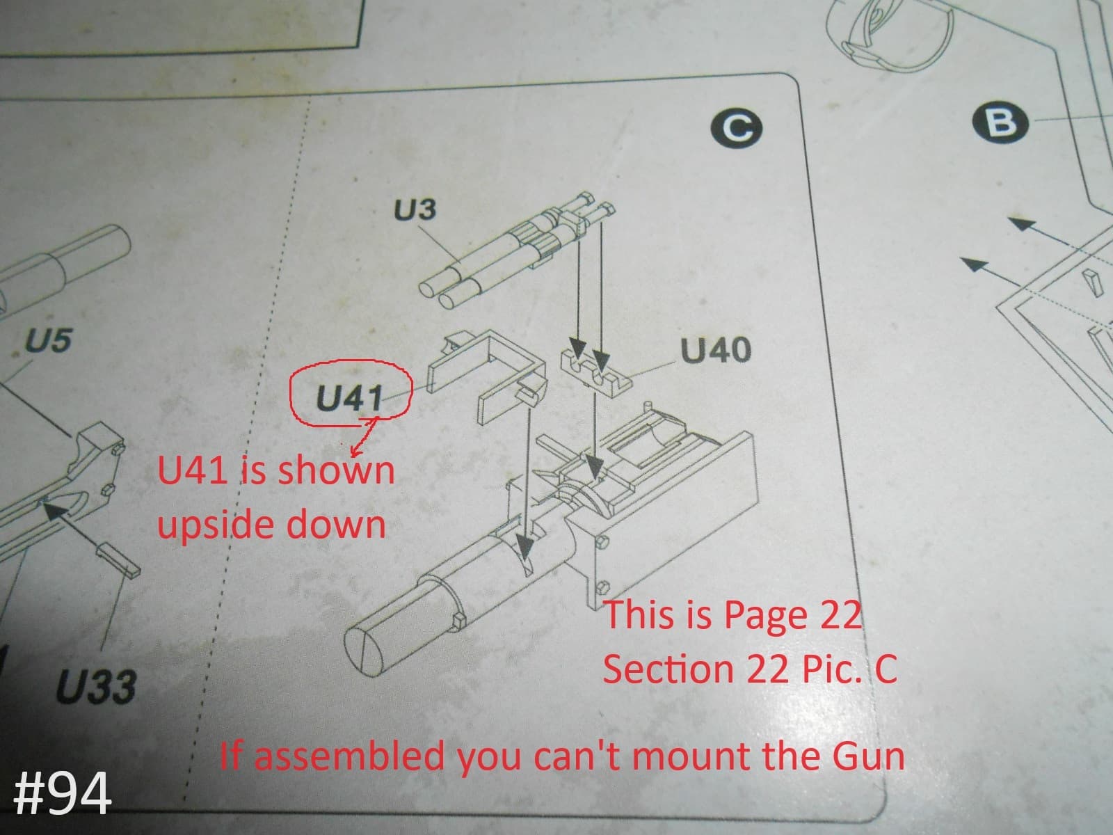

Just a quick correction not my mistake but the instructions show
L31 & L32 reversed and pointing in the wrong direction.
On page 17 the Convoy light is shown on the wrong side, it should be on the Left side.
On page 18 one is shown on both sides, this is wrong as there should be only 1 on left side.
Parts H25 & H26 are shown the wrong parts, they only fit one way/

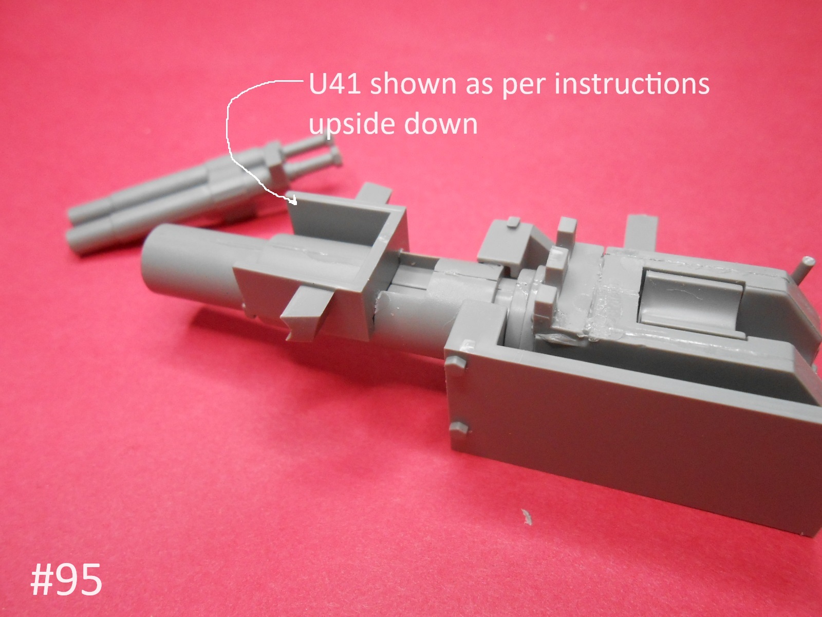

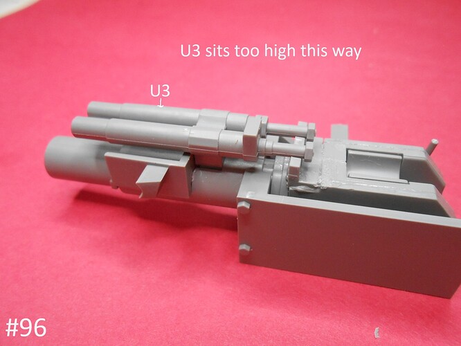

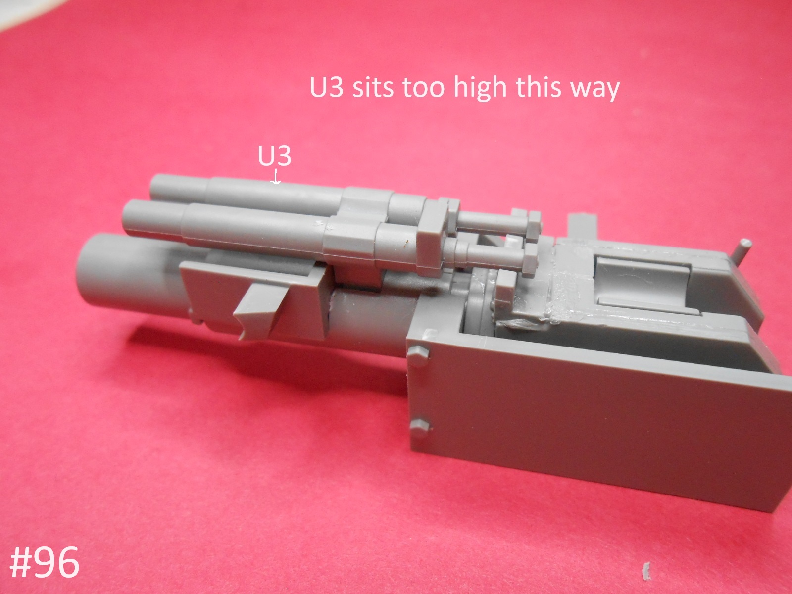

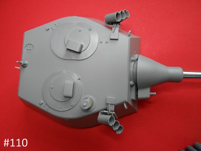

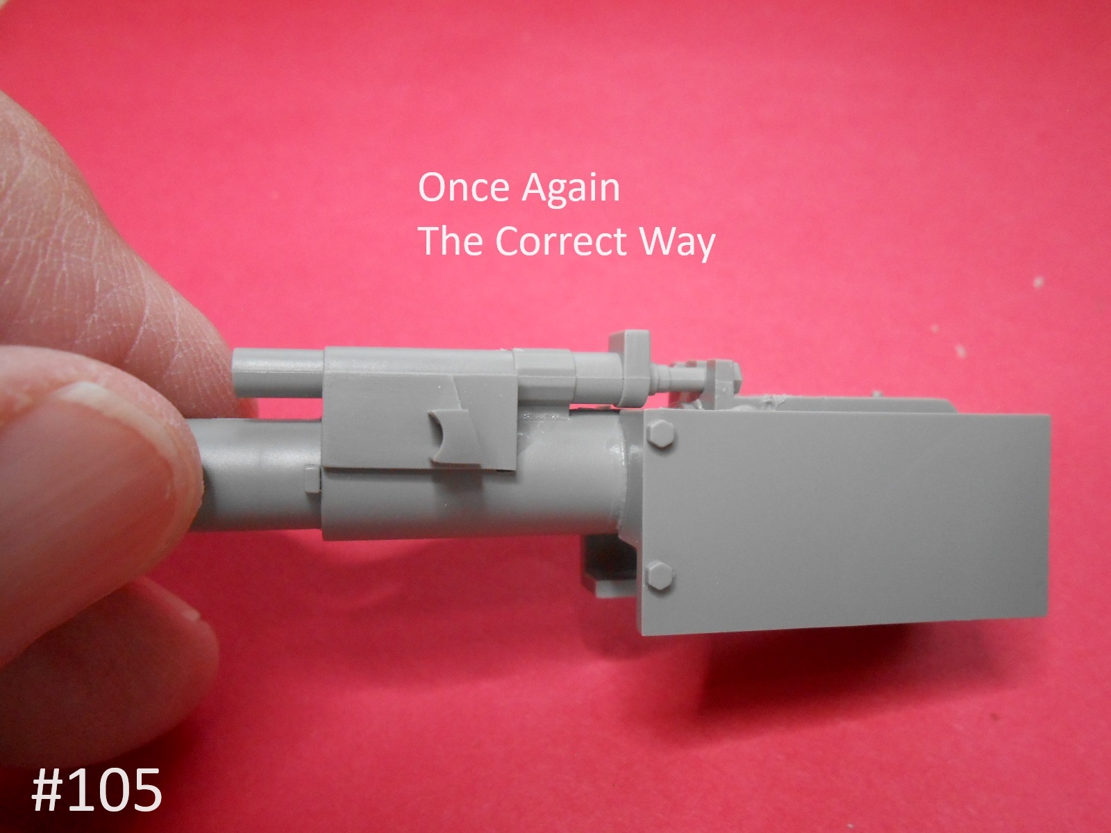

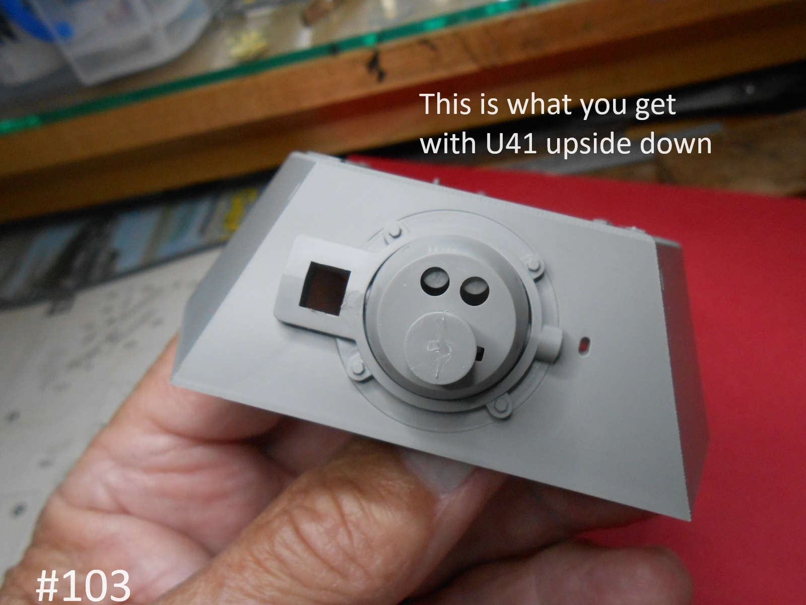

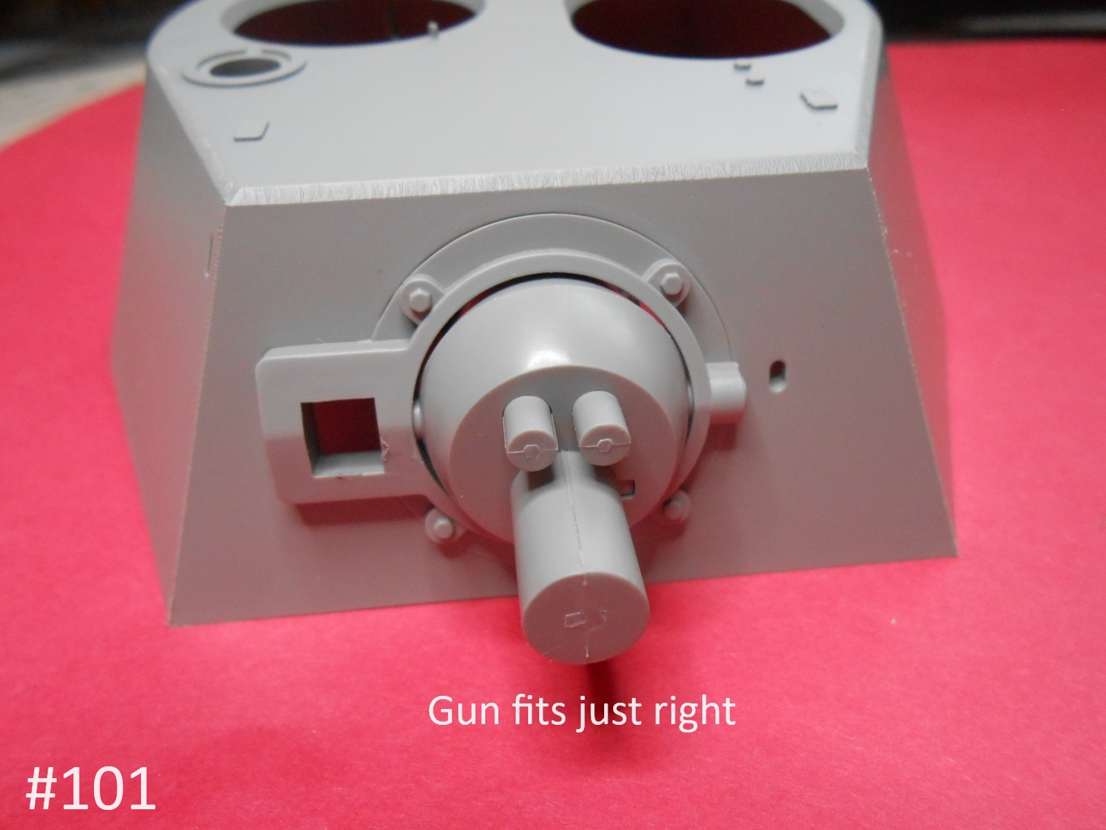

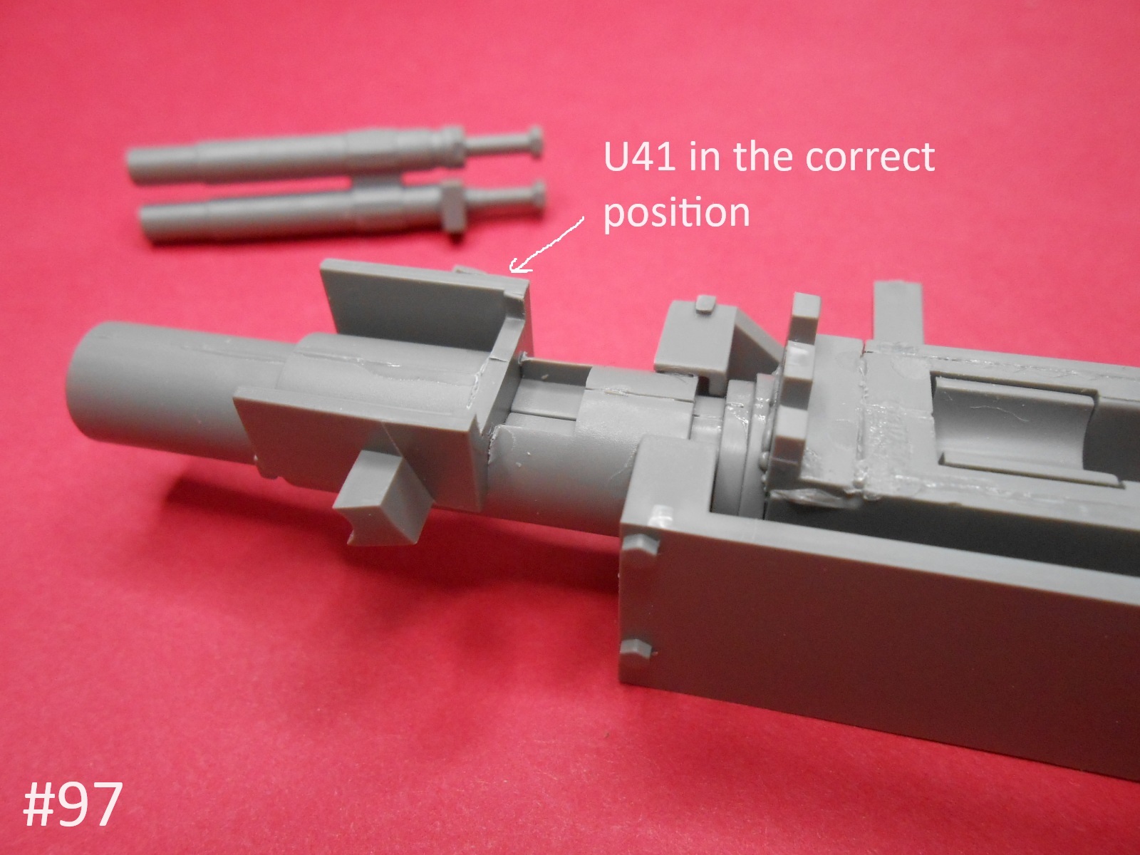

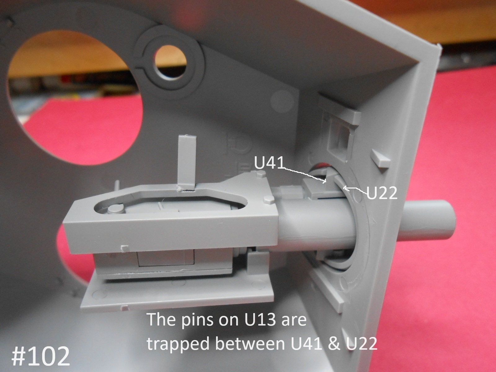

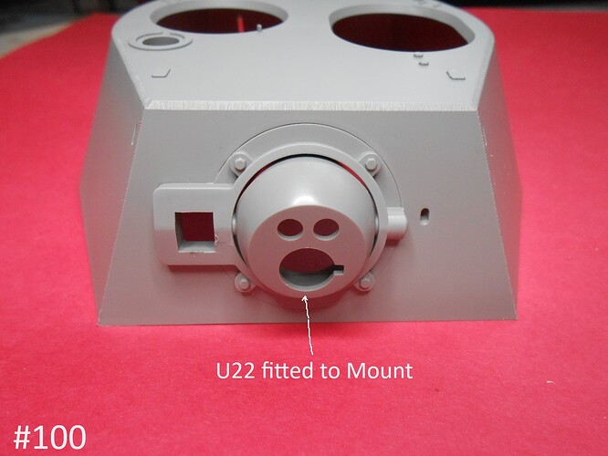

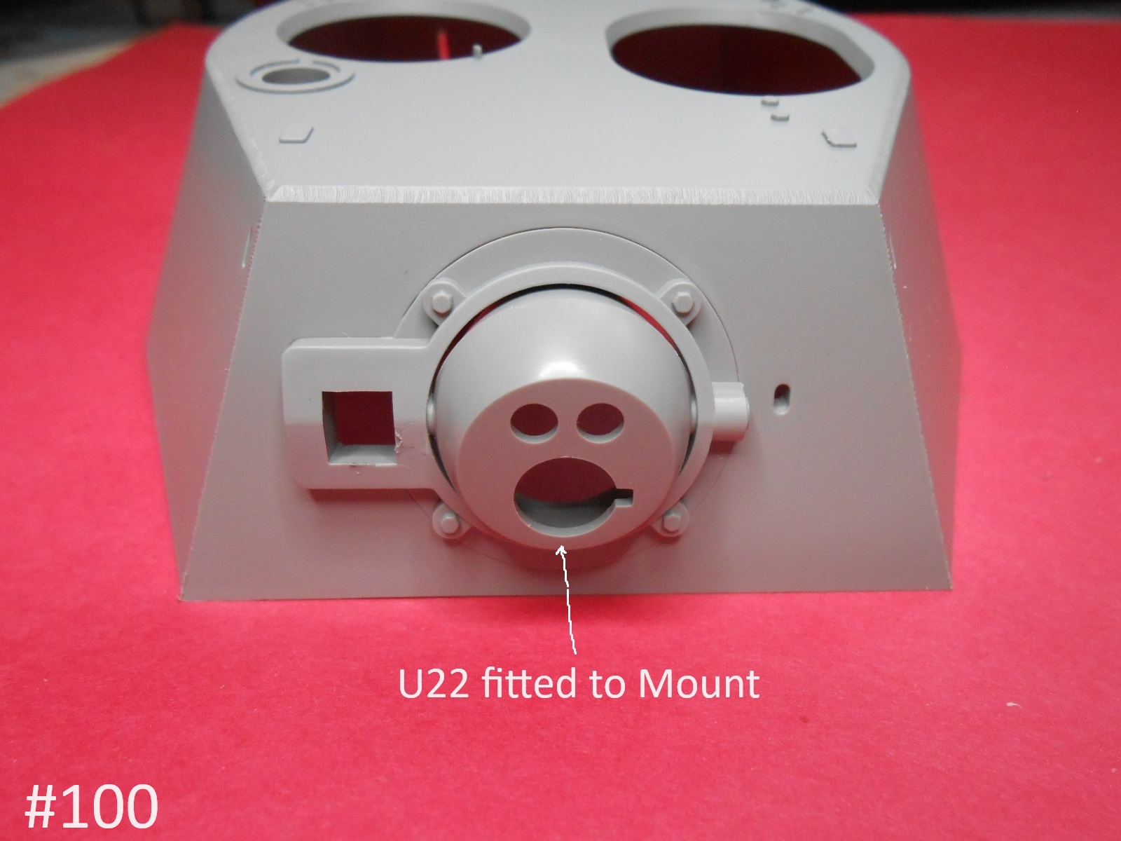

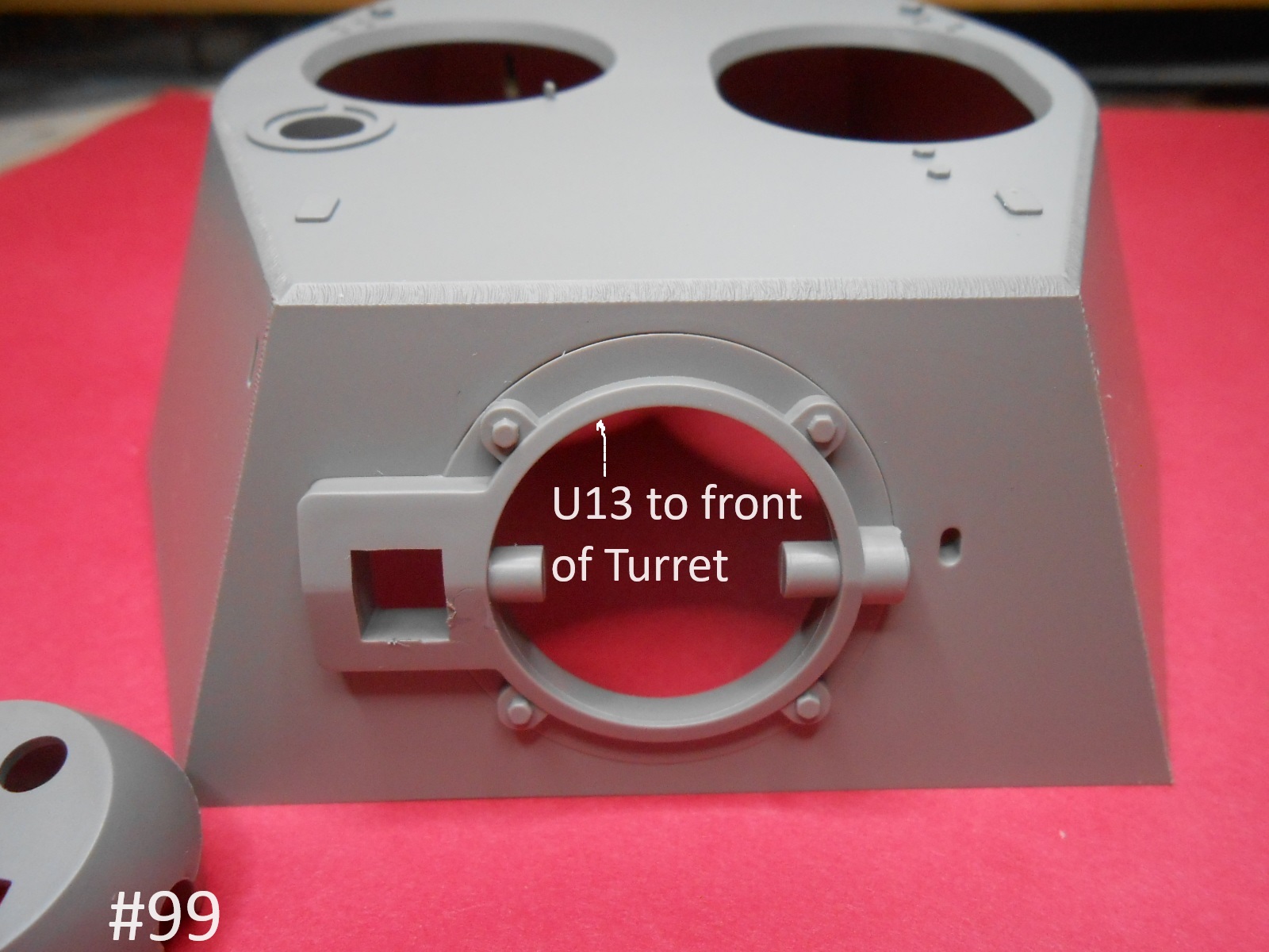

I have some of the Gun & Turret finished, There is a mistake on the Instructions that need your attention if you are building this kit.
Once again all the info. is on the Pics.
Now the Pics.
That’s all I have for today.
Donald

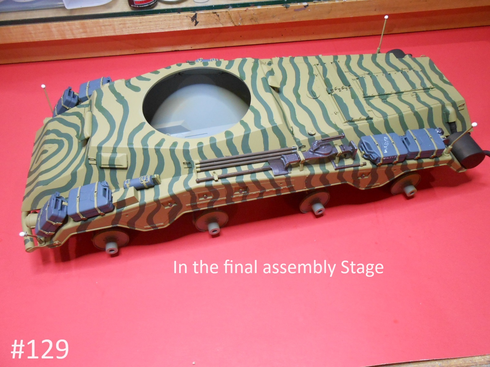

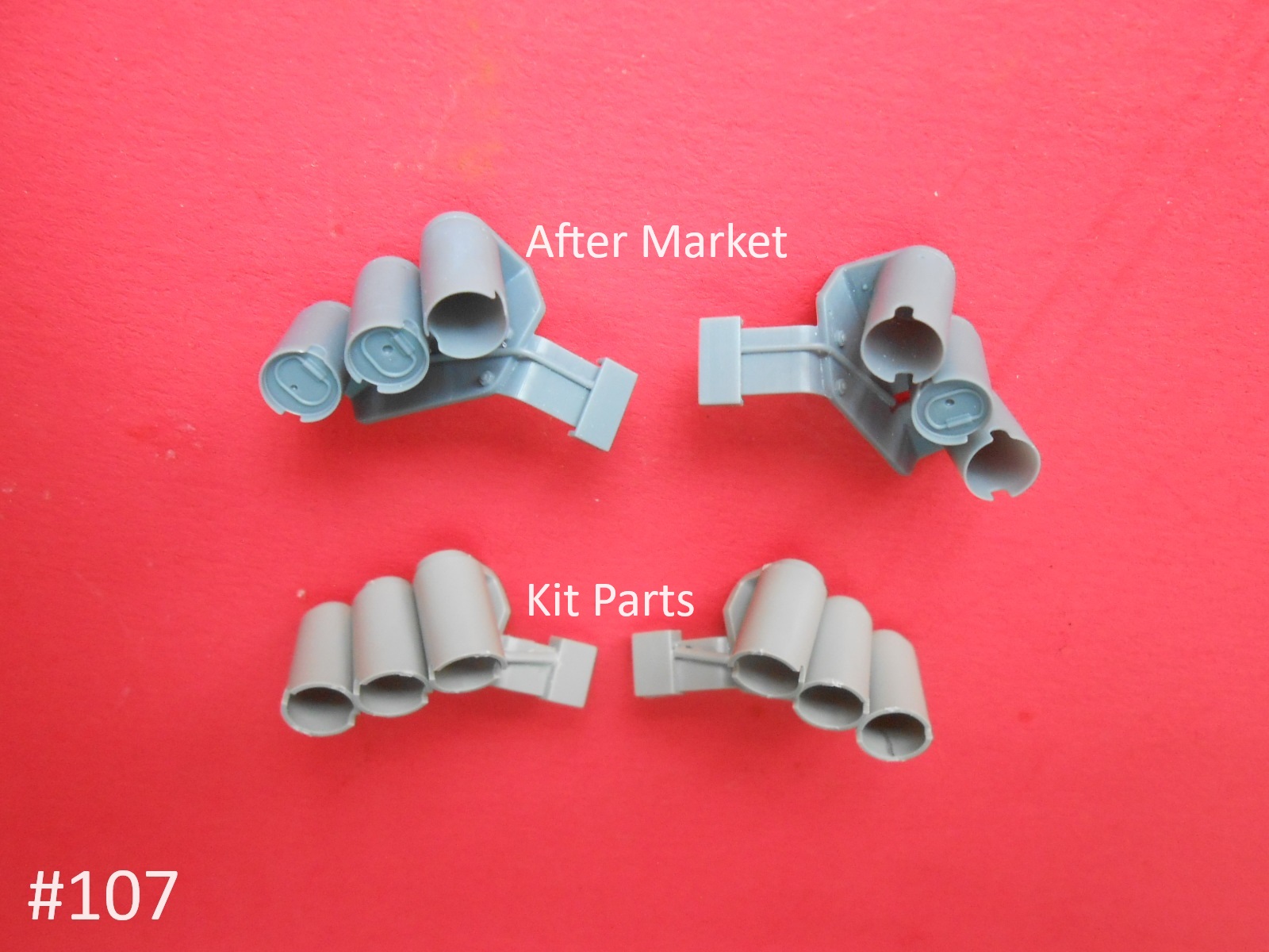

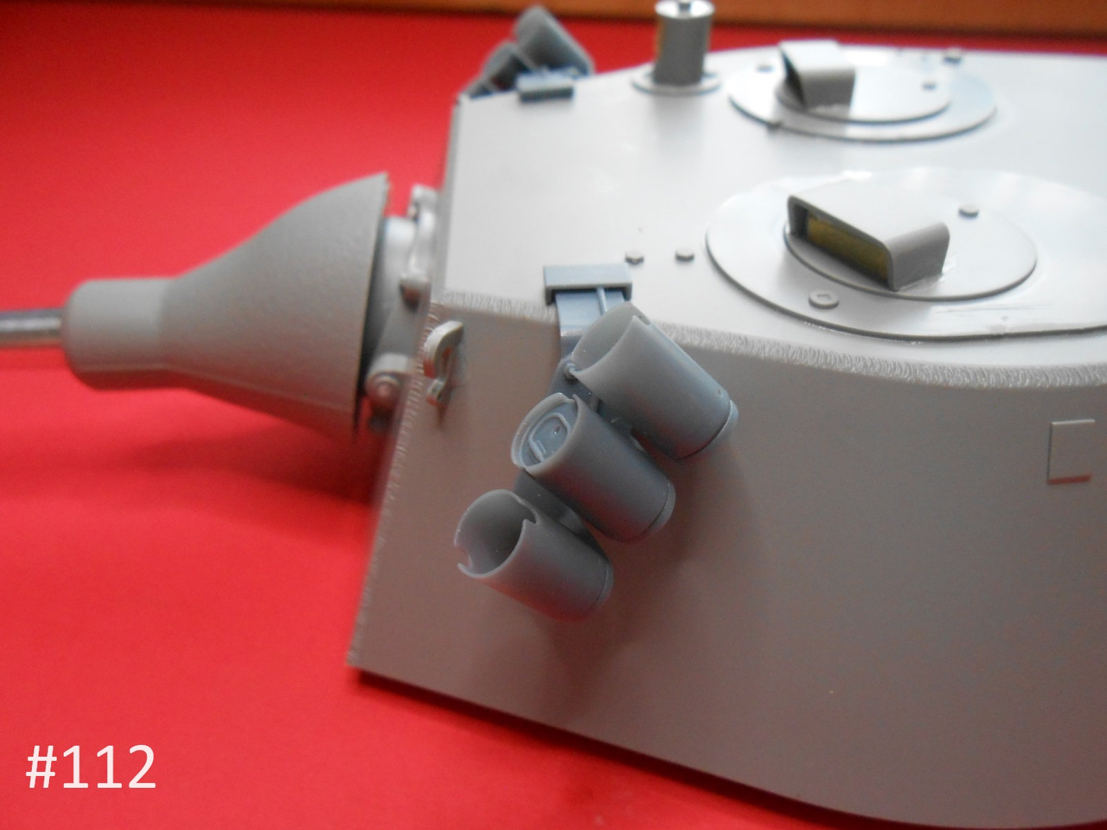

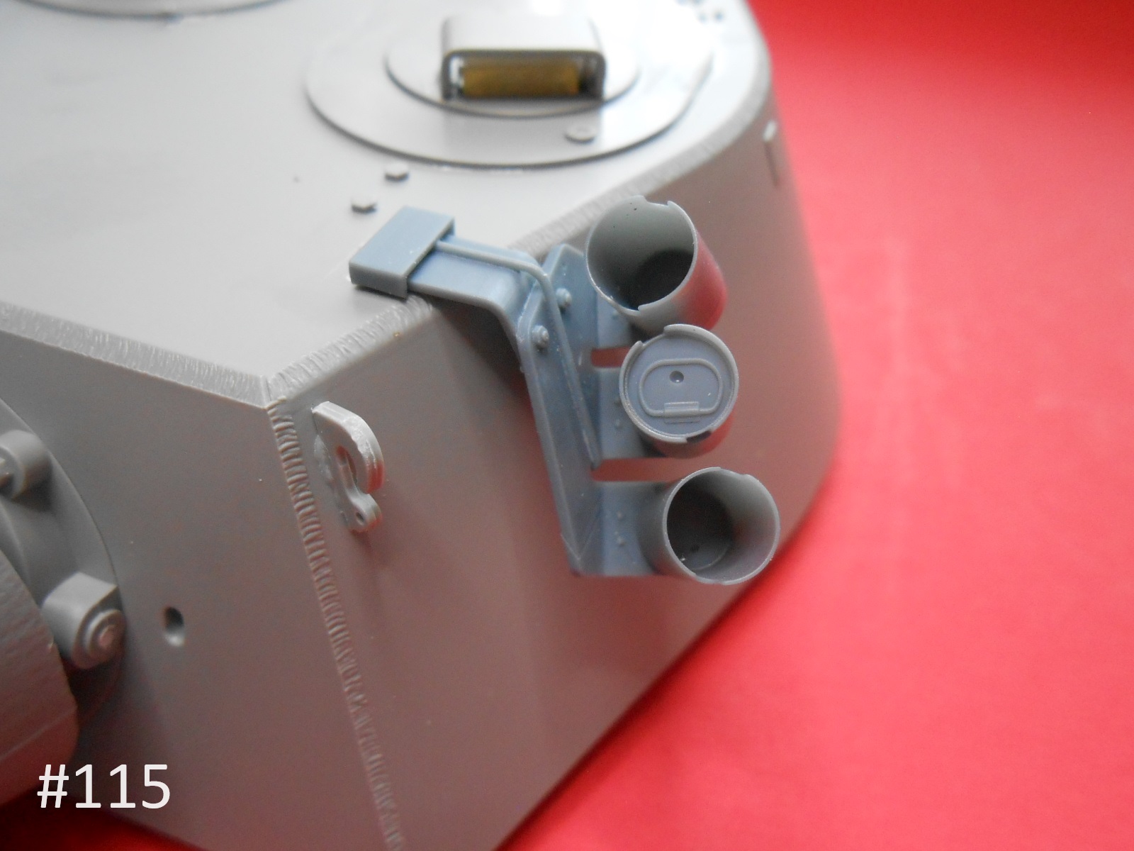

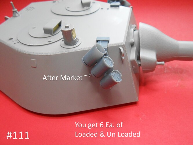

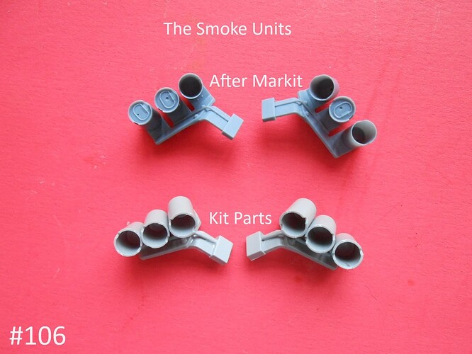

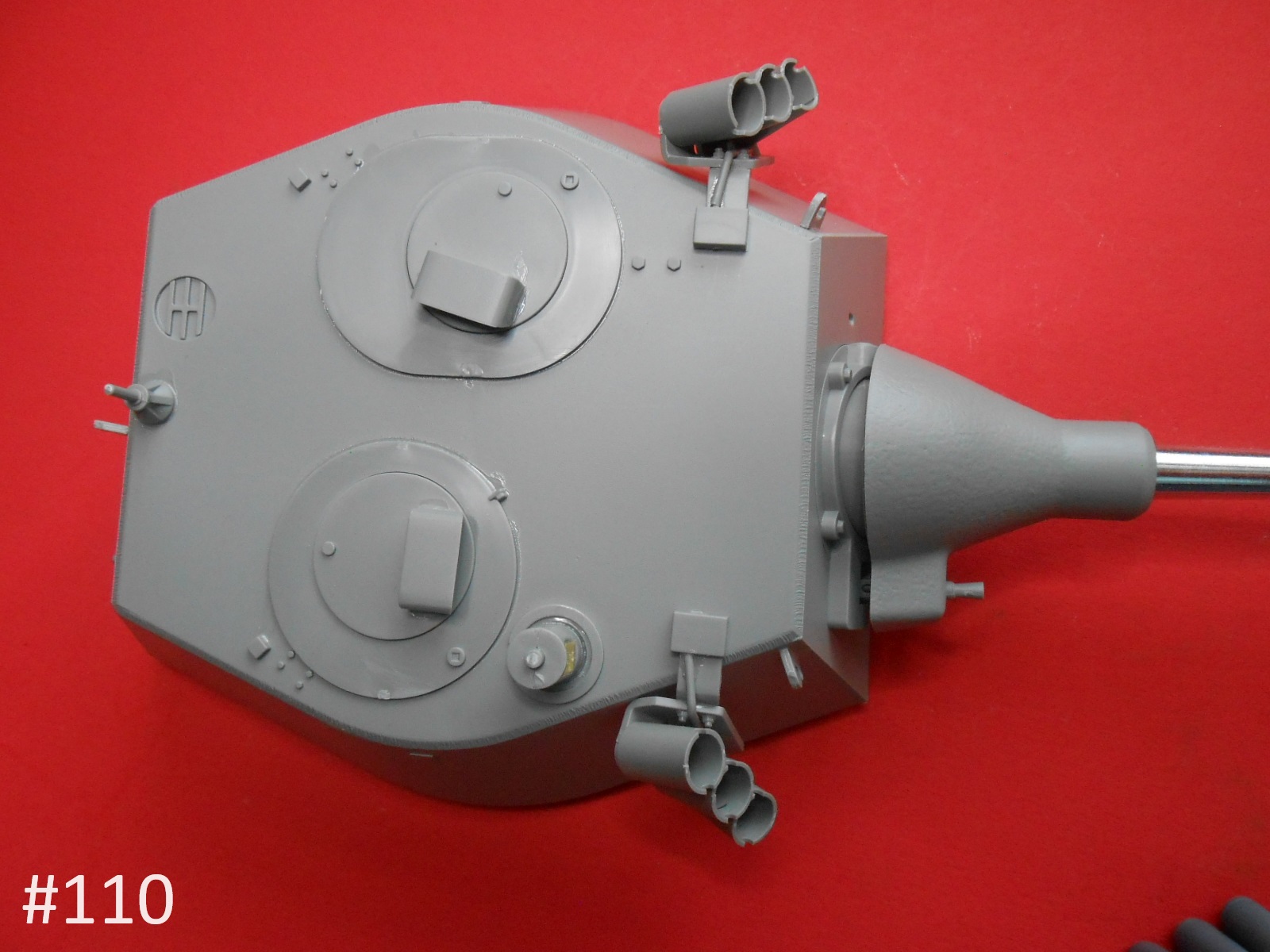

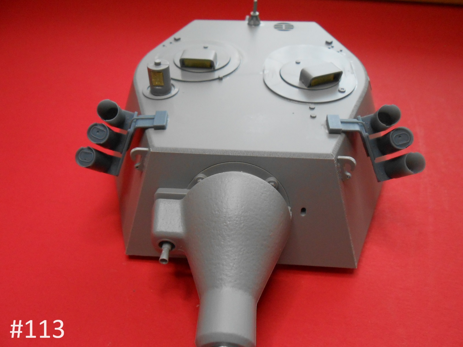

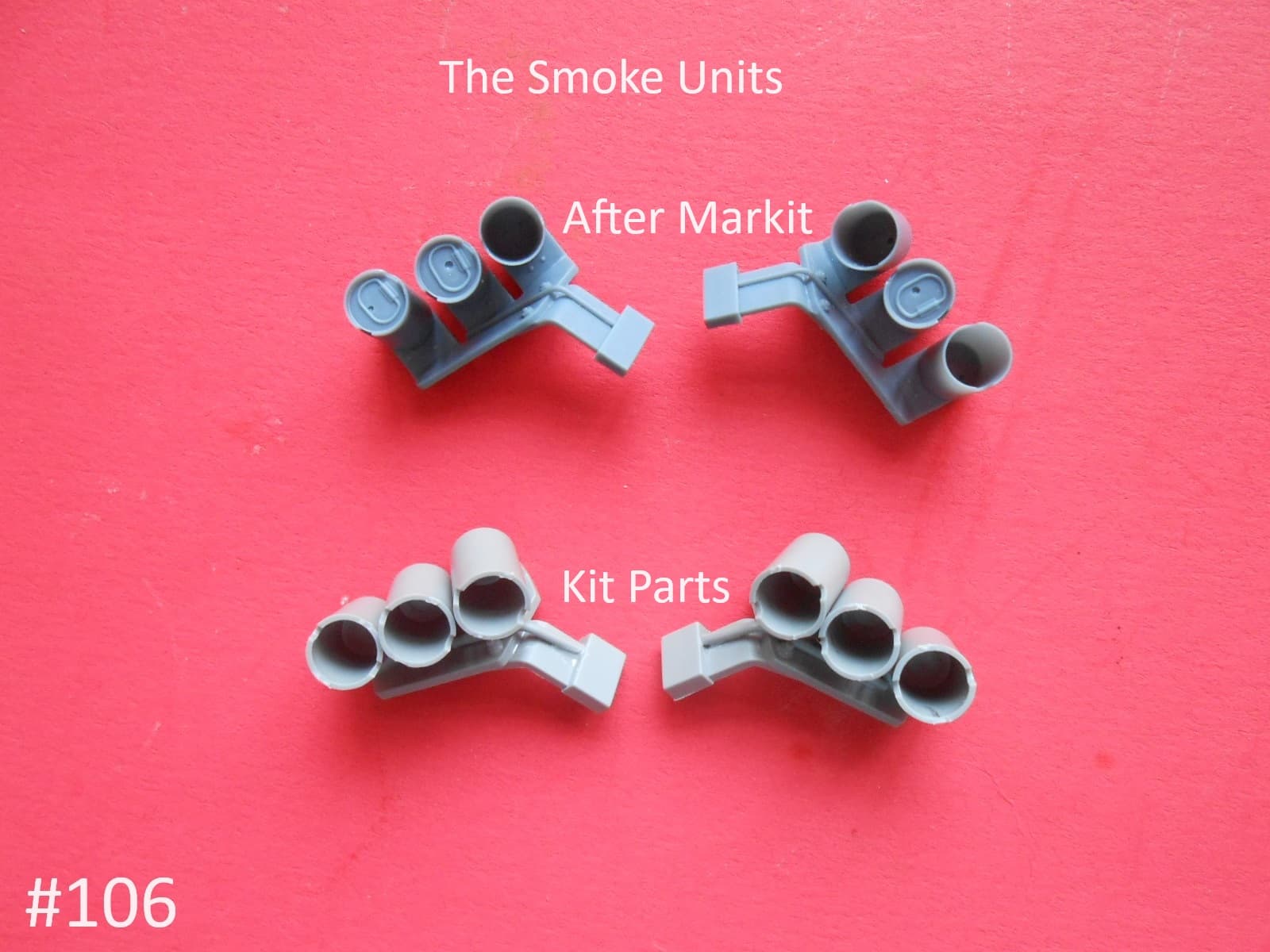

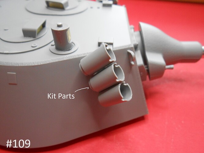

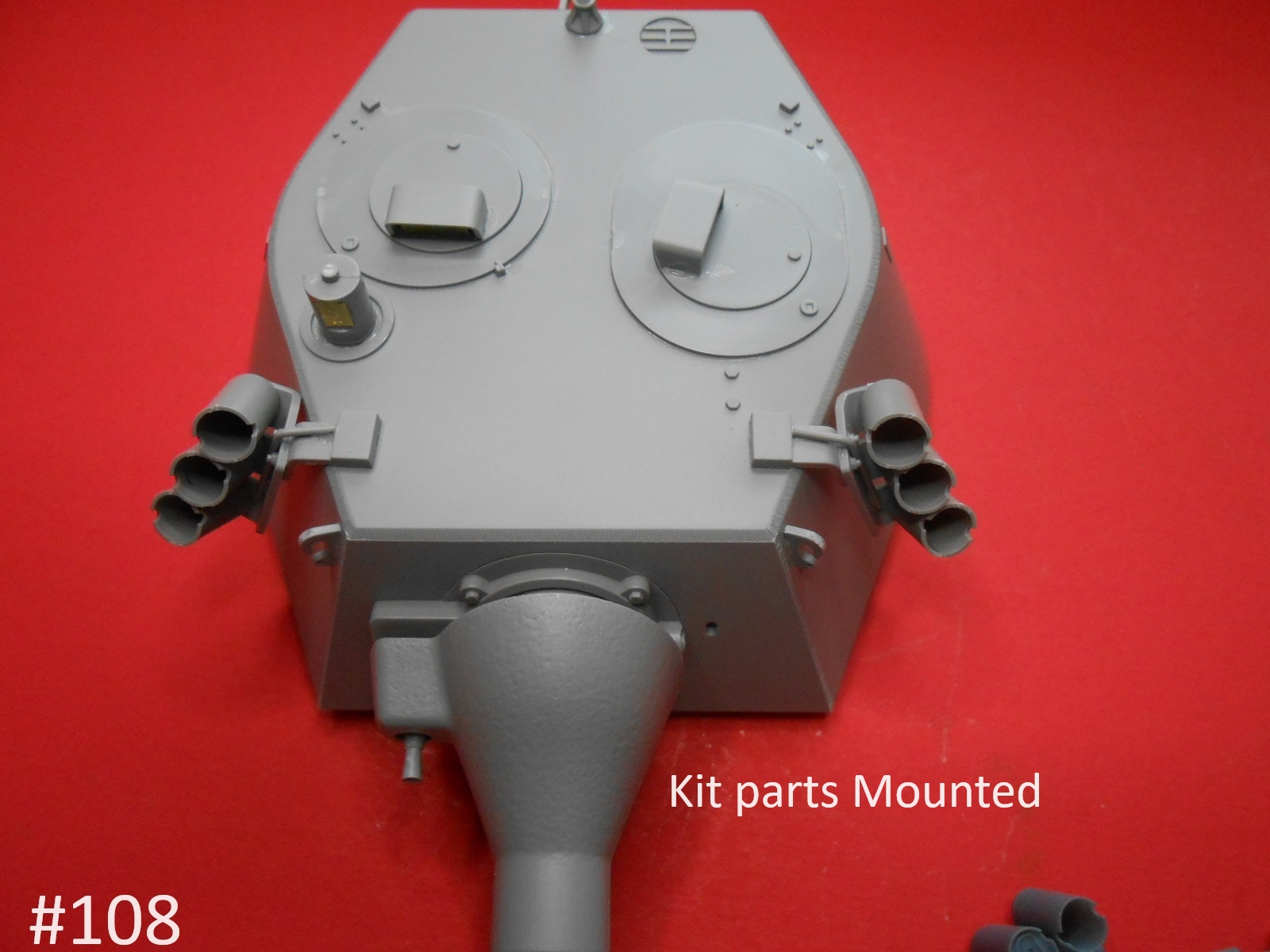

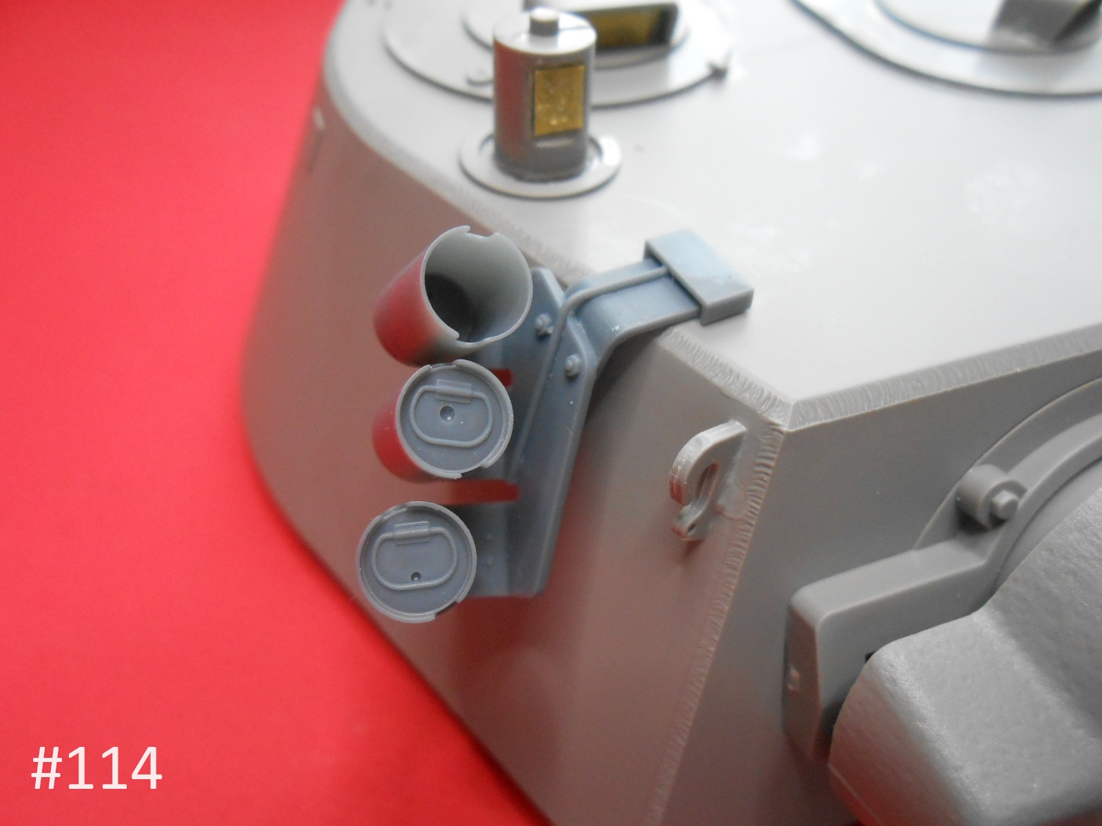

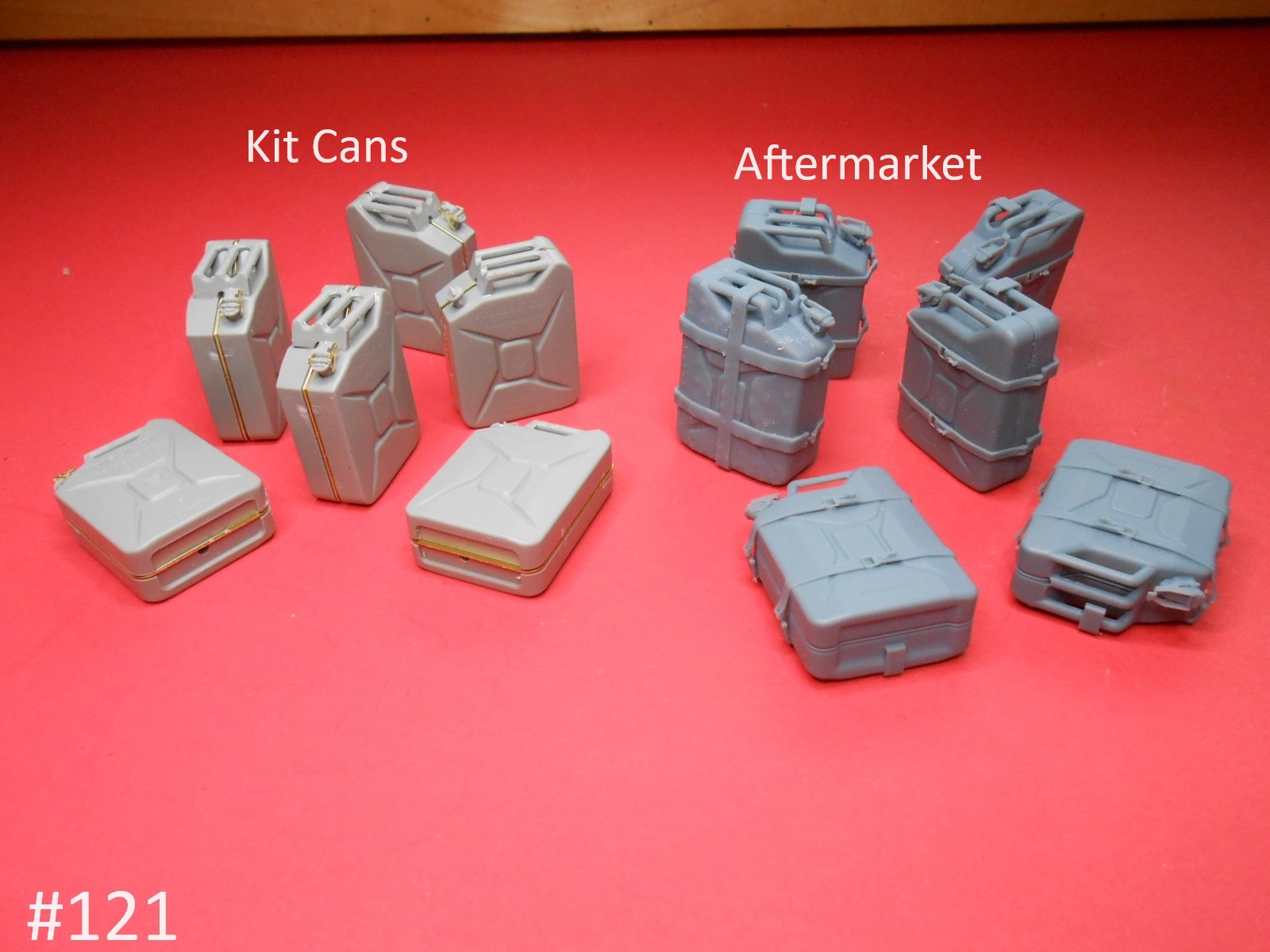

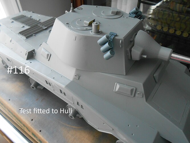

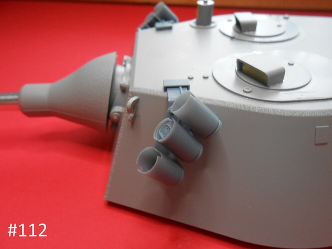

I have the Turret finished . This batch of Pics. features the Smoke launchers both Kit and After Market.

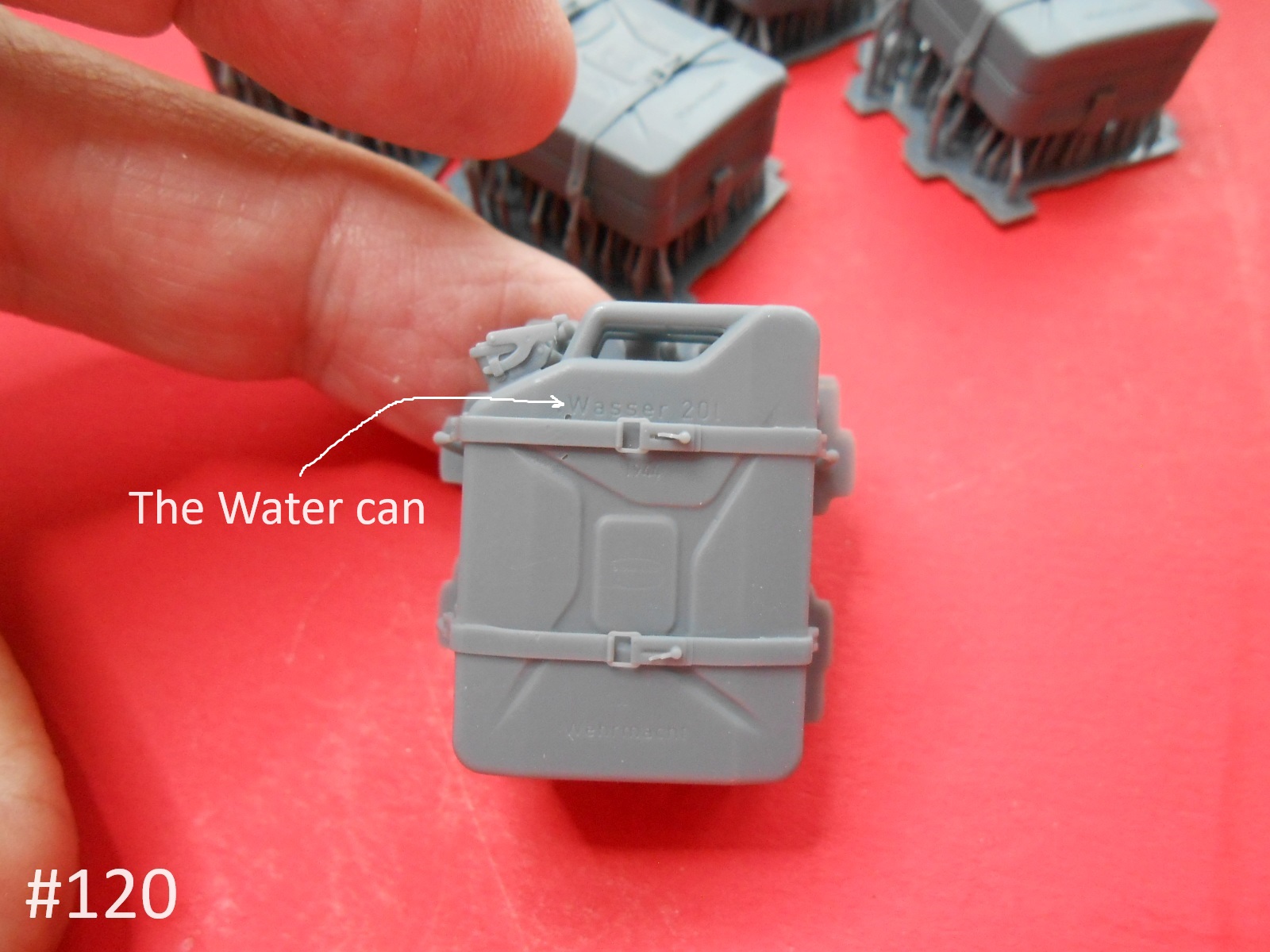

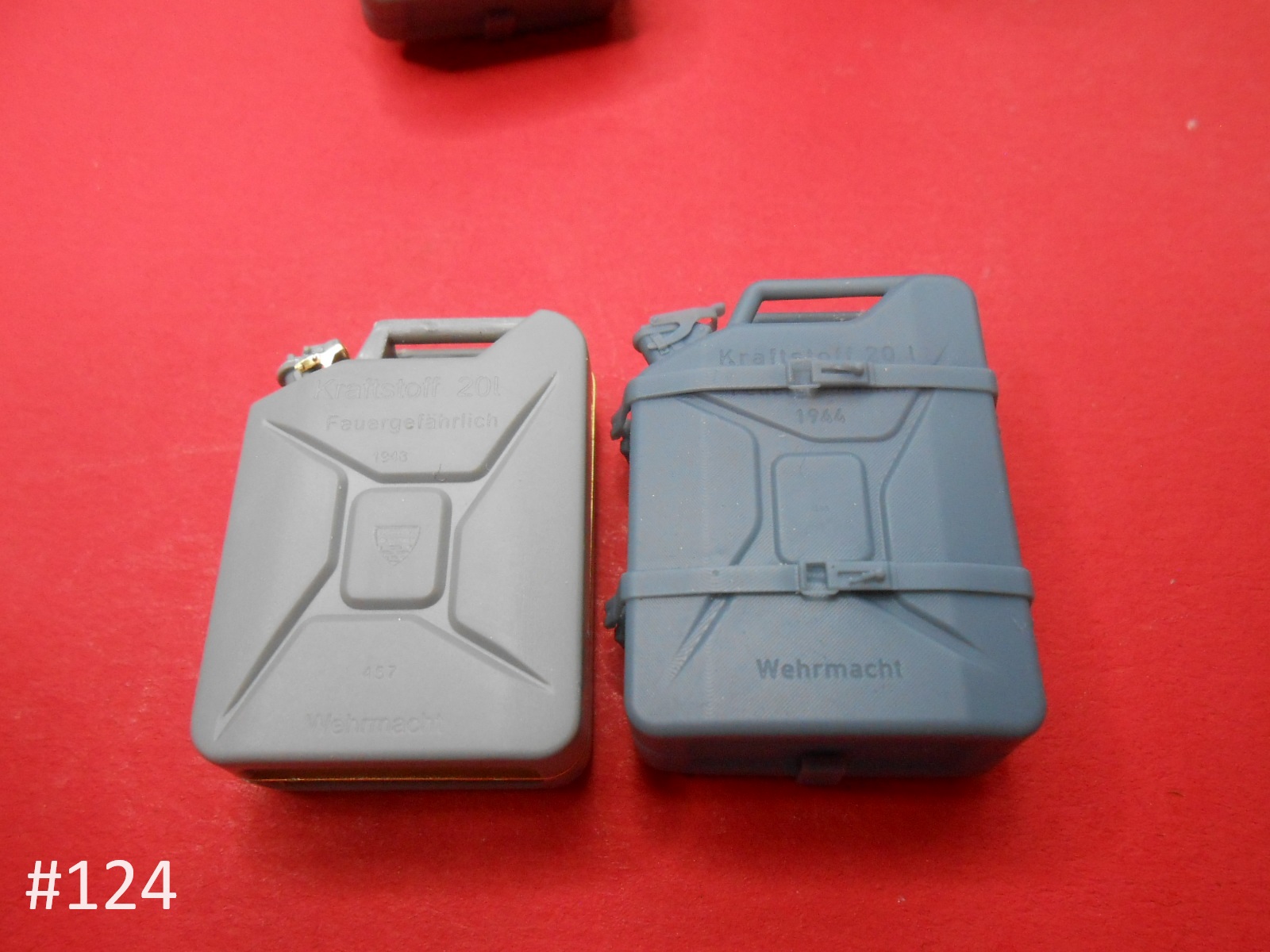

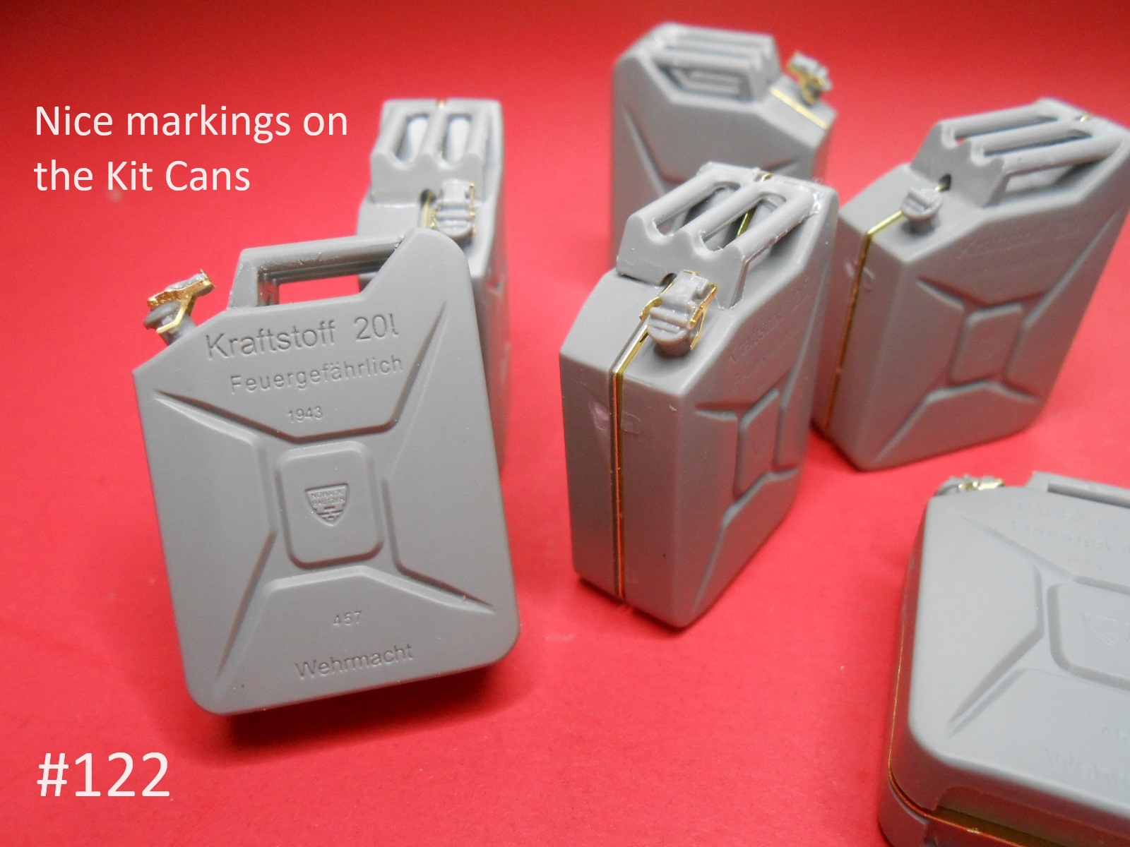

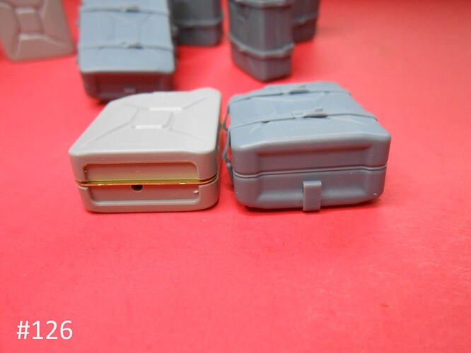

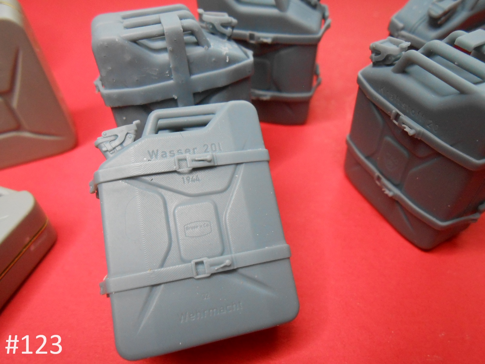

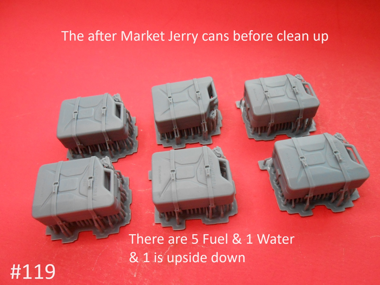

The biggest issue with the kit jerry cans is they all have the same number! This was the serial number so when numbers were present (they were not on all cans) they wouldn’t be the same.
One thing nice about the After Market Jerrycans is , one is marked for water , and one is in the rack with the pour spout down instead of up. Very nice.
Regards
Donald
Very nice work so far. I have this kit, I hope to get to it soon (HA!).

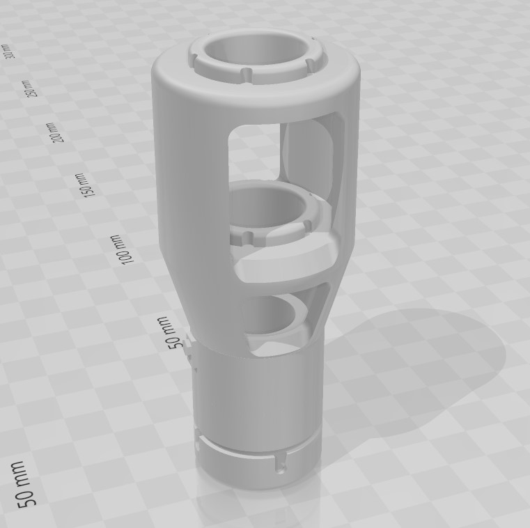

I did not like the muzzle when I looked the kit over, so I made a new one that I think looks better. What are your thoughts on the kit piece?
I think that the kit part is very basic, The company that I purchased the Jerrycan’s for the fenders has a really nicely detailed Muzzle Break, but being a little short on cash I had to cut some corners
Regards
Donald

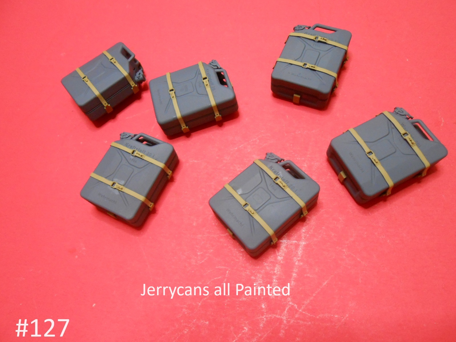

Is the vertical piece painted green on the back side of the cans a mounting bracket? Was it metal? Will the water can get a white cross later?
Dude, you’re like a Rock Star of model building. Knocking out more hits than anyone I know. ![]()
I’m not Shure which part you are asking about, but if it is the small piece sticking up on the bottom of the can in pic. #126 then yes it was metal and would be painted the same color as the vehicle.
Actually the mount to hold the cans was all metal with thinner gage metal for the straps.
I wasn’t going to paint the water can with a white stripe as this wasn’t always done and would draw attention from an enemy .
Regards
Donald

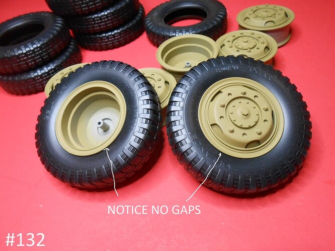

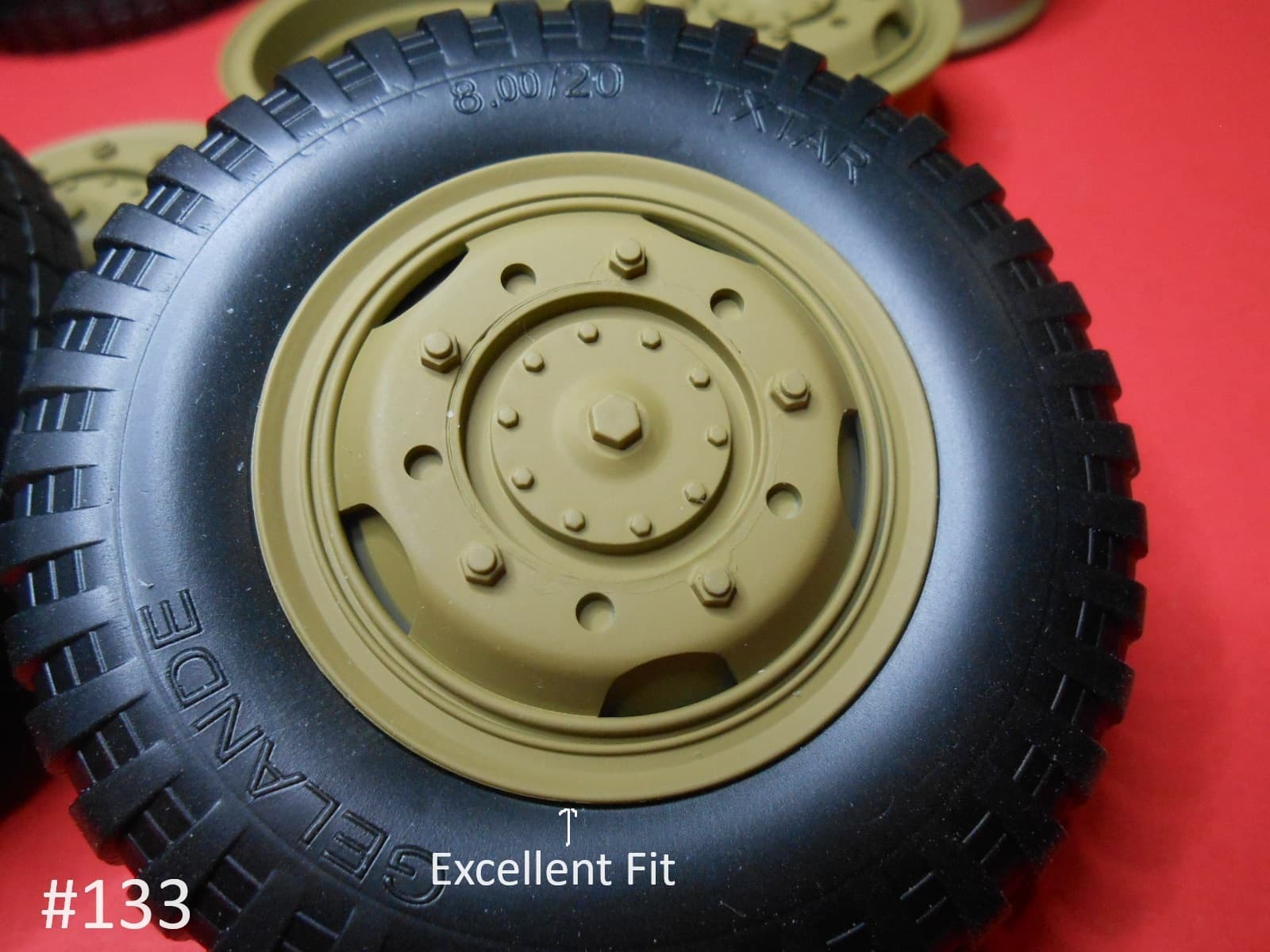

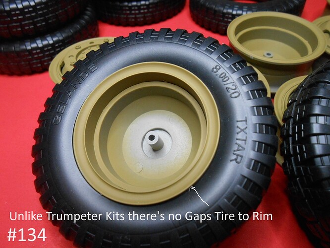

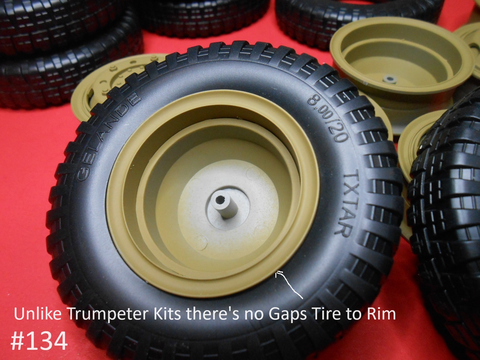

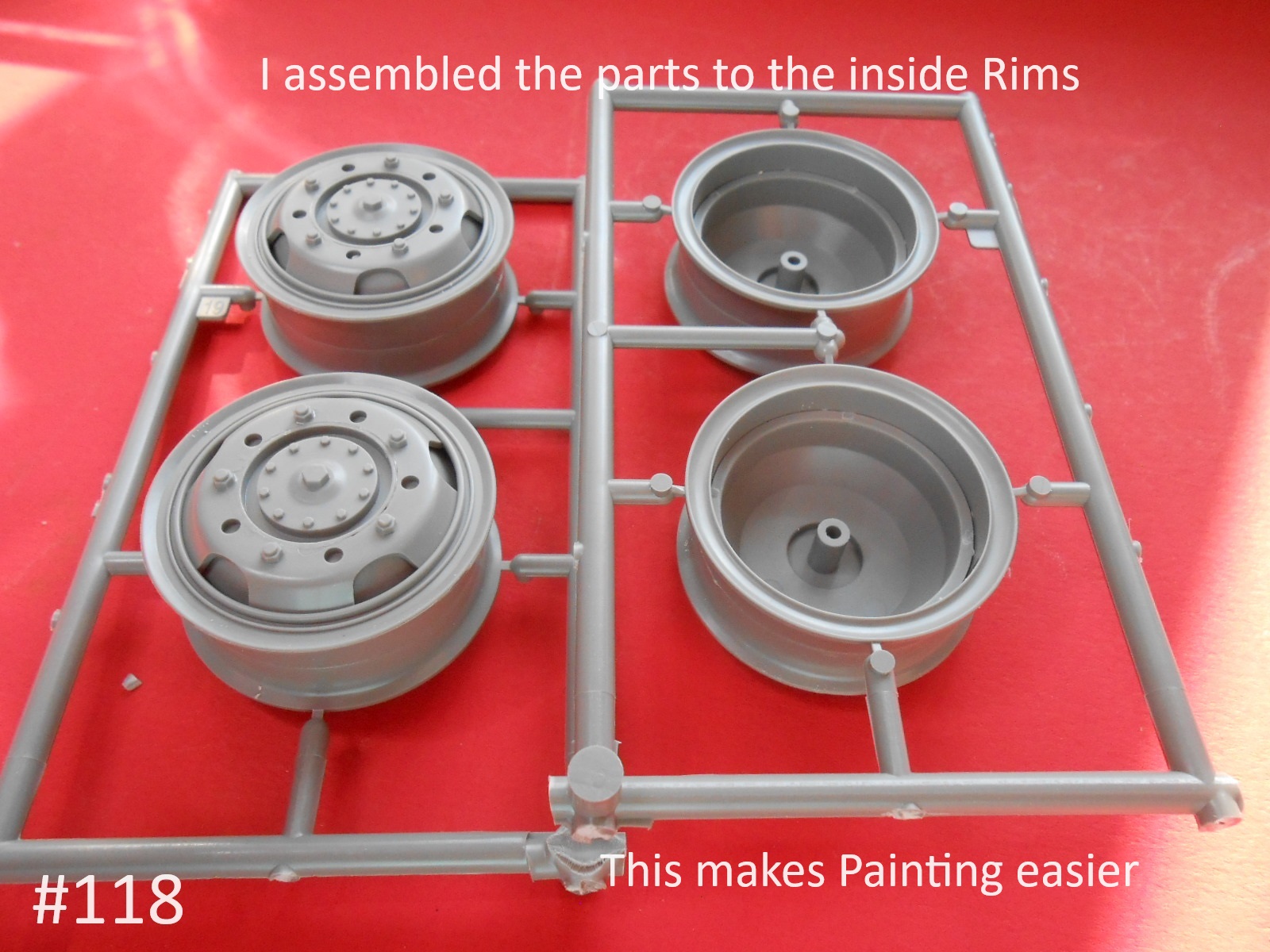

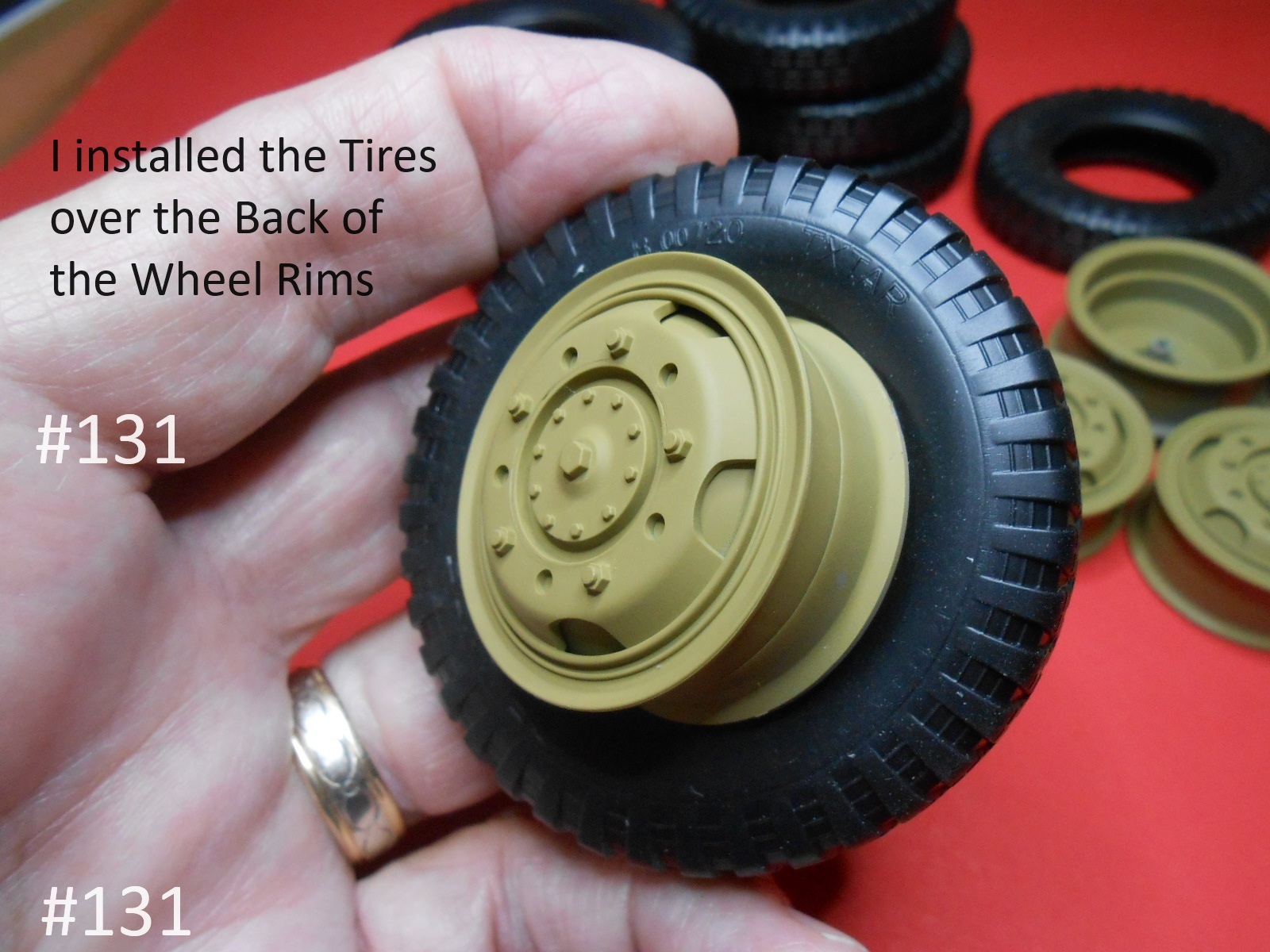

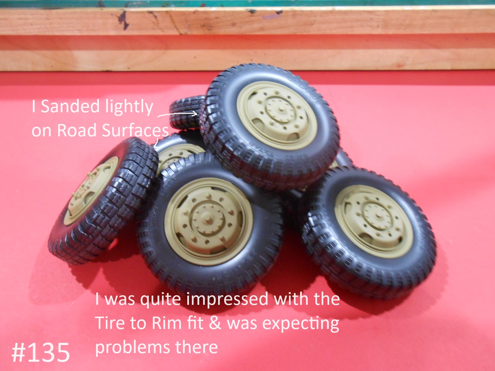

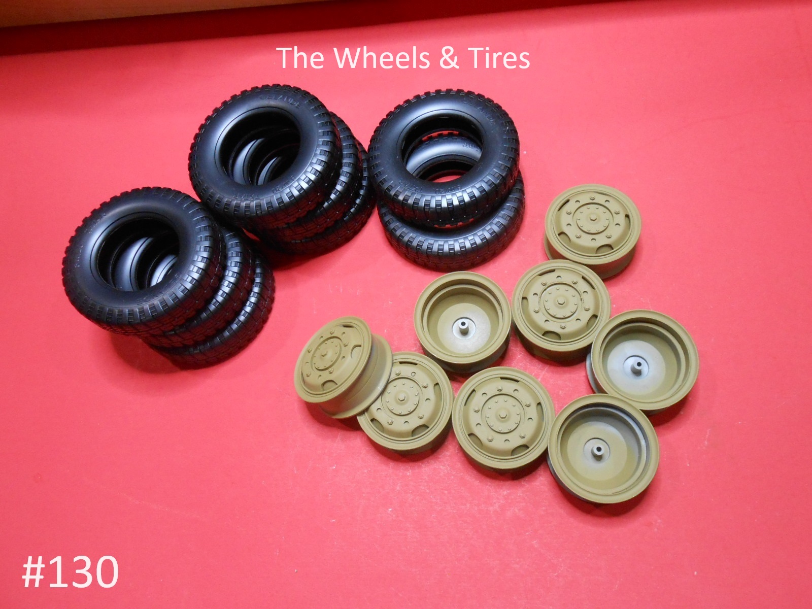

Unfortunately, the tires are the biggest issue with this kit. The tread pattern was basically never used on the Puma. So far, after looking through dozens of Puma photos, I have yet to find a single tire with this pattern. According to AFV Modeller, they have found photos of only two vehicles where a Puma is partly fitted with this pattern. This pattern is that seen on the Sd.Kfz. 234/4, which Das Werk inevitably plans to do since they have the Pak 40 with the Sd.Kfz. 251/22, so they obviously produced the tires with the intention of using them for the 234/4. But it is disappointing, considering the cost of a set of tires from AFV Modeller, Pimp My Miniature, and others I am sure. Sol Model has released an inexpensive set (i.e. about half the price of the other two), but the tread pattern is a bit suspect, as is the shape of the rim, but it’s hard to tell in the photos on their website.
