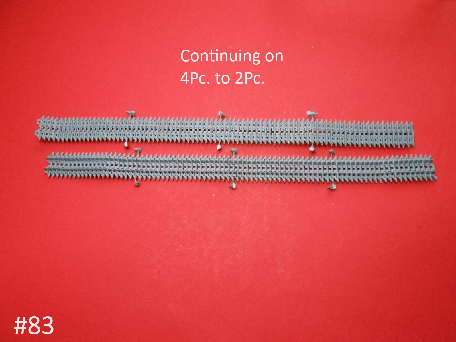

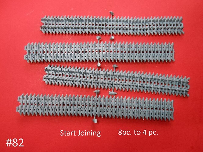

I think that a lot of you are wondering (HOW) will he ever get that track together?

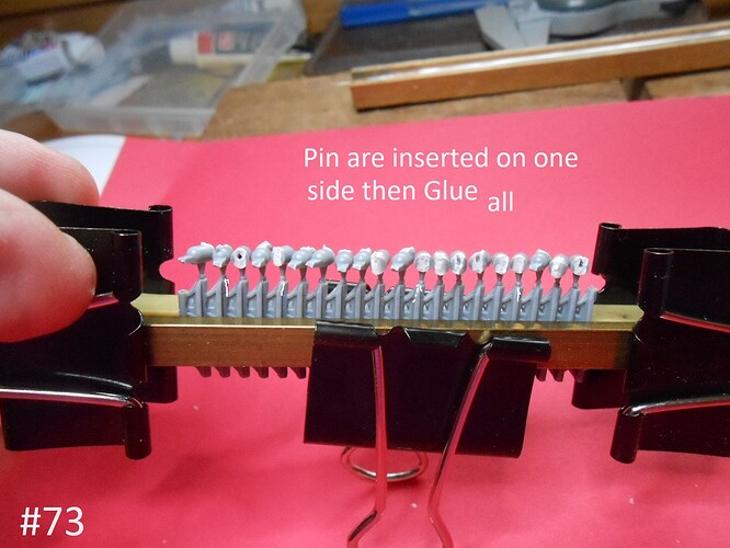

Well I got it together and it wasn’t verry hard, tedious but not really hard if you follow my instructions.

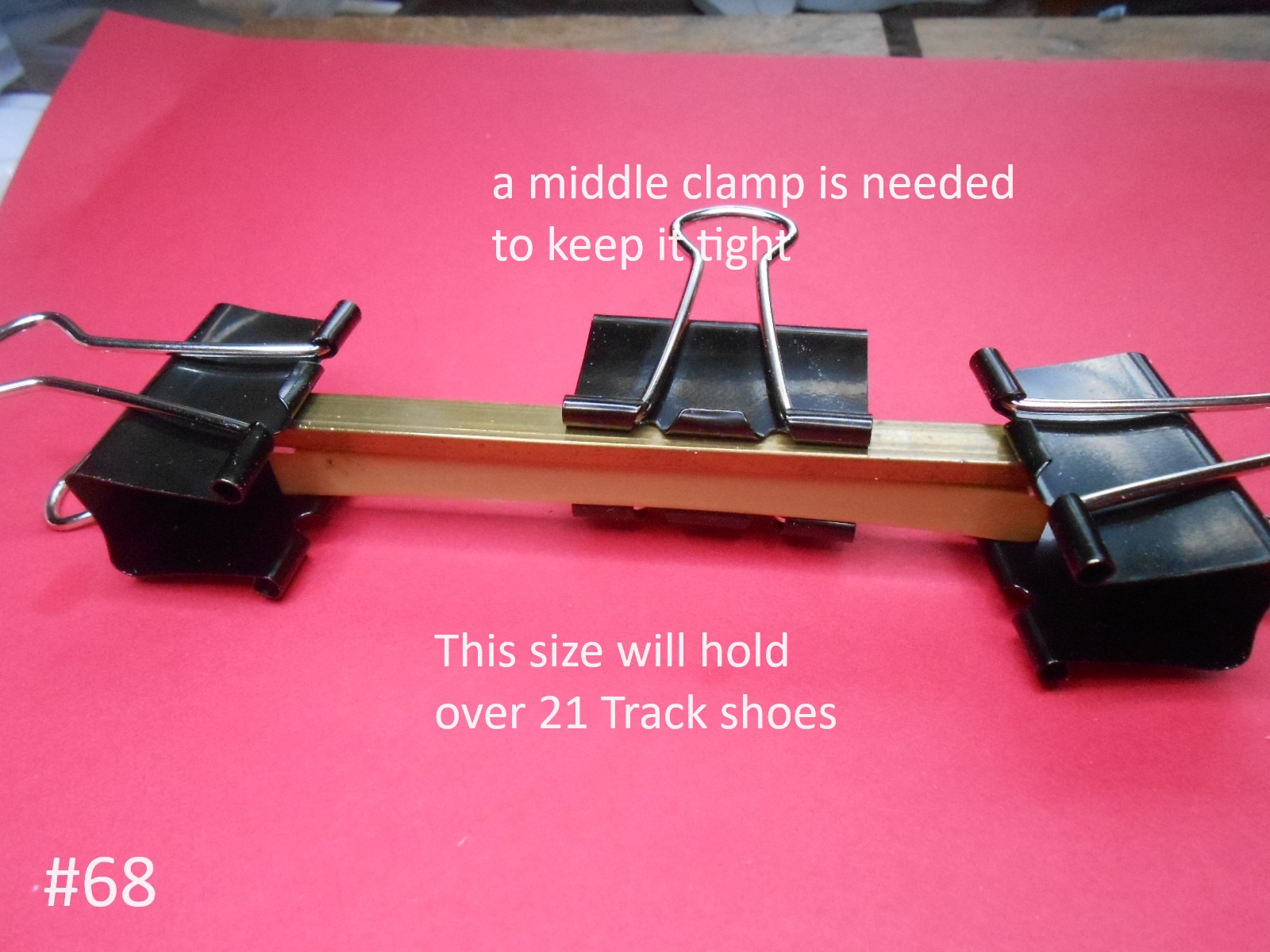

First you will have to make a Jig to hold the Track Shoes, preferably out of something that isn’t very flexible.
I used some scrap from my junk drawer. You can make it as long as you want, I made it to hold about 21 Track shoes.
Ok enough talk, here are the Pics. I hope this helps any of you trying to build this kit.

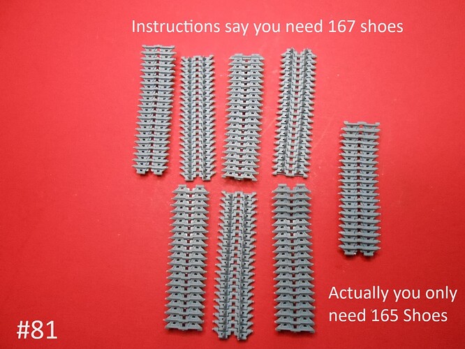

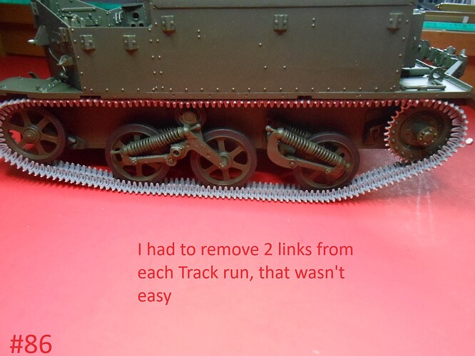

Donald your doing some great work here, however regarding the track the Universal carrier always seems in photos to have a slightly slack track when stationary so possibly 166 links?
The track is really flexible so I plan on gluing it down to give it a little sag.
That should fix that.

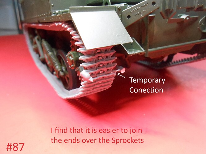

Well I have the Track painted. weathered , & installed permanently with a slight Sag.
Here is how I did it.

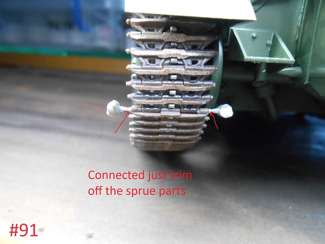

Hey I gave you a fairly easier way of doing it.
The hardest part is cleaning up all the tiny parts.

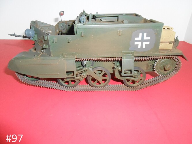

I just have a little more detailing and I’ll be finished.

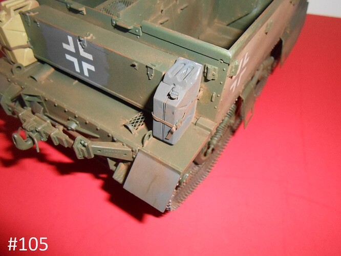

I marked this build as a captured vehicle pressed into service by the Germans as either a Tow Vehicle for a PAK 40 , or a Munitions Supply Vehicle.
I hope this helps.
