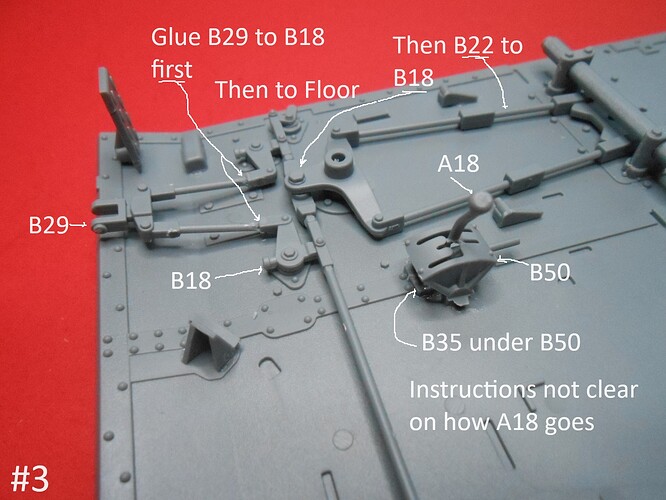

Some more on the interior, you have to think ahead and install the parts in order because some go under others.
I’m finished for today, I’ll be working on the rear drive axle next.

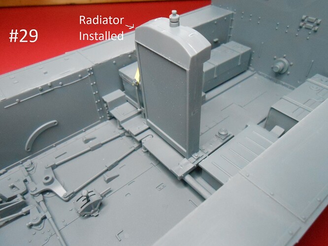

This is what the interior seams should look like.

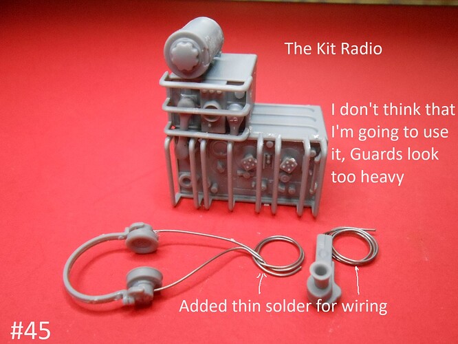

There’s a lot of unseen detail , and some of the instructions are very ambiguous an exactly some of the parts go.
I’m probably not going to use the Radio, It just doesn’t look right and where exactly does it go ? I think I’ll make this into a supply Tractor.

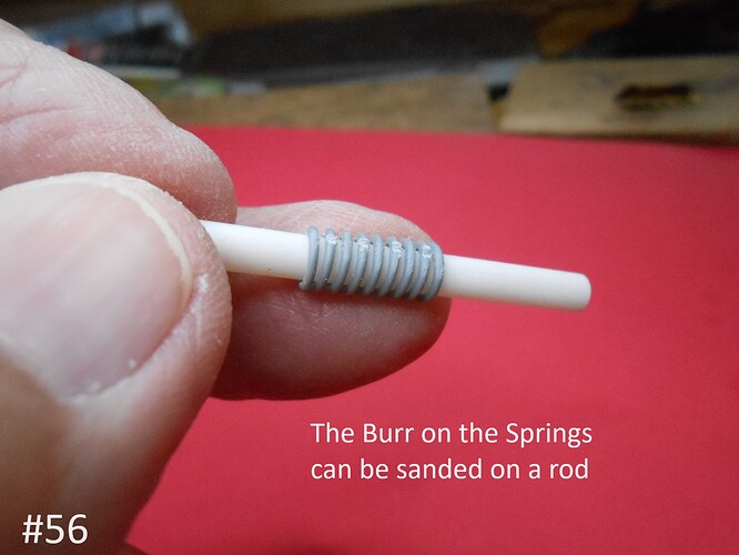

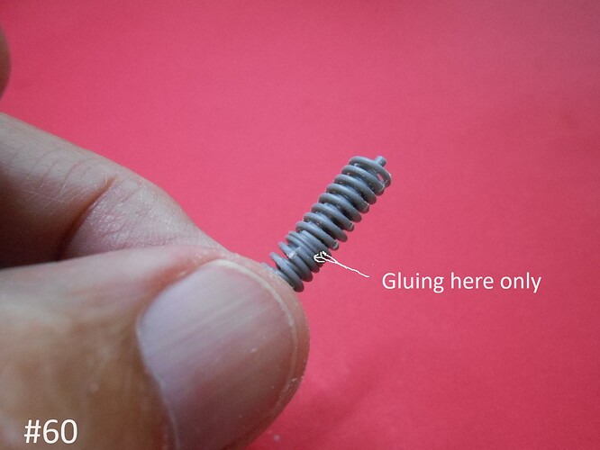

I have a little on the Bogies finished, I haven’t been feeling to good lately.
that’s all for now.
