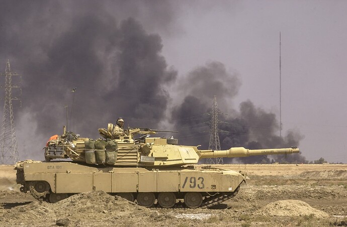

Does anyone have any reference photos of M1A1 Bushpig Bandits? This is the only image I can find. It is the one in the background. Anyone has other images showing the whole vehicle and any from the rear?

For this build I would leave it off as it’s for the fording kit. Typically for Marine and not Army tanks.

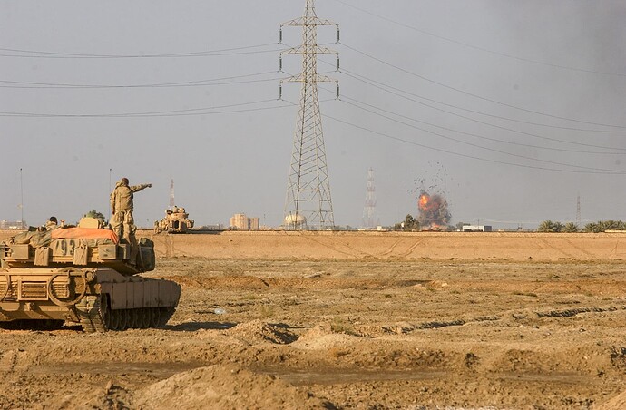

DOn;t know if this particular tank is part of the Bushpig Bandits, but you can see the drive sprocket ring…
And on this image, you can see the plate present.
At the time, OIF 1, most M1A1 HCs (Heavy Common, Common to USMC and US Army) from APS 5 (Kuwait) as 3-7 CAV, 3ID drew, had the solid sprockets. It would have had the flange around the exhaust and the conduit for the APU as these were M1A1 HC features. Most of the APUs were removed as they were old and didn’t work well, if at all.
Here you go, you can see the drive sprocket ring more closely.
Depending on the timeframe, some OIF Abrams had their APU removed from the bustle to remove a potential fire hazard in an urban counterinsurgency operational setting.
