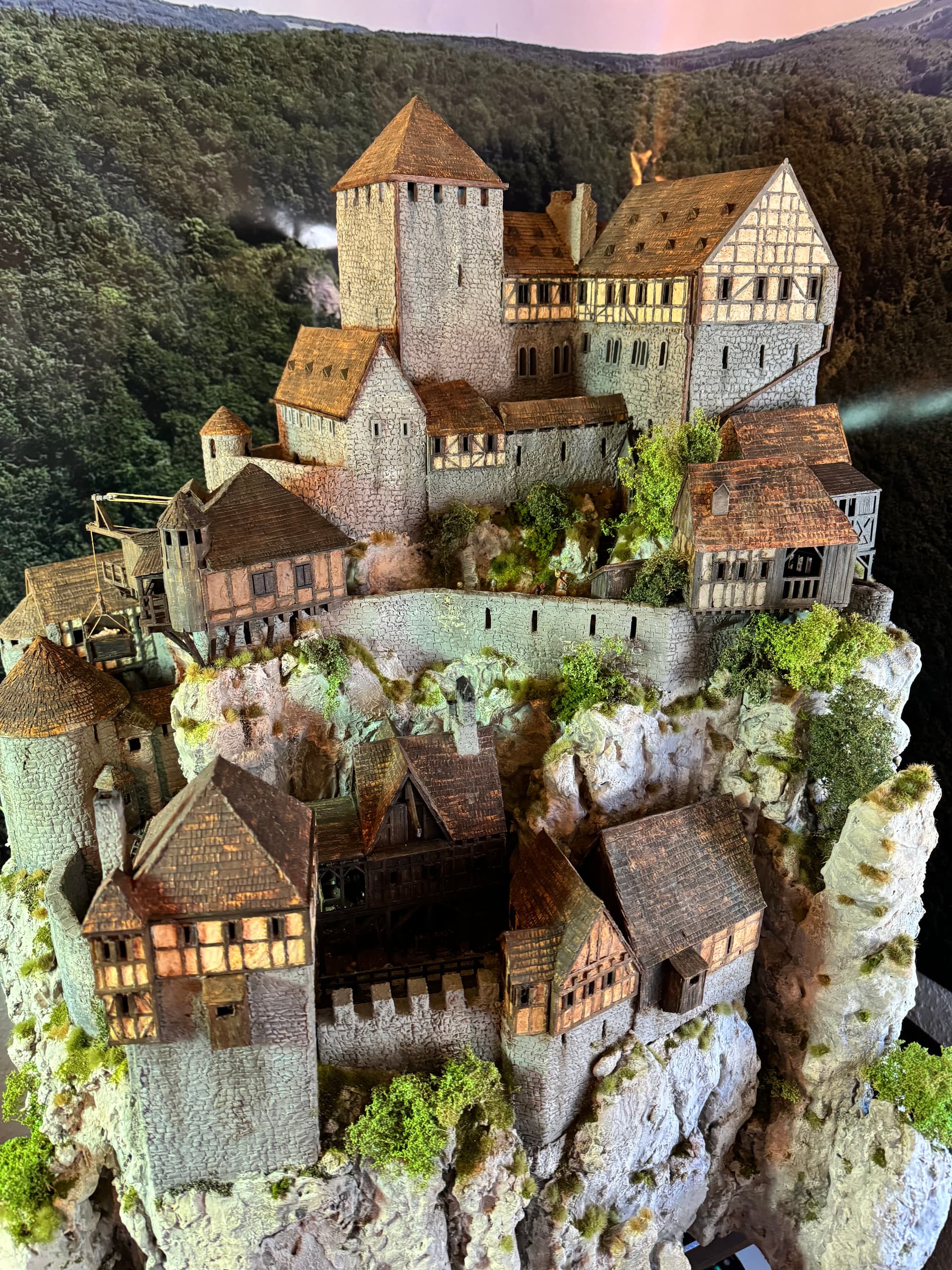

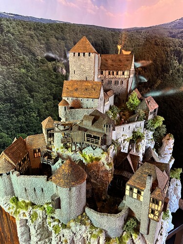

Castle Reussenstein in 1:72

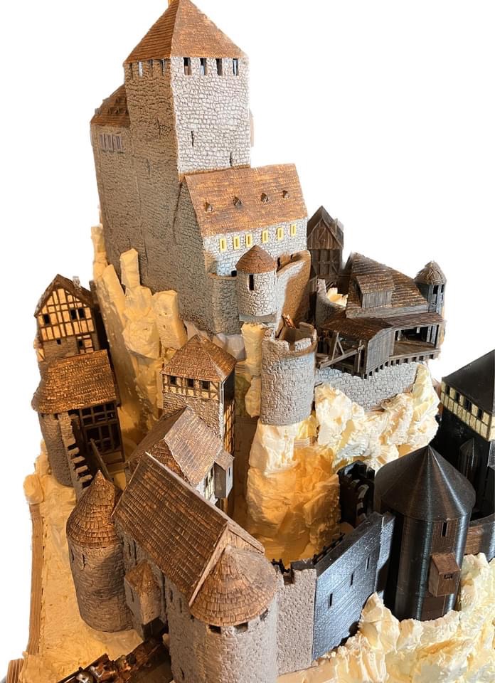

My project before Greifenstein Castle was Reussenstein Castle.
This was the first time I used a 3D printer for the “basic structure.” I like to combine the advantages of 3D printing with traditional craftsmanship. This means: the walls are covered and modeled with self-hardening modeling clay. Landscaping is done with Styrofoam, plaster, and a white glue/water/quartz sand mixture. Roofing and wood imitations are made of paper. While this model is more impressive in appearance, the detail is not as good as the 1:72 Greifenstein Castle, which I presented yesterday. With each model, you learn something new.
The base area is slightly smaller than that of Greifenstein Castle, measuring approximately 65 x 63 cm, and the height is 75 cm.

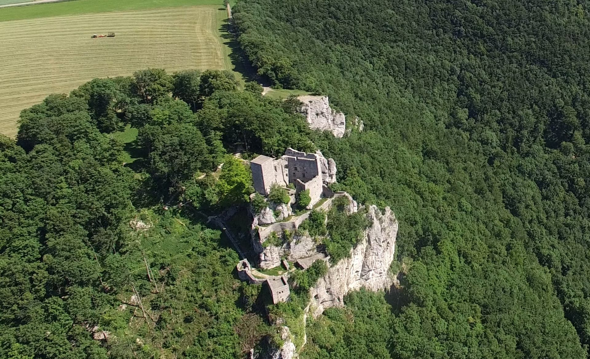

The fotos from the originals are fotos of my own…Screenshots of a video made with my DJI Drone

That is simply mind-blowing… We get some impressive dioramas posted here, but that is on a whole different level! (Well, on several levels actually… :smiley:)
I thought it would be difficult to top Greifenstein but in the very next post you show us this! Magnificent.

Thank you very much. Only for myself. I would only get a fraction of what I put in.

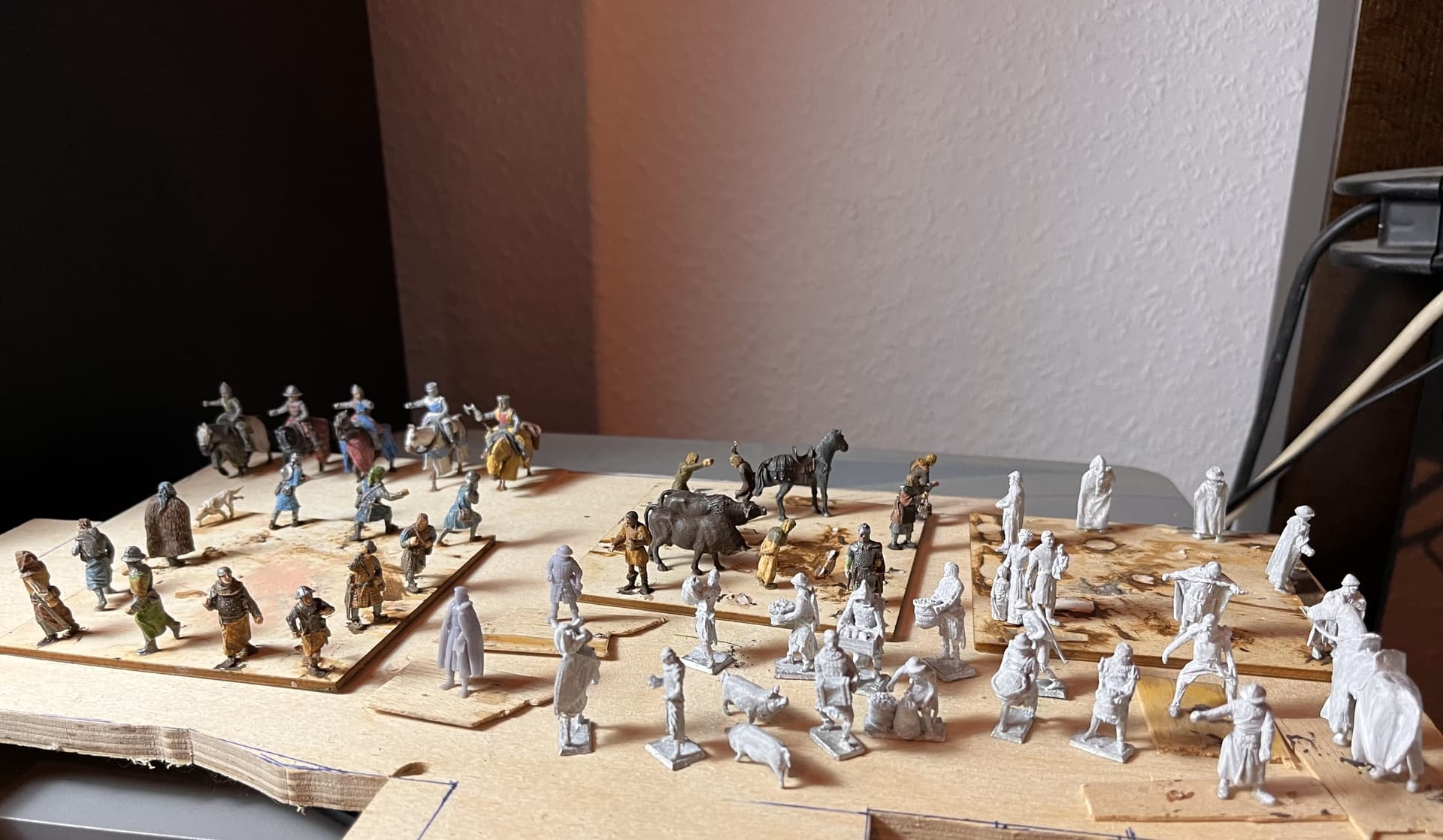

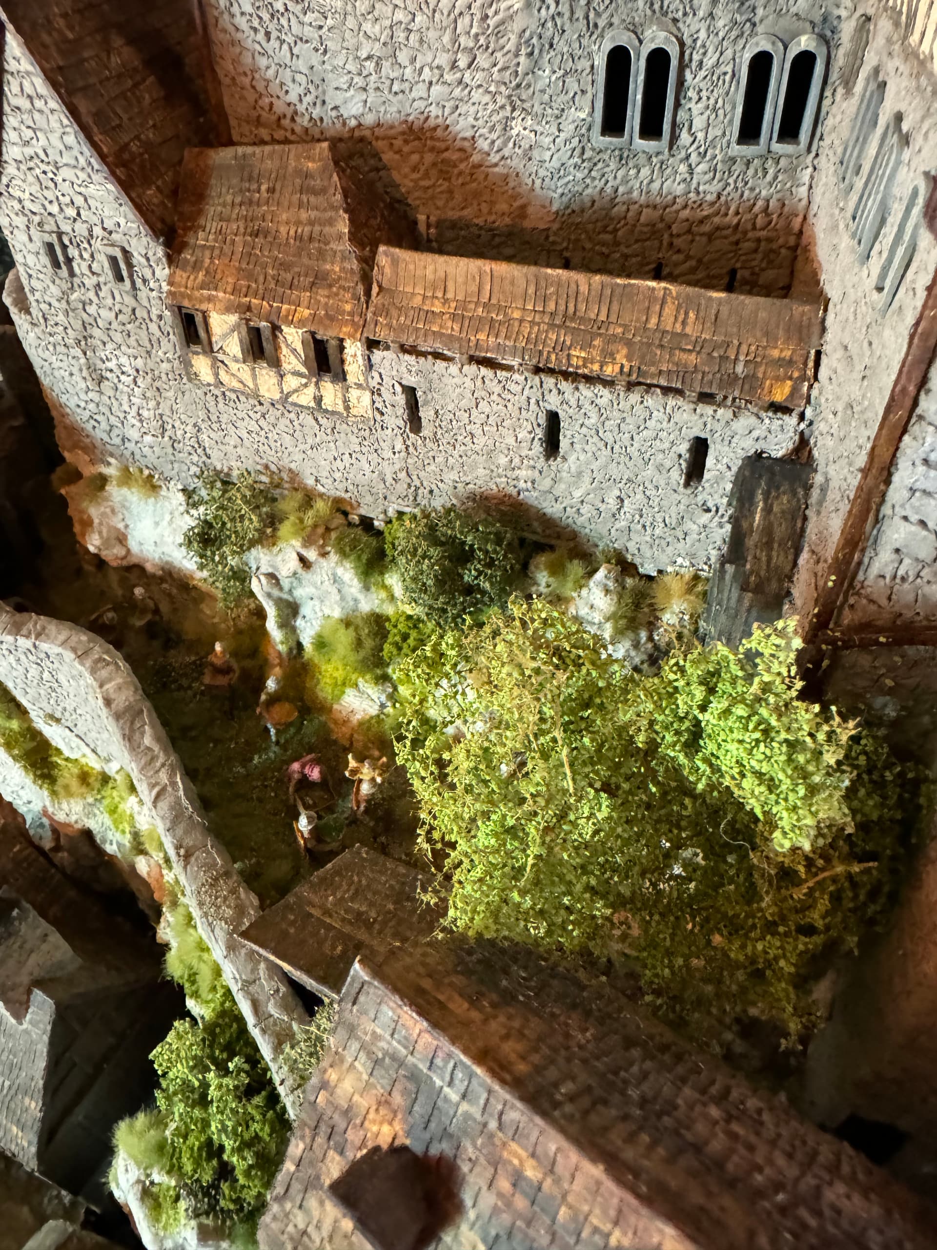

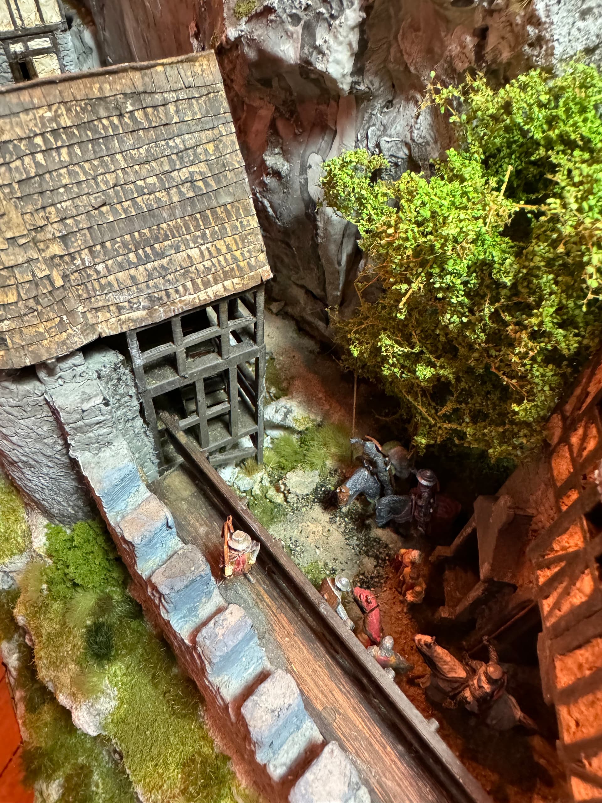

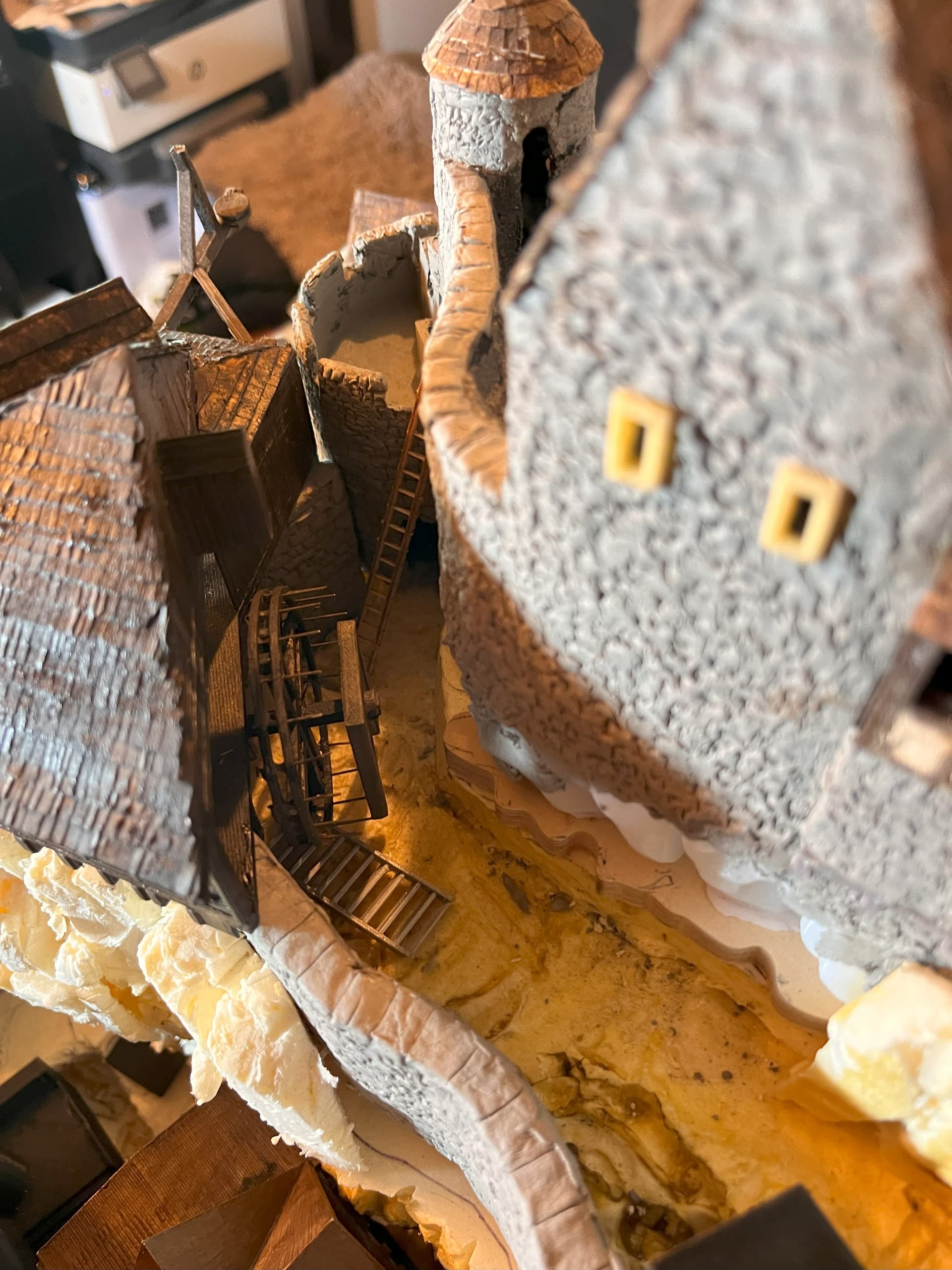

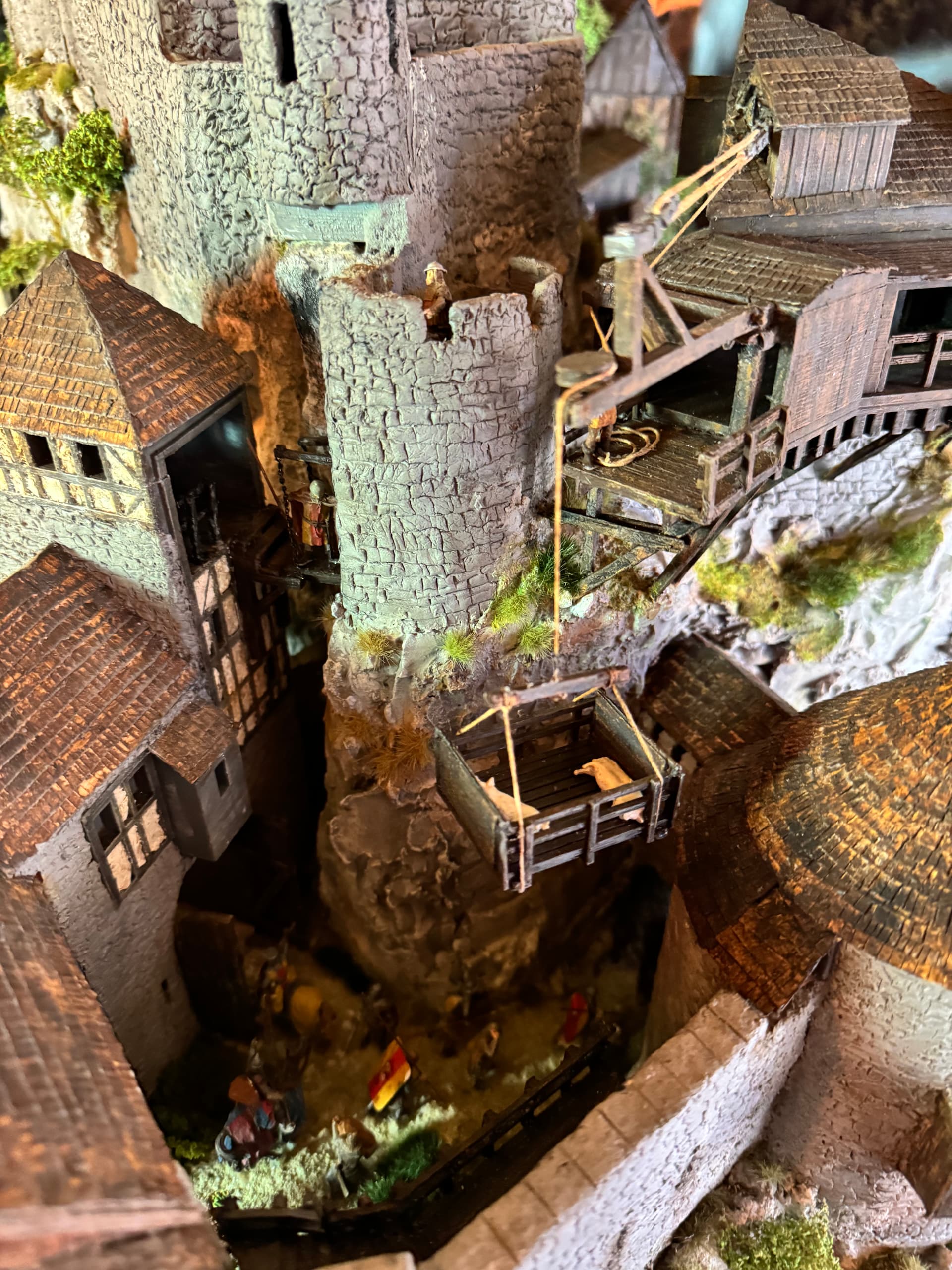

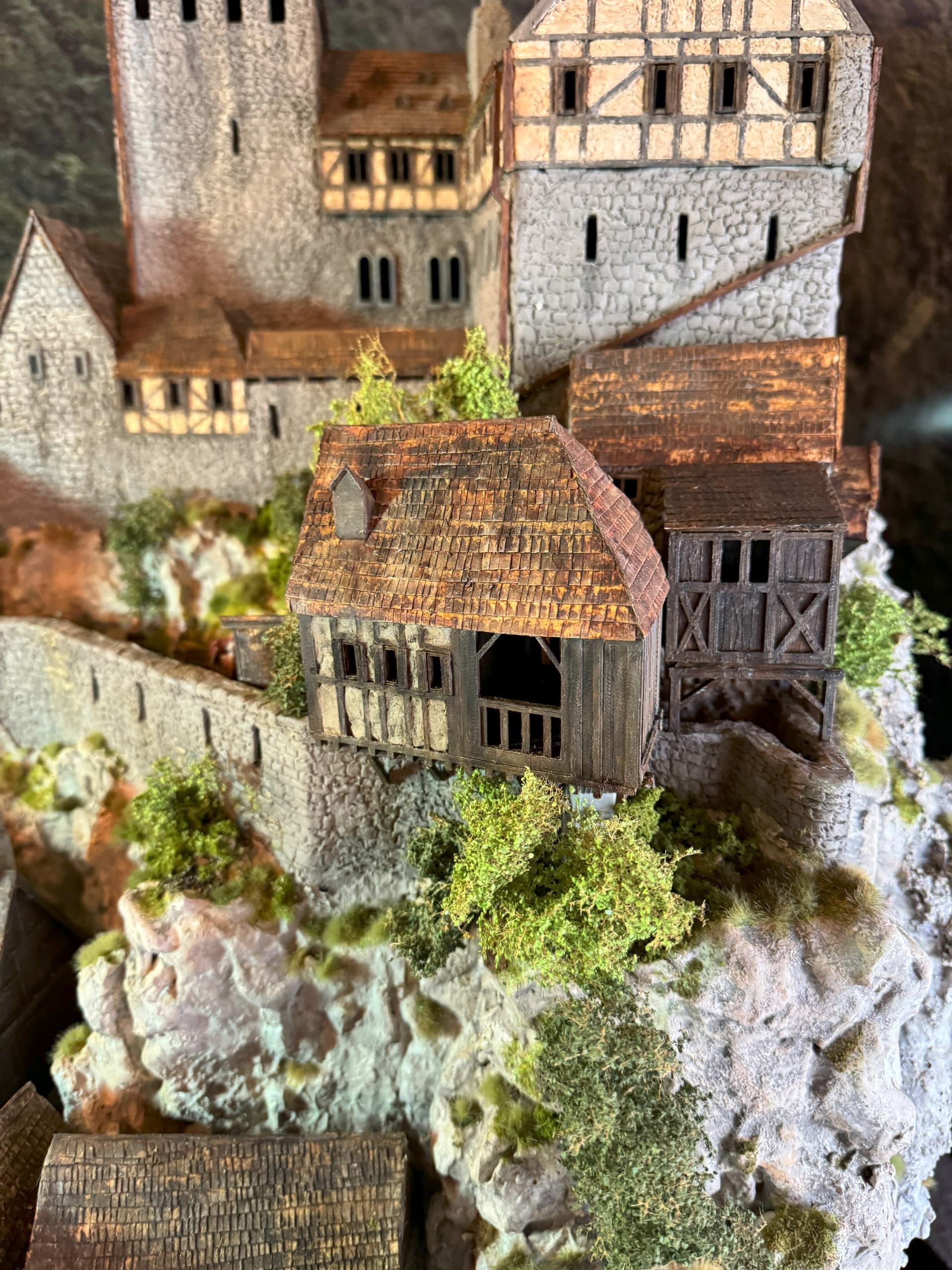

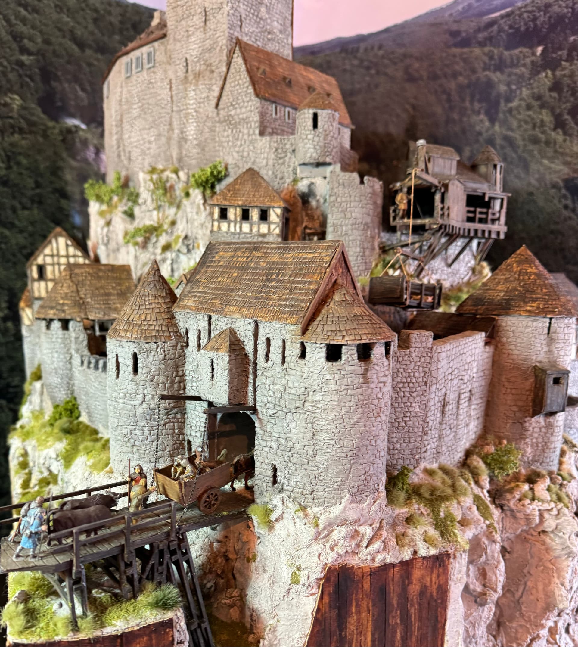

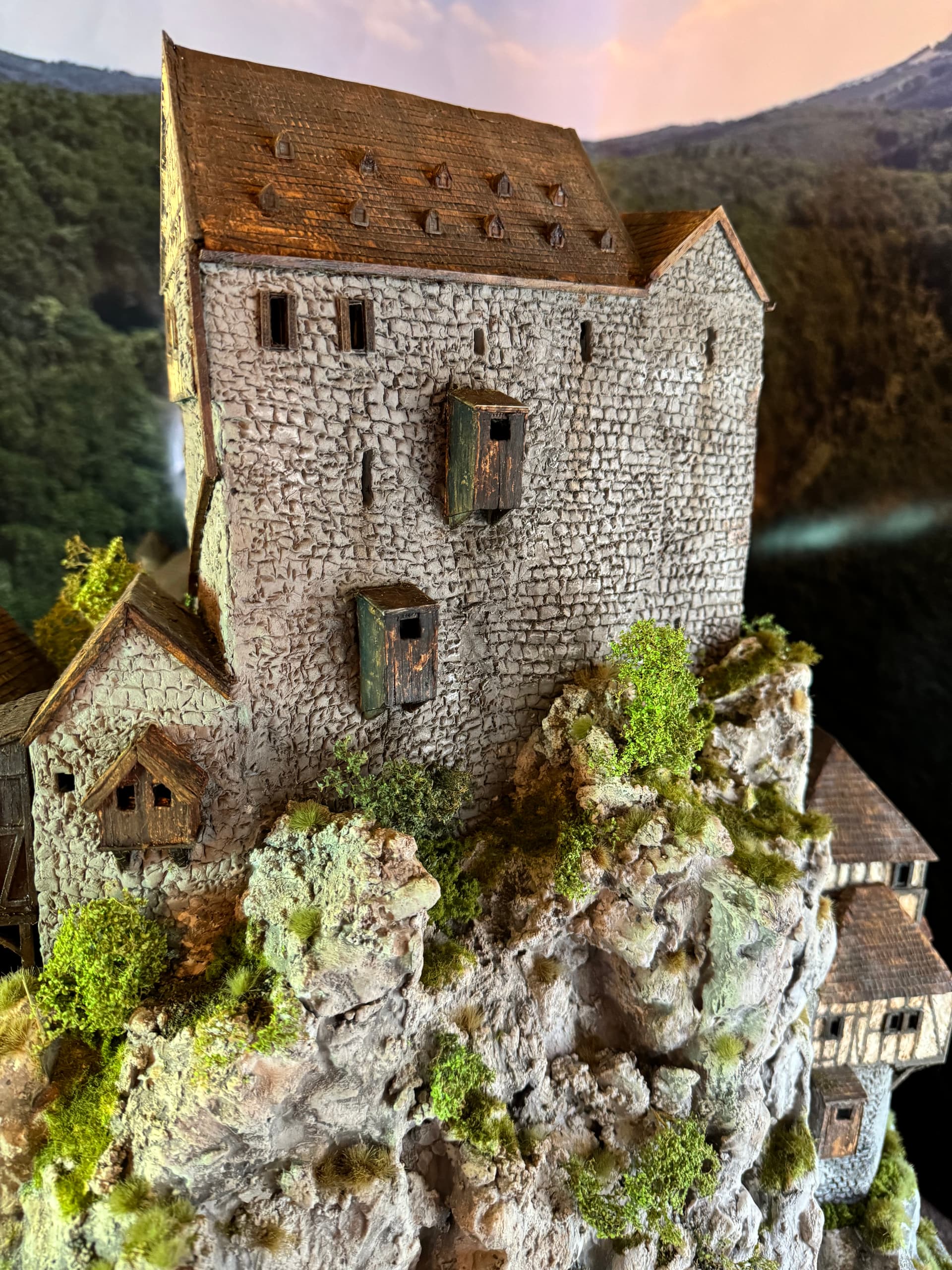

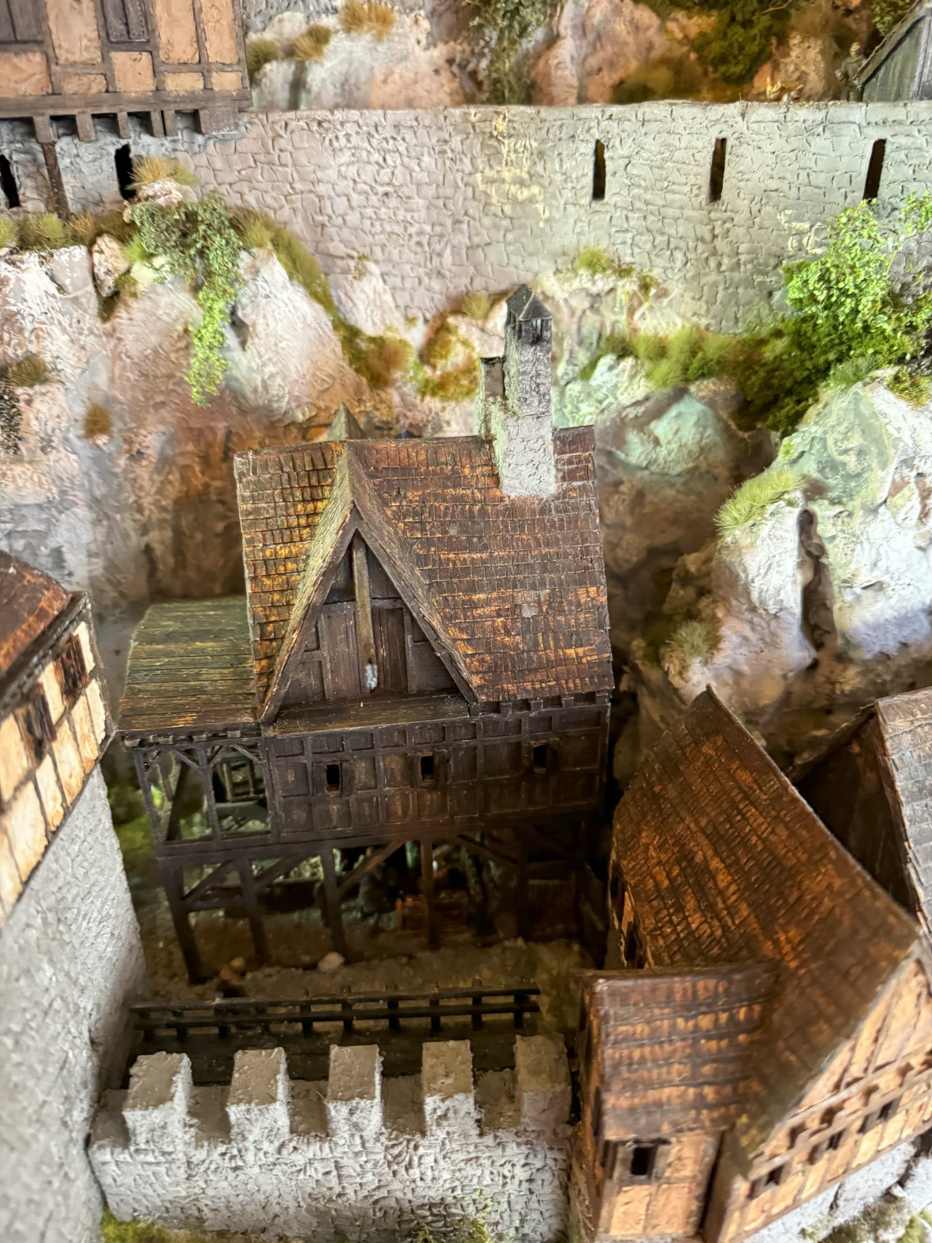

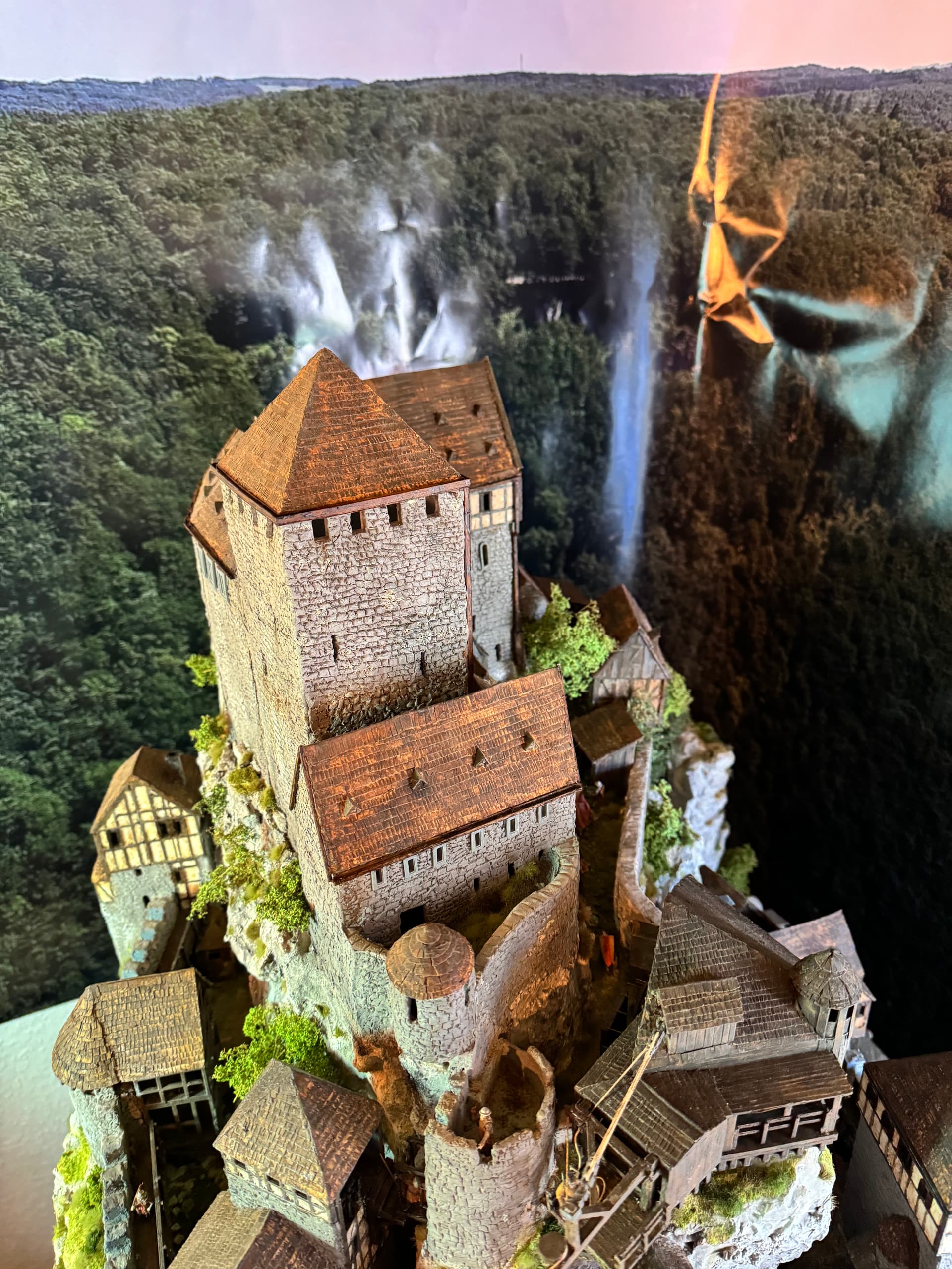

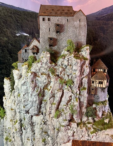

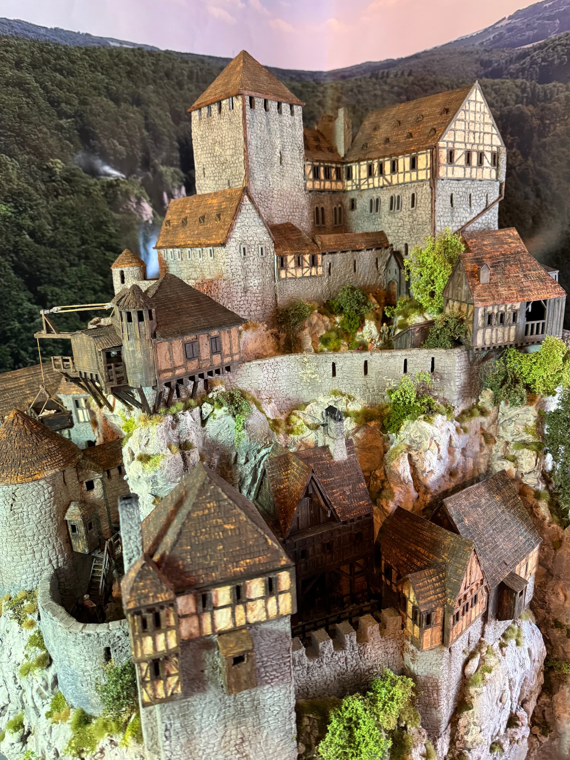

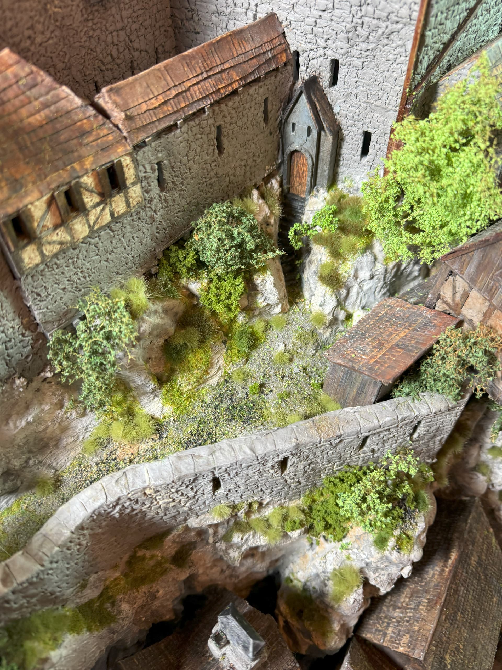

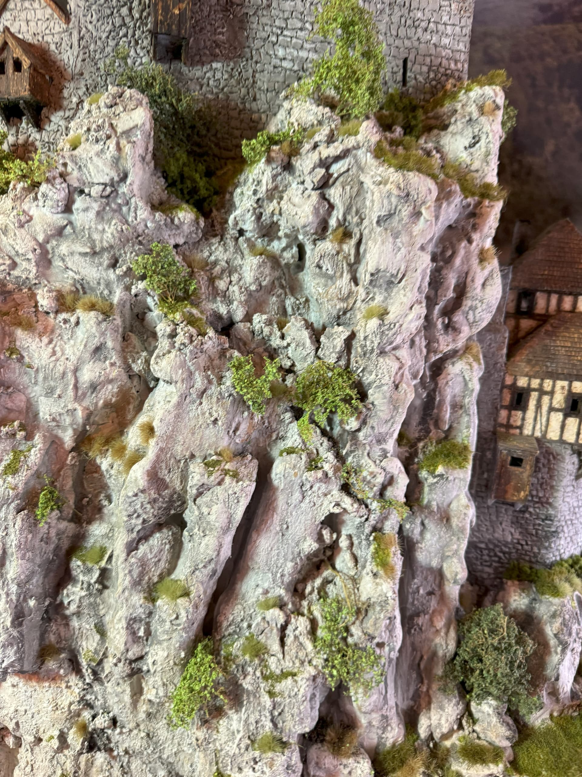

Here are some pictures taken during the construction, of the figures, the crane from the back, and other details and perspectives.

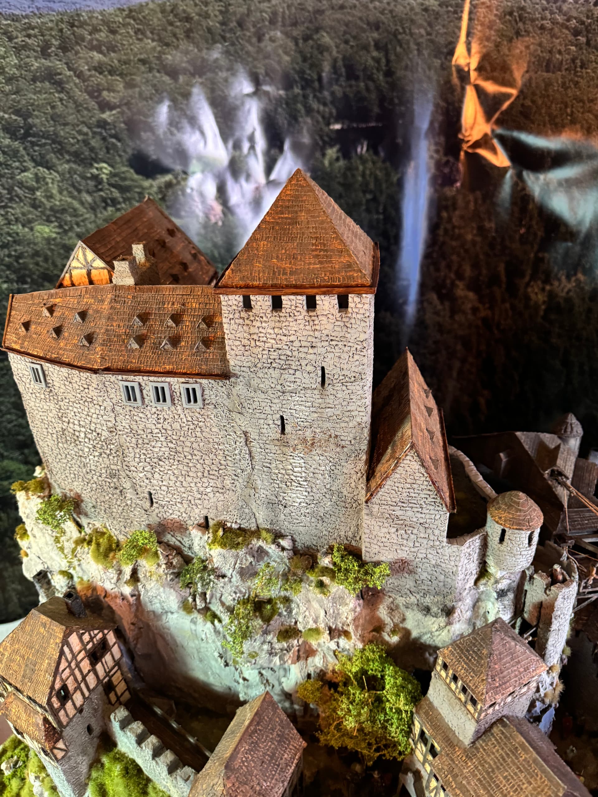

Unbelievable… that this is a model and not a real castle…
Thanks for the praise.
Well…I’m well aware that there’s still room for improvement. It gets better each time. You learn a lot and hone your skills. Greifenstein Castle may be a smaller castle and not as impressive. However, the craftsmanship is significantly improved. You learn something from each job to do better next time.
Again Frank, a lovely piece of work! Also, the castle buildings and walks are really well done but your rock work is beautiful! Nice colouring and structure. Very true to life!
