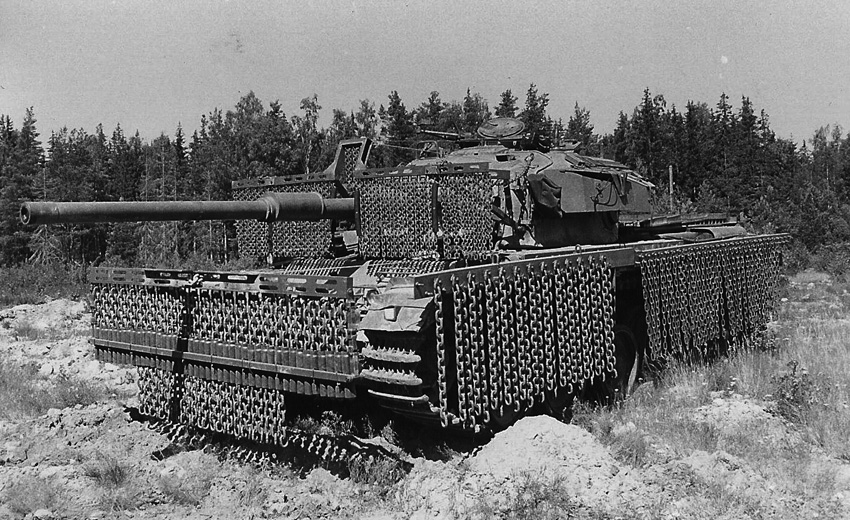

Found one pic.
Swedish Centurion with “chain mail” armor :wink:
Perhaps I build a “What if” Cent with ERA and dozer blade.

The picture of that Swedish tank with a dozer has a caption about experiments for various purposes including dozer blade.

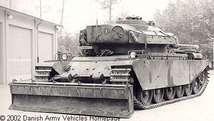

Danish bought 5 sets of the dozer blade…later 1 to 5 more, thats a little unclear.
Found in the Kim Hartvig Sorensen book about Centurion in Danish Service.

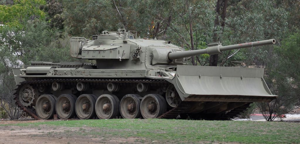

not sure, but I think this is one of those 4 Australian Centurion Mk5 with the blade. Without the side skirts.
School of Armour in Puckapunyal, Victoria

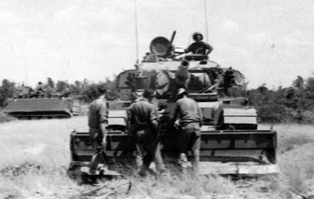

Were any of these used in Vietnam by the Australians? Wayne
Yes. Sent in '68.
