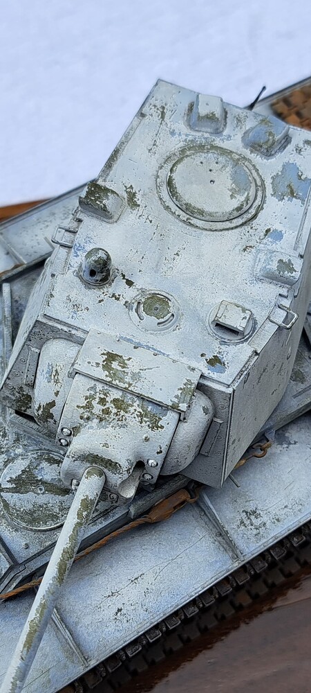

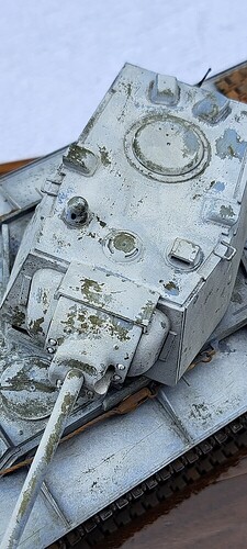

I used Tamiya White XF-2 thinned with Tamiya X20A thinner. Used water & old paint brush to chip plus backside of #11 blade for longer thin scratches. In some areas the midel got one coat, others two coats a few three coats of white…all thin coats of course. It’s easier to build base modulation with thin coats.
FWIW - The paint underneath the chipping fluid is enamel Floquil Railroad Road Weathered Black & enamel Floquil Military Color Dark British Green both thinned with the secret sauce (xylol & lighter fluid). Hard core lacquer & enamel fan. I dislike acrylic paints in general unless they can be thinned with Mr Color Leveling Thinner…basically making them acrylic-lacquers.
Being my first experience with chipping I wanted a base coat & color coat that would resist softening if exposed to Tamiya paint thinned with X20A.

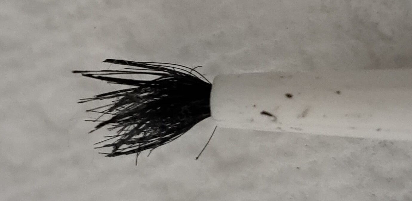

For paint brush application of chipping, I like one of those cheap terrible Testor’s nylon brushes like this one with just a faint trace of paint on the tips of the bristles.
Applied by stabbing like a pin pointed sponge.
