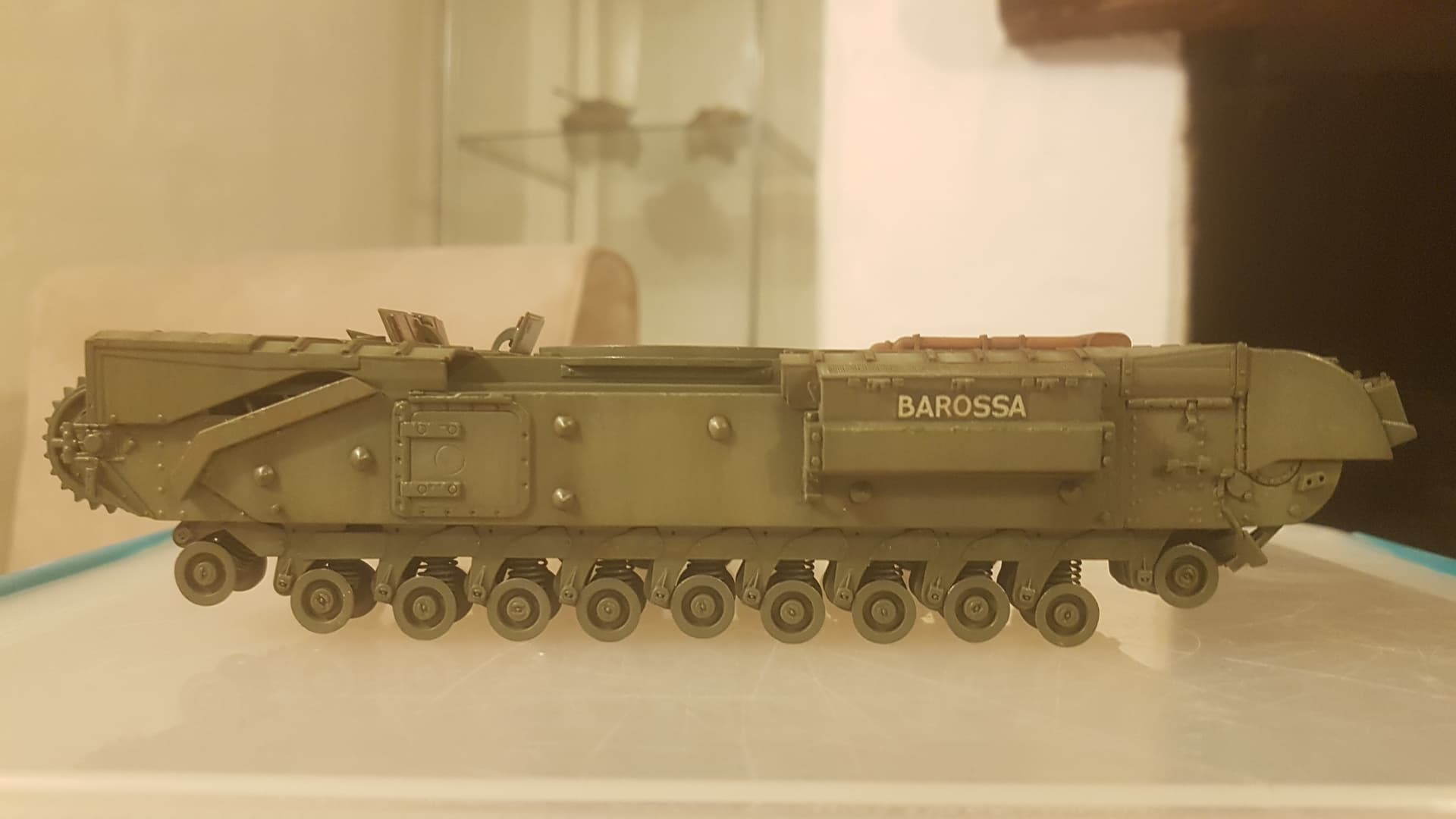

Not the best photos due to artificial light, but I have just painted my 1st ever oil dot filter to a model. I am very happy with the end result. I used burnt sienna, burnt umber, ochre and titanium white. This was only a $10 cheap set from the discount store but turned out better than I expected. It is still very subtle (poor photo doesnt help) and no weathering pigments have been added yet.
