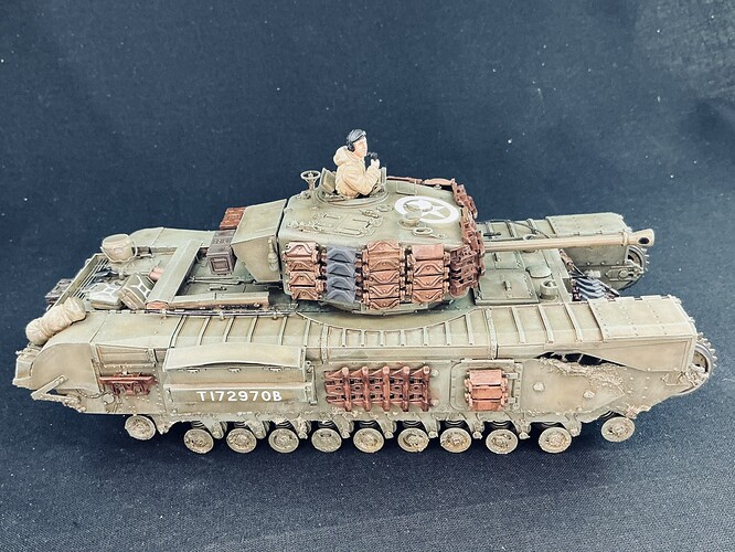

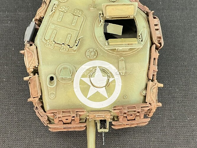

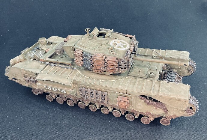

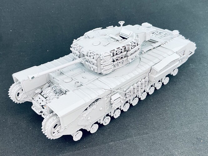

And from there, the model languished until yesterday … I had already decided I wanted spare track armour on it, because this features very heavily on British (and Canadian) tanks from late 1944 until the end of the war. Digging through some of my spares boxes, I came up with a good, representative assortment of Sherman and Churchill tracks for hull and turret:
I had kind of wanted some Panther or Tiger tracks on the turret, but as I don’t have any, I had to put more Churchill and Sherman links on instead
The Churchill tracks are all from AFV Club, while most of the grey Sherman ones are from Dragon that someone gave me this summer — and just building these couple made me glad I never bought a Dragon Sherman kit that comes with them … Awful things to make. Other Sherman tracks on the model are from Tamiya, Asuka and Panda Plastics. I didn’t try to replicate a tank from a photo, but arranged the tracks to look much like they do in photos of different tanks.
The white stuff in the last photo is coarse, textured, acrylic gel from an art supply store, applied with a spatula and a stiff brush to look like mud. It will dry semi-transparent, and probably shrink a little so I may have to add a second coat once it dries (it’s still very wet in the photo).
