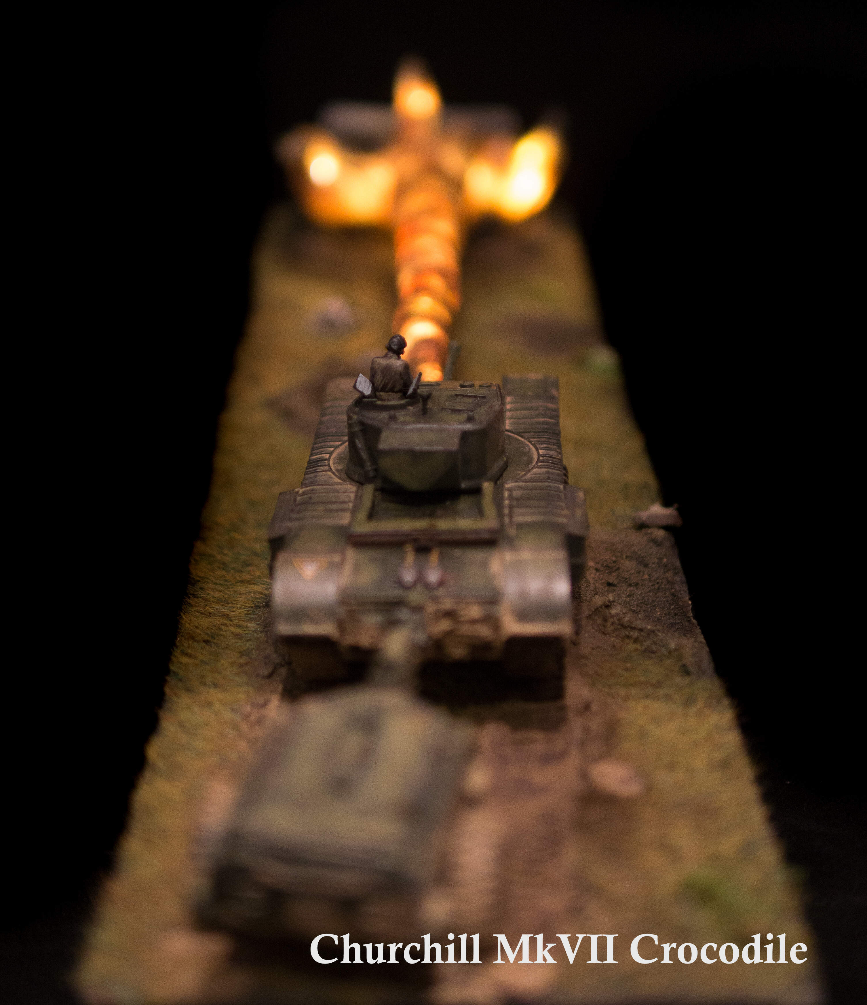

This was the last build i finished. I usuallly work on 1/35 armour but due to the potential size of the build when adding the flame thrower decided to scale it down to 1/48. I also really enjoyed the scale and plan on doing my top 5 tanks in that scale on one base for my desk.

How did you do the flame effect? Only painting or also electric lighting?

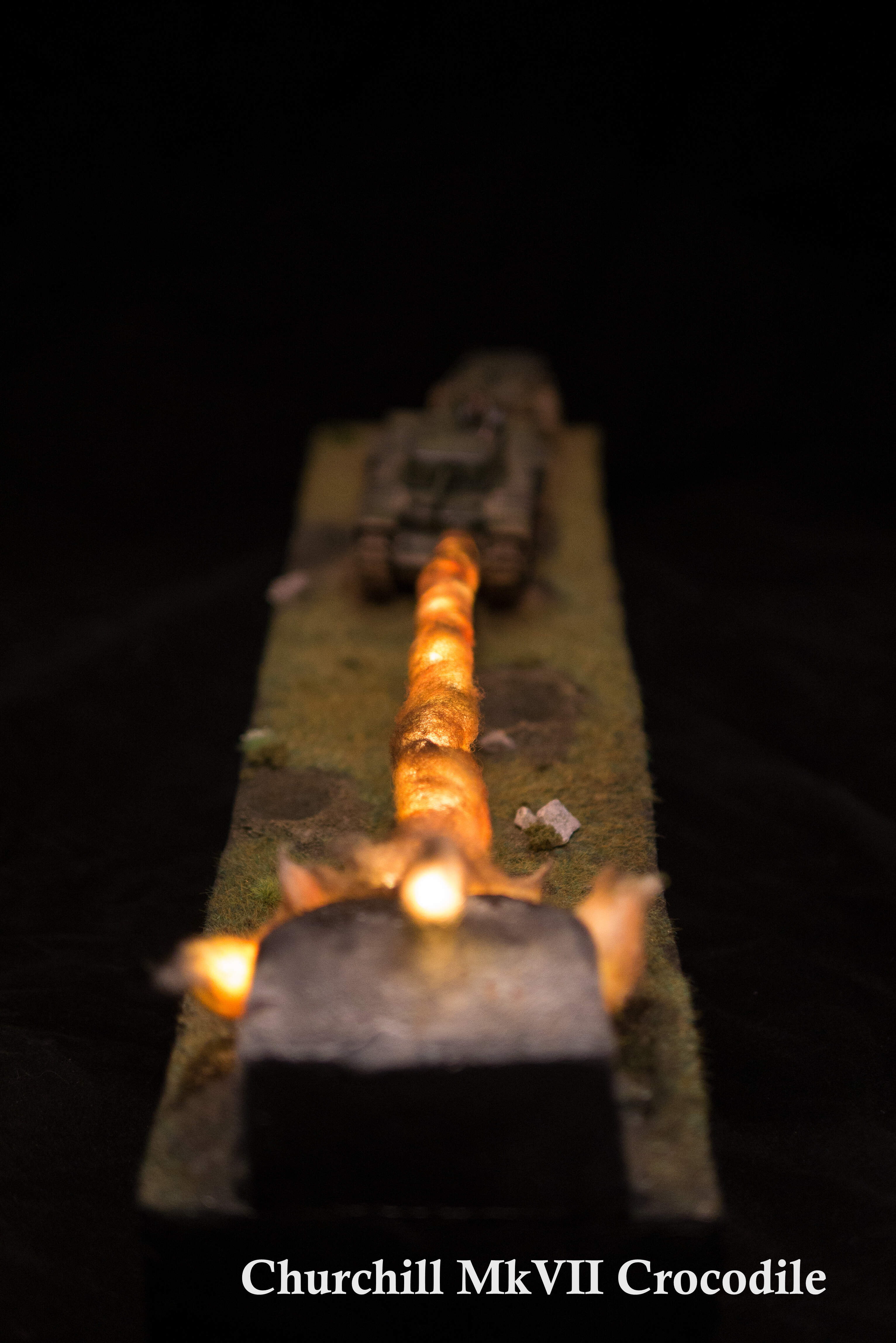

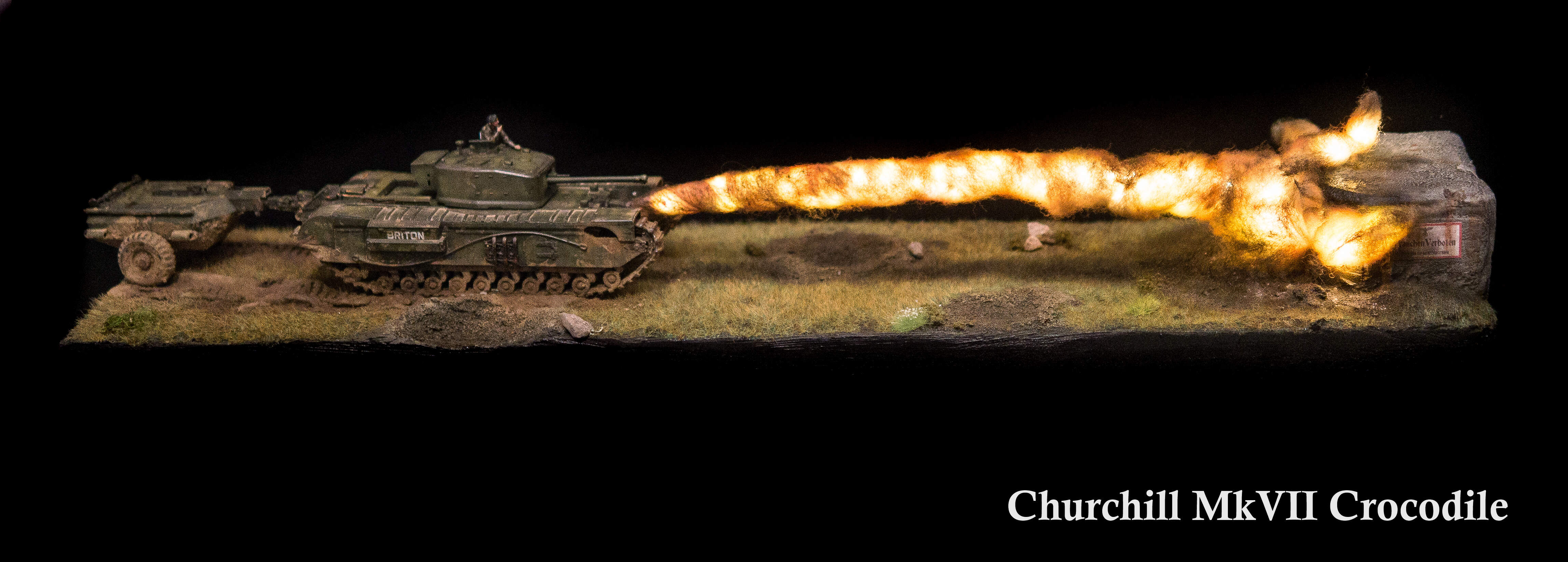

Both. Its essentially a wooden skewer, then i got small LEDs on a copper wire, the kind of ones you see in vases etc on etsy and VERY tightly wound them around the skewer (100 lights, more the better) then i wrapped double sided tape around that then… (phew) wrapped synthetic stuffing tightly around that making sure to try and keep some of the “fluffyness” then i painted it various yellows, oranges, red and blacks. It looks bloody awful when the lights are off but really works when lit up.
