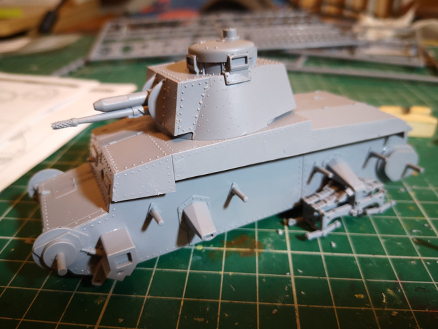

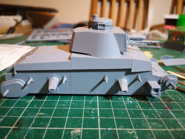

more progress… bogies and upper hull (including fenders)m front & back wheels are all removable. Wheels are done but can be slotted in later (got this tip off a full youtube build (actually what inspired me to get this kit)). Next up will be link & length track at the weekend.
As I lose all modelling space from the 28th (christmas decorations and moving the furniture around) the plan is to get the main build done now then do the additional stowage etc in the New Year…

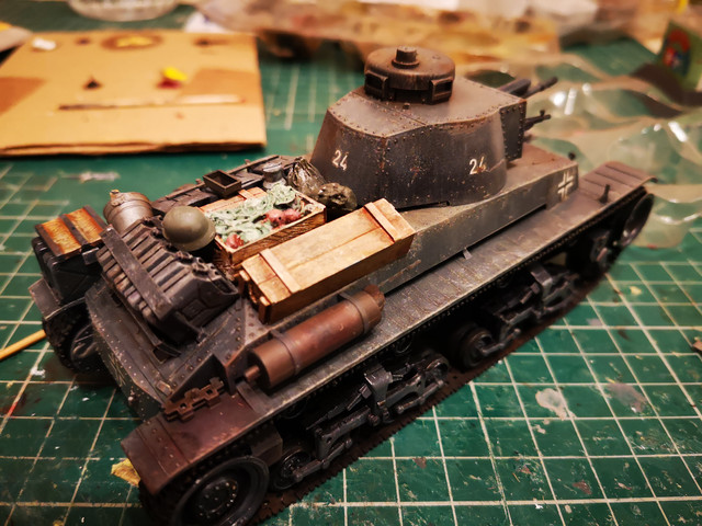

tracks done and you you can see where I am going with the stowage - need to add some on the right fender in front of the exhaust (photo research shows that )
more stowage added. Need to add some on the right fender and then work on the supports & frames for it all (probably after Christmas). Also considering my first base and revisiting figures… would need to find something suitable (maybe FoG base or something from MiniArt)

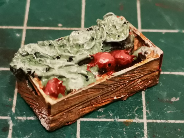

glossed up ready for decals (3 crosses, 3 turret numbers - not authentic numbers BUT authentic that they had small numbers). Also started on the wooden stowage (and cabbages - need to had some shadow to them I guess - first time painting veg)…

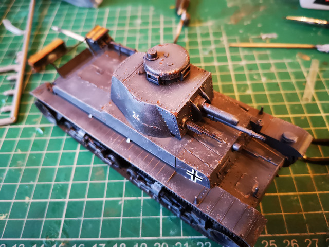

Decals on… turret numbers may not be accurate but their are photos with vehicles with small numbers on, stolen from a 251 kit…
scratches done (probably overdone knowing me), wheels & tracks on (not the best)… next up panel lines then some oils… getting close to being done

some oil dot fading - not 100% happy though. Need to work out what to do with the lower half. Need to look at the stowage - I hate just putting it on so need to get some rope for it. I will probably get this to a point then look at getting some soil when the weather picks up and fixer
99% complete - need to finish painting on one stowage and then look at dusting the lower areas…
