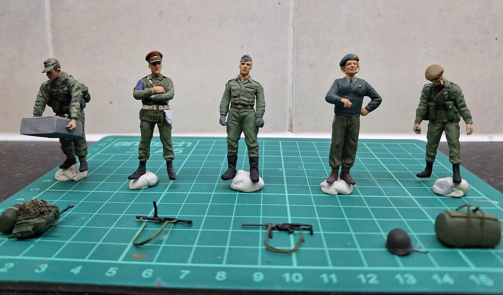

I don’t claim to be an expert but I manage to obtain an effect, though never as well as I’d like. But you’re right re the research, let alone the actual hands-on with Magic Sculp or Milliput; it is all very involved - and of course, it’s not just the Soviets:
L to R: A Brit, Belgian MP, Bundeswehr (relatively simple to be honest), Brit female, Belgian
Some of the opposition (East Germans):
I did have to set up a sort of production line for these.

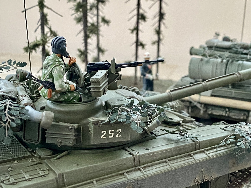

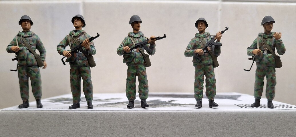

The only other type I’ve had a go at were figures wearing the camouflage smock, which given the nature of the garment, was relatively easy:

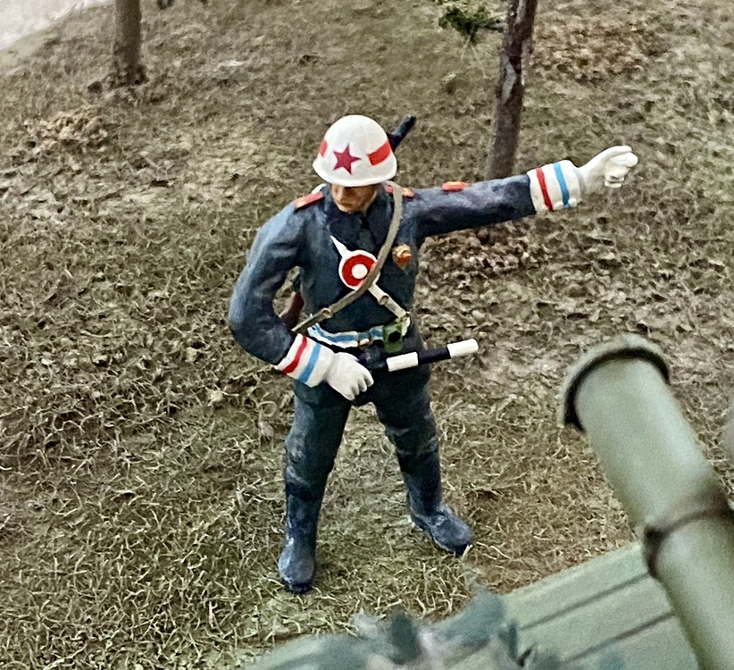

Unlike the Traffic Regulator which I didn’t really manage that well:
The paint job was a bit lacking I admit, which was probably the main problem.

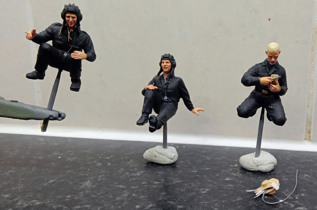

His opposite number - albeit a decade earlier - although an equally involved construct, came out, arguably, a little better:
This is not to show off; there are errors a-plenty, but if nothing else it shows the amount of work required even for fairly basic changes, however, I feel that figures can make a model; anyway, perhaps this’ll get a discussion going, but I certainly don’t claim to have all the answers , especially when it comes to sculpting.
