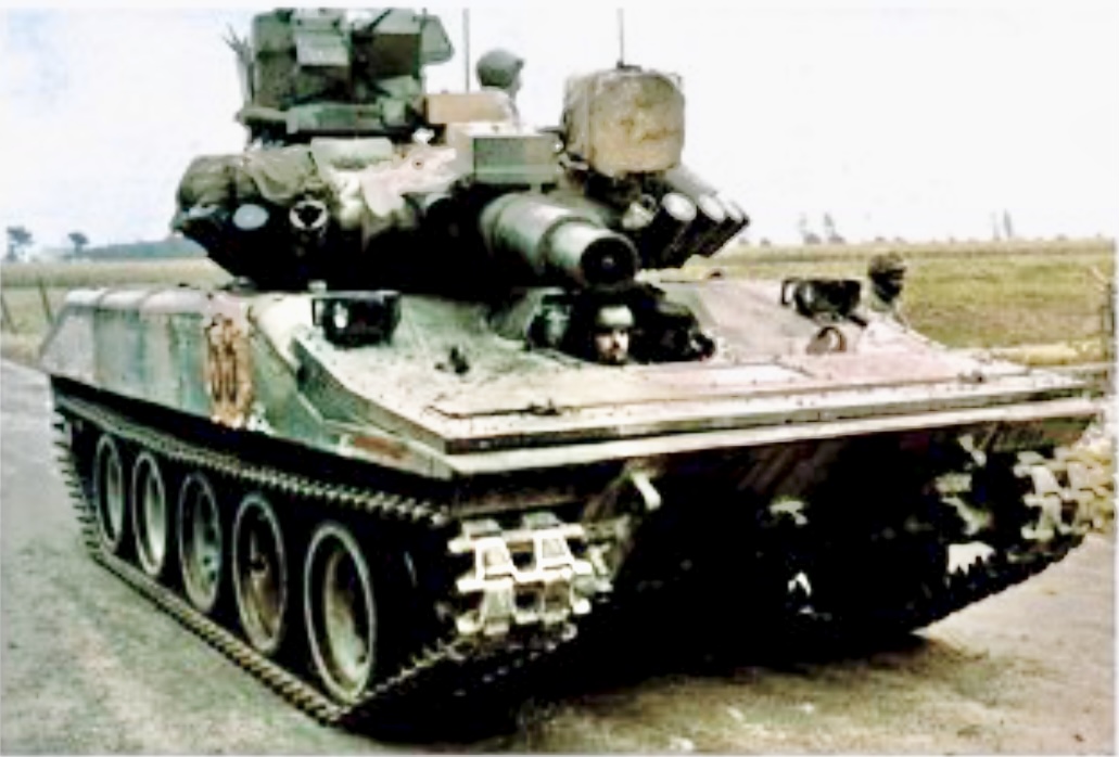

REFORGER 75 (according to the caption…)

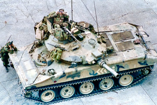

Not Reforger, but a good over head photo of the M551 in Panama operation Just Cause

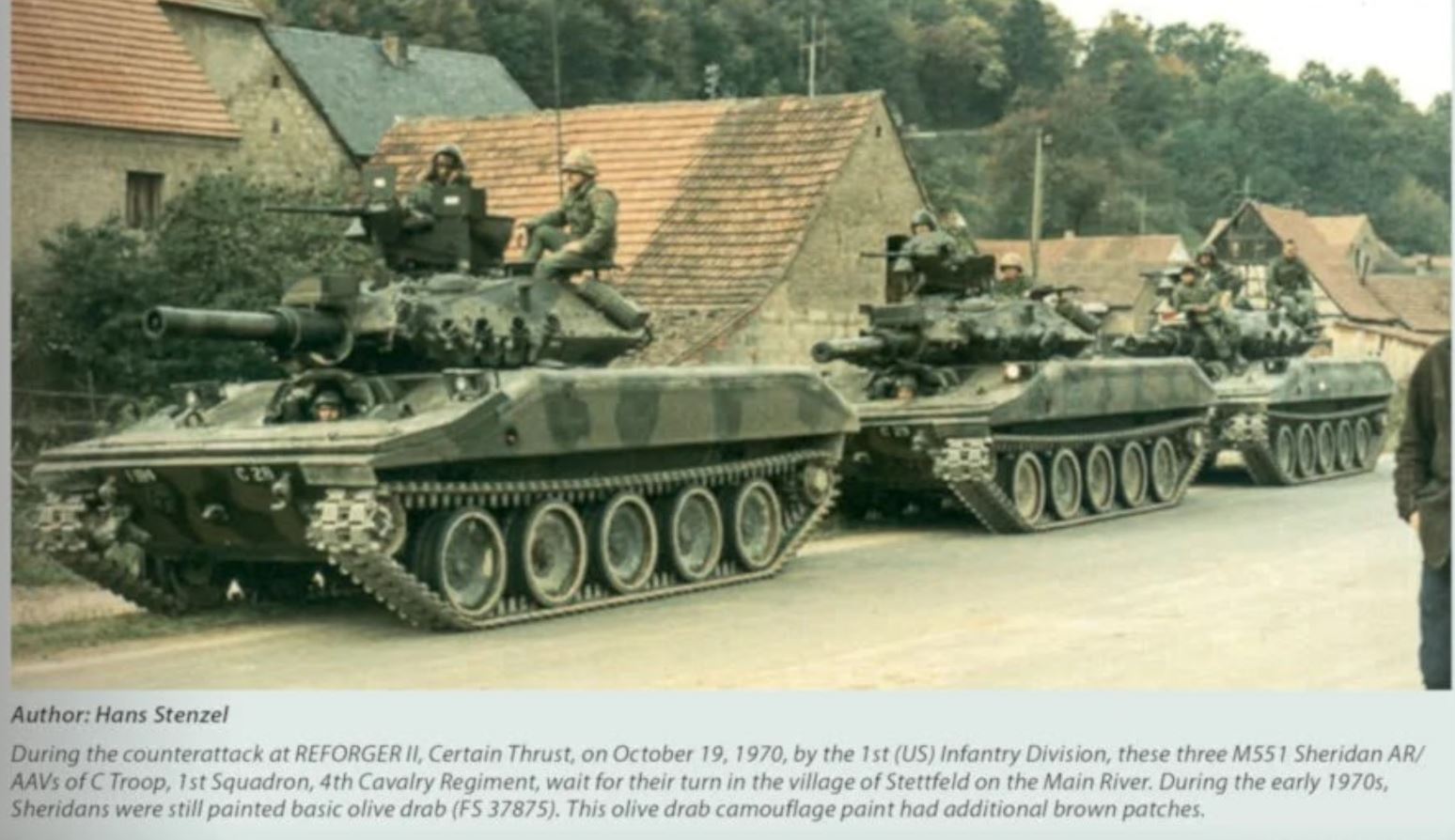

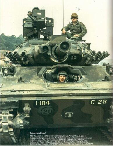

Reforger 76 Sheridan I don’t think it’s what you’re looking for but maybe of some use :woozy_face:
The reviews I’ve been reading indicate the Tamiya kit is accurate for my time period. And it’s quite a bit cheaper than the new RFM kit. I’d like to get the TTS RFM kit but it’s OOP apparently.
