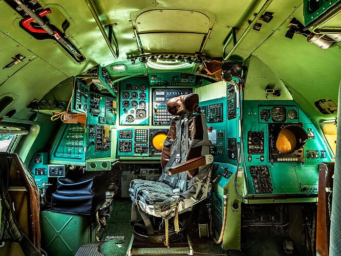

For the Bear, this photo shows a green similar to yours for the fuselage walls, and the more bluish color for the instrument panels:
For the fuselage color, I’d simply add a little yellow and I think you’d be just about right.

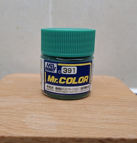

And for the interior green(aircraft and some vehicles-like MAZ 543) you can use H-46 Gloss Emerald Green from Gunze Sangyo/Mr.Hobby

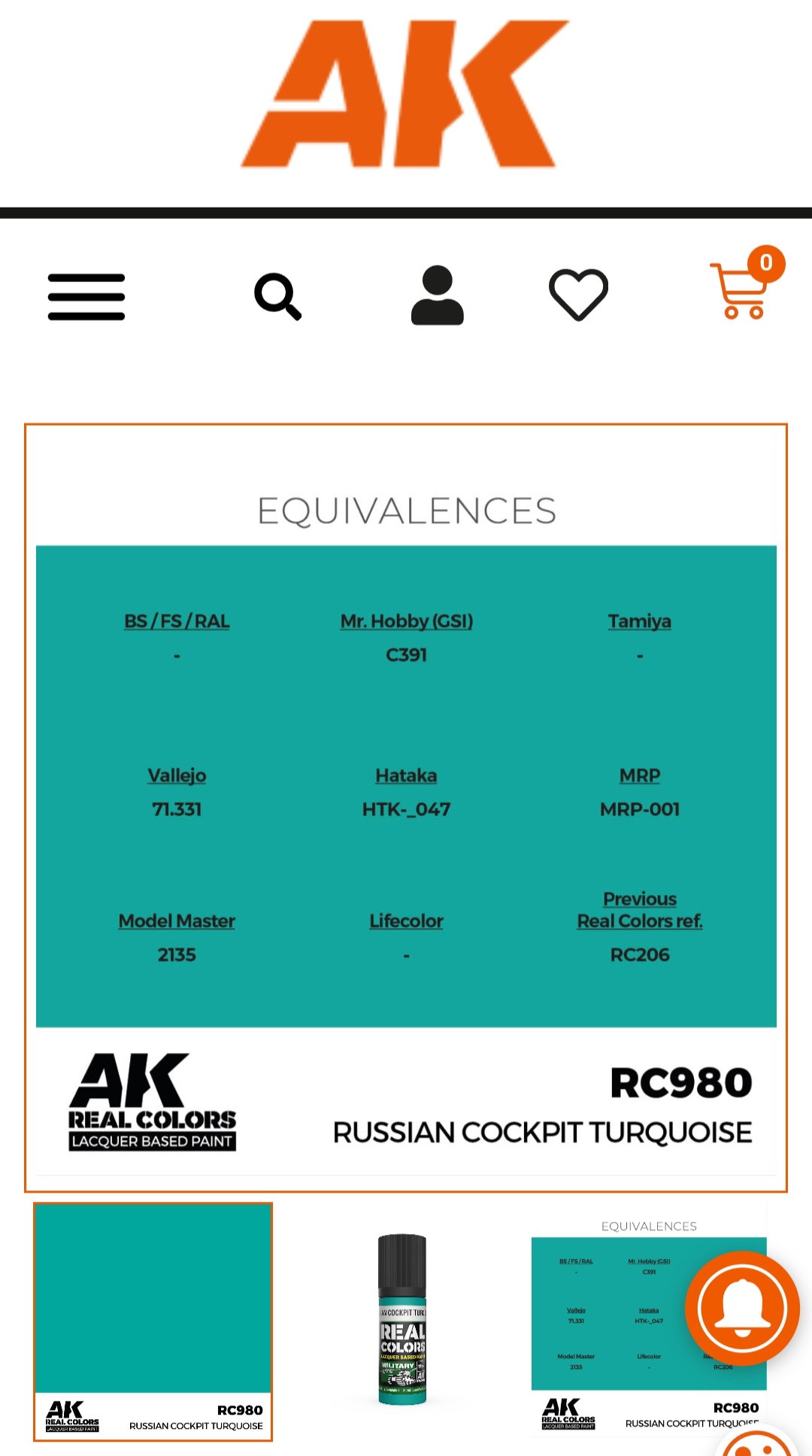

AMMO do this.

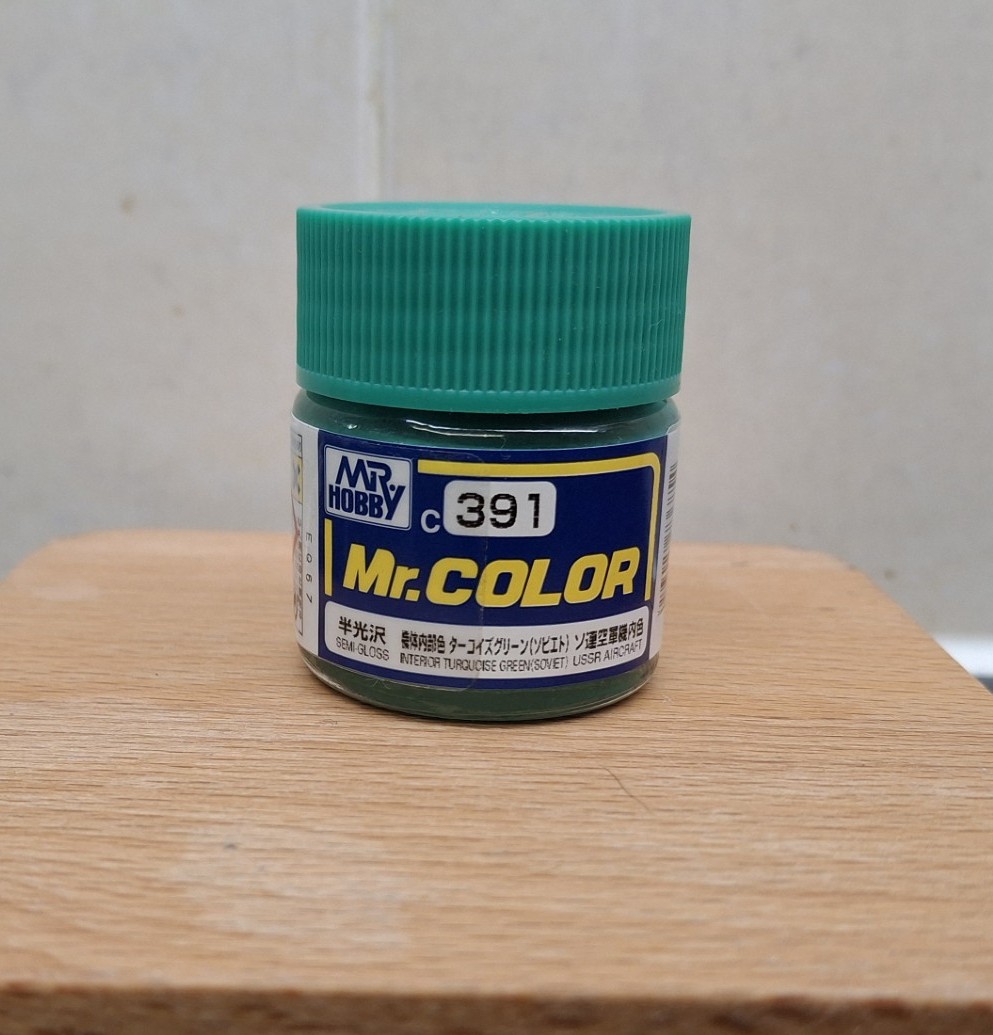

The Mr. Color looks very close.
I had a bottle of it myself (the AMMO one) and I thought it was quite accurate- not as green as it appears in that pic. If I still have it I will pour some out on a bit of paper and take a pic.

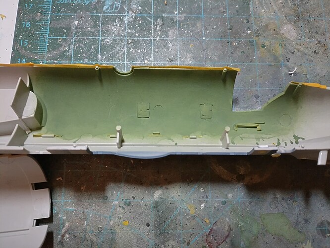

I like to use Revells 365 Patina Green, which is also available in their acrylic aqua range. Not sure about the availability in your part of the world though.
Used it here to the instrument panel on a Mil-2. It’s probably a bit greener than others, but it works for me.

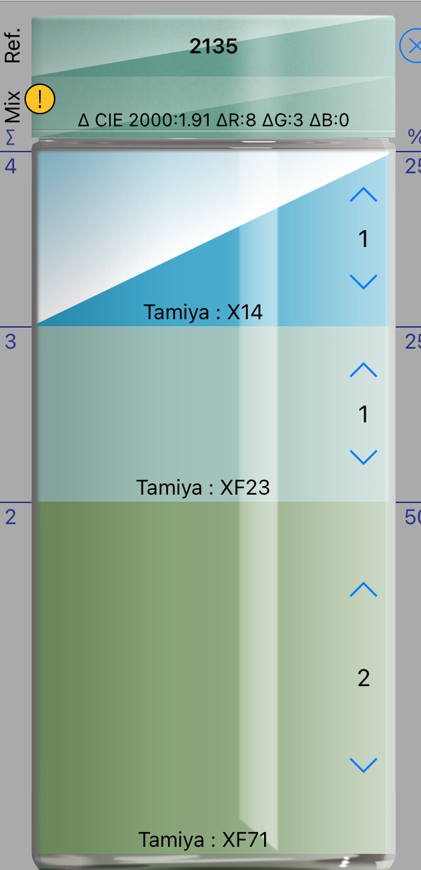

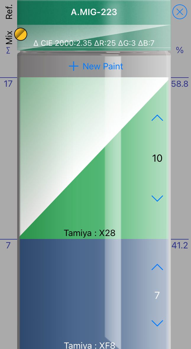

There’s also this option with comparisins
Just what I’m looking for, thanks alot Ryan.
